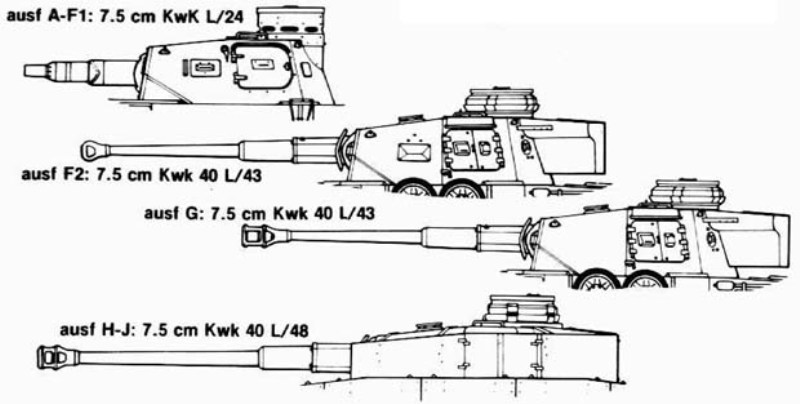

Heres a good outline of the turret/gun upgrades.
The PzIV F1 was a short gunned-uparmoured 'E', that became the F2 when the L43 gun was fitted, that became the 'G' when the armour was upgraded, that became the 'H' when the L48 gun was mounted................and on to the 'J' with hull simplification, along with all the other variants along the way. :crazy:

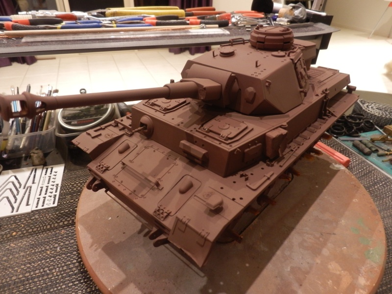

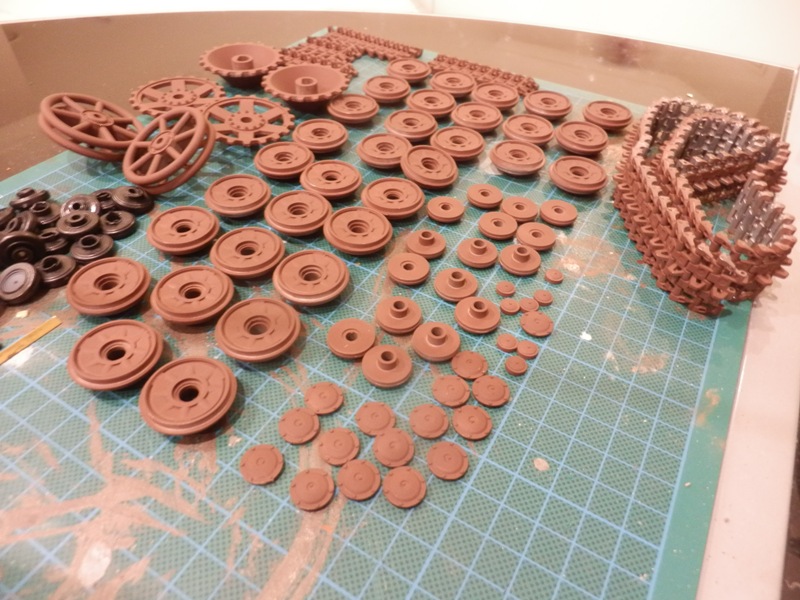

I got the rest of the primer on all my bits today, I'm using XF-9 hull red which I dont normally use. As the top coat is going to be XF-59 Desert Yellow, which is very light, I went with the dark primer to hopefully calm down the brightness of the desert yellow.
It also is a very good pre-shade as I found out on my White Tiger.
Thin areas of the top coat should create shadow areas, but this is still to be shown.
My only doubt is that its not actually a genuine primer-its a paint. The automotive primer I normally use is a real hard core self etching primer and it really burns into the material its applied to.
Once I bung on the Desert Yellow, I hope the lot stays put.
I might do a hairspray over the dark Hull Red and top coat it from there with a view to chipping areas off on the usual spots to resemble an Africa Korps machine, now in Russia with a bit on its plate :think:

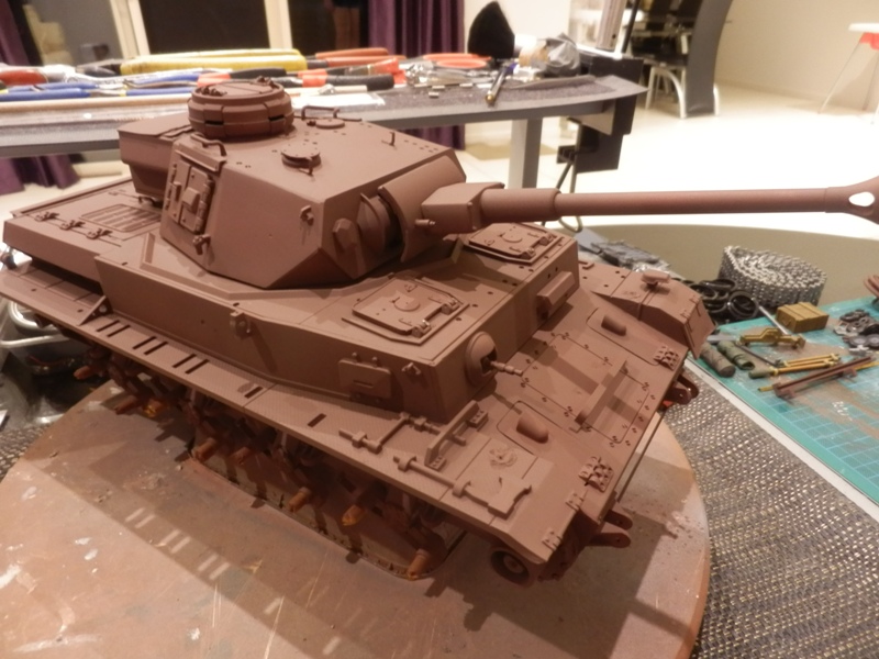

Thanks Mr Lav. You can see how the same colour differs from the hull to the running gear.
The hull has had a Mr Surfacer 500 , then a light cover of the hull red, then another light hull red.
The running gear had no base coat, a clean, and hull red.
The contrast from Tamiya dark yellow - XF60 to the desert yellow XF59 is significant.
Ive done brush test patches on scrap & I really am confident that the much darker hull red will calm down the bright desert yellow.
Soon see huh ! :eh:
I still might do a matt black shade over the deeper areas to perhaps shadow them even further, more testing to do yet.
