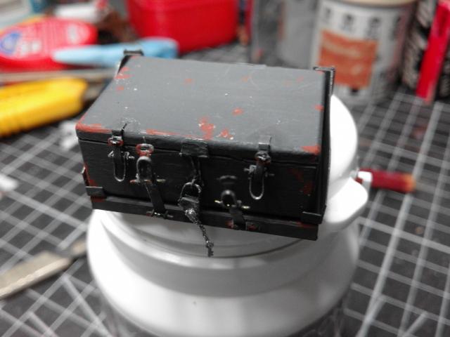

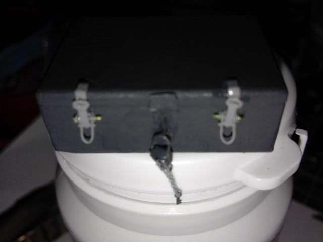

A couple of photo of part of the cause of my frustration for the last few days. It is the Tamiya tool box, reworked with Aber PE fittings. It still needs a final coat of paint. It does not bear too close inspection, but I think will pass muster from a distance. My excuse is that is been abused by the crew!
The other cause is the mounting frame, which still needs a little work. Looking at it, you would wonder how something with so few parts could be such a pain in the derriere.

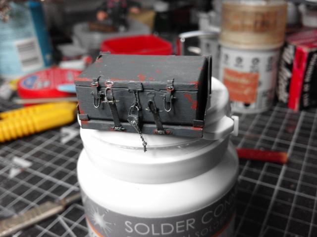

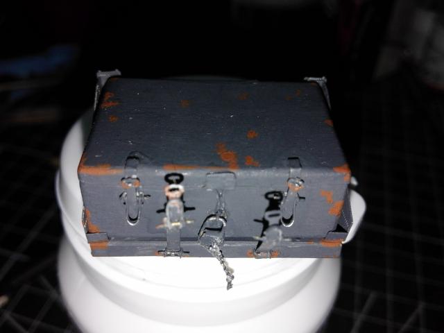

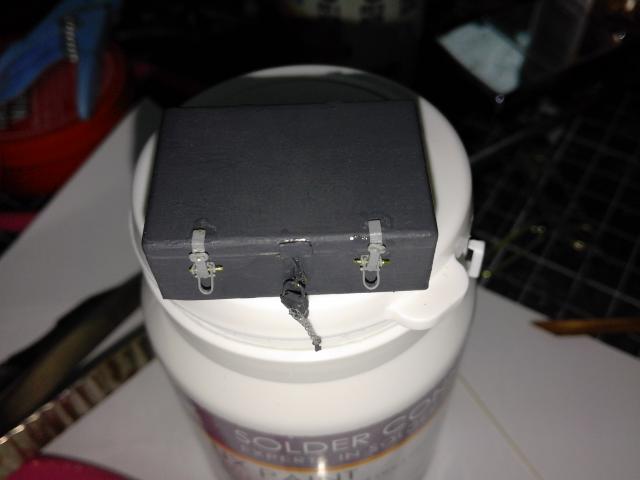

Photos of the tool box sitting in its cradle. The only things missing are the top strap, which will go on once it is fitted to the tank, after fitting the rear fenders.
