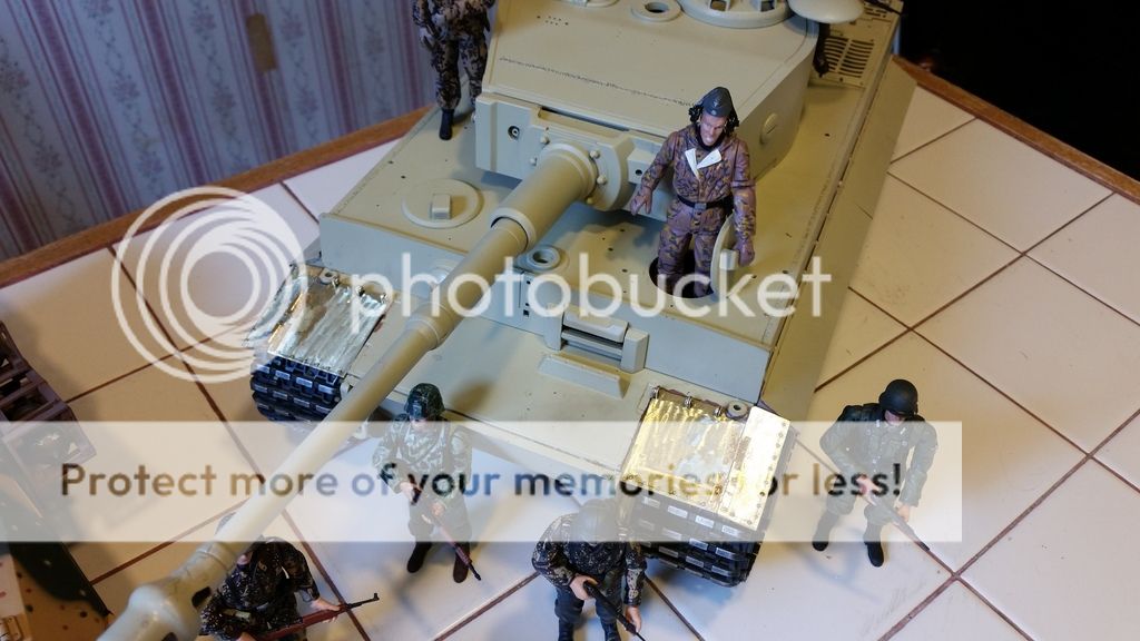

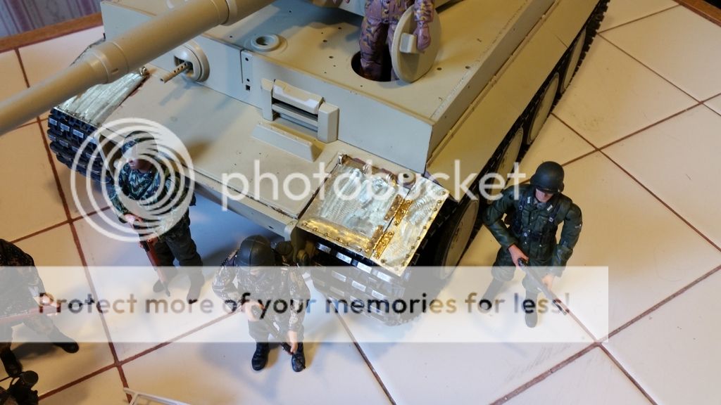

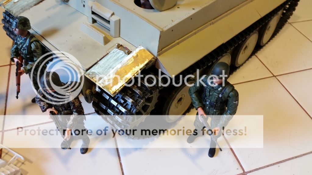

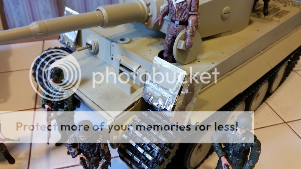

Success! I got the left front fender finished and on the tank and all the hinges work just like the real thing would!
Now on to the right side so I can get some pics up of the progress to show you guys. It's coming along really well.

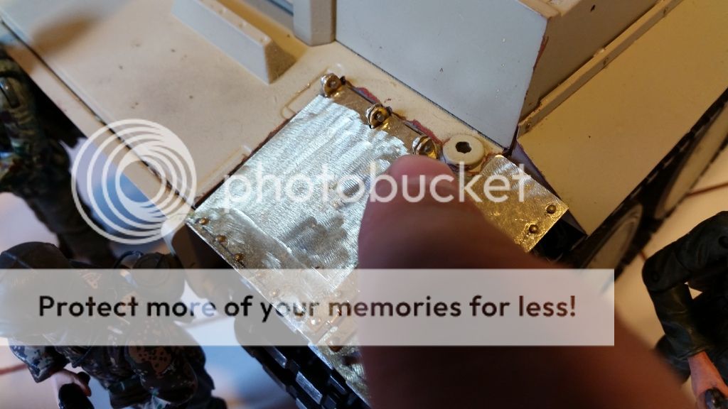

Ok got some updates on my Mid Tiger I build so please let me know what you think!

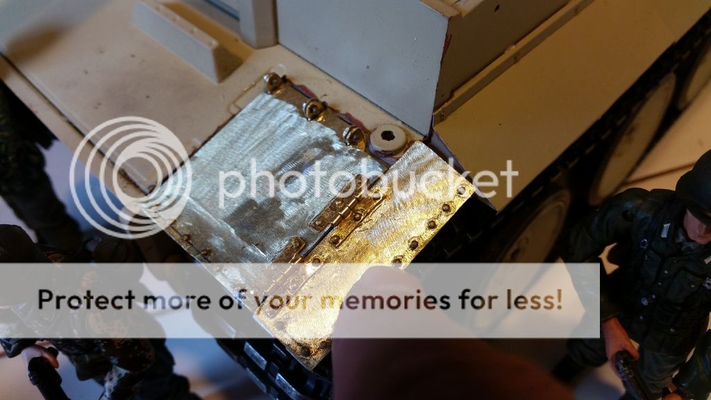

So here's some pics of the front fenders I made from scratch, the only thing store bought other then brass sheets and pins were the 2 small hinges that hold the side part on. Originally I had soldered them to both sides but did not like the effect so I removed the solder and took another look at the plastic fenders and saw the hinges were exposed along with the bolts so that's what I did. Now I couldn't find any bolts this small so I used the "nails" that came with the doll house hinges. Then I used more of the "nails" to simulate the rivets on the fenders. Anyway not bad I think for my first go at scratch building brass fenders and hinges IMHO.
Individual "rivets" had to be applied with tweezers and magnifiying lenses.

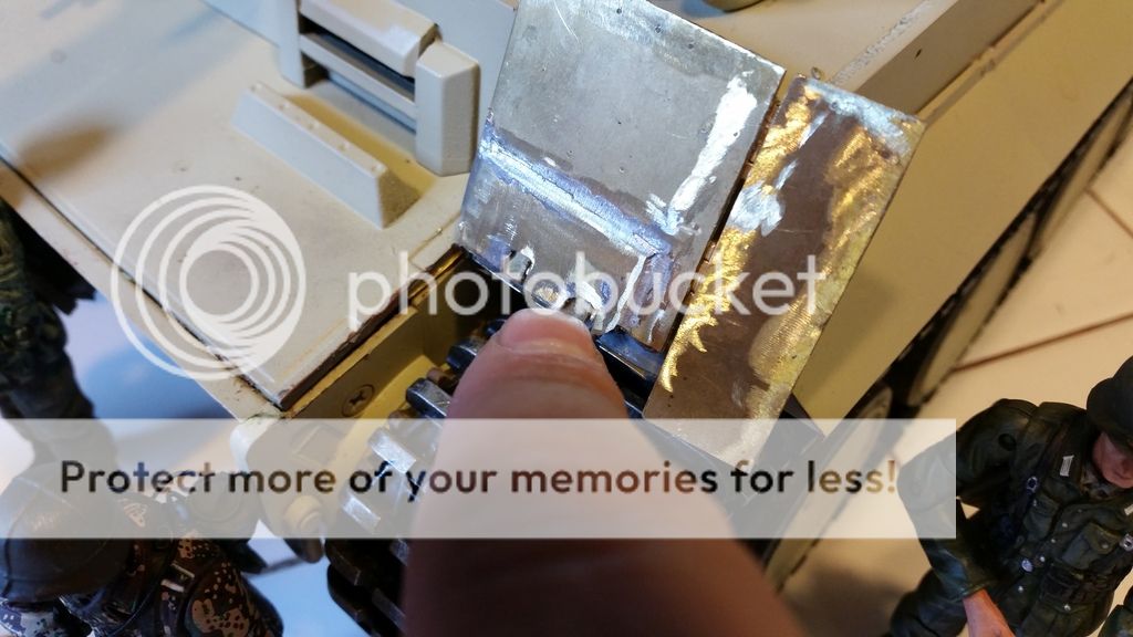

Scratch made hinges. Note I could only figure out how to make the inboard 3 I finally gave up on the 1 furthest out on both sides.
So here's the almost finished product! They need priming and painting but I'm happy with them!

Bloody good work Terry! ! I'll have a set of those front fenders there ace

Jack I love your "Photo-Etch" front fenders, I always make my own and I cheat, I buy the "VOYAGER" front & rear fender sets,
Because the brass sheet is so thin I cut 1mm plasti-card to shape and glue the PE to the card then using dolls house accessories website hinges,
I pin vise the hinge holding holes and push dress making pins through the holes (I use a block of soft wood as a template to hold everything together) then a spot of superglue at the point the pin comes through the hole,
Let it dry and clip the pins flush to the plasti-card back.
You now have a set of fenders with the bolt/rivet heads finishing off the look.
All my Tigers have properly working front and rear fenders and they are much tougher than the original PE fenders.
Dress making pins come in different sizes so you have to see in your minds eye how big the Bolt/Rivet heads would be when in position to get it looking right.
If your into detailing this can be very satisfying

Thanks guys! I have dress makers pins but I found these tiny doll house nails and went with them cause they're brass as well.
I also used the doll house nails to hold on the brass side skirts to my home made mounting pads on the side because they have these tiny ridges that are almost like barbs so they push in but then don't want to come back out.
I also picked up a diamond router bit for my dremel tool so I can make the proper mid production Tiger rear mud flaps as well.
The brass I use is much to thick to cut with scissors I use my dremel tool with a diamond cutting wheel and it's like a hot knife through butter!
I've done some custom wiring and installed some servos to do some neat stuff, I'll post some pics later.

If you need to cut soft but heavier guage brass than you find in commercial PE I recommend Garden Secateurs,
You can control the cut and it is easy to make accurate small cuts.

Shaun, This brass isn't very soft not sure how well any shears would do VS. this sheet. I'd be afraid the shears would bend the brass rather then cut it.
I just take a piece of masking tape, stick it to the brass sheet, measure out how I want to cut it and use my Dremel on it. Once I get it cut out I remove the tape and clean up the edges and all done!
