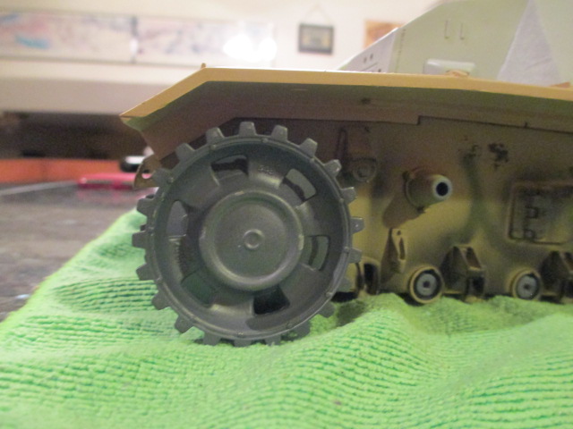

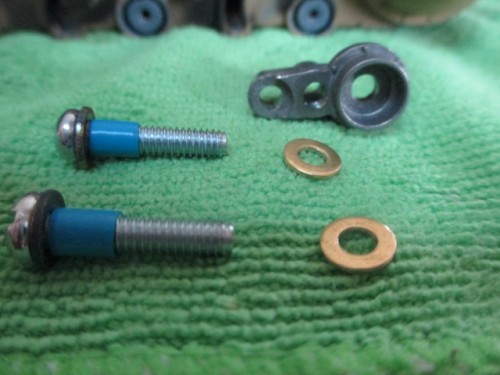

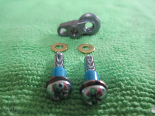

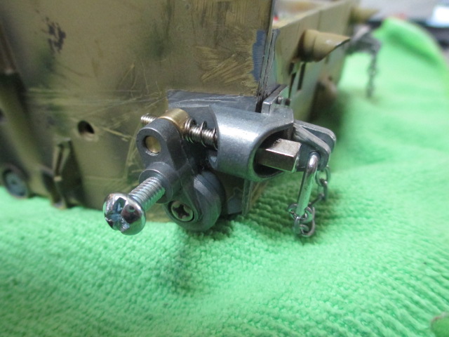

Lots of sunshine and gentle breezes saw me working on the StuG lower today. First, I primed and painted the new metal idlers and sprockets. While the pieces were drying, I was figuring out how to mount the idlers on the new metal adjusters. The original screws were meant to screw into plastic and had that type of thread. The screws and collars and washers that came with the idlers were designed to replace the original screws so would not work either. Taigen had enclosed two screws that had the correct thread but were much too short to mount the idlers also. I ended up taking a drive down to the local Home Despot and got a longer version of the right screws and some extra washers. Coming home I cut some plastic sheathing for the idler's bearing to sit and run on using the original screw as a template. A couple of added washers and the new metal idlers were securely mounted. After all of that I figured that, of course, the sprockets would be a perfect fit on the shafts of the new gearboxes, right? *laughs* I ended up getting the Dremel out and using a drill bit to clean up the inside of the new metal sprockets until they could be pressed into place. Hopefully, the new metal road wheels will swap out correctly. ;o) Pics:
Nice new metal panzer grau sprockets
Nice new metal panzer grau sprockets.JPG (97.23 KiB) Viewed 4664 times
Mounted securely with the new working adjusters
Another view showing the simple plastic collar I came up with

New screws of the right .75 length
The original plus Taigen's offering.

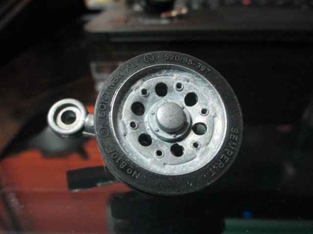

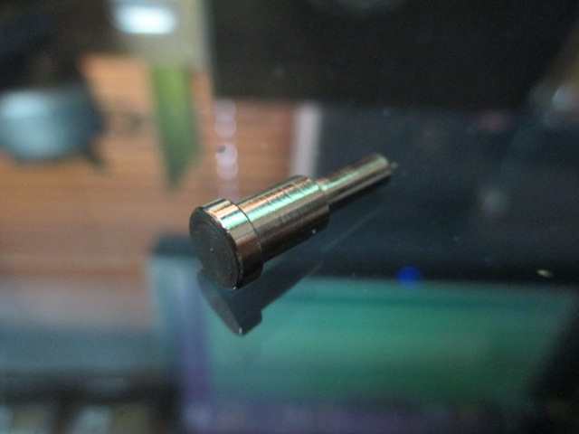

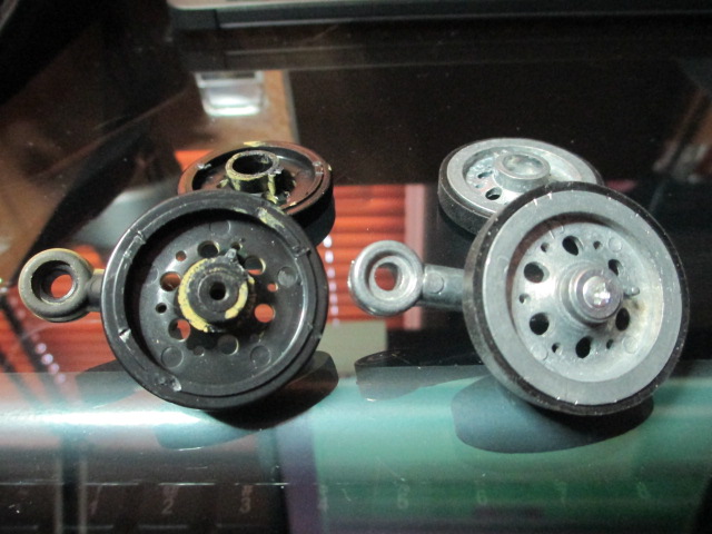

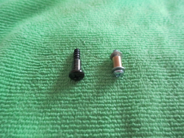

Pouring rain for the last couple of days so no painting. I did want to install the metal suspension arms and a couple of the wheels to test. Well, the wheels as shipped had the type of axle installed that is used for the arms on Taigen's metal lower hull not the plastic lower that I am using. The new metal arms I am installing are the type used for the plastic lower. So I pulled a little hair dreading the call to IMEX to ask for replacement axles or wheels and decided to research first. Not a lot out there and especially no pics or process on how to swap the metal wheels onto metal arms on a plastic lower. No pics of the axle or screw that would be required. I looked at the metal arm and noted that while it was not tapped, it did have the type of tabs that would allow for a screw to be used....Just like the plastic arm it was replacing. My mind finally woke up and realized that to use these Taigen metal wheels on the Taigen metal suspension arms for plastic lower, all that was required was to separate the metal wheel, pull out the axle then separate the plastic wheel and remove the screw. Use the screw to attach the metal wheel to the metal arm. As you all then say, 'Bob's your Uncle!' Pics:
New metal wheel and arm assembly for plastic lower hull
New metal wheel and arm assembly for plastic lower hull.JPG (90.42 KiB) Viewed 4646 times
Swap the screw from the plastic wheel assembly  to the metal wheel assembly
Remove this axle stud from the metal wheel assembly
Remove this axle stud from the metal wheel assembly.JPG (75.23 KiB) Viewed 4646 times
Begin with the old plastic wheel
Begin with the old plastic wheel.JPG (83.28 KiB) Viewed 4646 times

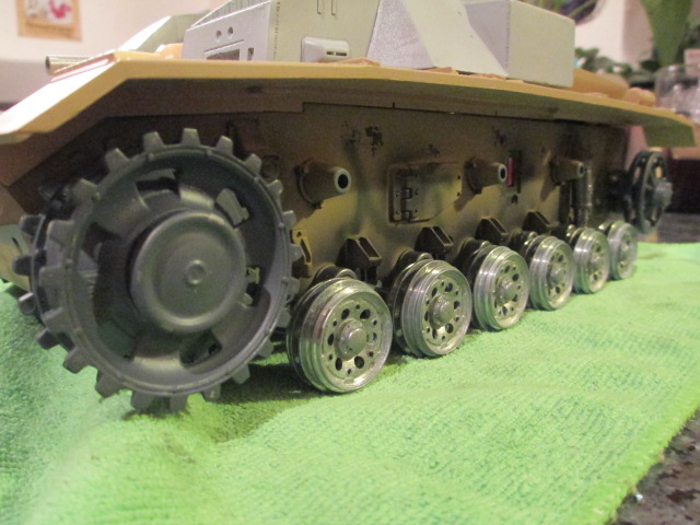

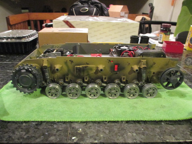

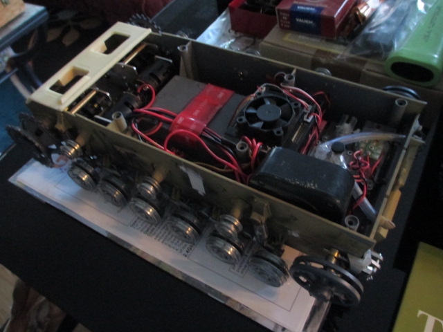

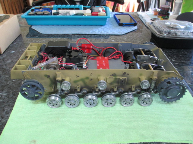

Still raining here so spent some time last night assembling and installing the roadwheels. Really makes a difference in the weight of the lower hull. These are nice quality pieces from Asiatam sold through Taigen. I removed the rubber in anticipation of prime and paint which will hopefully take place as soon as the sun shines. Pics:
Starting to look like an Assault Gun.
A solid fitment
A solid fitment
Assembled using the original mount screws and the screws that attached the original road wheels to the plastic arms.

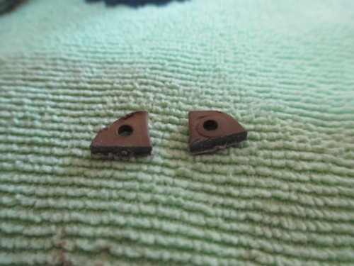

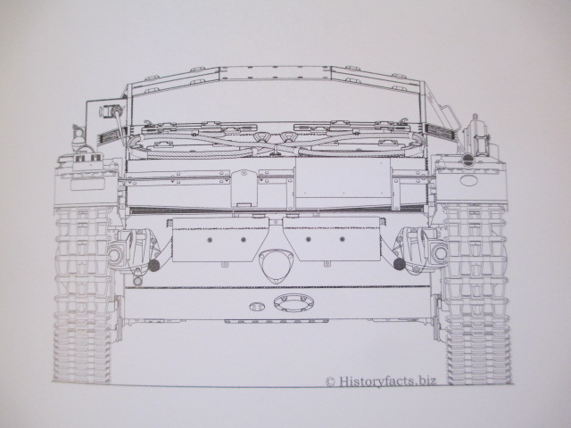

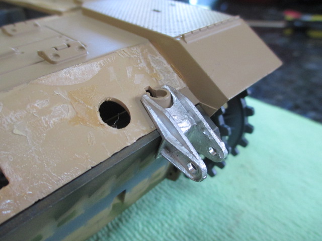

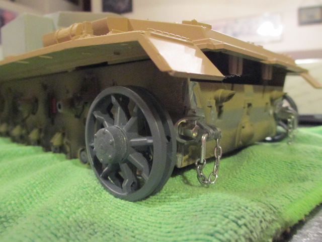

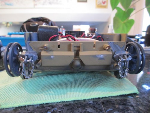

Got some more done today. The metal return rollers are in pieces when they arrive so as a word of caution I suggest looking at the original plastic pieces or an assembly template to make sure that they go on the new axles oriented in the right direction. Once mounted and the tiny nuts threaded on, a drop of Loc-Tite will help ensure that the nuts don't take a trip into the gearbox later on. I finished off the day's work prepping the lower for painting by puttying up the extra screw holes and trimming off the unneeded 'G' type front shackle mounts. The mufflers had broken while being removed so a little drilling and some pins saw them securely reattached. On to priming tomorrow. Pics:

More work will definitely be needed to match the illustration.
From Sassgrunt's excellent two volume StuG series
From Sassgrunt's excellent two volume StuG series.JPG (87.59 KiB) Viewed 4603 times
Test fitting of the early tow shackle mounts
Test fitting of the early tow shackle mounts.JPG (93.86 KiB) Viewed 4603 times
A couple of strokes of a file and ready for primer
A couple of strokes of a file and ready for primer.JPG (87.37 KiB) Viewed 4603 times
Used a razor saw to remove these from the front of the lower

Return rollers assembled and mounted

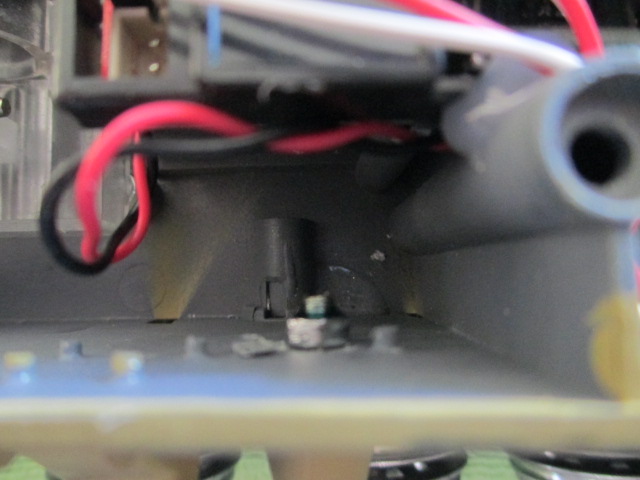

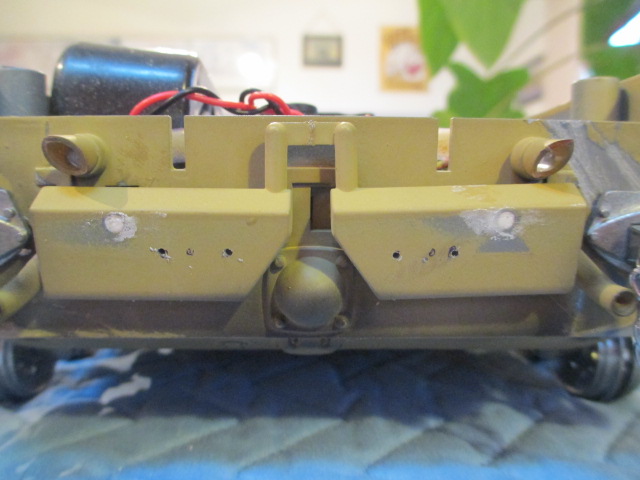

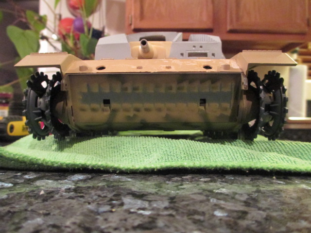

Thank you, Sir. Today was a beautiful day and I had to spend it outdoors, cleaning up after weeks of rain. So, I'll work on the primer tomorrow. I did manage to complete the putty work on the lower and put some thought into correcting the appearance of the rear bulk head a little more. The real AFV has a radiator air inlet grill under the plating there so I will work up something similar to fill the gap left by the removal of the PZ III lower hull spacer. Pics:
A little more putty to start prepping for the air inlet piece
A little more putty to start prepping for the air inlet piece.JPG (96.51 KiB) Viewed 4586 times
Bolt holes added to the mufflers.  Eventually, the later StuG models got an exhaust redirector in this location on the vehicle.
Bolt holes added to the mufflers. Eventually, the later StuG models got an exhaust redirector in this location on the vehicle..JPG (90.5 KiB) Viewed 4586 times

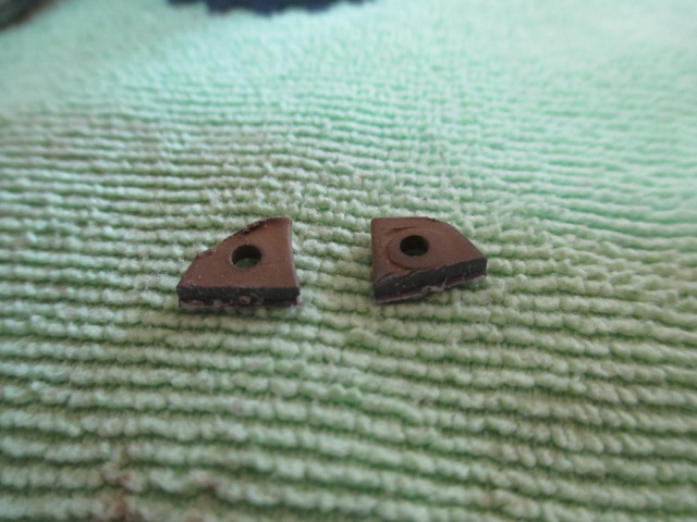

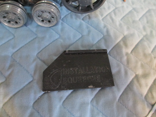

If you've ever put your own screen protector on a device and have this left over, save it.  It is very useful when puttying in small places.
