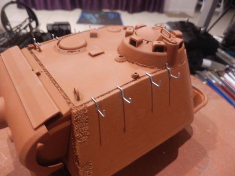

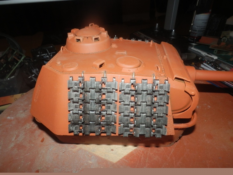

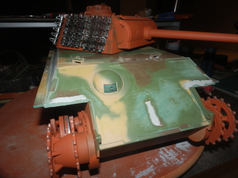

Slow day progress wise today.
Had a crack at removing the exhaust covers to change them to late Jagpanther ones with the elbow on top.
Hmm, the H/L glue monkey beat me, to death almost !!
Ended up breaking the shrouds into fragments & still not getting what I wanted.
Bought a new set of exhausts - X2- and a whole new rear plate just in case.
I do want to muck around with a storage box for the Vampir gear that these had on the right rear, so a spare panel to get things right on is going to be handy.

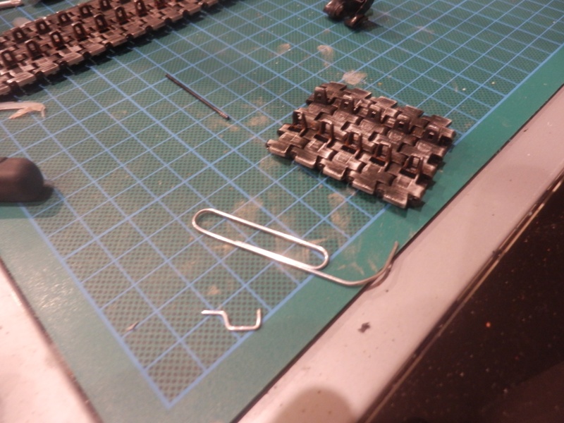

Also got the turret spare track link hangers bent up & mounted.
Used a heavy paper clip & two sets of needle nose pliers to bend them.
Still to complete the rear quarter mounts, but once the welds are placed I reckon they will look smoother than a gravy sandwich :haha:
Sure does give the turret an angry Echidna look with the guide horns sticking out like spines 8O

Looking good Herman smart trick with the paper clip nice one

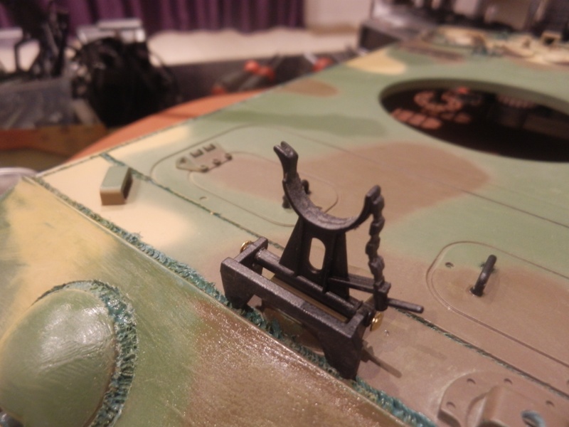

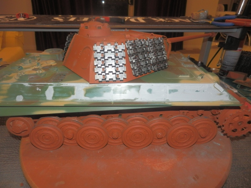

My rear plate has still not arrived to replace the mess I made of the exhausts. The glue maniac got me cold.
I just seem to be out of sync not having the lower hull done.
Need to replace the exhausts with fully hooded Jagdpanther types, mount the tow clevis claw, starter crank, and track pin pliers on it, and create the Vampir storage box in place of the right side stowage bin.
THEN carry on with the hull upper.

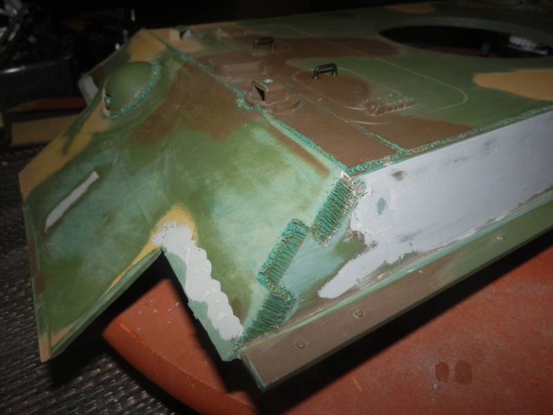

Freed up the barrel travel mount by drilling out the long pin & replacing the solid moulding with brass pins out of a picture hanging kit.
Also completed the turret track link hangers, but these still need the welds doing.
Finished welds on the hull & need to place the fan cover plate lifting hooks.
Coated the glacis plate with superglue & spread it by finger to give texture. Seems to be pretty effective.
