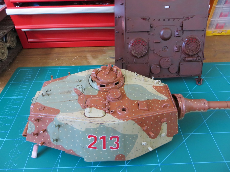

Started ageing the turret but the numerals are rather bright.
The top is also done and will paint this weekend.

A filter and some streaking will sort that out Bill!

Yeah, going to do some more ageing and whatnot when the hull is in the same state.

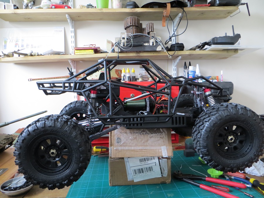

I've yet again become side tracked.
Meant to be a 1:8 scale. It's hiding the Tiger II quite nicely.

Sweet is that a axial yeti?
