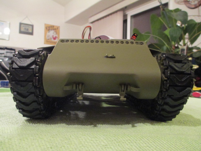

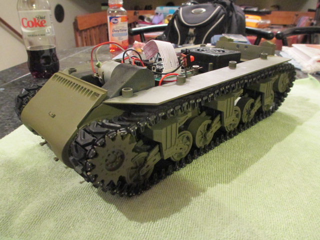

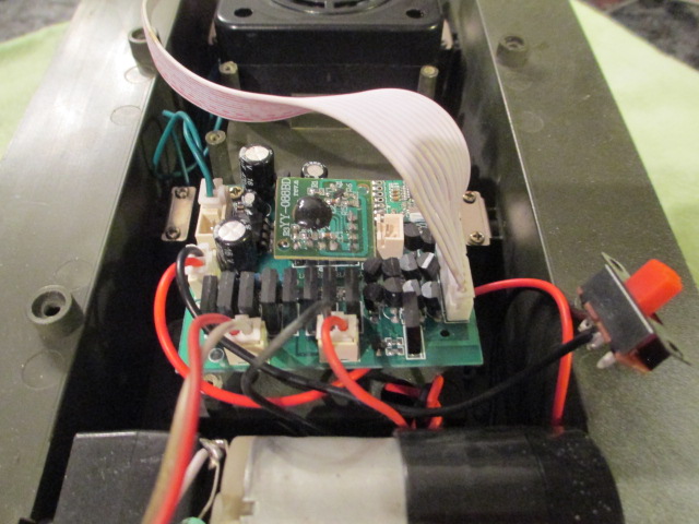

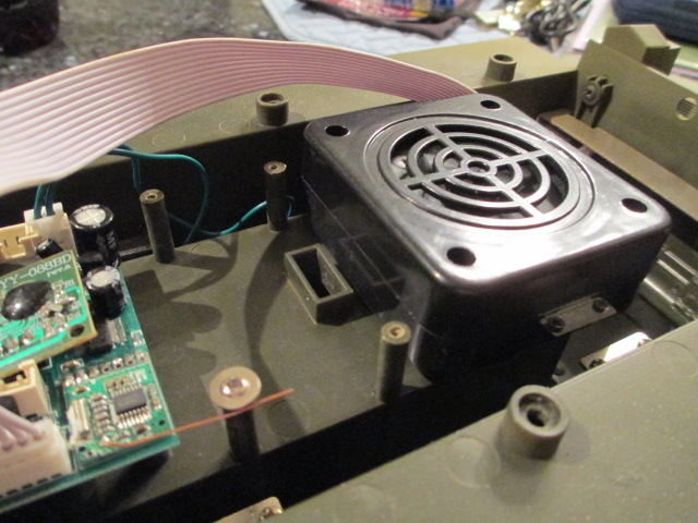

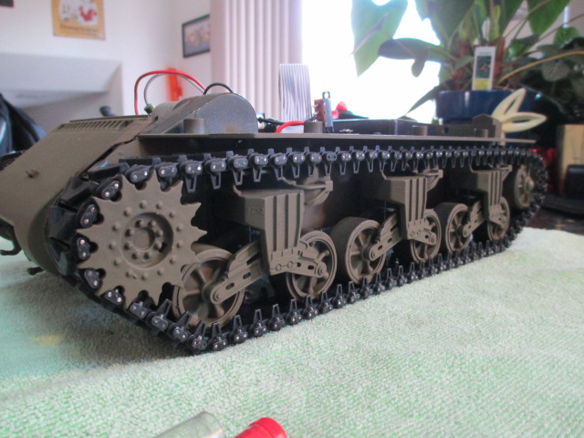

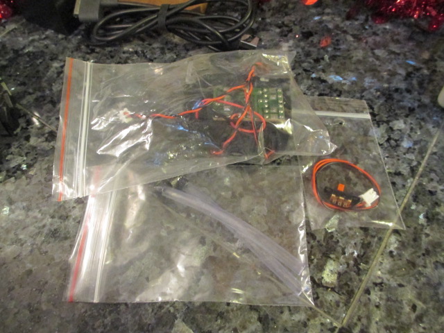

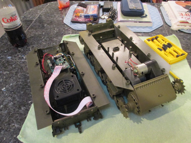

Alpha my Friend, there is a lot to be said for coming to your senses. I did the same thing tonight, deciding _not_ to possibly fry my gifted 2.4GHz board by trying to fit a HL smoker to it. There was only one empty 2 pin port left on the board and I wasn't sure if it was power or control since the heretofore unseen Mato Sherman smoker apparently only has one 2 pin plug on it. The HL smoker needs the Power and the On\Off 2 pin ports. Unless someone here has done it and knows a sure fire method to connect it to the Mato 2.4GHz board, I'll be saving that proportional smoker for the Pershing redo. Otherwise, the night went well. I got the electrics switched over and everything mounted solidly in the lower hull. I have the On\Off for the tank left loose to be mounted under one of the hull hatches. The same will be done with the new sound pot. I put the tracks back on and noted that I will have to remove the extra link I added. Way too much slack. The new tracks come with an extra link in them already over the older versions. Pictures:
Starting to look like a Sherman tank again
Starting to look like a Sherman tank again.JPG (95.15 KiB) Viewed 4082 times
New speaker mounted with a screw and tab + a section of removable double stick for cushioning.  Note the aerial screw safeguard
New board fits nicely with one screw mount in the old hull
Tracks back on with a tad too much slack

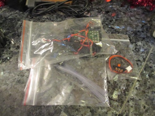

Unused for now proportional HL smoker
Time to install the new 2.4GHz set and switches in the old hull.

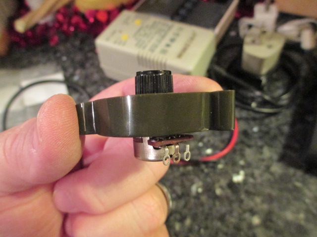

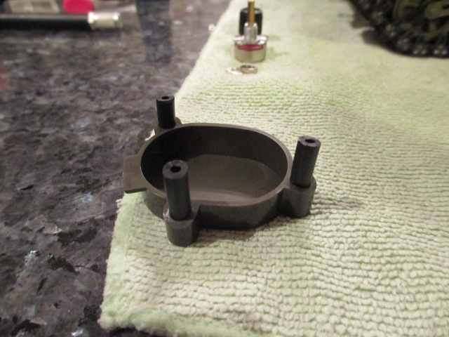

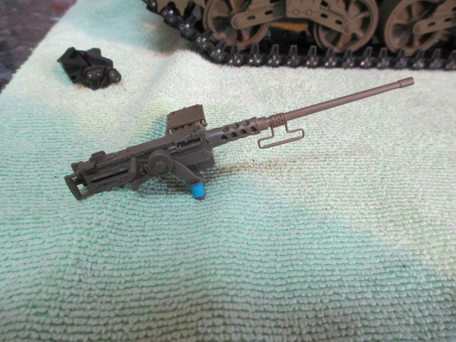

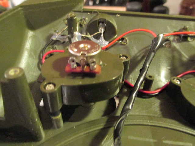

Tonight saw some things done and checked off of the build list. To begin with, I removed a link from each track and corrected the excess slack I had noted the night before. After that I used a small section of shrink-to-fit tubing and got a nice fit for the Tamiya .50 cal in the Mato loader's hatch pintle mount. After that, I drilled the idler wrench mount and made a small handle for it (as I had threatened to do earlier on) Lastly, I tackled the installation of the sound pot from Immortal Hobbies. Pictures:

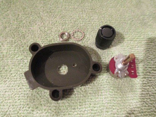

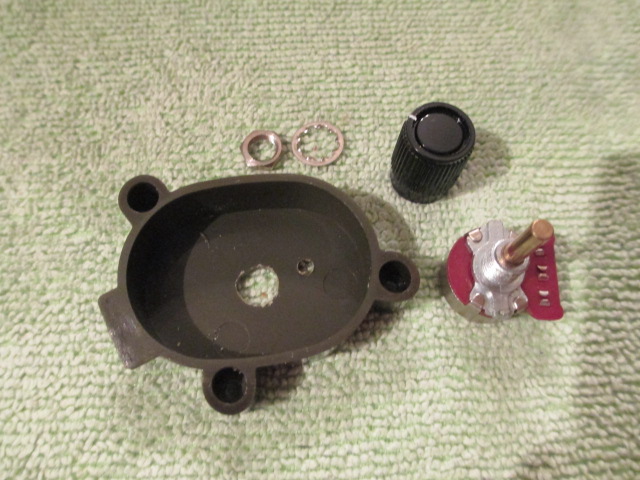

Assemble sound pot through insert with washer and nut then attach the knob
Assemble sound pot through insert with washer and nut then attach the knob.JPG (96.34 KiB) Viewed 4074 times
Drill a center hole to fit the threaded sound pot shaft and drill a smaller hole to the side for the placement stay to insert.

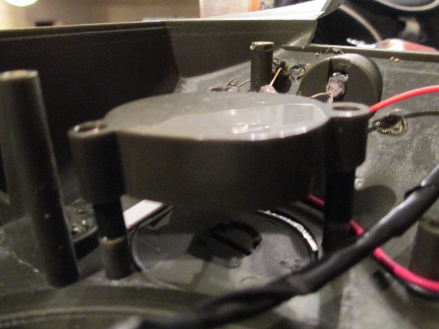

Glue the open end of the tubes down over the brass stiffener rods.  Replace the screws in the hatch insert to hold it in place
Glue the open end of the tubes down over the brass stiffener rods. Replace the screws in the hatch insert to hold it in place.JPG (93.93 KiB) Viewed 4074 times
Cut to size and insert, not glue, rubber tubing  in the screw holes in the hatch insert.

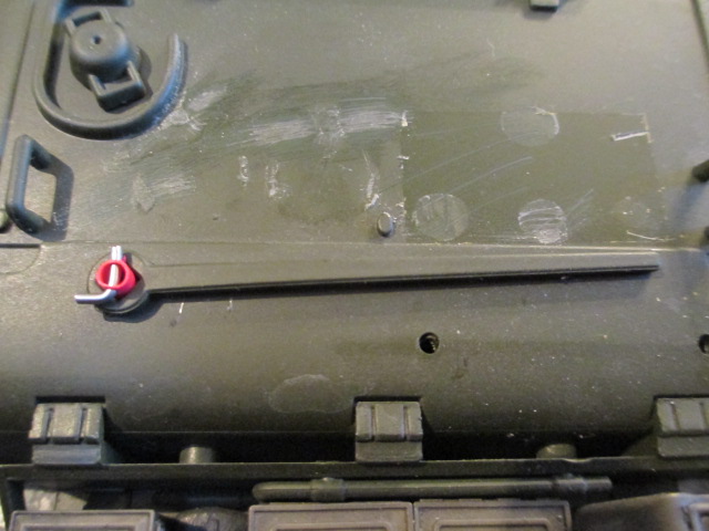

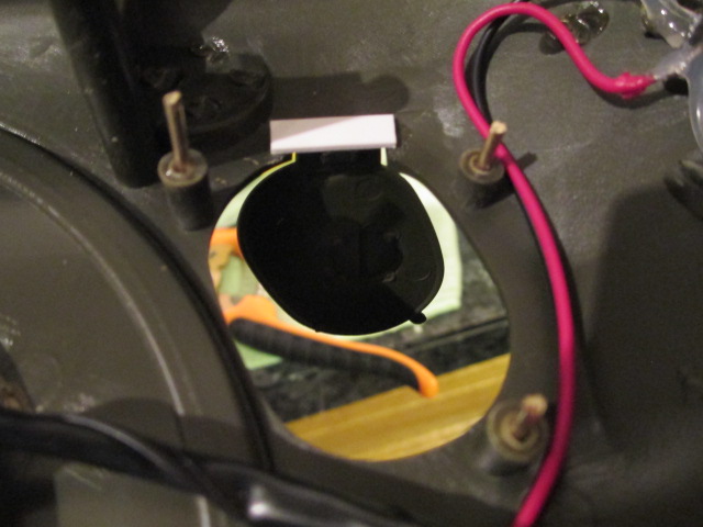

Cut a piece of flat plastic and carefully glue to replace the hinge stay.  Cut 1 16 brass rod or sprue to size and glue in place
Cut a piece of flat plastic and carefully glue to replace the hinge stay. Cut 1 16 brass rod or sprue to size and glue in place.JPG (88.52 KiB) Viewed 4074 times

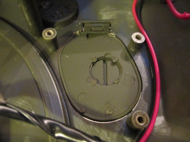

Undo three screws and remove the molded insert.
Undo three screws and remove the molded insert..JPG (92.34 KiB) Viewed 4074 times
Hull hatch insert is too shallow to fit a proper sound pot
Hull hatch insert is too shallow to fit a proper sound pot.JPG (92.16 KiB) Viewed 4074 times

Shrink to fit tubing provides a sizing collar for the Taniya mg to Mato pintle mount
One link removed, track slack corrected

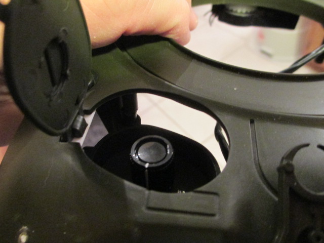

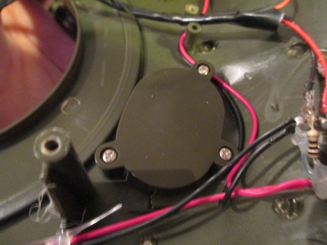

Easy to access and adjust sound now through the Radioman's hull hatch
Easy to access and adjust sound now through the Radioman's hull hatch.JPG (87.19 KiB) Viewed 4074 times
Sound pot installed and ready for wiring
Make sure pot is aligned so minimum volume marker on the knob is in front and easily seen.
Make sure pot is aligned so minimum volume marker on the knob is in front and easily seen..JPG (95.4 KiB) Viewed 4074 times

Your re-installation of the sound control through the RO's hatch is very classy! I'm surprised that there was room above the motors for it all to fit there. Nice work!!
Posts: 7863
Re: Crazy Joe's Sherman Rehabilitation
Good Morning, Sassgrunt,
I considered that as well, sir. You can see that in the next to last photo of the completed install, I have shortened up the rubber 'legs' by a 1/4 inch. There was plenty of clearance between the bottom of the pot and the gearbox but a little extra never hurts. ;o) The On\Off switch for the tank will go over in the Driver's hatch. The insert is deep enough so that no modification should be required there. Thank you very much! for the encouragement.
