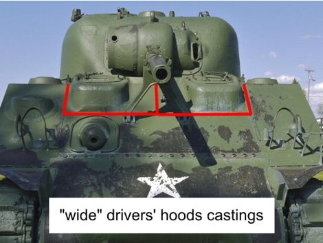

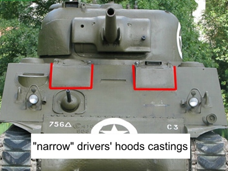

Ok ... got a really lame ..perhaps stupid question... I didn't like the positioning of my mantlet barrel flaps ....so I re did them last night ...Here's the stupid question... as it came up while I was doing them over.
What are those flaps for...?
They don't seem to serve any purpose...and on the earlier model are not there at all... even in the later model... they are non existent
the mantlet does "look" a lot better with them there... but it can't be the reason those flaps were put there
aesthetics ? it just can't be

Bullet Splash Shields, I suspect. ;o) Wiser Tankers will speak up, no doubt.

Perhaps a well meaning but poorly tested idea of protection from mantlet impact spall that could foul the main guns recoil or similar. By pporly tested I mean that most mantlet impacts on a Sherman resulted in penetration rather than impact deflection & spalling .
Could have been a method of machine processing post casting as well. Something to hold the raw casting on or with while the back of it was machined to fit the gun ,and processing the MG penetrations.
I feel we might never know.

they sure look good... even as functional handles and a stepping area to get up to the turret...but there is nothing written or that I could find anyway .. saying it was or wasn't just an aesthetic feature lol

I don't have a complete answer for you but I do have a partial one. I went to Hunnicutt's book on the Sherman, which is pretty much the reference for things like this. For starters, I found out that I have been calling things by the wrong name, all this time. The main gun shield (what I always thought was called the rotor shield), served as the front plate of the turret. A rotor shield (what I always thought was called the mantlet) was added to prevent small arms fire from scarring the rotor surface and locking it against the main gun shield.
As far as the 'flaps' go, the original rotor shield for the M34 mount (that's the skinny one in your picture), did not have the flaps. It doesn't say when they were added or for what purpose, but they were there on later production M34 mounts. Later, they transitioned to the wider M34A1 mount, (which was built to better protect the direct sight telescope and the machine gun), the 'flaps' were always seen on this mount.
I suspect, as others have said, that they were either a guard, or a counterweight for the gun. They weren't used on the later T80 mount (that's the one on the Mato M4A1) or on the 105mm Sherman. The British conversion to the Firefly used an entirely new gun shield and rotor shield, and this mount did not have the 'flaps' either.
So it looks like you are right to have them on your build. (But now, I need to go look at my M4A2 build and see if they should be there or not. It's always something....) -Mike
