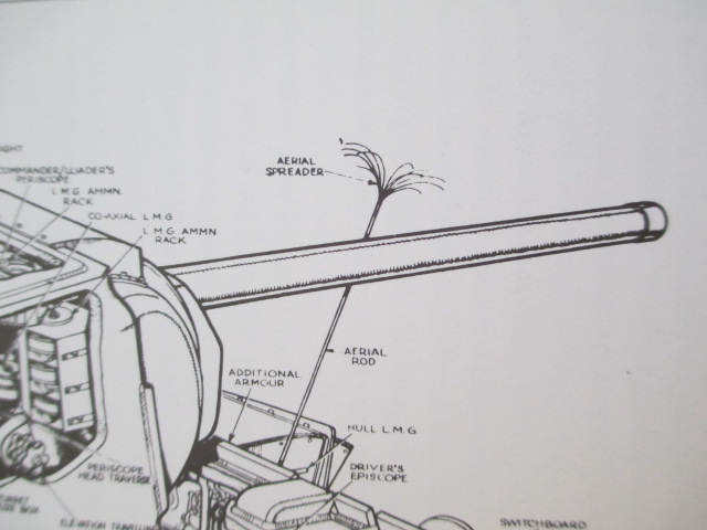

That's some jaw dropping work there, Pale. I love the bullet hole in the headlight! Fenders definitely look like some Sov tanker took it through a building once or twice. The antenna in front would just be cosmetic if you use the Fix that Alpha is using. Here is what I have found on what the front antenna looked like: (Note the forward angle to clear the gun tube and spreader to give the short aerial more range)
P.S. The illustration is from my Vanguard book, #24 Soviet Heavy Tanks by Zaloga and Grandsen

Thank you for the reference Painless. I think I am going to try a stock location with auxiliary one in the hull or in metal tool box on fender. Lots of great input. Thank you.

Hello Painless... my antenna is left functional... in the case of reception I have more faith in redundancyPainlessWolf wrote:Good Morning,
Re: KV-1 on the bench
Hi Palepainter... yeah those boxes are perfect... only problem is they are ...in composition... very close to lead.. an insulating material....so you might want to get some scrap copper... flatten it out cut it to fit inside your boxes then solder wires to them (if you are going to do them in tandem)...the internal ones I've read about here aren't as efficient as the helicopter wire I used ...I tried .... once the hull is closed.... you lose about 20% of your range..compared to having the upper hull offpalepainter wrote:Thank you for the reference Painless. I think I am going to try a stock location with auxiliary one in the hull or in metal tool box on fender. Lots of great input. Thank you.
But it does work
GOOD LUCK
