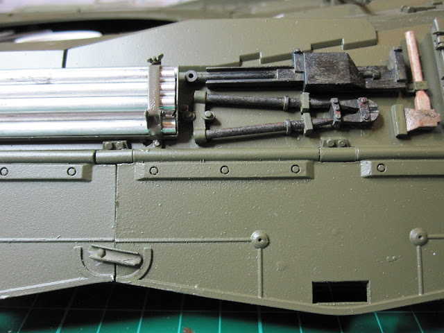

Painted and fitted the tools.
Had to make some minor adjustments due to the larger size of the PE cleaning rod holder.
