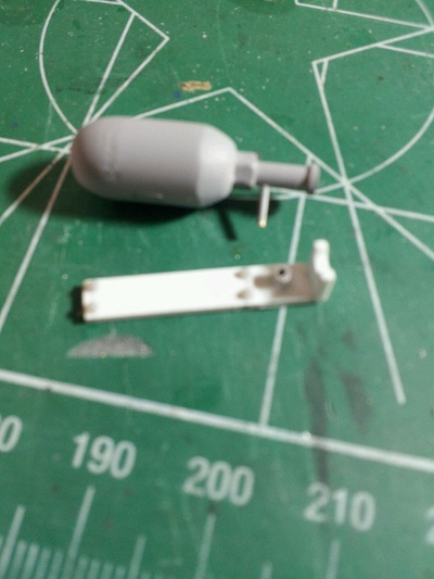

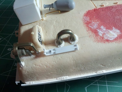

I needed to duplicate the fire extinguishers used on British armor, which was difficult because there are few references to the bottle shape or size and they are missing from the Arberdeen vehicles. Finally, I found one to scale from. So this is my rendering. I also produced the bracket and the strap that holds it will be made from lead foil and .015 brass rod when they are mounted. The bottles, as mentioned were made from plastic shapes. Tube, hex rod and .28 brass rod and a bit of miliput. To get the round ends i chucked it up in the drill and with a wet finger I used the drill to make them uniform. Similar to using a pottery wheel.

Extinguisher on bracket
Extinguisher and Bottle on bracket.jpg (32.98 KiB) Viewed 4501 times

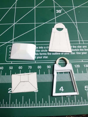

I needed to make the gun crutch and the armor that covered the bow machine gun position. I used sheet plastic and scaled the parts from 1/35 plan drawings. I drew the patterns out, laid waxed paper over them and assembled the gun crutch. Similar to building a wooden aircraft.

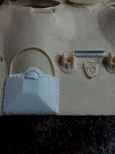

Here I have mounted the bow machine gun armor and the missing angle iron and have completed the welds.

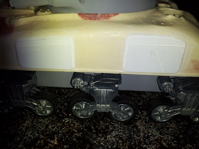

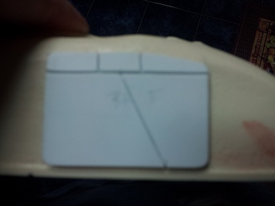

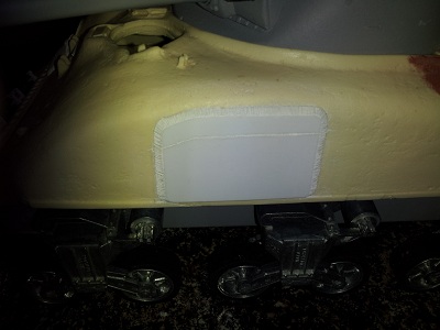

I made the applique armor with sheet plastic. I used a scriber to make the upper portions bend to confirm to the curve of the armor, then the usual miliput for the welds.

Left side armor add on
Left side armor.jpg (33.72 KiB) Viewed 4499 times

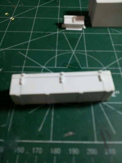

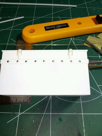

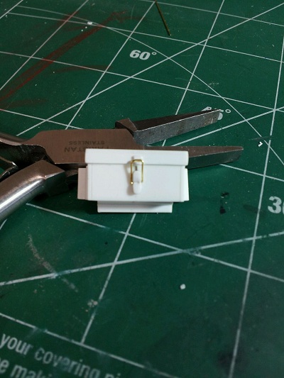

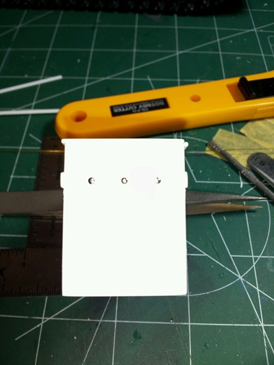

I fabricated the rear deck storage box, first aid box and the turret storage from sheet plastic, .015 brass rod and straight pins. I was trying to figure out what I'd use for the rivets that held the middle strap on, the pin heads made great rivets. Improvise, overcome and adapt! Anyway, simple "gizmatology" worked out. The latches I filed into shape to give them the appearance of the flip style units and the hinges were simply made with .035 plastic rod that was measured and cut with a razor saw.
Turret Storage Box Side View
Turret Box Side.jpg (54.88 KiB) Viewed 4497 times
Turret Storage Box
Turret Storage Box
Storage box turret.jpg (63.54 KiB) Viewed 4497 times
First aid box
First aid box
First aid storage box front.jpg (67.01 KiB) Viewed 4497 times
Rear deck storage box
First aid box.jpg (47.01 KiB) Viewed 4497 times
