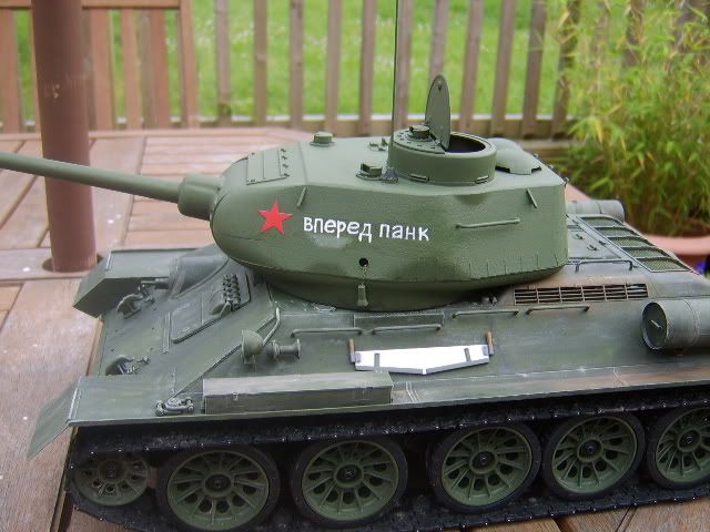

86 gets my vote as well (funnily enough same as my T34 8O )

:thumbup: :thumbup: :thumbup: :thumbup: Ooh , Nice '85 ! I'm quite fond of the T34 - the lines of the 76 version are especially appealing . Who knows , meybe a Trumpy one might fall into my sticky paws someday , it's a pity MSW seem to have stopped it . . . .
