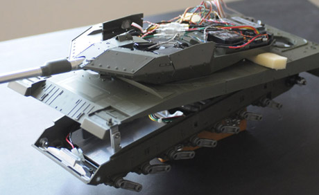

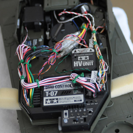

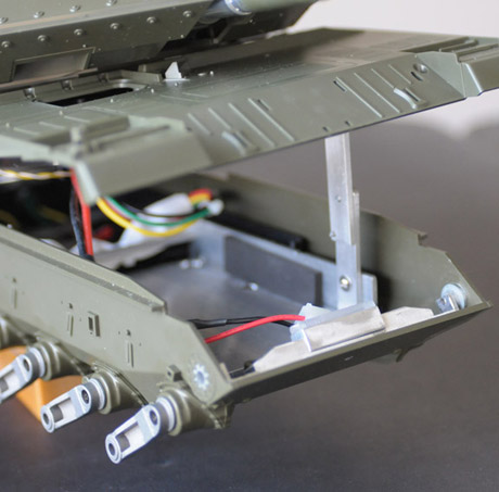

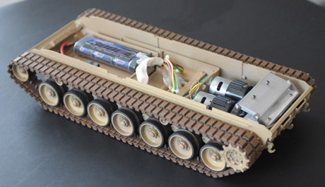

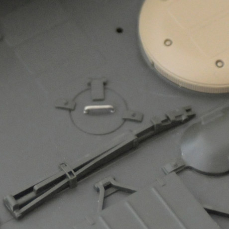

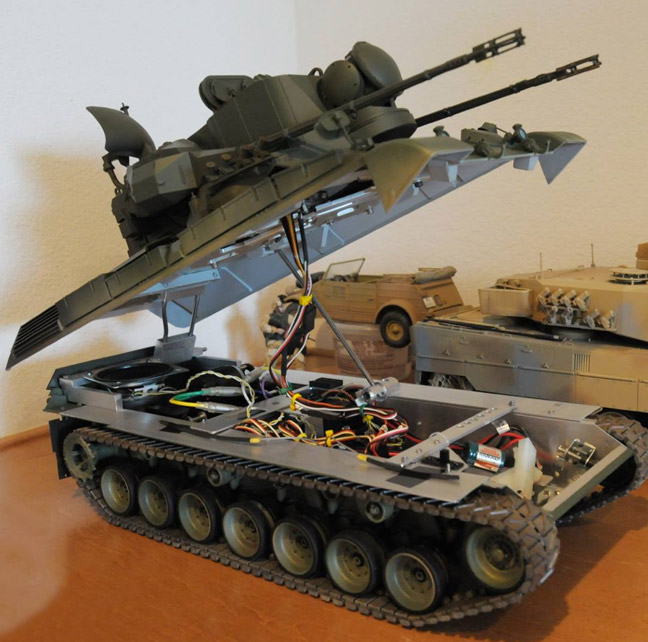

Daryl Turner converted Tamiya's Flagship RC Tank Model model kit's hull, using his famous metal working design and fabrication skills, to relocate the battery from the turret; brace the hull and create a clam shell deck lift system for accessing the battery. Turret base sagging & catching on the rear deck; under the 7.2v battery weight; is no longer an issue.
I assembled and painted the kit following the Daryl's work. The model is designed to be relatively easy to service and maintain.
A Danish Army Afgan Deployed "Desert Leopard" Main Battle Tank was referenced for the camouflage treatment.

Daryl Turner, Impact & AFV custom parts & features:
• Battery relocated to the hull.
• Custom built metal hull + idler bracing.
• Custom battery metal tray + hull brace.
• Gearbox mounted deck lifting hinge for easy tank battery access.
• Impact metal suspension arms.
• Impact road wheel bearings.
• Impact metal idler assembly.
• AFV metal turret baskets.
• AFV small metal handles.
• Hinged rear turret access panel for the DMD On/Off Switch.
• Nicely routed turret wiring.

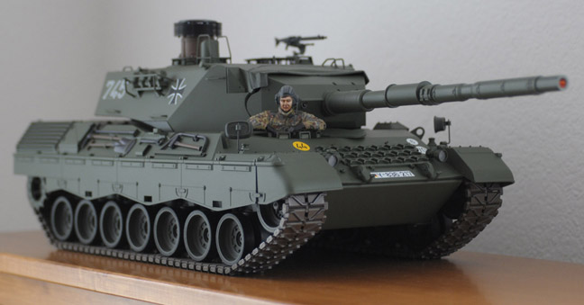

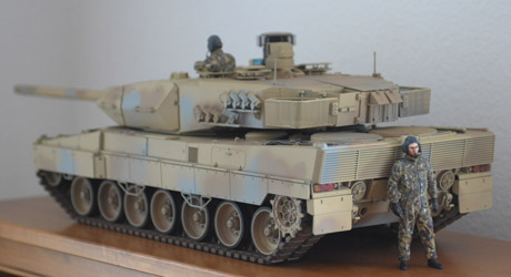

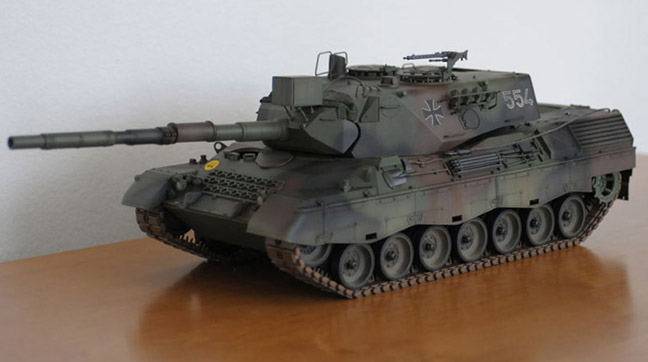

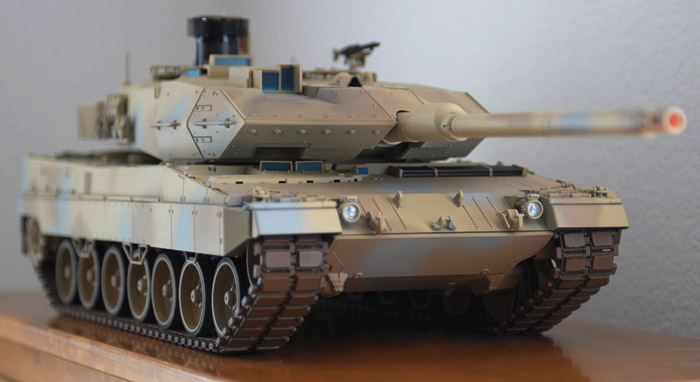

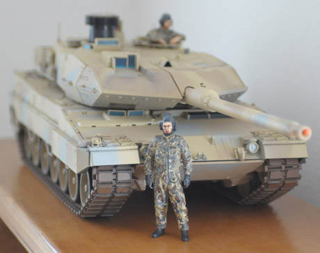

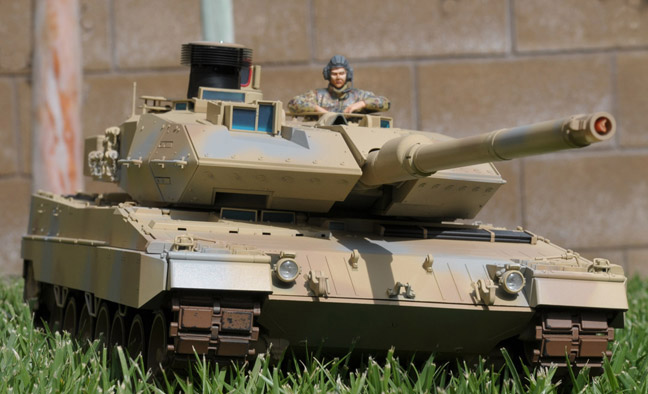

This completes the Leo trio build: the Danish Army Afghan Tamiya Leo 2; the 1970's Bundeswehr West German Army Leo 1A4 (full option) and the 1980's NATO Leopard 1A4 (semi full option).
Next up is a 7 channel Tamiya Gepard Flakpanzer.
Enjoy, John
1980's NATO Leo 1A4.
Late 1970's Bundeswehr West German Army Leo 1A4.
Danish Army Afghan Leo 2.

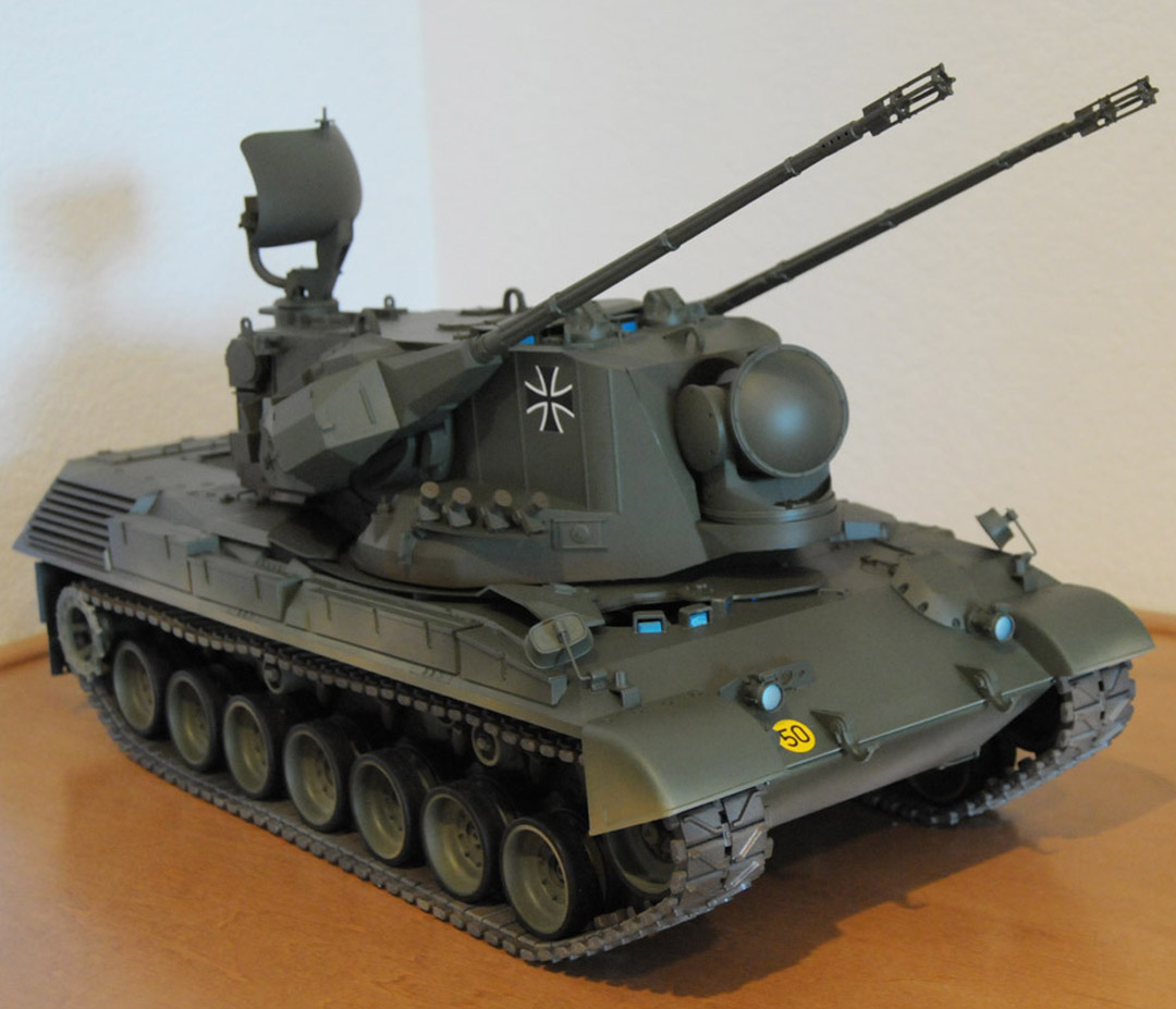

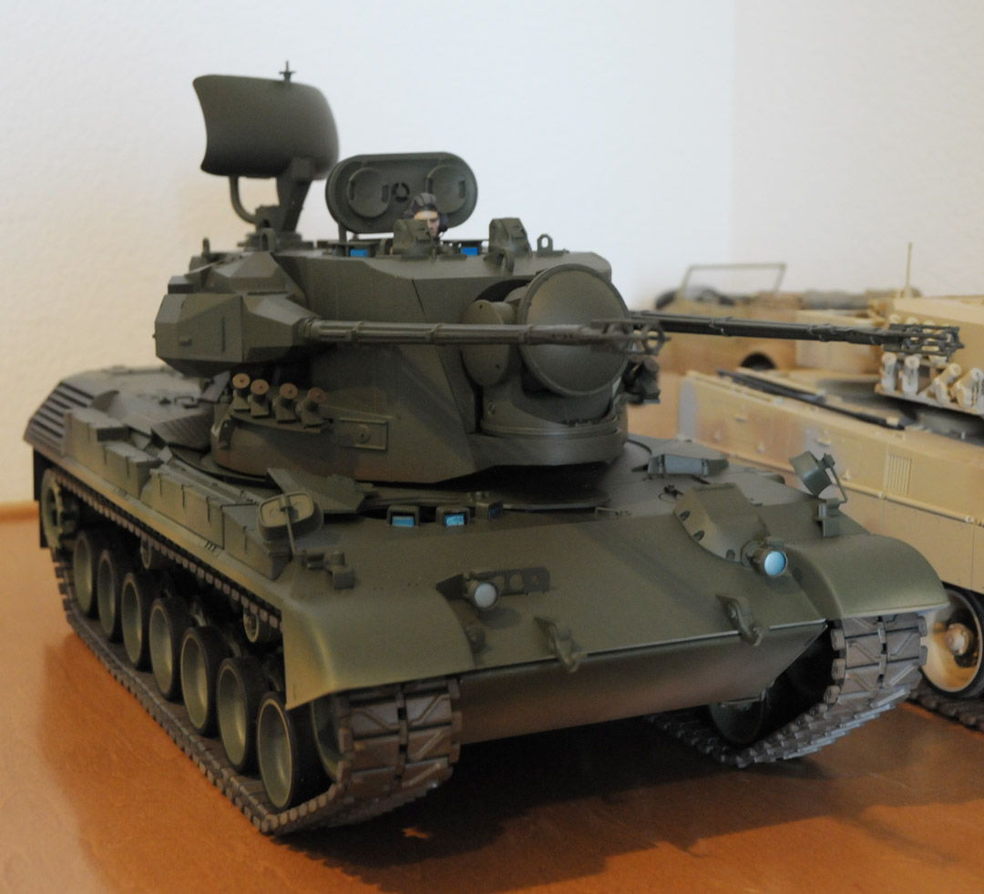

Tamiya Full Option Gepard custom one off model.
