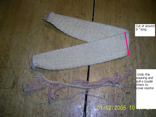

You're gonna have a hard time to find a kevlar wick the dimmensions you need ...
I bought a flat ribbon of kevlar on e-bay , cut a piece about 8 inches long ; undone the weaving to pull a couple of strens to cover my resistor ....
That will last me a life time ...
http://cgi.ebay.ca/Kevlar-Wick-50mm-fir ... tem2a11924" onclick="window.open(this.href);return false;
