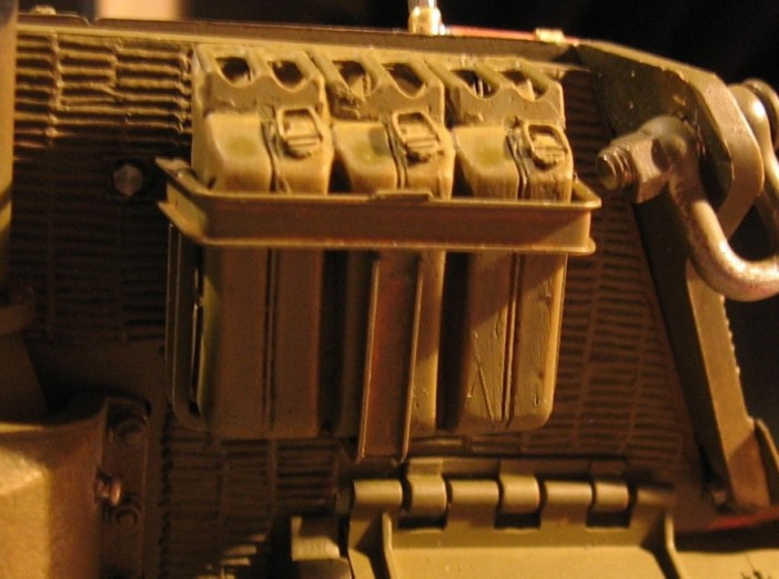

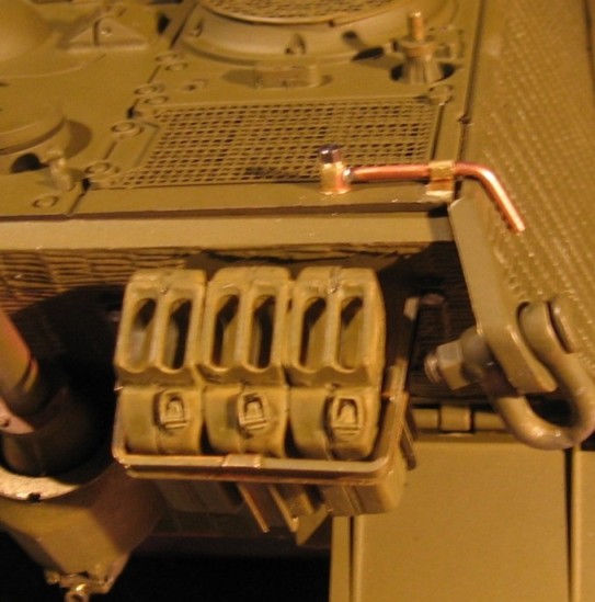

some detail work:
I found a few net pics that show rear bulkhead fuel can mounts in place of the block/box. These pics show the can mounts having the ability to hold 1 -3 'jerry' cans. I soldered up a brass unit for three because one vendor sent me a three can resin casting.

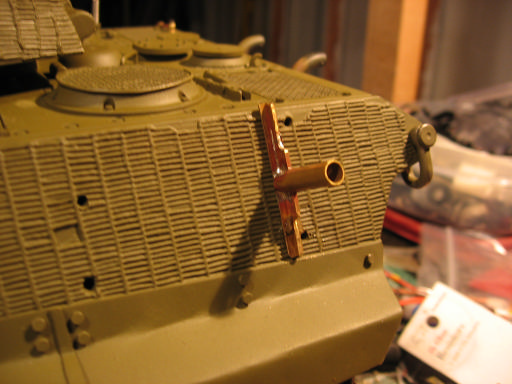

Also built a drain cock/compression fitting out of brass and a hollow copper drain tube. Some pics show a second fixing device on the tube..some do not have this.

Re: Matorro King Tiger w/ Tamiya-HL upgrade
Really nice work xrad! I like the jerry can rack, I think they look great on German tanks. It hints at the desperate fuel shortages in the German army.
I can't wait to see more!
Thanks, GM! these are obviously not factory items, but placed on in the field. I like the modelling freedom of adding these items pretty much any way you can.
For example, most likely, shape could be for any type or number of containers. Common being common, I went with the J-cans. I did bolt the rack in place(because I have a bunch of small bolts), but most likely, it would be welded on.....

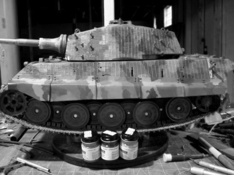

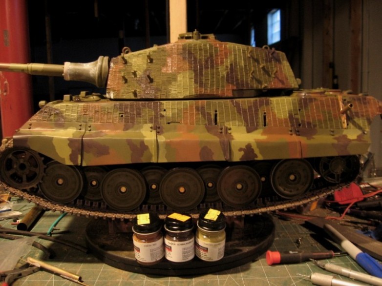

Cammo....any thoughts?
dirt red, panzer yellow, dark brown (testors German yellow and brown) over olive drab (testors). The cammo paints are thinned with 25% alcohol so that they flow into nooks and the color is washed out a little. Coat of testors dull spray..not quite dry...
I only did this side to see how it comes out.
