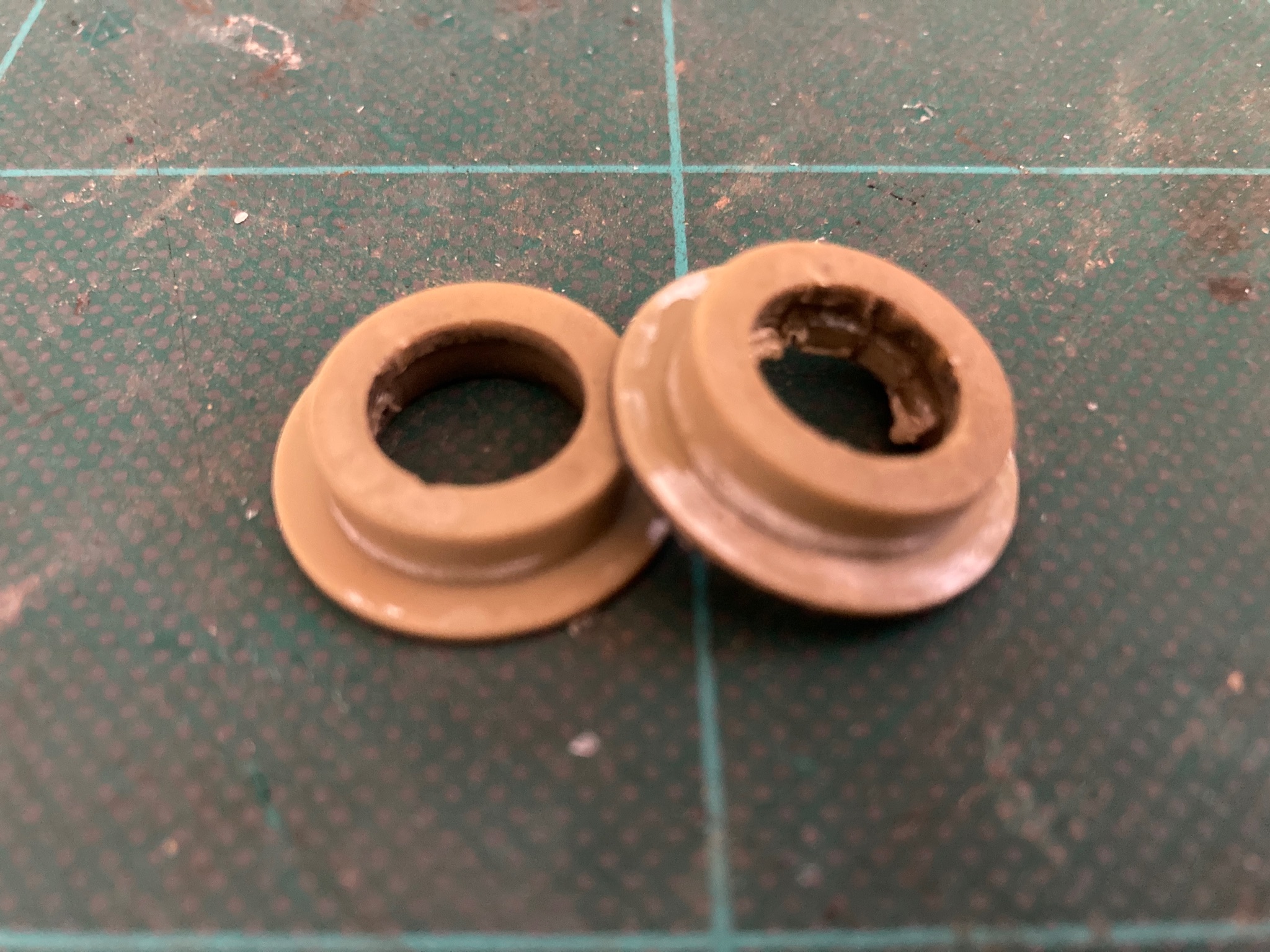

Re: Heng Long Challenger 2. Plastic Axle Bearings.
I wanted to remove the plastic bearings that came in the tank - and like everything else on my particular Challenger 2, they had been glued in!
These plastic bearings had already suffered some surface damage when I had to lever the metal drive sprockets off of the axles (also super-glued on!) so I wasn't too worried about chewing them up any further as I tried to remove them.
A bar was inserted into each bearing as I worked my way around gently levering the bearing (from the outside) to see if I could detect any movement - and I thought I could see and feel some "slight movement" to suggest that the bearing had not been glued in with as much superglue as some of the other parts that I had trouble removing - but they were also too well fixed to be removed using this method as the sides of the chassis were bending and moving more than either of the axle bearings!
Given the above "semi-encouragement" of thinking that I may have detected some movement, I decided to use a larger bar placed against the inside of the plastic bearing and punch it out. I supported the hull on the outside so that only the bearing would be free to move and gave the bar a quick sharp tap - and the first bearing came out with no more trouble!
The second plastic bearing extraction soon followed with no damage to the hull, and the freshly exposed sockets looked clean enough to press in a pair of ball bearings without any "cleaning-up" being needed. I reasoned that the less than perfect super-glue stained surface of the socket would give a nice "texture" to help retain the ball bearings better then they would if I cleaned them up to give a nice smooth shiny surface!
- Plastic bearings eventually removed !

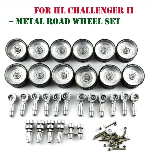

Re: Heng Long Challenger 2. Metal Drive Wheels.
The plunge has been taken and a set of metal drive wheels to fit this Challenger has been ordered from Andrew at HAYA.
My reasoning is that this Challenger has a set of metal tracks and drive sprockets, but the hard plastic wheels have no tyres on them so I prefer to fit a set of metal wheels with rubber tyres to run against the metal tracks...and they are ball-raced, so they should run smoother too.
This particular set of metal wheels is made for HAYA to their own design input and is not Heng Long brand. There are some additional alloy parts included that can (optional) replace the moulded-on parts that are detailed on the hull. I need to take a good look at this when they arrive and decide if I want to fit these options parts or not - apparently most buyers don't bother to fit them as the original shapes need to be filed off of the hull if the option parts are to be used.
- HAYA Alloy Drive Wheel Set for Challenger 2.

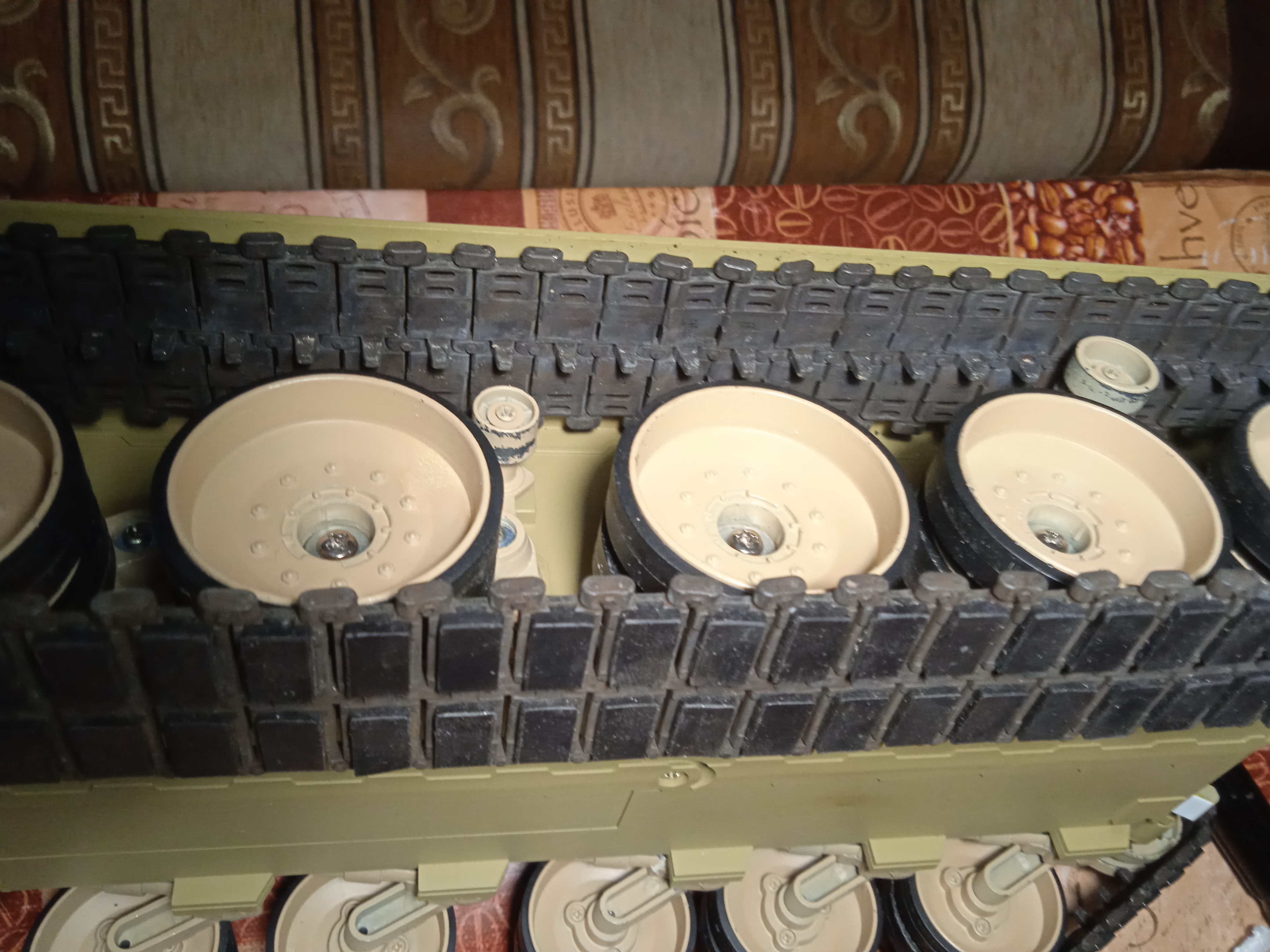

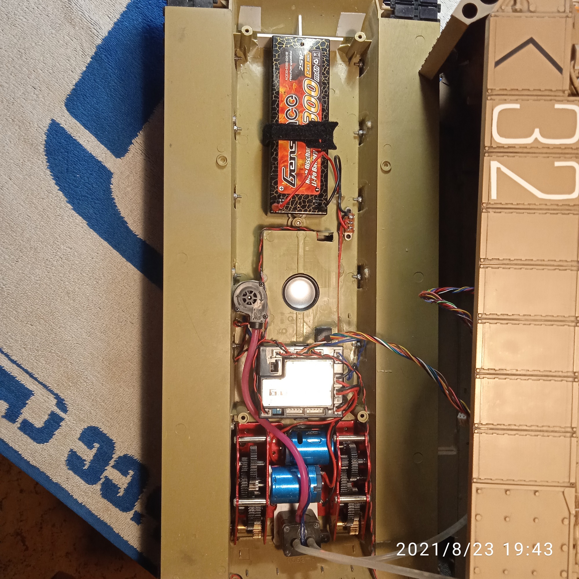

Re: Heng Long Challenger 2. Sprocket Problems.
I have the same set...
Everything fits perfectly inside the bathtub, the body does not bend, you have no reason to be afraid - this is unnecessary
- 1629737064249.jpg (1.21 MiB) Viewed 1292 times
- 1623088039079.jpg (2.63 MiB) Viewed 1292 times
Using the empty battery compartment as a speaker box is a good idea Pavel - very neat and tidy.
I also have 4 magnets in the places where the screws were, I just didn’t take a photo, like everyone does this, it’s corny...
I repeat, the body does not bend, the tracks do not fly off if they clearly land on the teeth of the wheel!!!!
