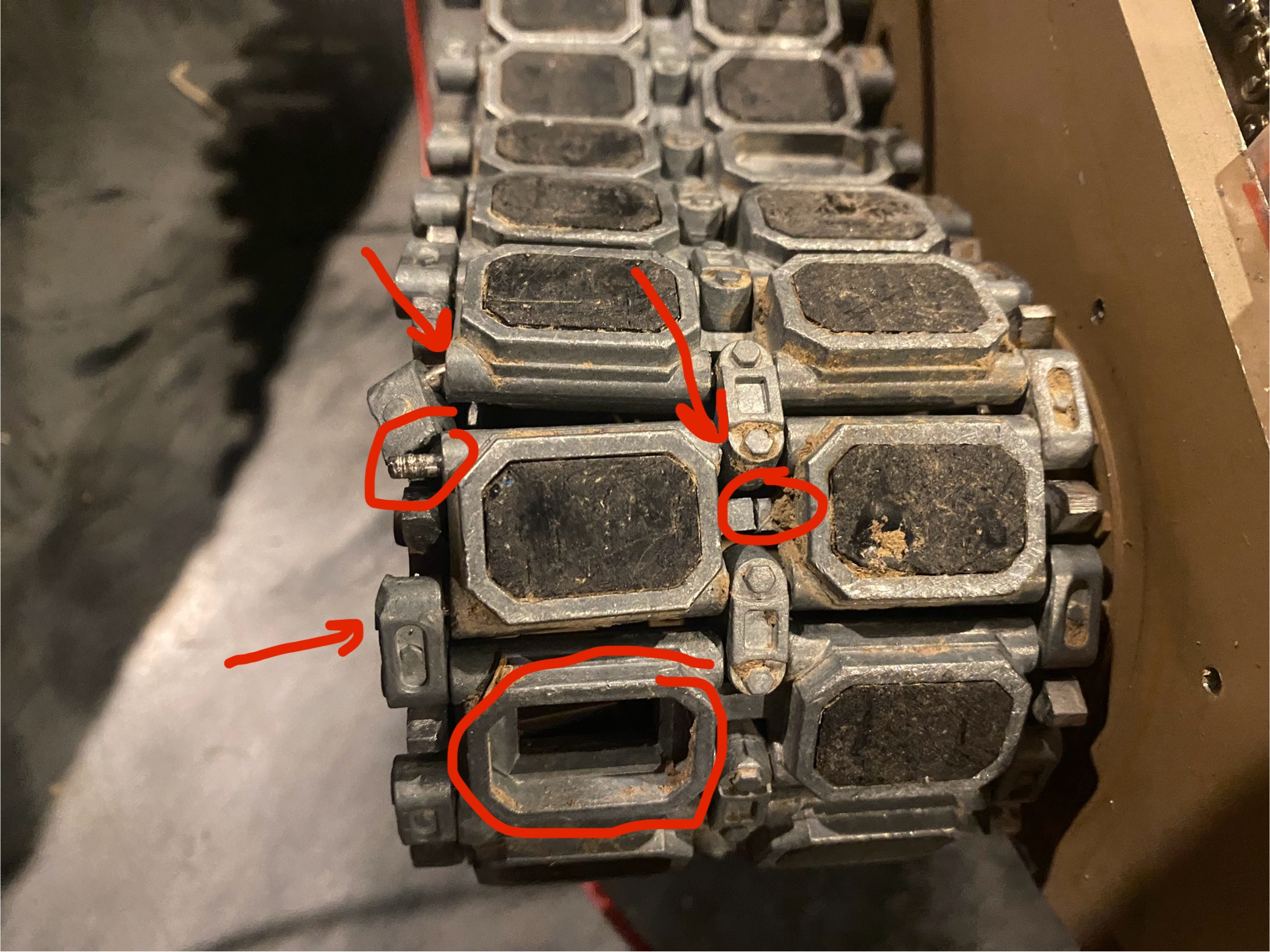

So, decisions were made, bad decisions.
Tried to drive it in 7-9” of snow. Tank sunk into the snow, the drive sprockets froze up. While I was trying to get the tank moving again I pushed it too hard, snapped one of the two drive chains.
Had to put it on my daughters sled and sled it back to the garage. Also found out I detracked both tracks, lost several track pads, and broke one of the track links, along with a couple of bent pins.
Thankfully they are sending me replacements of all the parts, only had to provide pictures of what was broken.
Pretty dumb on my part. The snow was almost up to the drivers hatch when it sunk down into the snow. Pretty sure real tanks wouldn’t be driving in that. Not sure why I thought this would be different.
