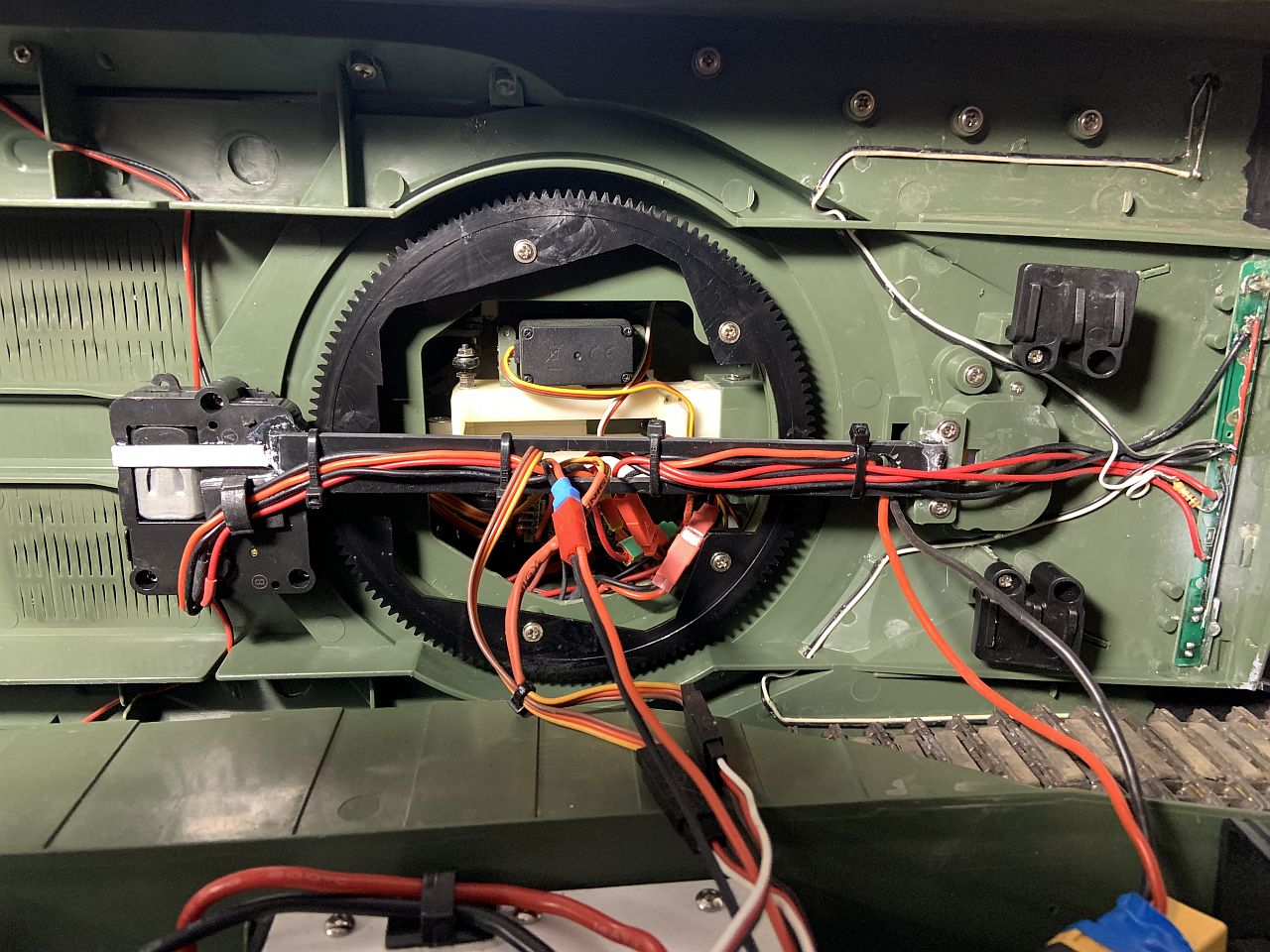

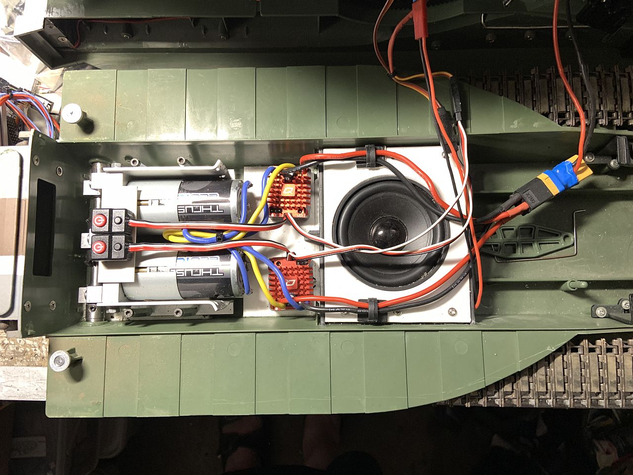

I have fitted 540 Type Motors in the HAYA chieftain,
but not with the original gearboxes ... :haha:
The loudspeaker housing is an integral part of the chassis and provides good reinforcement and torsional rigidity.
The control electronics (Open Panzer TCB) are installed in the turret.
