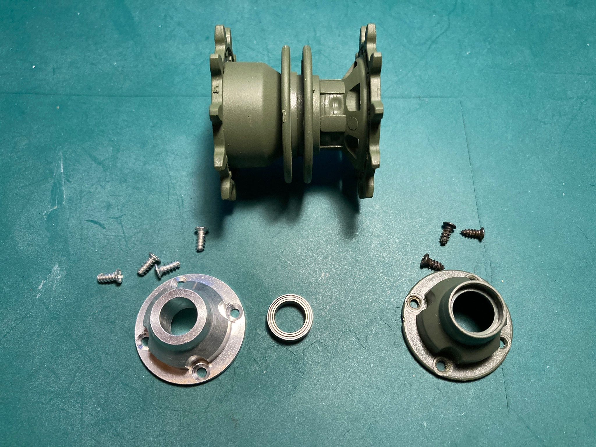

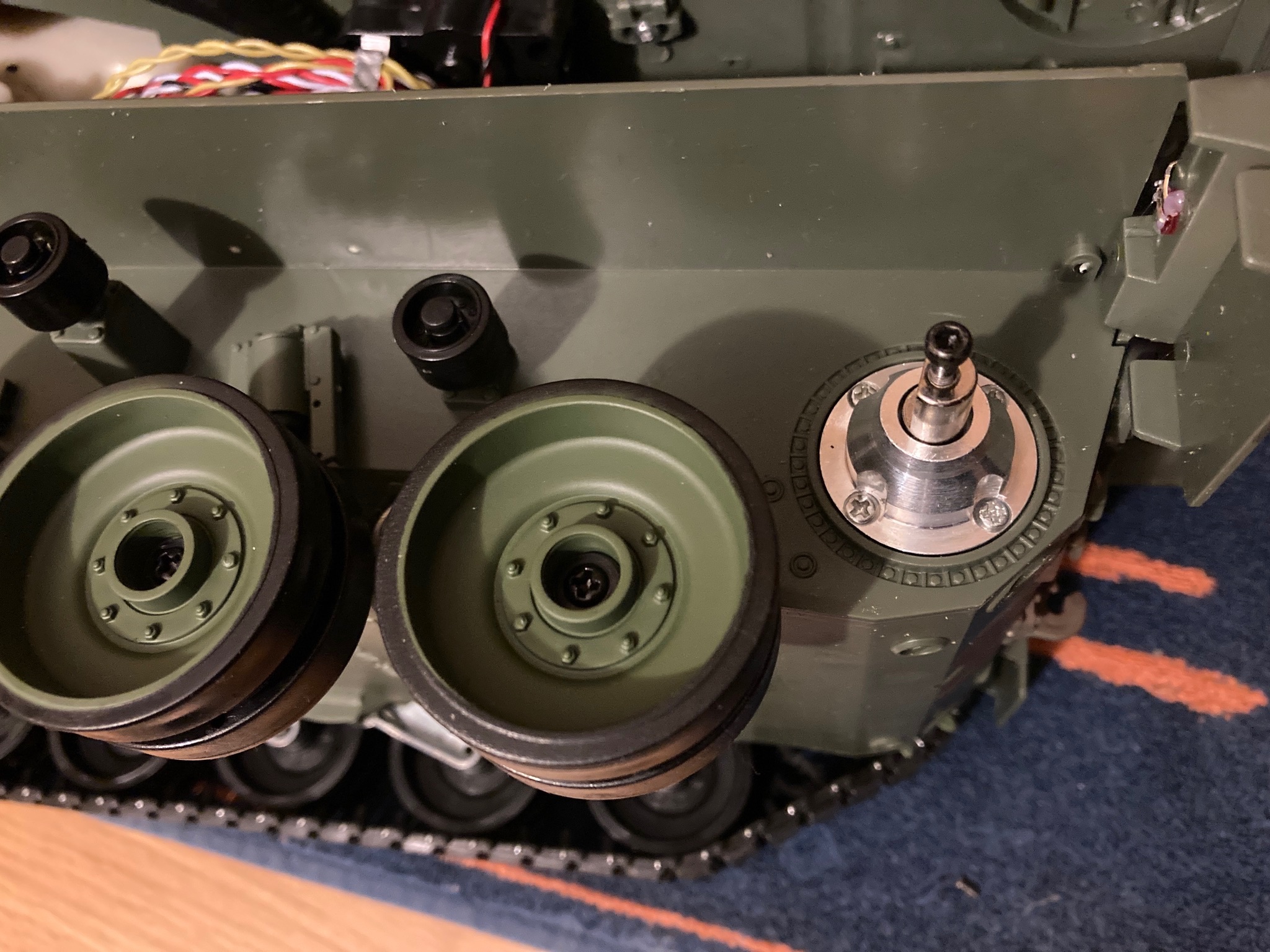

I added these alloy hubs with bearings to support the output axles in an attempt to extend the life of the plastic gearbox
I think I will need to replace the plastic drive sprockets with metal ones, but the plastic output housings might have held the ball bearings in a better position as they would be held further out than the alloy one that hold the bearing closer to the chassis.
Ideally the metal housing would hold two bearings - one in the outboard position (like the plastic housing position) and one inside (the way the metal housing is machined to take the axle bearing).

Those plastic gear box covers showed up on my last two HLs. They just snap on/off, and I'm sure they are an effort to keep dirt out and grease in.

Ecam wrote: Tue Apr 23, 2024 9:17 pm Those plastic gear box covers showed up on my last two HLs. They just snap on/off, and I'm sure they are an effort to keep dirt out and grease in.
I will take a look underneath those covers Eric, and maybe add some petroleum jelly to the gears if they are looking at all dry.
