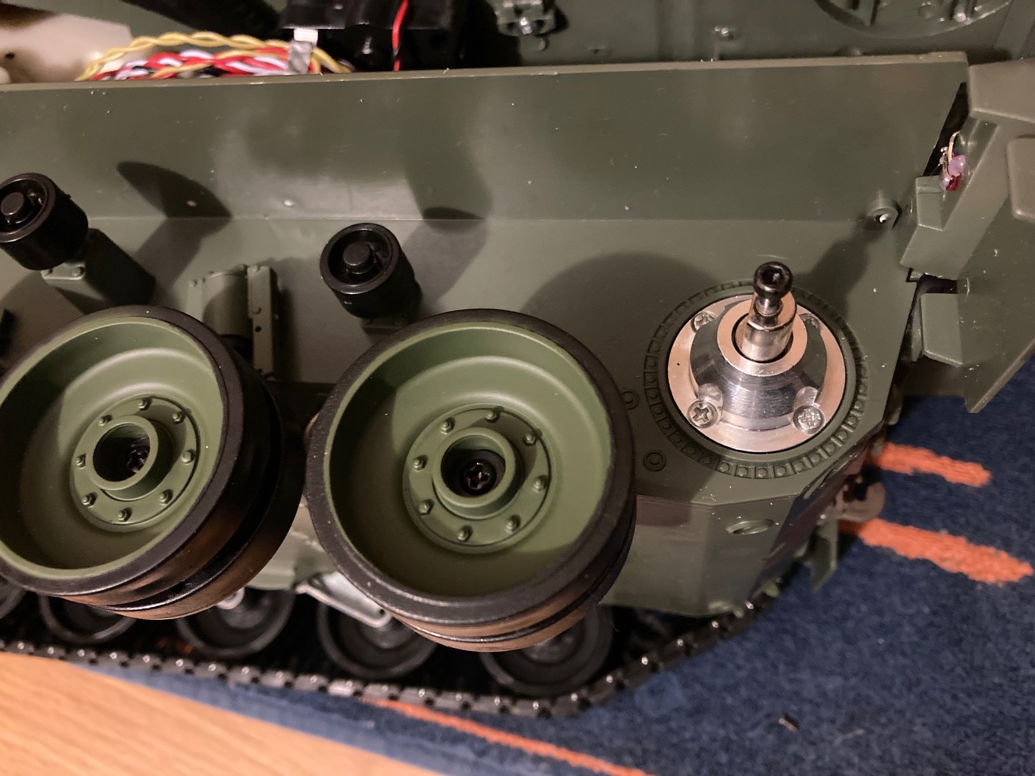

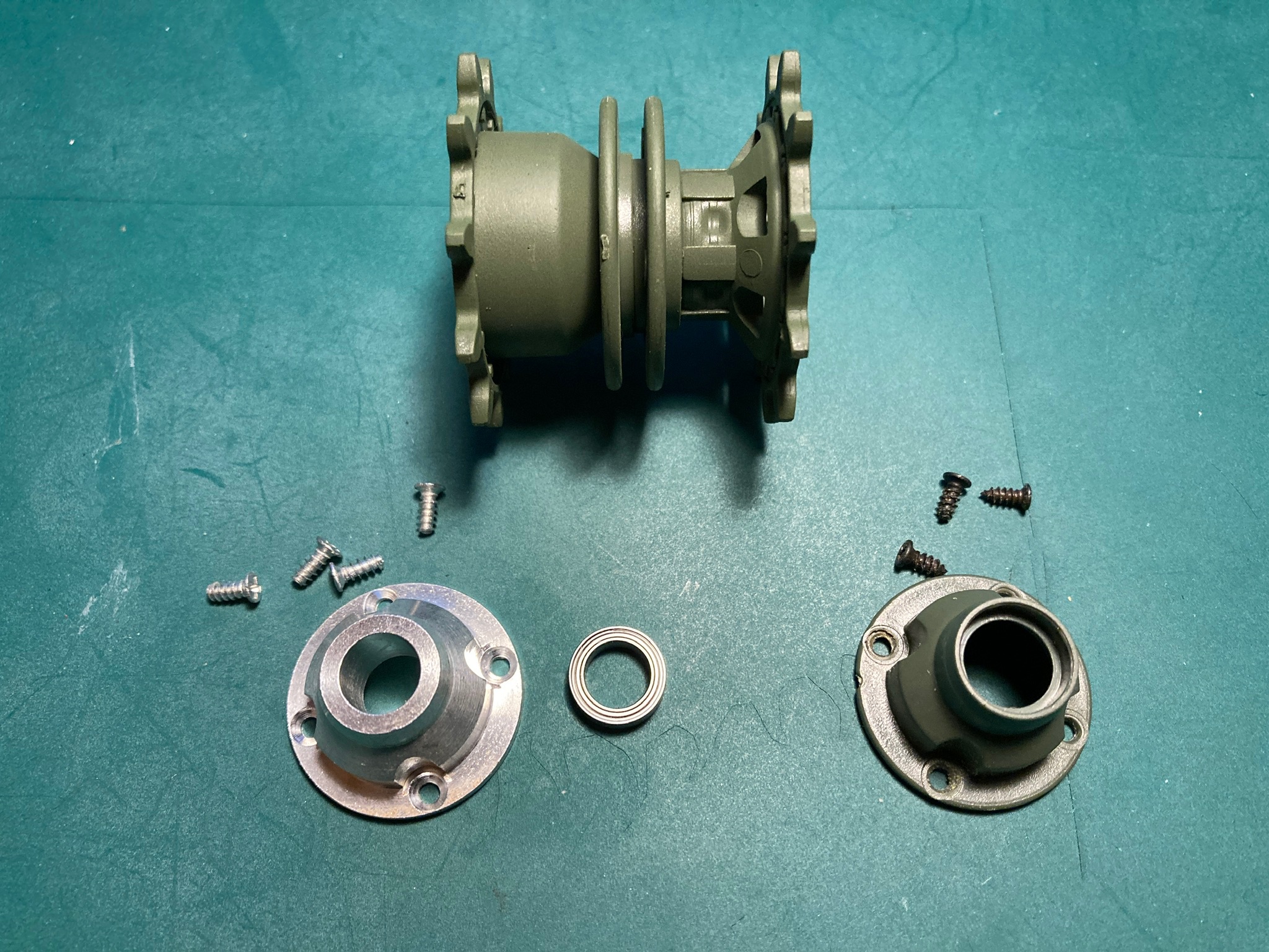

I added these alloy hubs with bearings to support the output axles in an attempt to extend the life of the plastic gearbox
I think I will need to replace the plastic drive sprockets with metal ones, but the plastic output housings might have held the ball bearings in a better position as they would be held further out than the alloy one that hold the bearing closer to the chassis.
Ideally the metal housing would hold two bearings - one in the outboard position (like the plastic housing position) and one inside (the way the metal housing is machined to take the axle bearing).

Those plastic gear box covers showed up on my last two HLs. They just snap on/off, and I'm sure they are an effort to keep dirt out and grease in.
Eric

Ecam wrote: Tue Apr 23, 2024 9:17 pm Those plastic gear box covers showed up on my last two HLs. They just snap on/off, and I'm sure they are an effort to keep dirt out and grease in.
I will take a look underneath those covers Eric, and maybe add some petroleum jelly to the gears if they are looking at all dry.

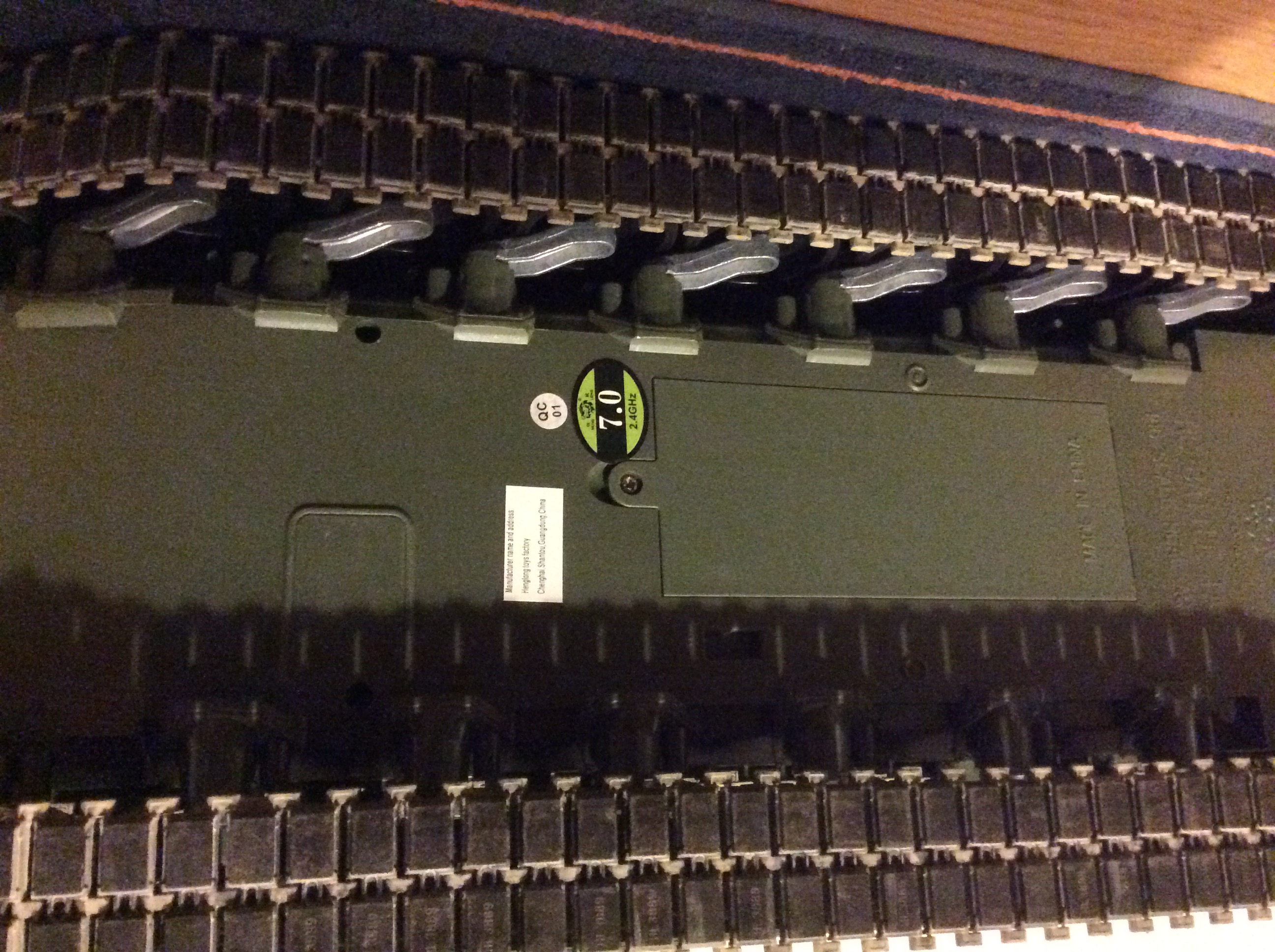

I have not even fitted any of the "add-on" bodywork parts yet, but I am already considering putting the LiPo in the turret. I really don't like turning the tank upside-down and having to use a cross headed screwdriver on a self-tapping screw every time I need to change a battery - and don't know how long the self-tapper will last with regular repeated use either!
Magnets on the turret top would make life a lot easier - and it would save my ham-fisted mitts from potentially damaging so many detail parts when I change the battery! I need to take a look to see how the turret comes apart and look at lengthening the battery wires and working out how and where to fit some magnets to hold the two halves together.
The small type LiPo batteries that I am using at the moment should fit easily inside the turret (they fit in my TAMIYA LEO 2A6 OK) and they don't weight very much and can be kept in place with Velcro......simples........I hope......:)
