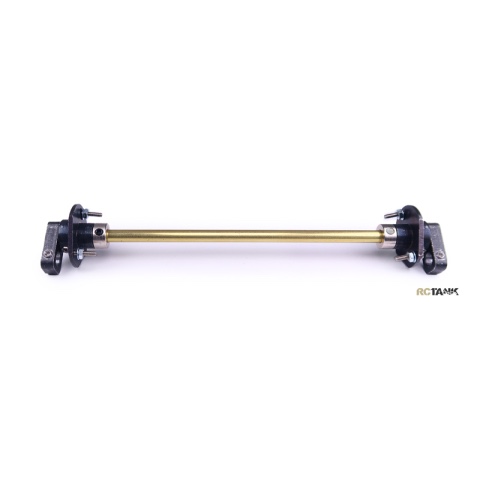

Tamiya Leopard 2A6 Track Adjusters.
My first Tamiya Leopard 2A6 is still running OK with the standard plastic kit tension adjusters, but it is getting plenty of use so I am looking to upgrade it with a set of metal tension adjusters.
The model already has the AFV metal suspensions arms and rcbearings ball raced axles, so I am hoping that fitting a metal tension adjuster will give it a bullet-proof drive train.
Searching the internet to find a good track adjustment system for my first Tamiya Leopard 2A6 I found this :-
It looks good and the most interesting thing about it is that it claims to be adjustable EXTERNALLY. If it works this would be a major advantage over any other type of track adjuster as the hull would not have to be removed to adjust the tension.
At a price of just under £52 including delivery to the UK is also looks like good value for money too as it includes ball bearings and axles ! See description below:-
Tamiya Leopard 2A6 - track tensioning system 1:16
With this system the tension of both chains can be adjusted separately and externally.
The set includes axles with double ball bearings for the tensioning wheels.
The components are made of steel / stainless steel, milled, turned and chromated to protect against corrosion.

Has anyone else fitted one of these systems to their Tamiya Leopard 2A6 ?

Looks like a Henntec to my untrained eye.
If so, the Henntec system is well respected and revered throughout the RC tank world as the best aftermarket tensioning system available, especially for Tamiyas, so if this is one, I advise to go for it.

Thanks Herman,HERMAN BIX wrote: ↑Tue Apr 16, 2024 10:34 am Looks like a Henntec to my untrained eye.
I have never heard of Henntec - but I have only recently returned to r/c tank modelling and still have a LOT to learn.

I liked the look of this tension adjuster when I saw it this morning and ordered one straight away!

Guido Henn was very helpful to me when I first started looking for metal arms for my Tamiya Leopard by giving me the link to AFV - I wish I knew then that he made the HennTEC adjustable arms as I would have bought one of his earlier..HERMAN BIX wrote: ↑Tue Apr 16, 2024 10:34 am Looks like a Henntec to my untrained eye.
I bought my HennTEC track adjuster from RCtank.de and their despatch was very fast and they communicated in English so they were good to work with.
Now that I also have the link to HennTEC. ( https://www.henntec.de/https://www.henntec.de) I can be aware of their product in the future.
