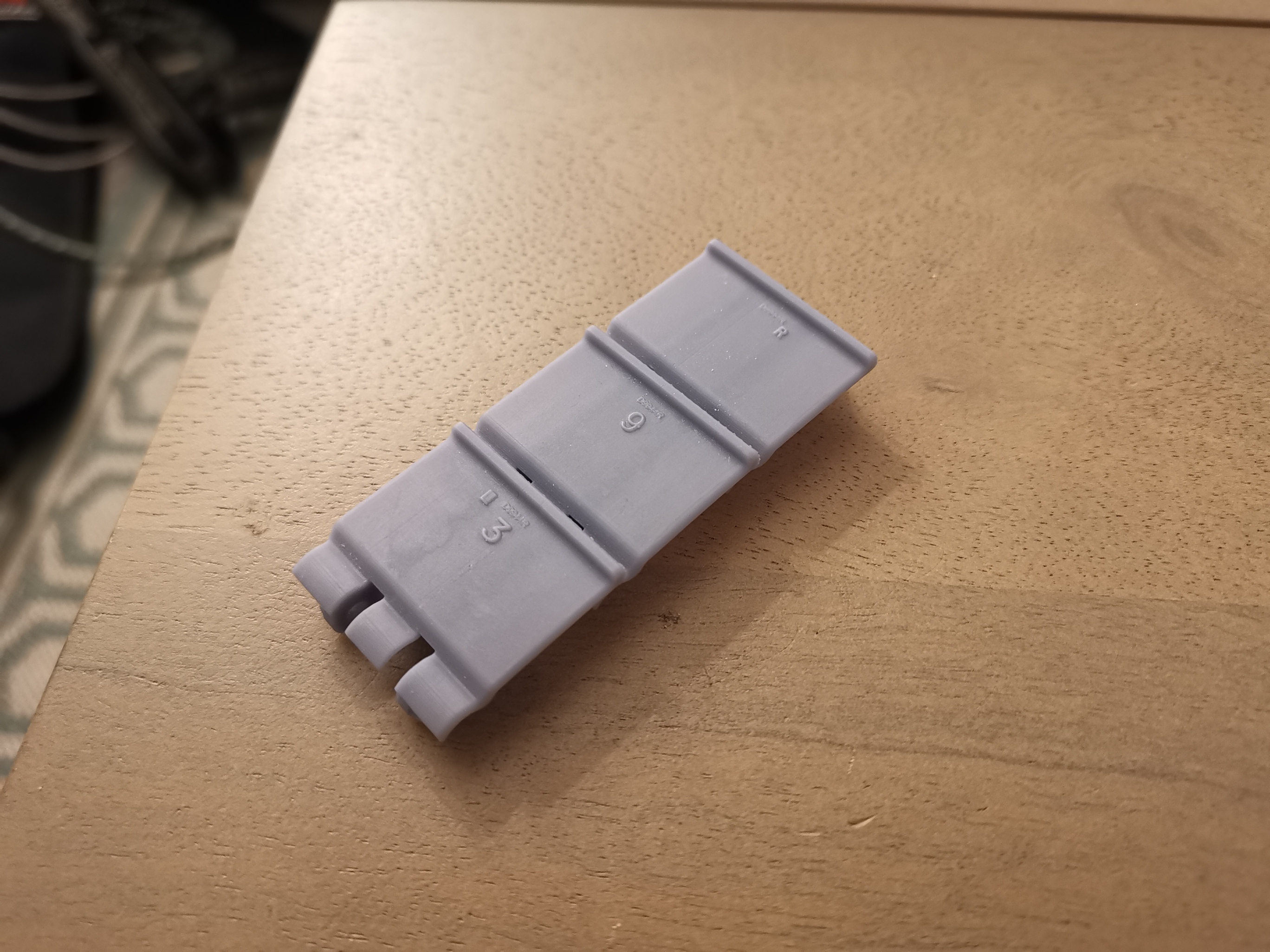

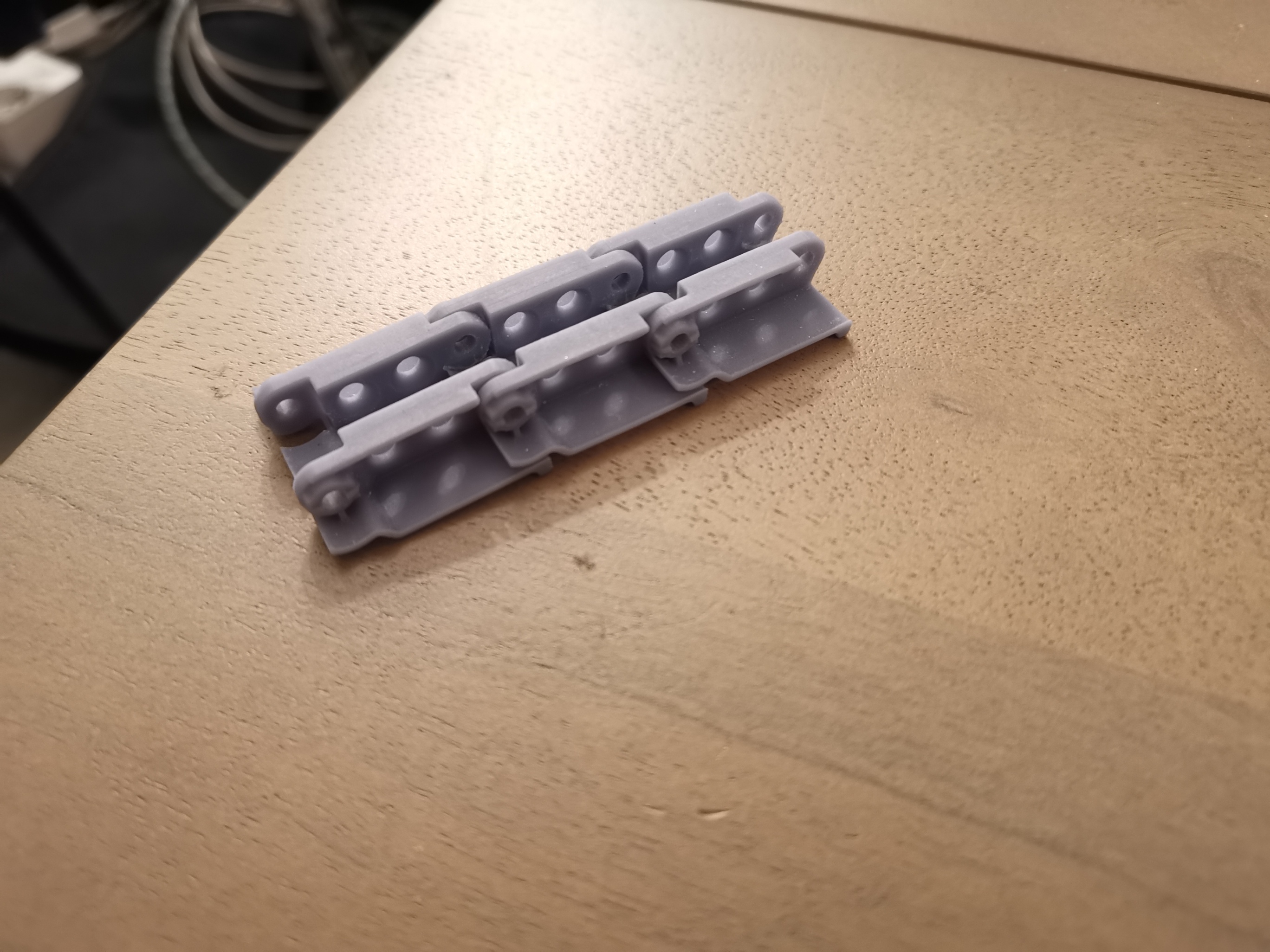

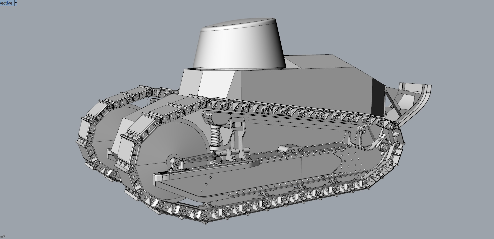

Hey Mike, mine will be 1/10 and it will be R/C but I'm just at the beginning of the project, still working on the 3D model :
I spent a lot of time on the track links, I'm finally happy with them (and with the nex resin). Of course I add to make the parts thicker than they would be to be stronger. This is the last version of the track links and they work well.
Thanks for the pic, now I understand better how the shoe was made. That's a lot of work just for one track link, I admire your patience and craftmanship. I wish I had your skills.

Your track parts look very impressive.
What do the raised numbers mean?
I've seen similar markings on preserved tanks.

MikeN wrote: Sun Jan 28, 2024 8:06 pm Your track parts look very impressive.
I think I'm alright for pictures. Thank you for the offer.
Thanks, not very impressive in comparison of yours !
I have no idea what those numbers mean, I guess they are casting part number/mold number/serial number. However I don't know if they were originaly on the French tanks or if they appeared when built under license by other countries (US and other). It's hard to tell on period pics are they are often not of very good quality or the track are full of mud.
