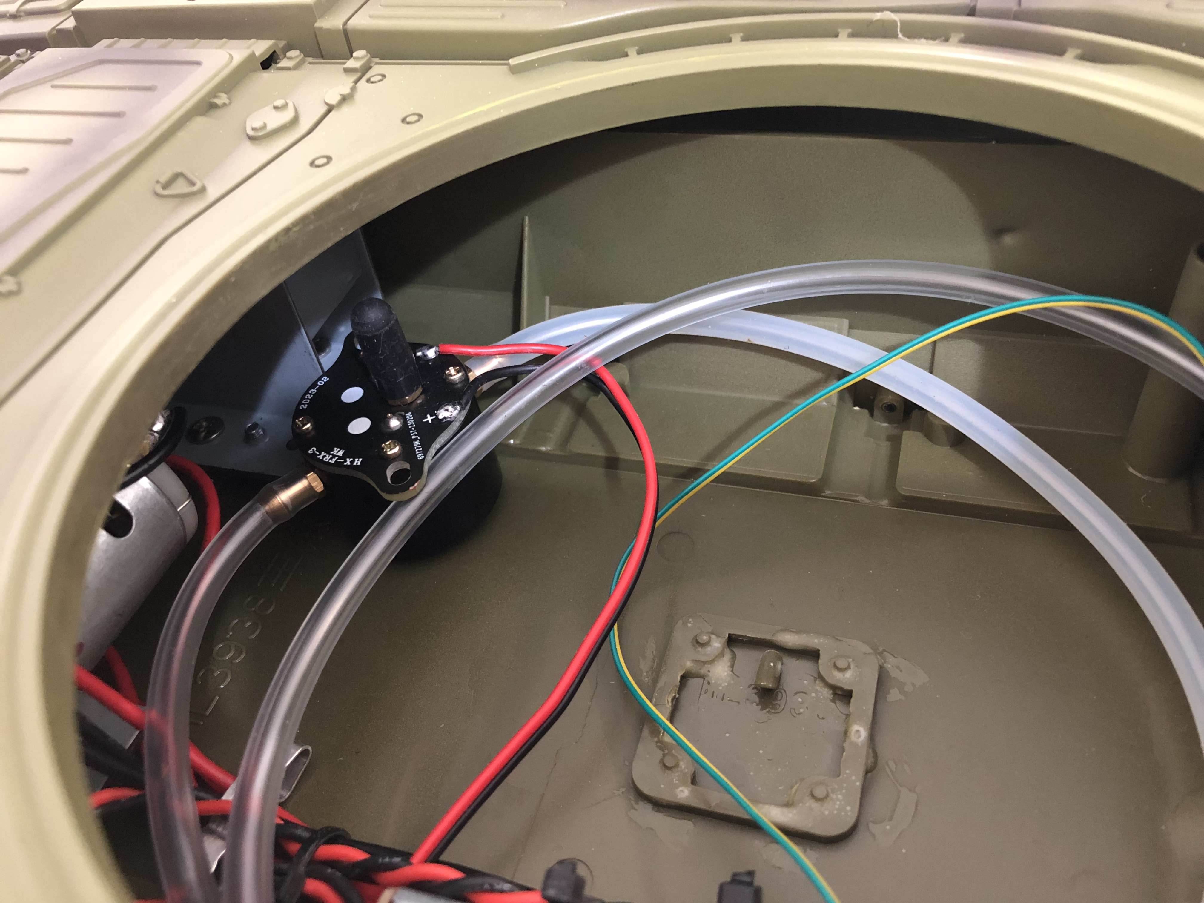

Nothing really newsworthy but some progress.
Cupola base is in, now it can take a figure.
Also fitted & tested the barrel smoker.

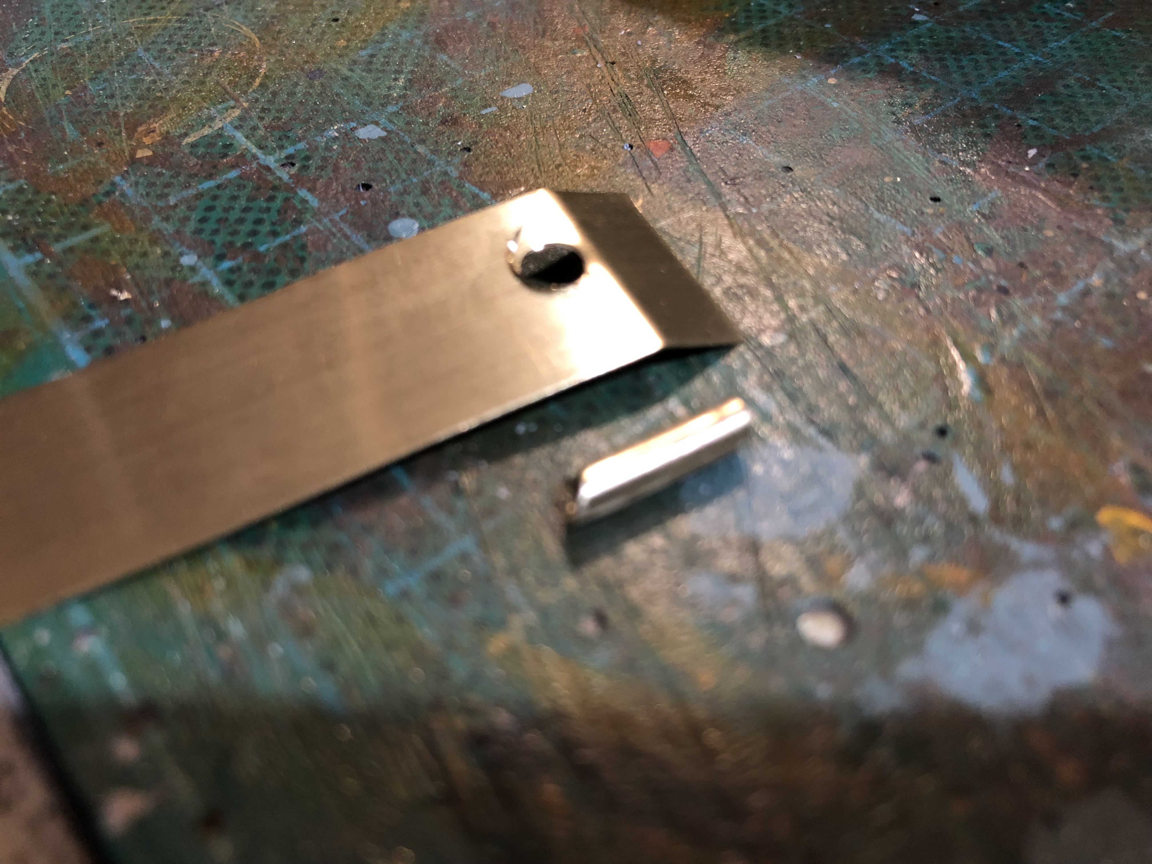

Having the upper and lower screwed together but needing to be able to top up the barrel smoke heater, I made a new “ hole of adding” as HL would call it.
The hull has a plate that I drilled out & made a replacement for. Under that I made a short spigot and plate to take a bit of hose that’s the capillary to the heater.
Nothing fancy to hold the faux plate on, my Syrian T72 s one is just blue tacked in place & work fine.
Next mission is the turret reassembly and surface texturing.
