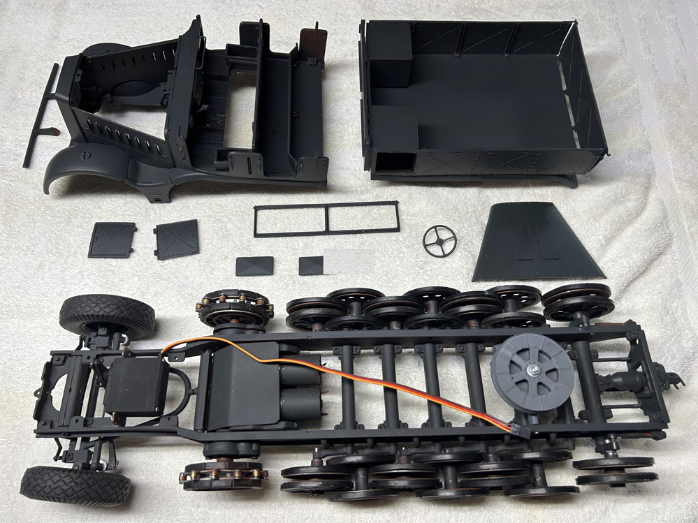

Re: Herr Doc's Famo: Snail still crawling
Posted: Tue Aug 08, 2023 6:08 pm
by Herr Dr. Professor
I do continue at a snail's pace. With the wheels painted and coated in flat clear lacquer, last night I assembled the chassis. Stretching those 28 skinny Continental tires back onto the road wheels and idlers left me with sore fingers. :haha: Then I got the interlaced wheels together and fiddled to get them to clear one-another. :crazy: Finally, as I was trying to reassemble both front wheels, I found that while one axle fit either wheel quite well, the other axle just would not fit either wheel. I realized that the 4.00 mm axle was too great a diameter for the 3.97mm hole. Simple fix--just drill it out, right?
OOPS! :eh: That 3.97 mm "hole" was actually a ball bearing, :O so perfectly installed* that I could not see the fitting for the outer race. With my tabletop drill press and a new 4.09mm bit, I did a great job of practically welding the inner bearing race onto the drill bit. :/ Despite desperate, heroic efforts, I could not remedy my stupid mistake. :headbang: So now I am on the search here in the U.S. for the right-sized bearing to reinstall in one of the front wheels (and a new 4 mm. drill bit, too :haha: ). I'm learning, and despite frustration, it is interesting.
Meanwhile, I am ready to re-install the electronics and speaker (I did get a Visaton to fit behind the grill, thanks to Herr Hamm's kind and always-useful advice.) Then I can fiddle with the cosmetic stuff (dashboard, fender markings, horizontal driver's side windshield divider, windshield wipers, load of interesting stuff, etc.). And there remain the figures to paint (fun for me).
In the following photo you can see the dramatic difference between Vallejo Dunkelgrau primer (all over) and Tamiya's version (on the winch only). I painted the winch a long time ago just to see the color. I will likely leave it, as if someone installed an old faded winch on a newer FAMO. I am just amused by the paint differences, and I like the idea of the winch being easier to see after the body is on.
Chassis Assembled.jpg (317.93 KiB) Viewed 16752 times
*See my next post.
