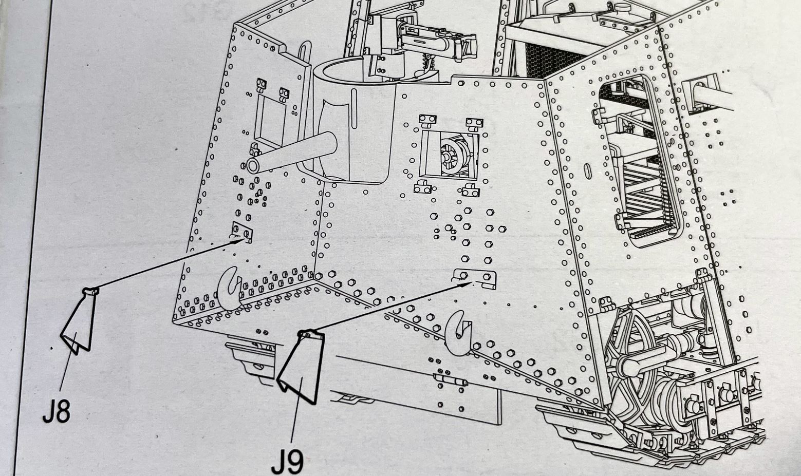

The 1/35 Meng kit instructions and kit parts provide the required specs for this build. Buying books for such build is almost useless as there is no way to get the overall picture for the detailing from images. Notice the tow hooks also at the front, and the lifting covers.

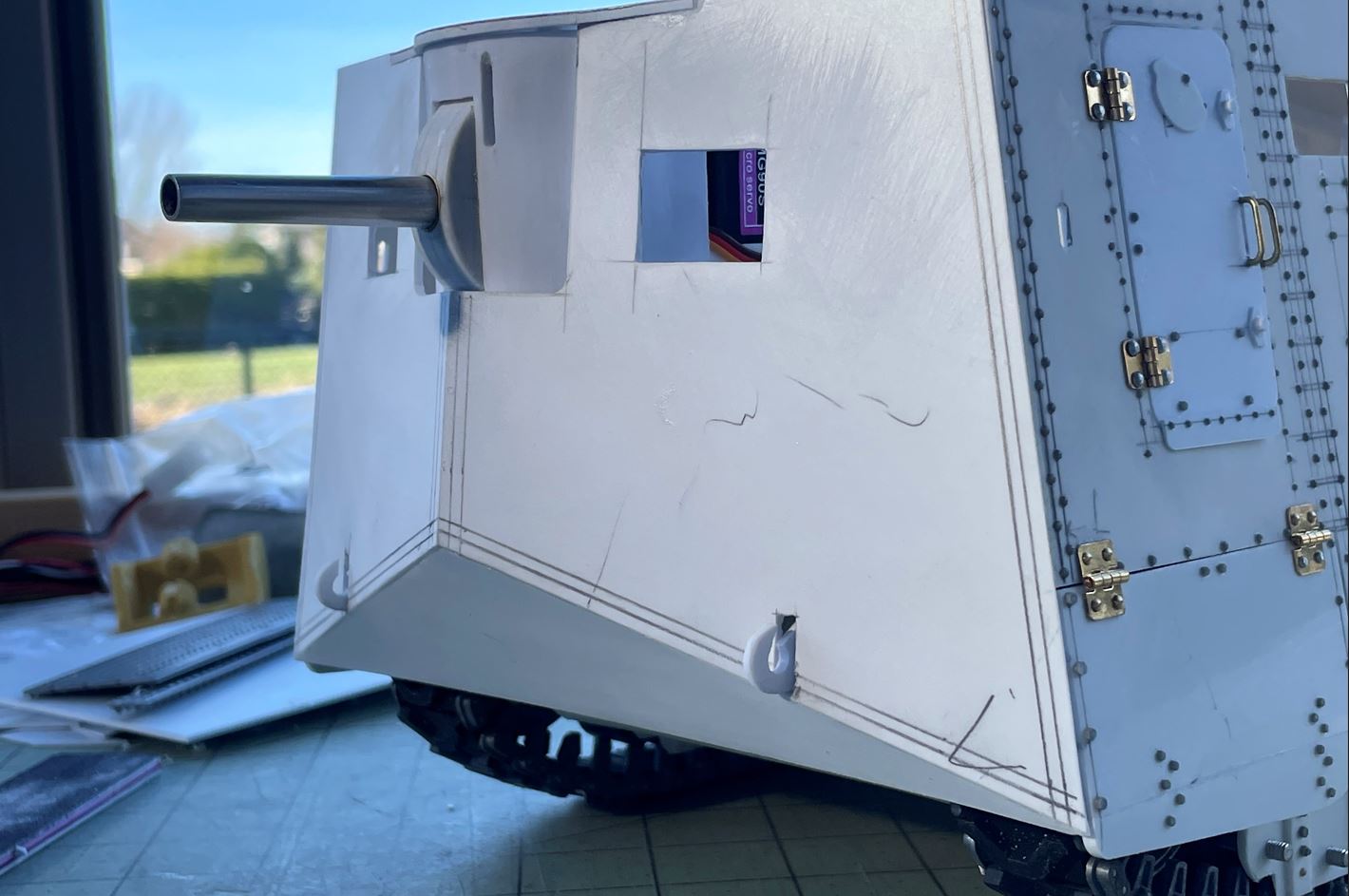

Tow hooks are made and installed.

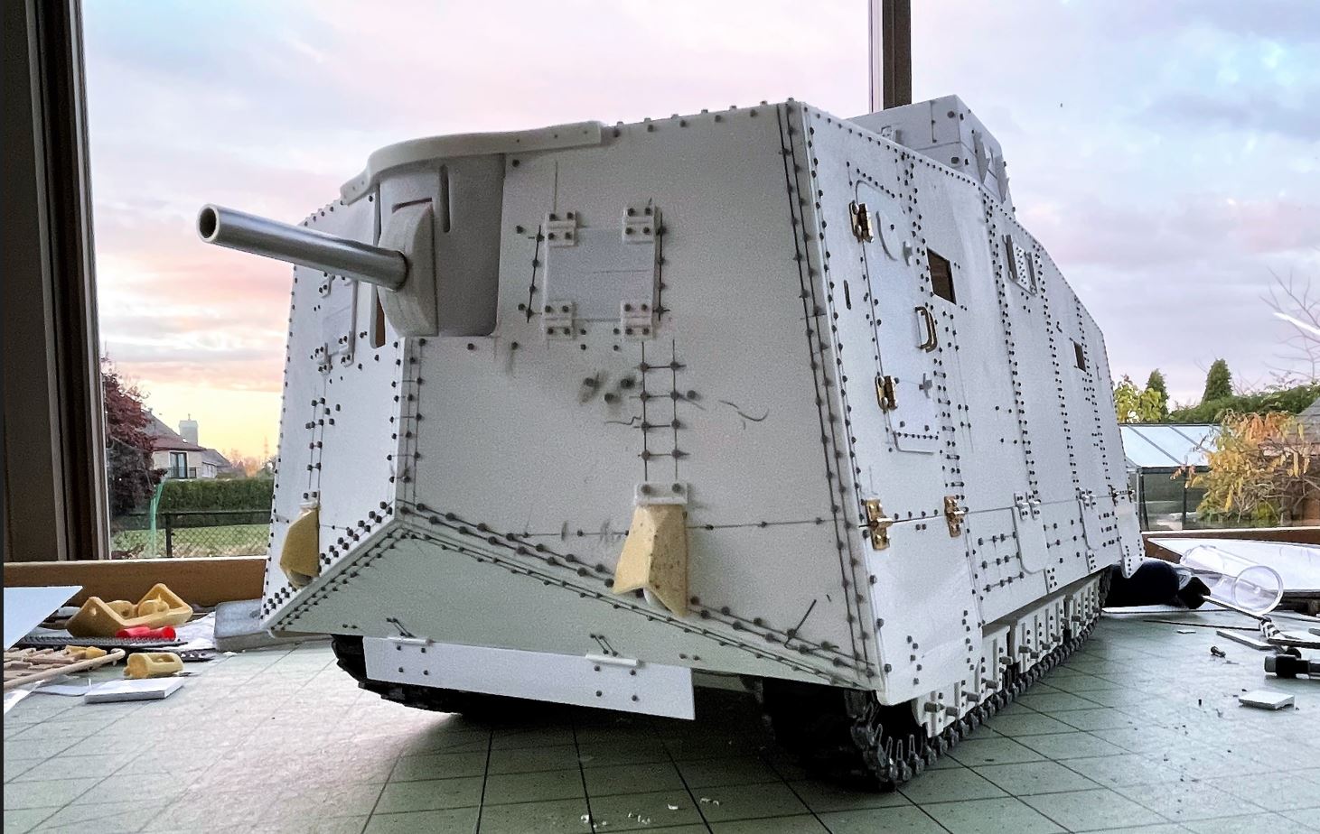

The Ludwig kits comes with 4 resin covers for the tow hooks, more like a blob of resin of an approximate shape. I decided to reuse them with modifications and also by making them hollow in order to cover the hooks.
A7V German WW1 tank 1/16 RC - Build
Tow hook covers are in place, i made them static.

Here, the frontal hatches are done, they were made static. The rivet/bolt job is ongoing, spread over 2 days to maintain sanity.

Here is the completed frontal section, minus a few tiny rivets that i noticed are still missing.

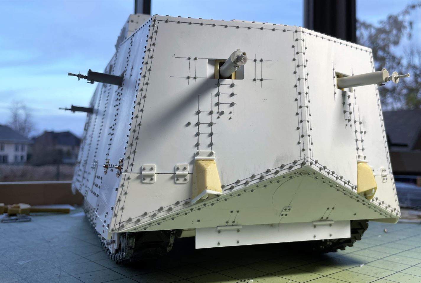

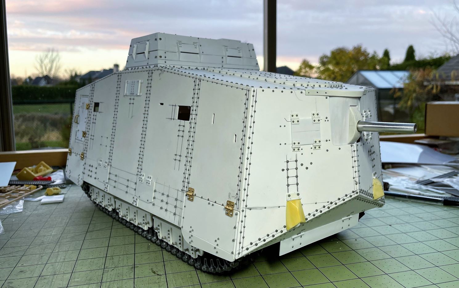

Next step is to detail the rear side of the vehicle. It does not have any visors or hatches, the two holes are for MG-08 machine guns. Installation of the 6 MG-08 will be the final construction step of the build, i'm almost there.

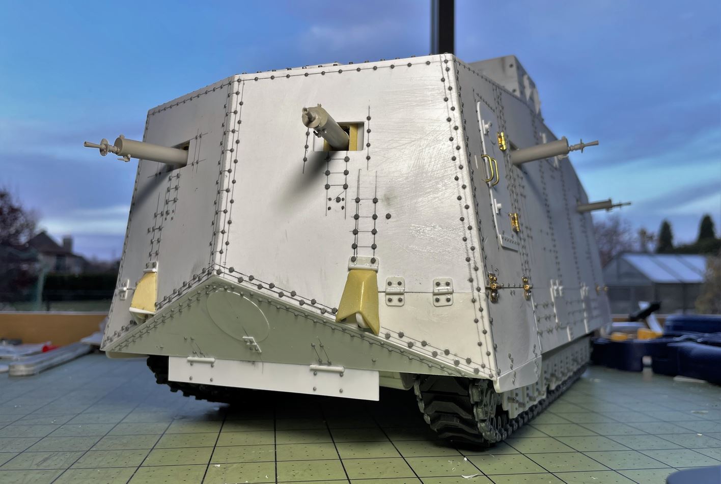

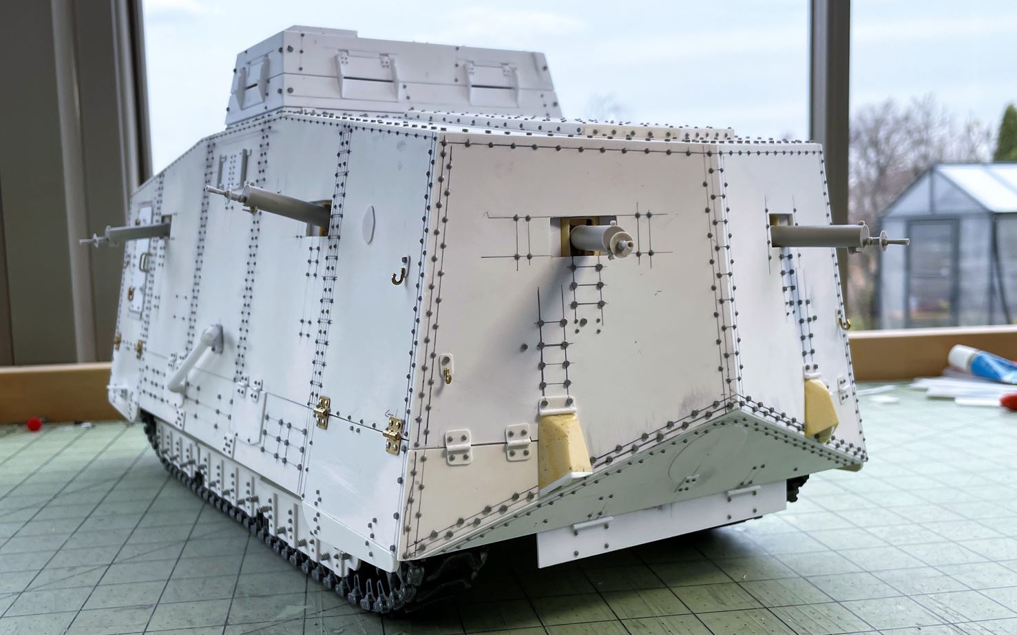

This post is for the completion of the rear of the vehicle and preparations for the machine gun armament.
The A7V was equipped with six Maxim MG-08 machine guns, two on each sides and two at the rear.

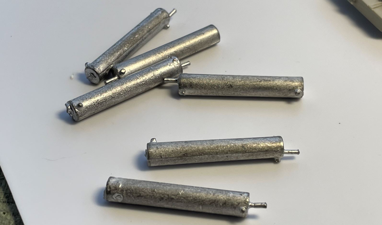

I found the metal sticks coming with the Ludwig kit to be unacceptable for such an important feature of the model.

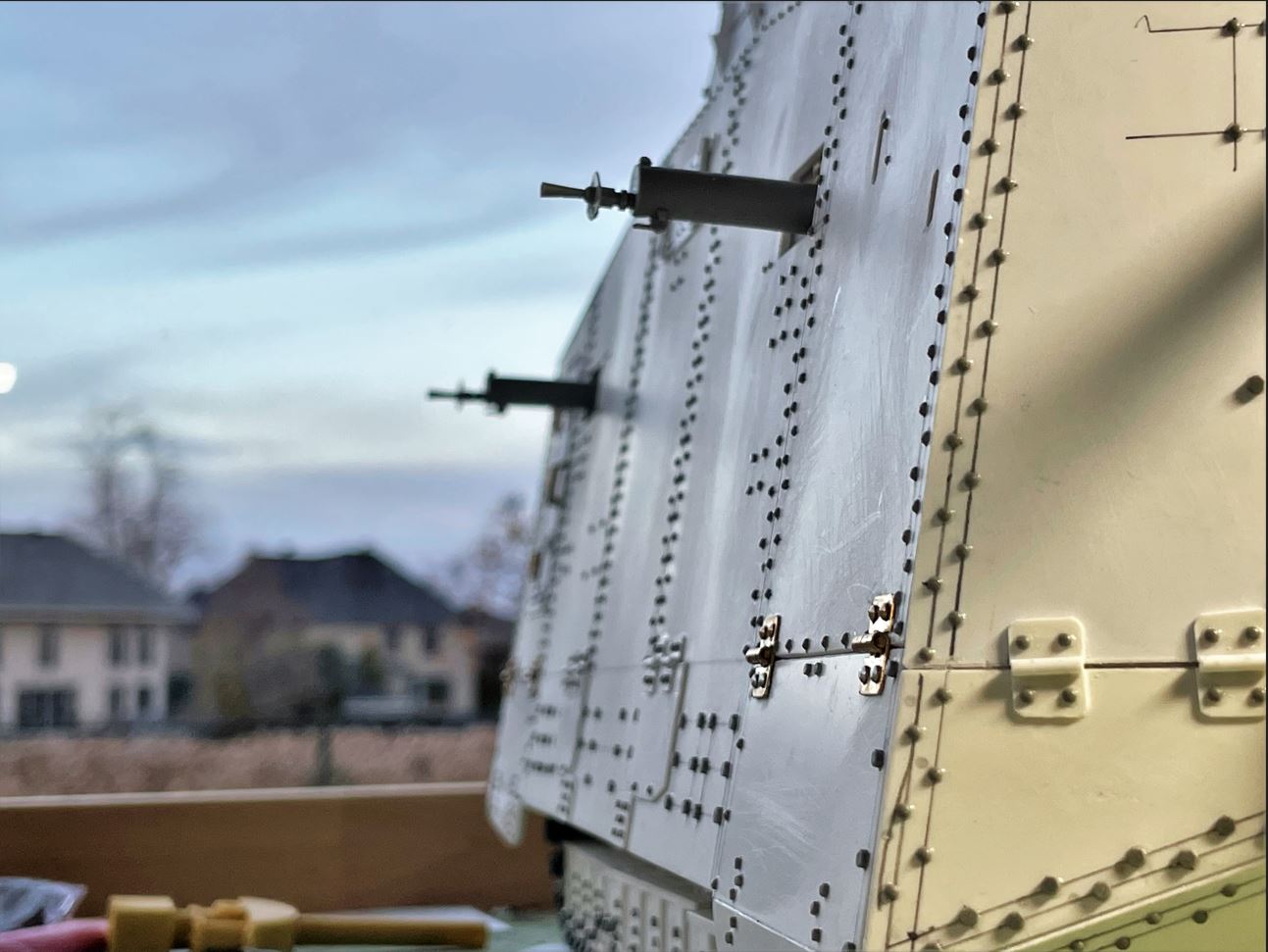

The Ludwig resin blob for the mounts were reused and modified to be as close as possible to what i saw on references, while keeping things as simple as possible.
The MG-08 are just positioned in place for the picture. The final preparation and painting will be done separately.

View of the completed rear of the vehicles with the Maxim machine guns. I will measure the exact length of the barrel that is sticking out of the wall and permanently install in place after painting. I will likely convert one of them on each side with a fiber optic and LED.

The model as it stands today. Construction is almost finished. I am happy to confirm that all bolt heads and rivets are in place, i did it... I still have to create the exhaust pipe and go around the vehicle for one last verification before painting.

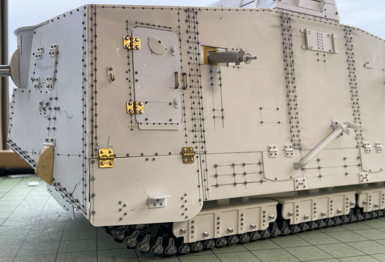

Went around the vehicle and added remaining components.
Such as the foot pedal at the bottom of both doors

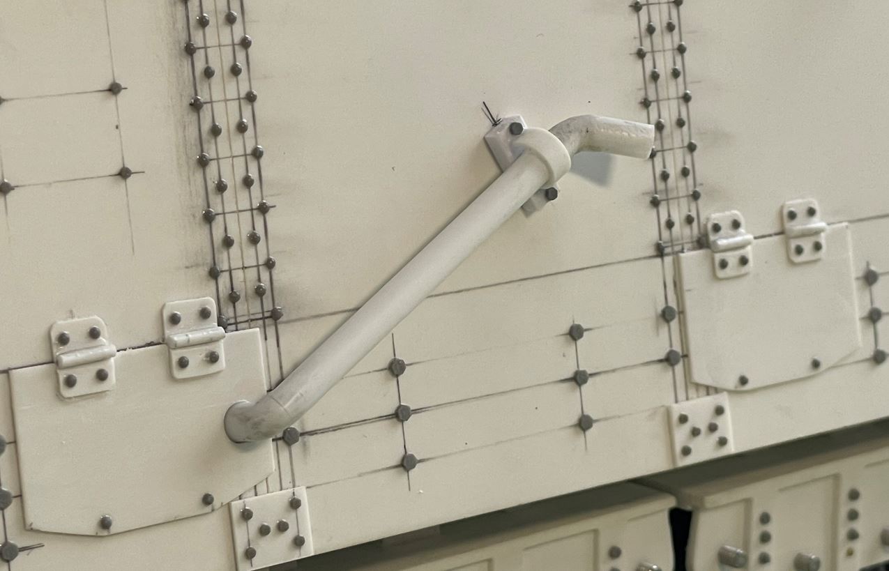

And the exhaust stacks on both sides, oriented towards the rear.
Last picture of the model before painting.

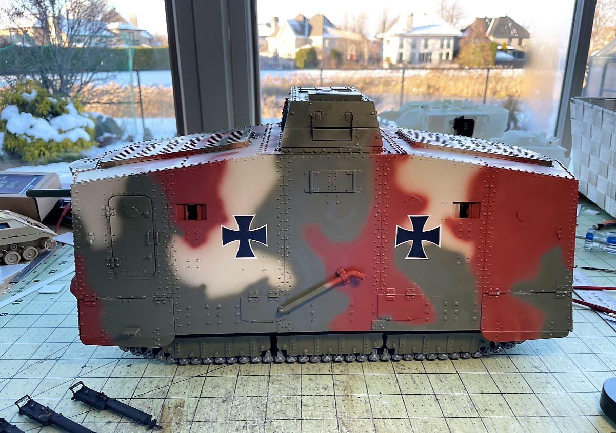

After painting but before weathering with black pigments, the decals were applied. I was able to easily put on the side decals. I did the best i could on the front and back, trying to avoid rivets and bolt heads as much as possible. Applying decals over bolt heads and rivets was tried but it creates a mess. I was not able to successfully put on the large crosses on the top grills, too many obstacles and holes. Those were discarded.
And finally, after months of work, here is the finished A7V model. I left the model relatively clean, with only some light weathering as i like them. I leave the dirt and mud application to other modelers that are better than me at this.
