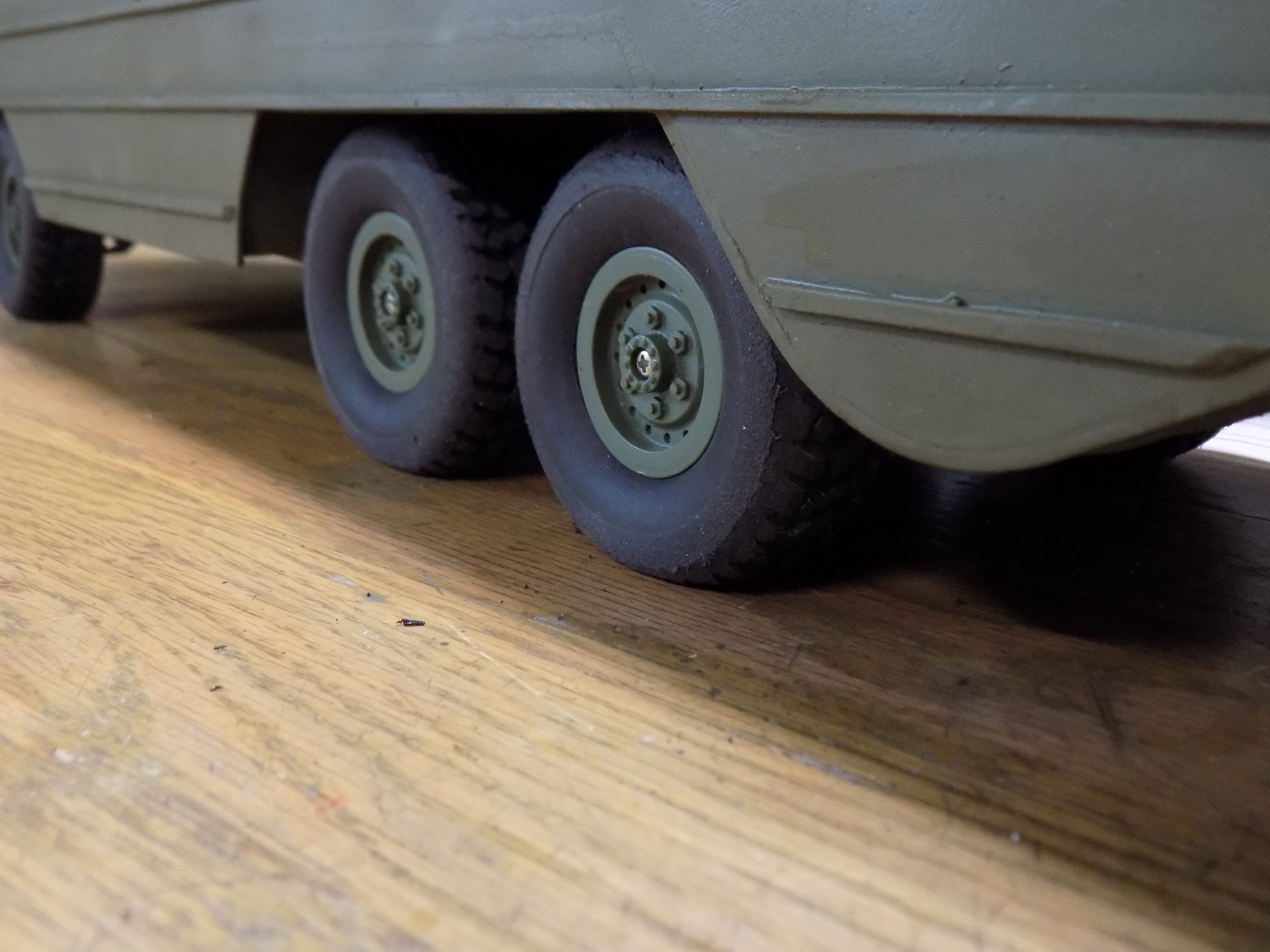

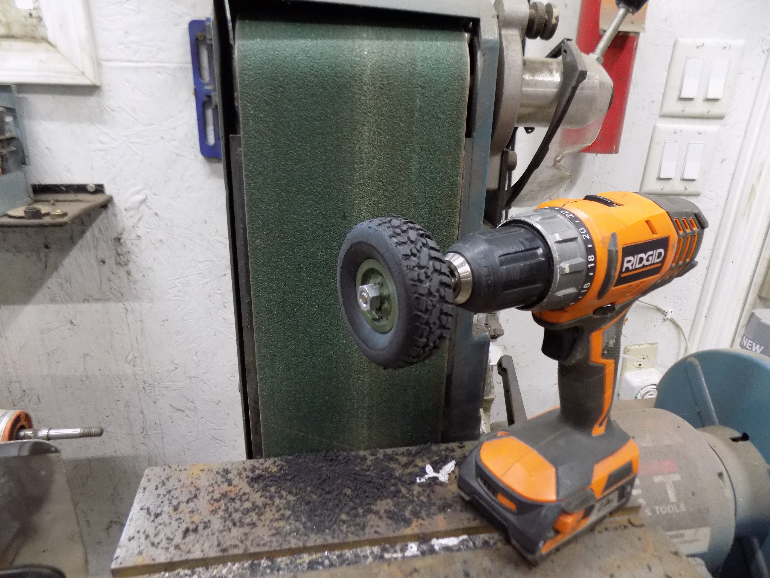

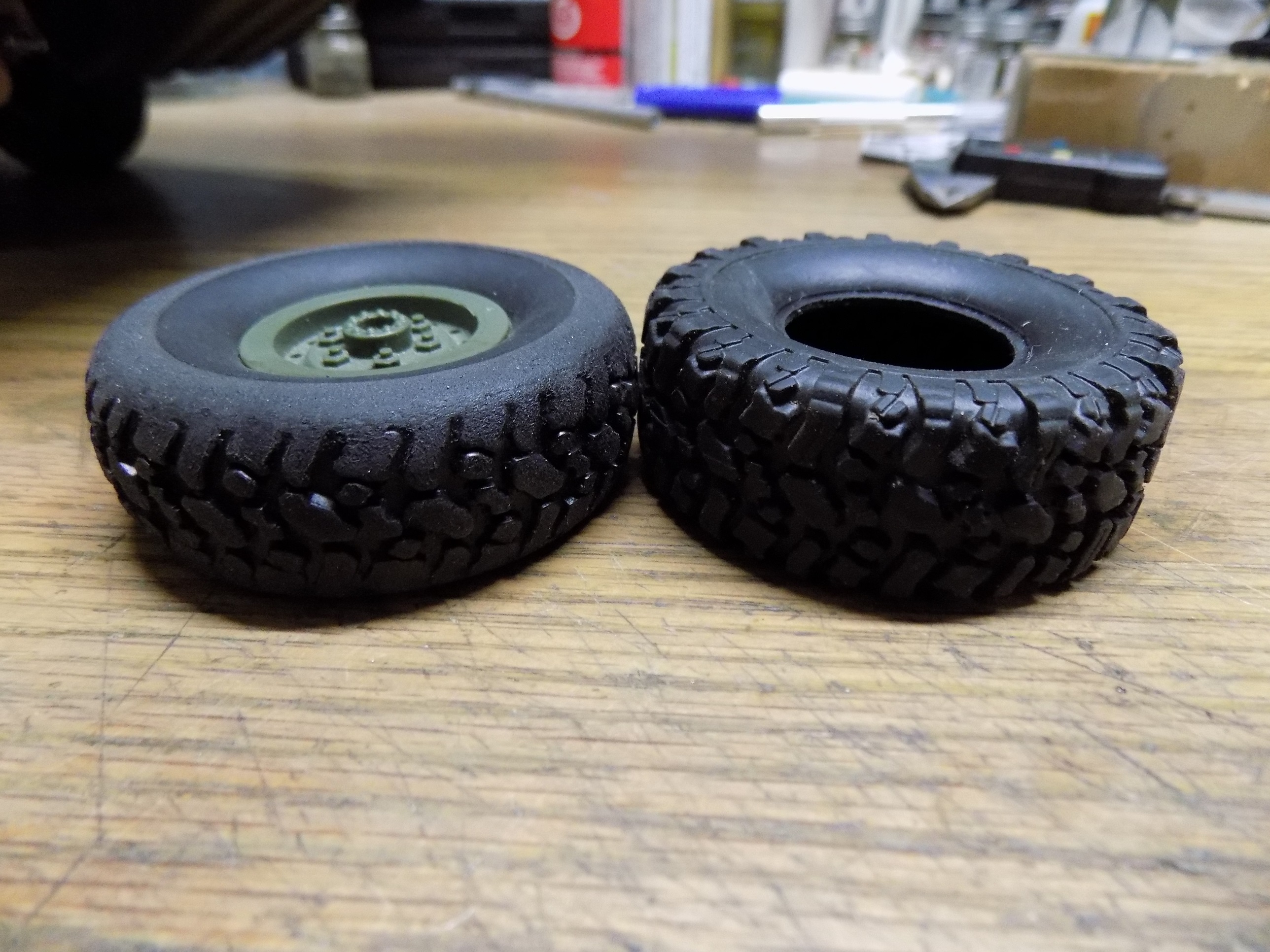

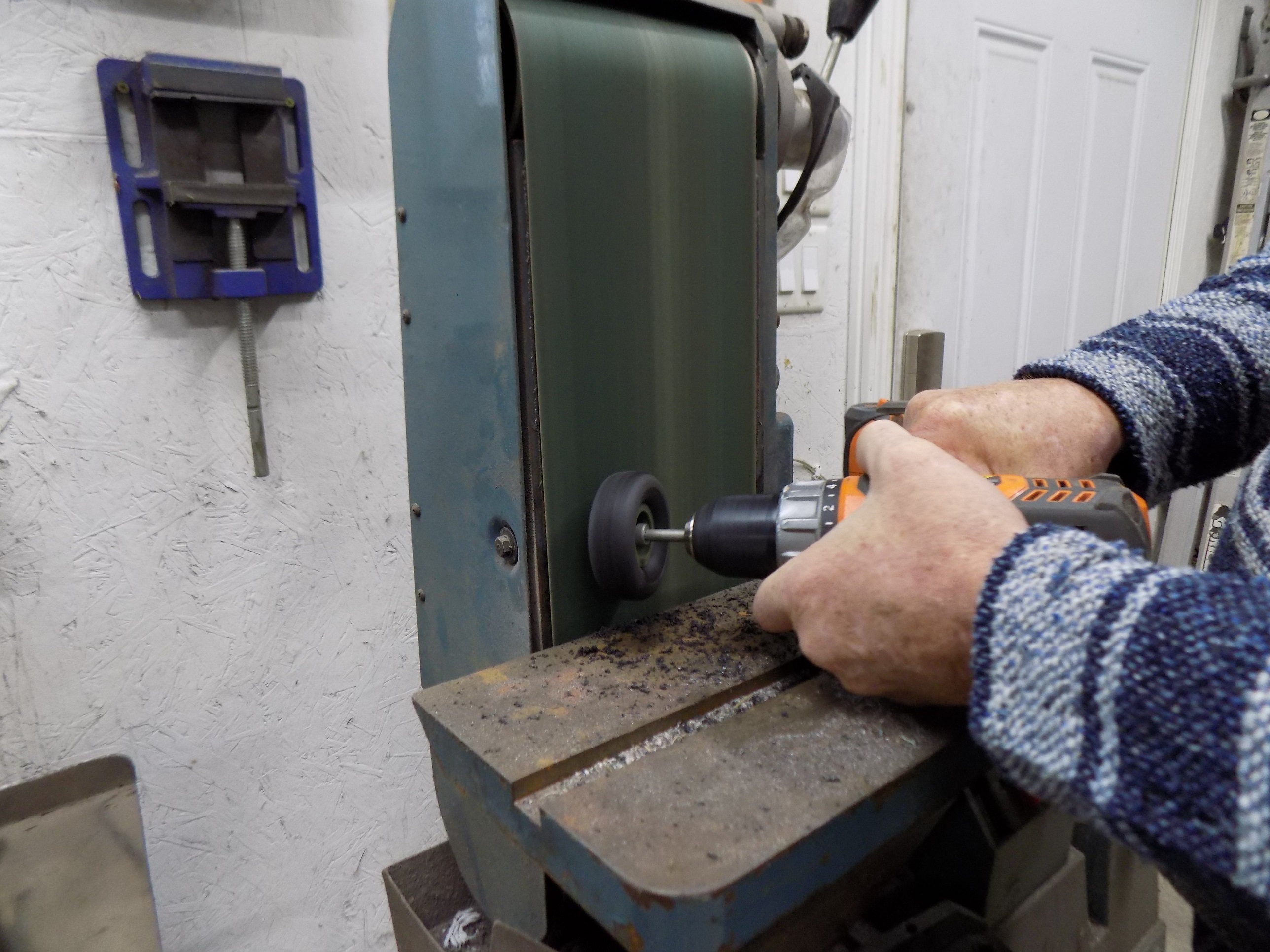

I came up with a temporary solution to the tires/tyres for the duck. They are not perfect, but they help.
Belt is running downward and the drill is running opposite. Light pressure keeps from melting or burning rubber. Could be done on sand paper but would take a whole lot longer. Each tire/tyre one took 2-3 minutes.

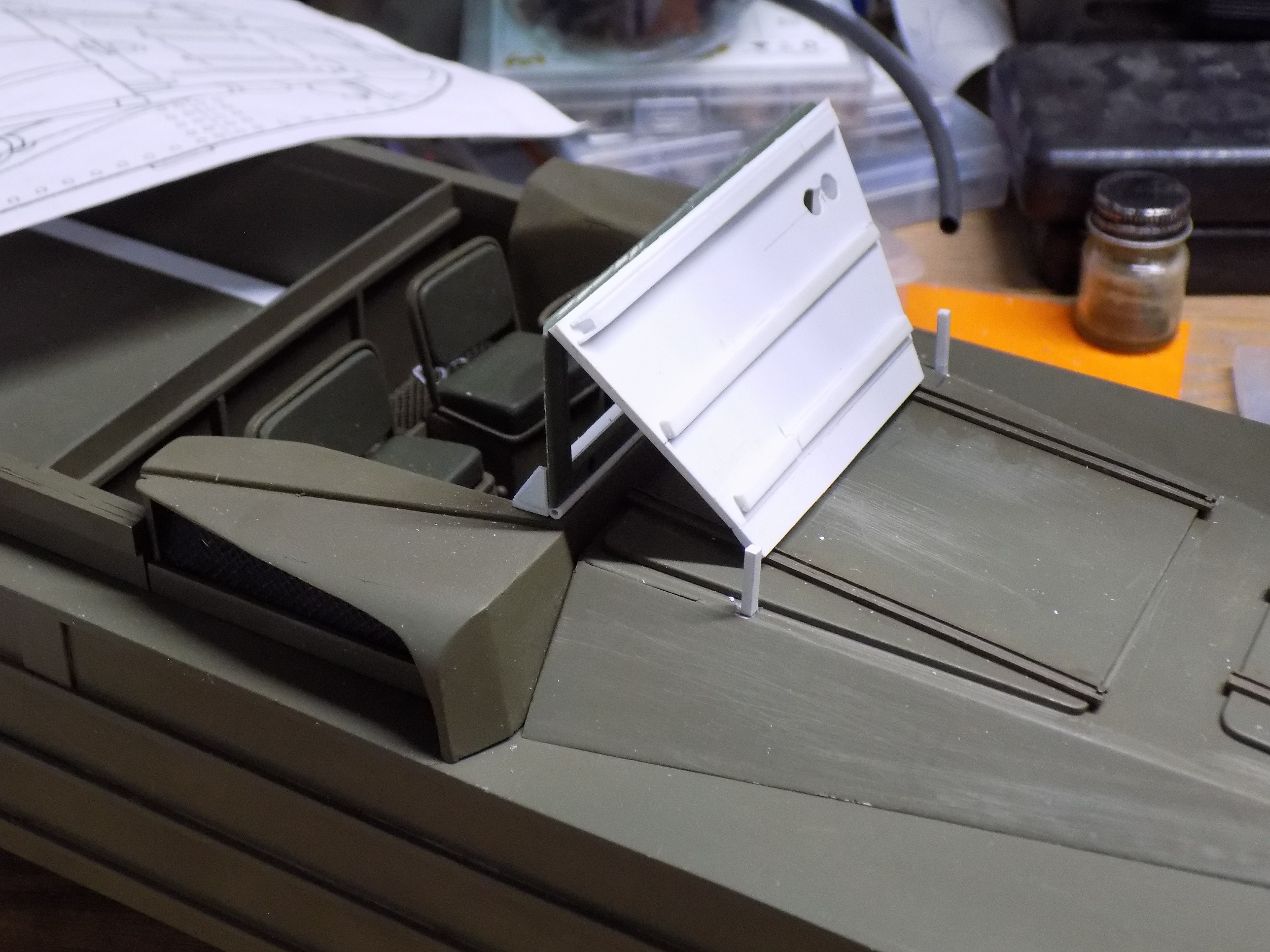

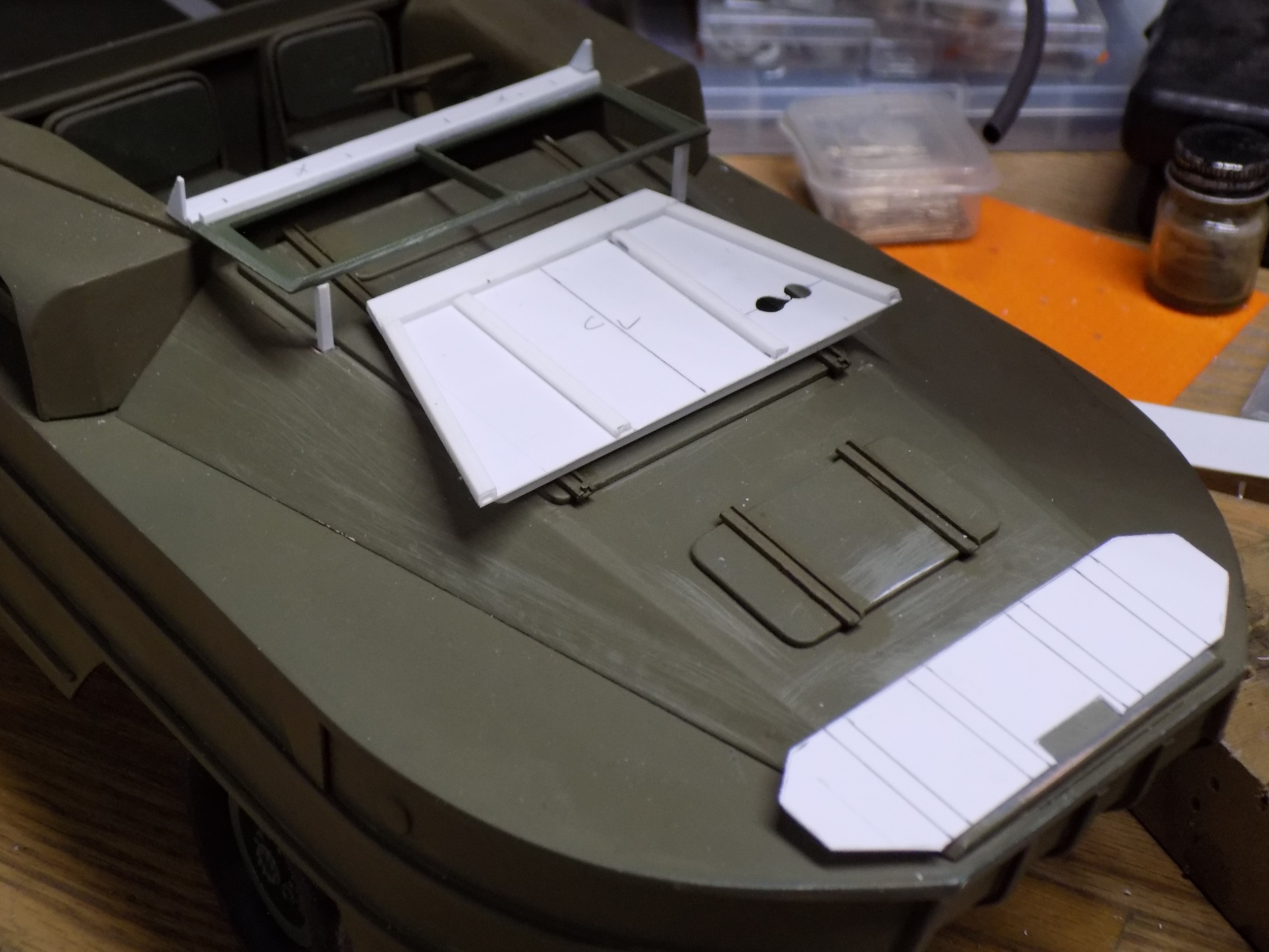

A little deck work.
This is the goofy windshield protector I mentioned earlier on the first 2000 DUKWs.

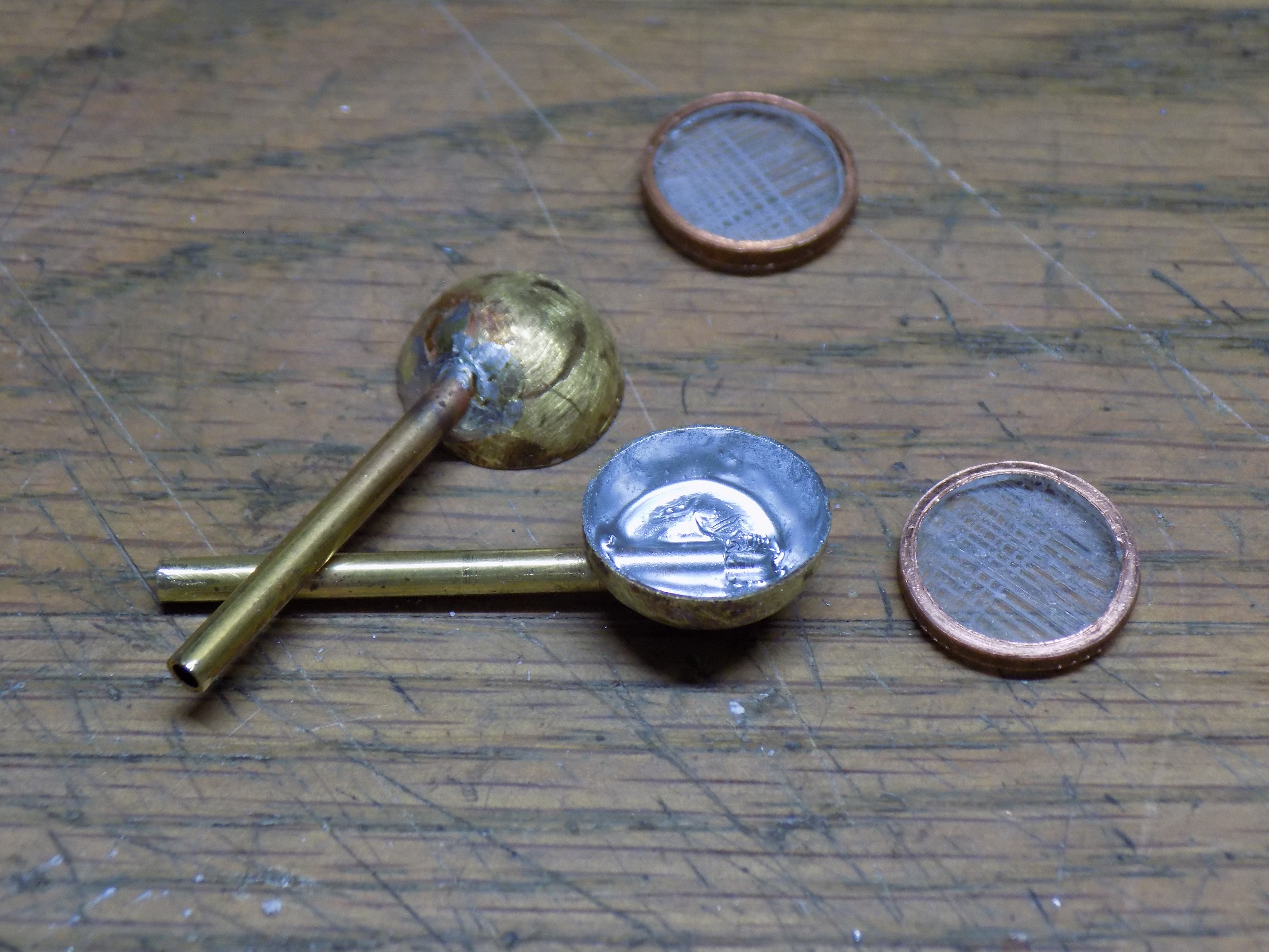

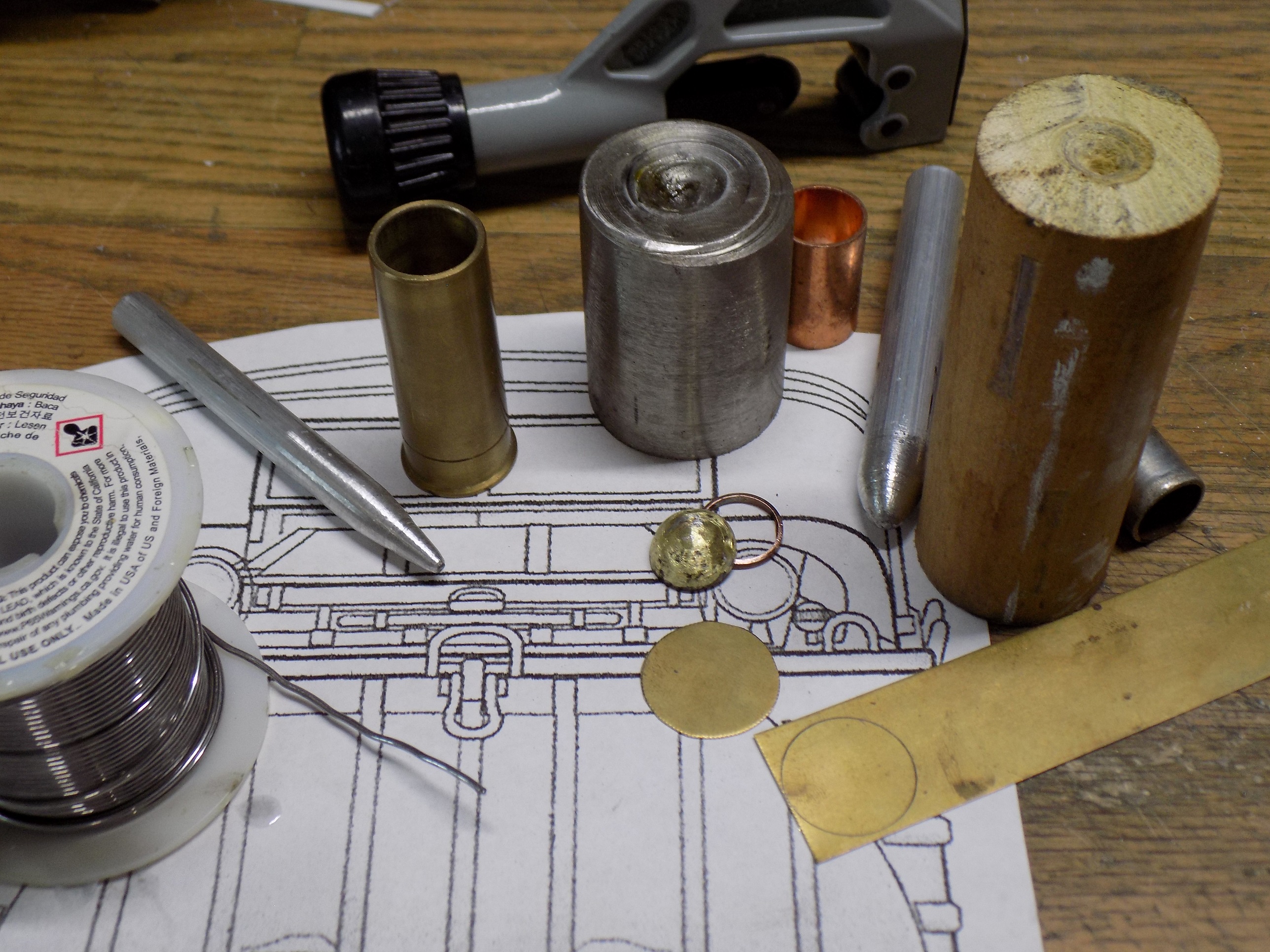

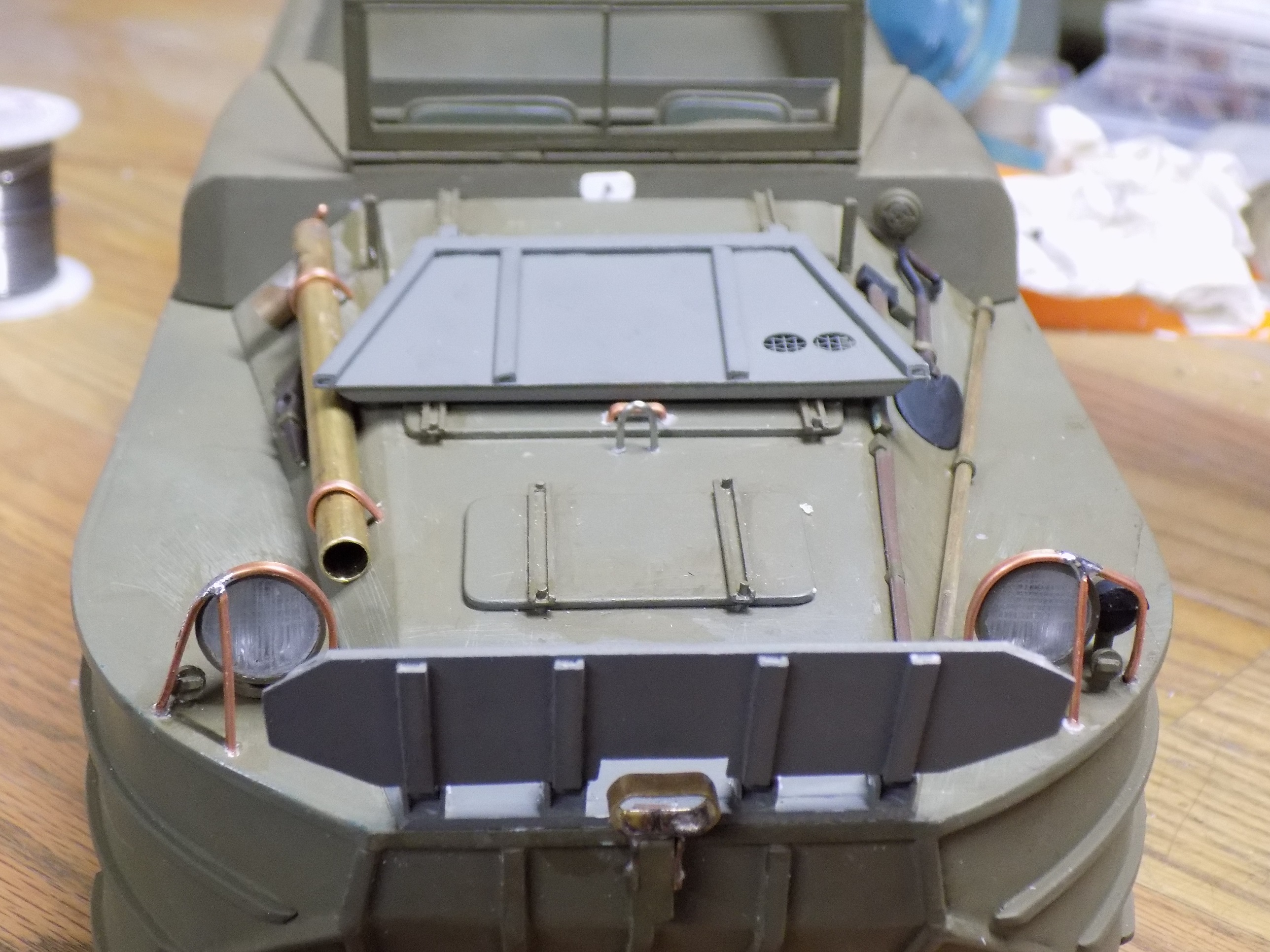

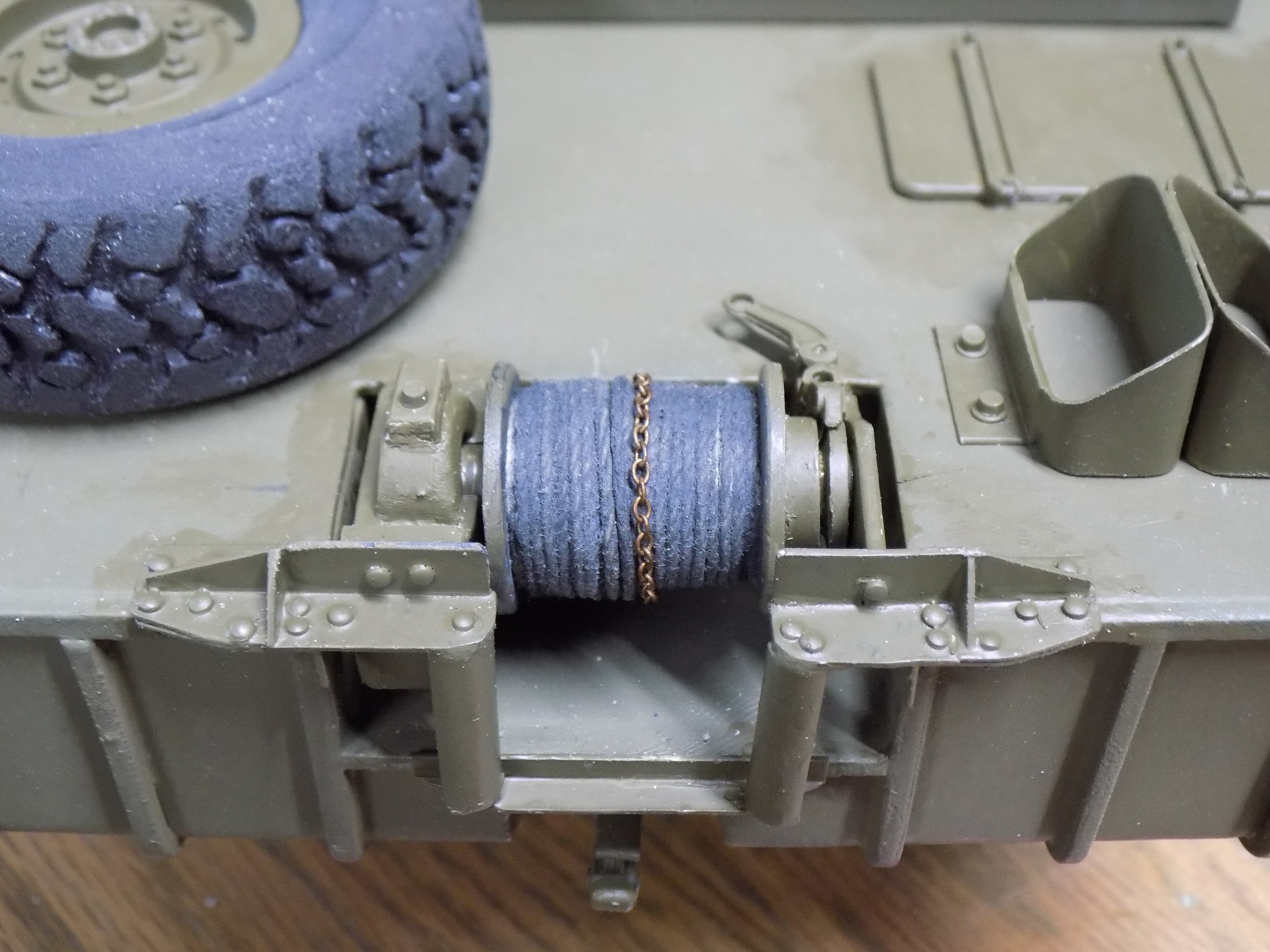

Searched high and low for a suitable bucket to make headlamps, however....
I did leave the tube open for future LED installation. Have to figure out how to operate them from the Flysky receiver.
The blackout lamp on the right side of the picture is a Tamiya piece from the M4 kit just to give scale to the headlight.

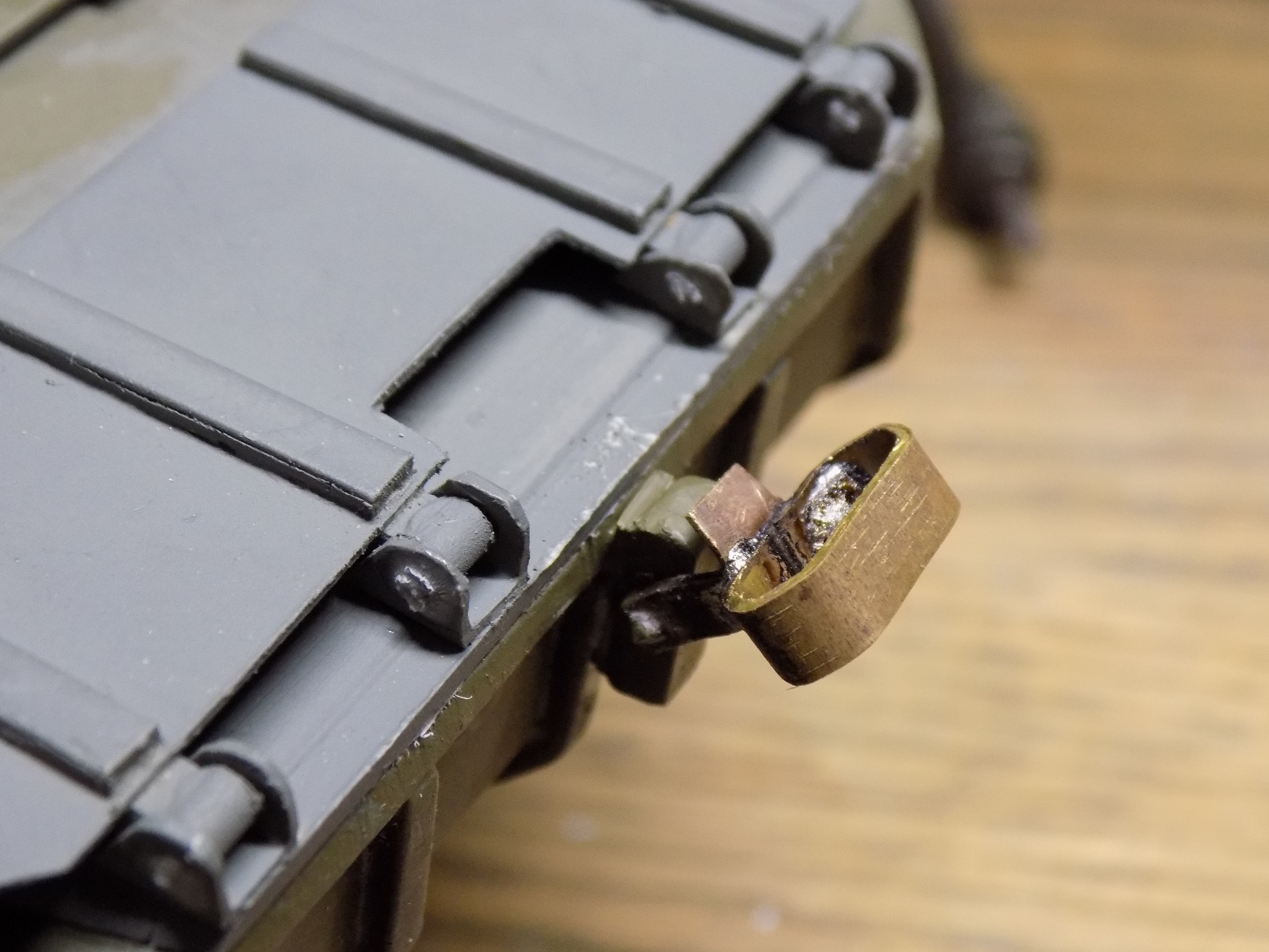

As an option to magnets holding the hood on, I went with a folding forward winch hawse as a latch.

For the lights, you can get cheap controllers from all the usual Chinese sites , eBay or Amazon, that just plug into a spare channel on the receiver and have switchable outputs you can connect the LED’s to. When the channel is switched it changes lights off and on in groups - you can use a button or a switch to do this on the Tx.

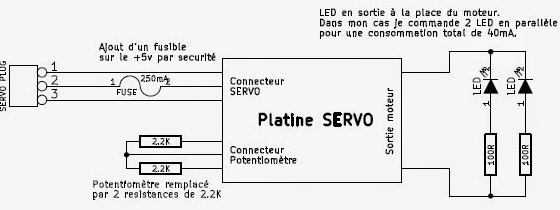

:) Hello, hence the advantage of having a multi-channel radio, our friend is right, you will find modules at low prices on the Aliexpress site, otherwise you can tinker with servo electronics, see diagram attached
Sorry if in French? but Google is your friend!!! for the fuse, in series, I personally did not put one, because the rest would be blown before, in case of concern
