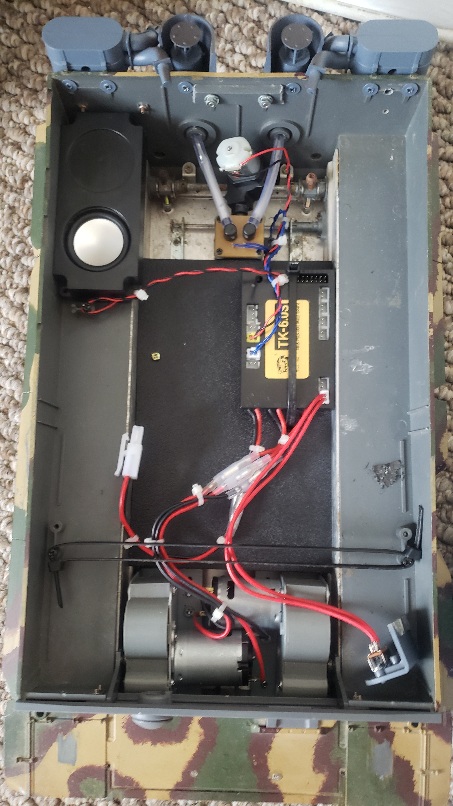

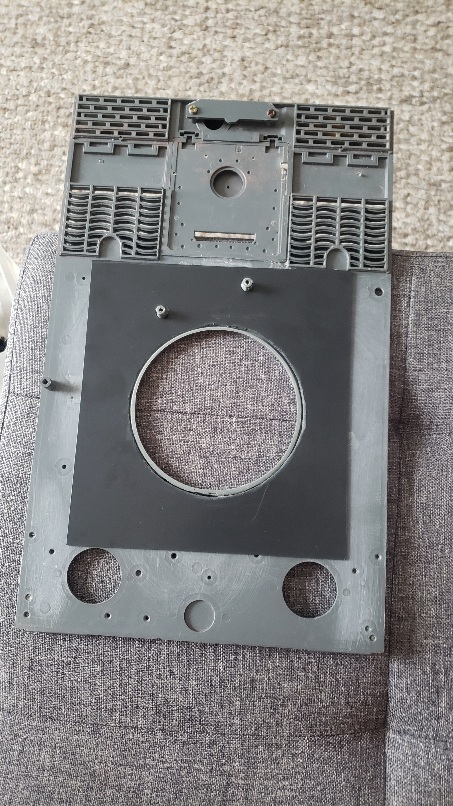

Laid my platform in the chassis yesterday and started attached the brain box. I think a velcro strap for the battery. More shopping!

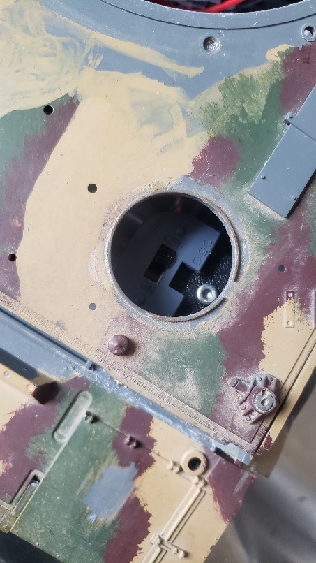

Tidying up the turret swap as well.
1mm ABS to be attached using epoxy.
I suspect at this point that the driver and funk hatches will be fitted the same way.
Posts: 8497
Re: Panzer kaput! Tamiya Tiger 1 restoration.
If you glue a sheet of velcro to the floor and sides of the Tank hull you will not have to drill into the Tank to attach the control board,Smoker and battery,
Just glue a velcro patch to the back of anything you are fitting into the hull including the battery which can be attached to the Hull side instead of on the floor thereby making more space available,
Everything will stay in place until YOU want to move it.

Post by AGKPeiper »
Now thats a great idea.
Unfortunately the suspension will get in the way when attaching it to the floor. I can however use it on top of my floorboard.
Fitting the board used one of the existing holes and a spacer from one of the OE gearboxes.
The smoke unit did require a couple of holes drilling but I'm not sure it would line up with the exhaust otherwise.
The following relocation of the on/off switch was not going to be solid enough without a hole drilling to enable bolting it in place.
Even without a turret I've been crashing this thing over obstacles and I want nothing electrical floating around.

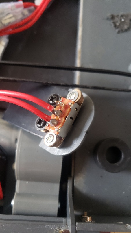

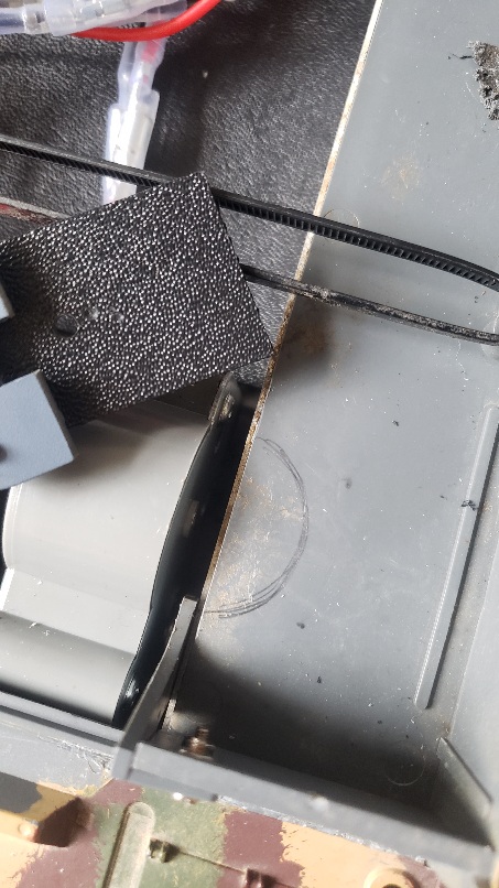

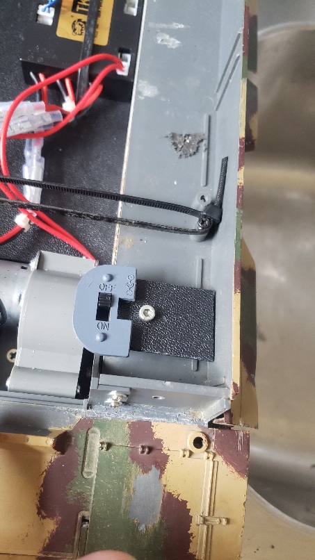

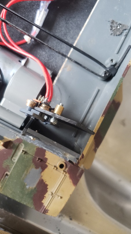

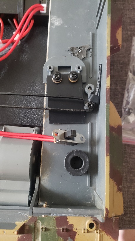

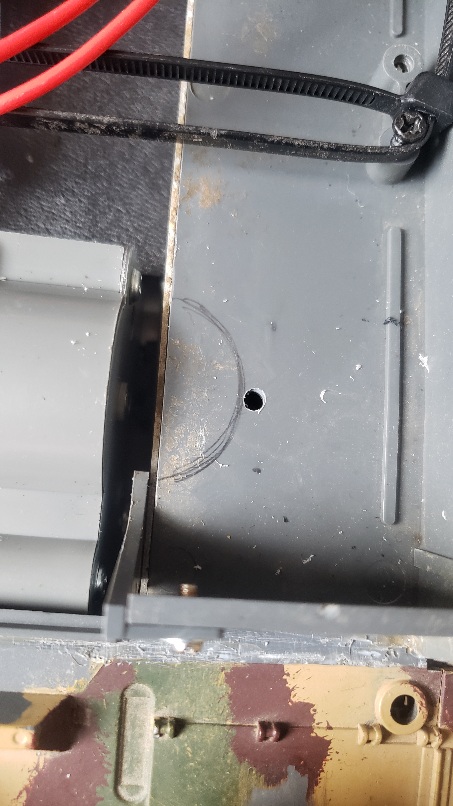

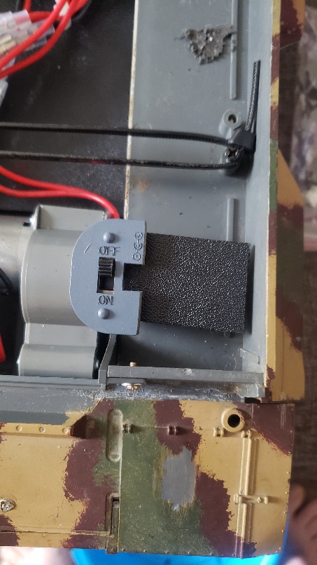

That switch relocation.
Firstly, glasses discarded for close work and obligatory foot.
Codged together mounting bracket. Really glad I've so many oddments of gearbox as these HL screws do not like to go back where removed from and stay. Please ignore the cable tie it isn't permanent.
Yes. Even I mark things out occasionally and this is to make sure I mount the switch in the right spot.
Yep. Another hole.
With yet more gearbox parts it works though.
Posts: 8497
AGKPeiper wrote:Now thats a great idea.
I actually meant the floorboard certainly not the floor of the hull.
