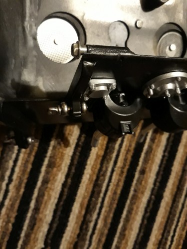

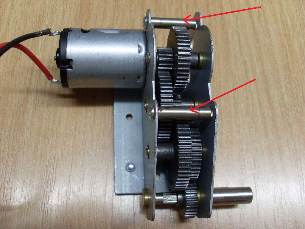

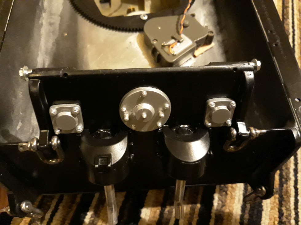

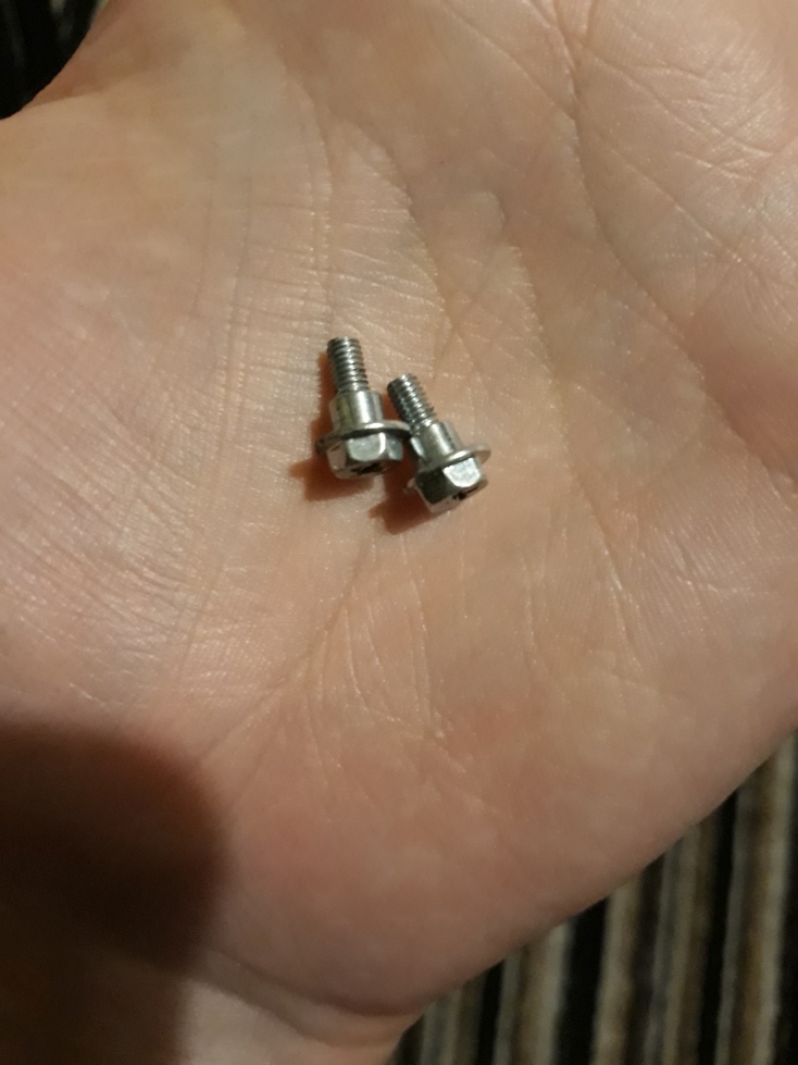

Re: Tamiya King Tiger custom build
Love the bonnet hood lifting. How did you go about it please?
‘Experience is the name everyone gives to their mistakes’ - Oscar Wilde
I used 2 spacer rods from a gearbox, filed a flat side on them and used milliput to to fix them in place. Drilled 2 holes through the side of the chassis that line up with the spacer rod holes and put 2 shoulder screws through to complete the mechanism.MikeHamilton wrote:Love the bonnet hood lifting. How did you go about it please?
My custom King Tiger build: viewtopic.php?f=23&t=31936
