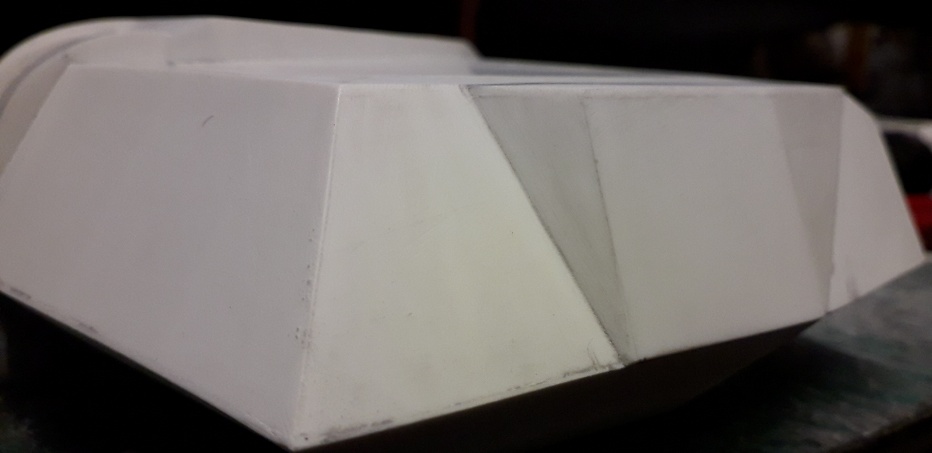

Such complex angles, surely cant just be for shot deflection...............can it ??
Scratch build US Army "Scout" Armoured recon vehicle XM800 T
- Lieutenant-General
- Posts: 12027
Re: Scratch build US Army "Scout" Armoured recon vehicle XM8
That is most definitely a "stealth" AFV !

Hi Mr Bix.
Thank you for your continued interest.
Regarding your comments on stealth design.
This tank was produced in the mid 1970's was highly successful in trials so much so that the US Army ordeted 2 to 3000 of them before the conclusion they were so impressed with it, then out of the blue the project was cancelled much to their dismay , what was the replacement......the slab sided Bradley
It just so happens that also in the mid 1970's DARPA was investigating stealth technology and the first stealth aircraft the HAVE blue flew in the wait for it .....mid 1970's.......then the F117 stealth fighter we now know was operational in 1983.
Maybe, just maybe
the XM800T was cancelled to protect the forth coming stealth aircraft and F117...just a thought, but the time lines fit perfectly and could offer a reason why the cancellation of production of the XM800 T amazed so many people.
Hi guys
I don't think stealth technology has anything to do with. IFVs are not a tank and to reduce weight they are usually made of aluminum (let's say very simply). As in WWII vehicles, appropriate armor plate angles are used to improve the ballistic capabilities of light armor (similar to WWII tanks since the T34 - as you surely know). For armored land vehicles, more important than lowering the radar signature is mobility, firepower, reduction of thermal signature and silhouette. To achieve this, it is much easier to cover the vehicle with a suitable paint that absorbs radar waves and reduces infrared emissions, and to use multispectral coatings such as SAAB Barracuda or the Polish Lubawa system:
http://www.lubawa.com.pl/pl/kamuflaz-i- ... az-mobilny
As I know XM800T project was canceled because it did not give anything more than what the M113 offered, and as a result, another project was started. In that way the M2/M3 Bradley was born.
Hi.
Thank you Mr Abramsky, of course you are correct but nothing like a little speculation to get people to look at a thread
The weopons system was greatly better than the M113 with the Auto 20mm, fully stabalised, night vision cannon etc, all comes down to money in the end though.
There is nothing wrong with speculating
Yeayh. You're right about turret, but perfect turret is not a whole vehicle, and the chassis, unfortunately, did not provide increased mobility and enough space for the soldiers and, more importantly, for their equipment (and this was getting bigger and bigger). I think that thanks to the XM800T program, a better (but not perfect) Bradley was created and its turret with a 25mm Bushmaster cannon resembles that of the XM800T in several places.

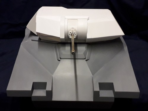

That was certainly the XM800's issue was that it could not transport 12 equipped troops as you say, and the good parts went on to be incorporated into the Bradley vehicles.
Trying out the turret onto the hull, looks more like the XM800T now thats for sure, still lots more to do.

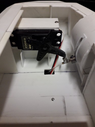

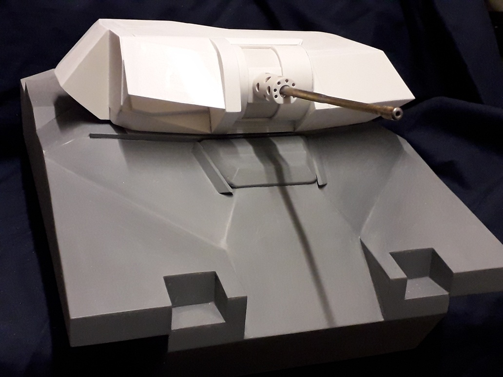

Mr Brute, as you say a complex build, i have always had patience.
Added the gunners side extension and additional armour,
Now onto making the elevation and depression mechanism, the twin rotating cylinders don't have a central pivot point, so i will have to get creative.

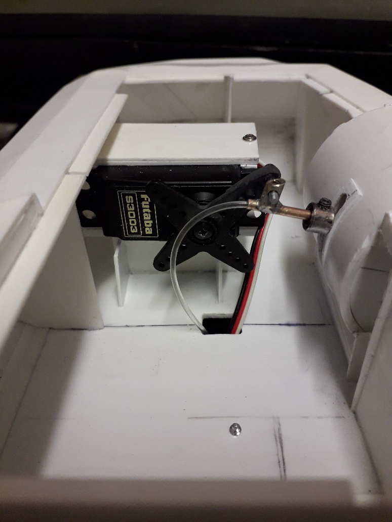

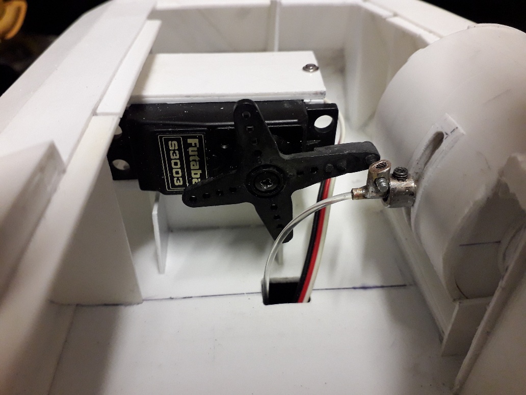

Hi.
Worked out the mechanics of the elevation and depression ok.
Few pics of it, central gun level then elevated and depressed,
It was fairly simple once you took accout for the arc of the servo arm which meant that the pivot point increased and decreased during elevation and depression, it also had to pivot around the servo arm shaft to avoid any lock ups.
Works well and is smooth in operation.
The clear cable going into the gun " breach " end is fibre optic cable for the gun flash.
