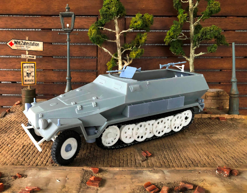

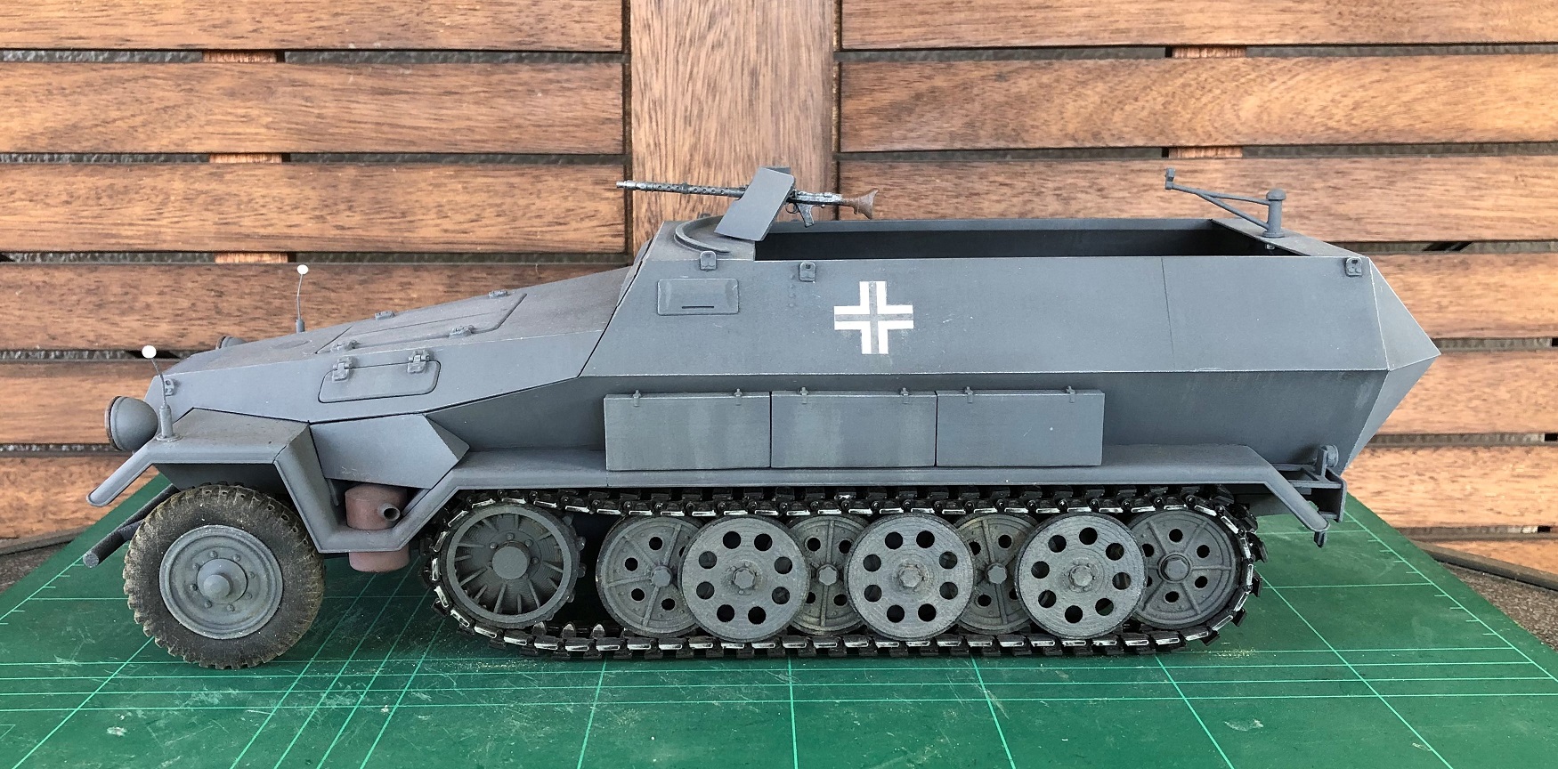

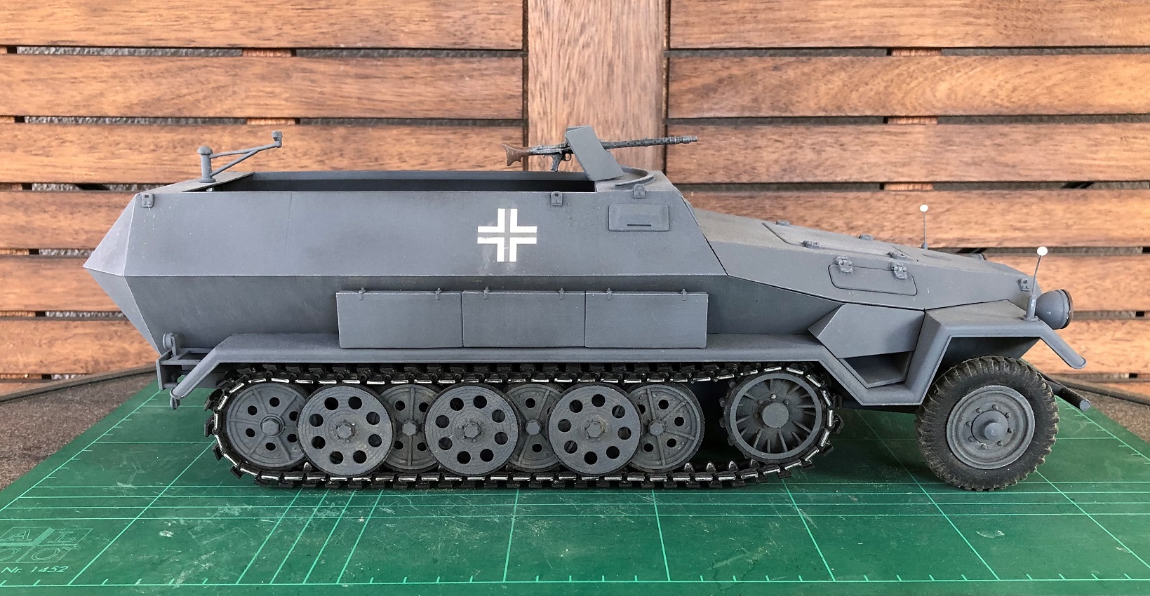

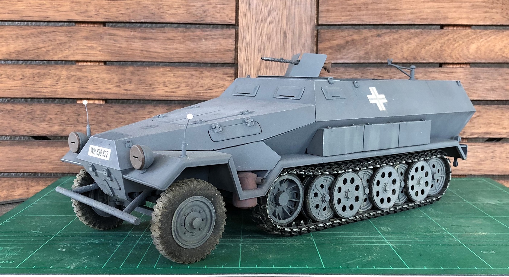

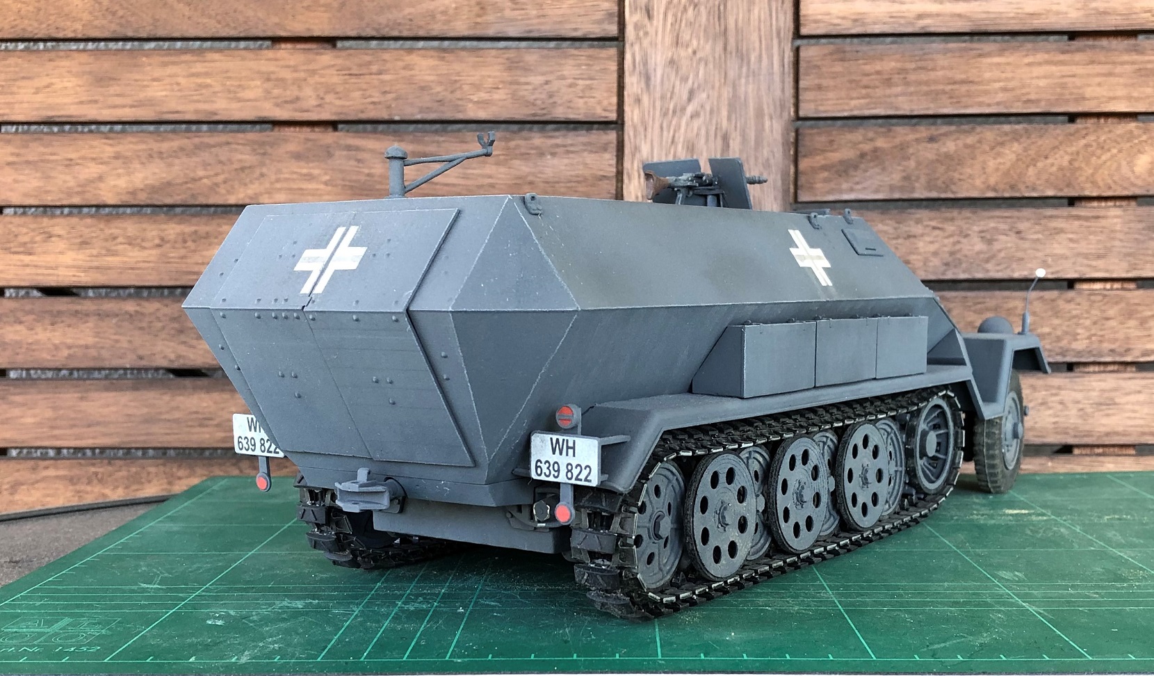

Needed a longer time until my "Berta" was able to make the first moves outside, but today it worked
The build isn´t finished yet. Decals, wasshing and a crew will follow.

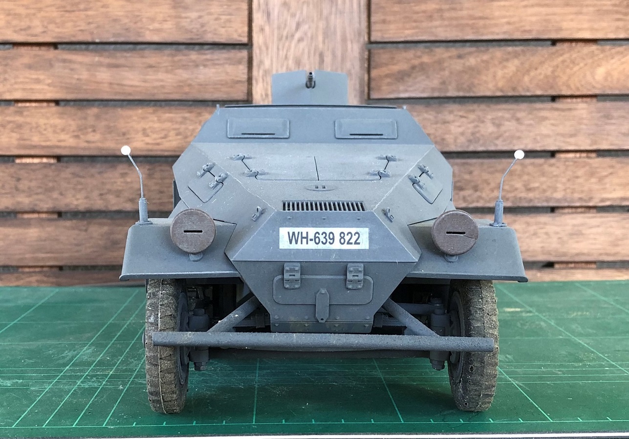

Some pictures of the slightly weathered ... and finished vehicle.
- EAO
- Posts: 1162
Re: Sd.Kfz. 251 Ausf. B - work horse of German infantry
PJ66,
That turned out great! Perfect amount of weathering, not too much nor too little!

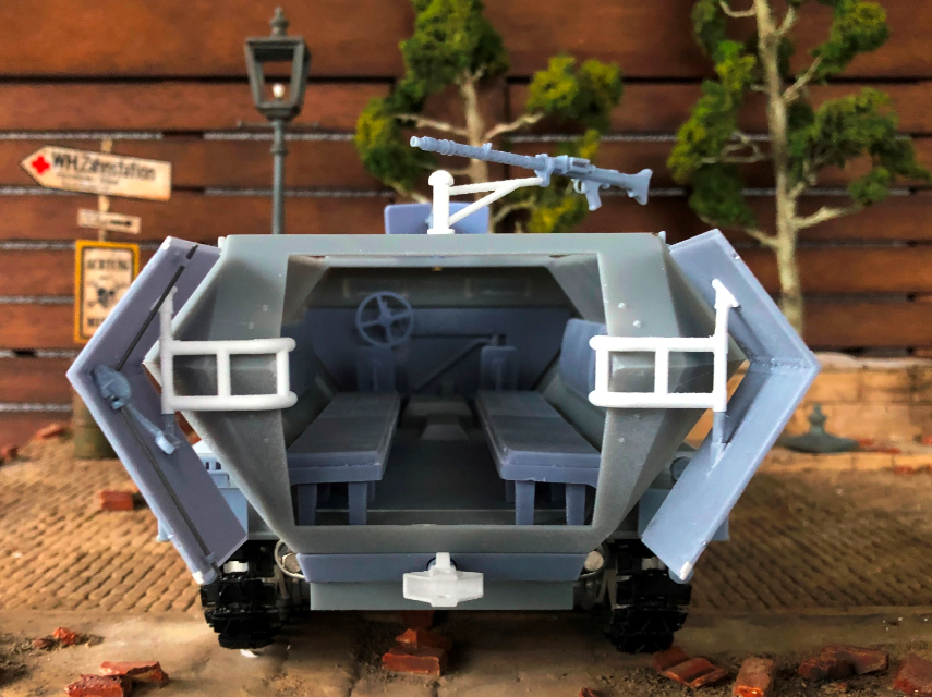

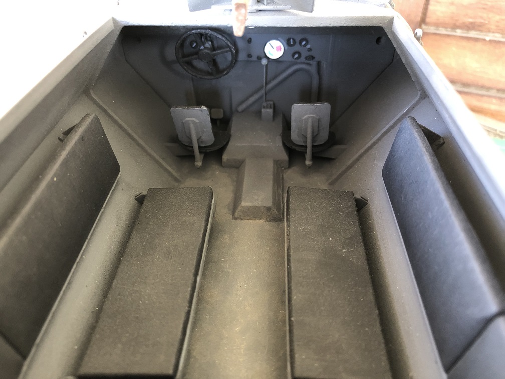

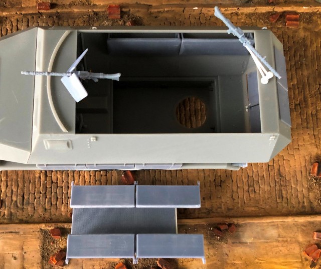

I would like to show you our revised version of the Sd.Kfz. 251 Ausf. B.
At first sight you don't see any (big) differences, but some things have been changed:

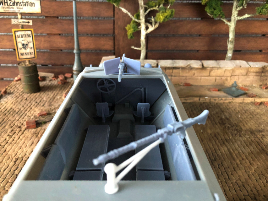

- the hull has been optimized and fits perfect now (compare hull/hood before/after), the wall thickness reduced but still more stable than the first version. In addition, reworking of the hull to eliminate printer support structures is no longer necessary.
- many former add-on parts (e.g. chain plates, storage boxes, headlights,...) are already integrated in the hull.
- the profile depth of the front rim was increased.
- the track rollers have been lowered minimally and in addition the rear idler has been raised slightly.
- the wheel profile has been reworked face sided so that the layer gradations are less visible.
- the hull bottom is closed, instead the fighting compartment floor is removable; this also results in better stability/rigidity of the running gear.
- the trailer hitch is now designed to rotate to make it easier to move trailer loads off-road.
- no PLA parts used anymore; for stable parts only PA12 was used and the rest is high strength resin.
