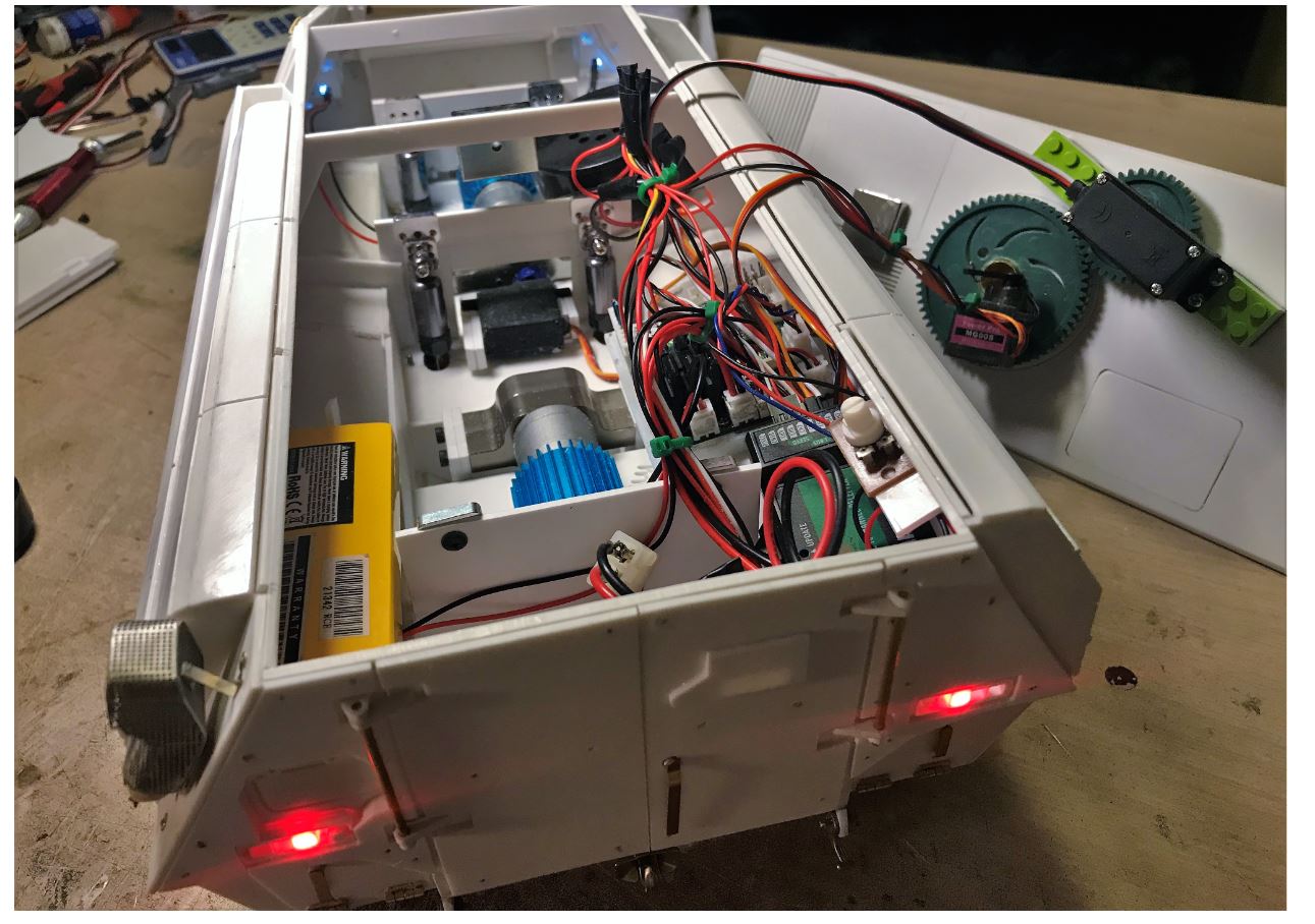

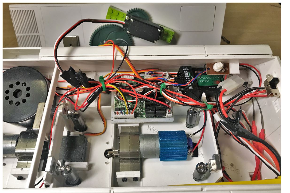

This posting is to show the electronics.
Lots of room here and nothing fancy. So, what we have are;
- Two Metal Gearbox with 370 Brushed Motor for WPL 1633, connected to L and R engine connectors on TK40.
- Two steering servos
- Clark TK40 control board
- HL speaker
- Flysky FSIA10b 10 channel receiver with S.Bus connector
- DS04-NFC 360 Degree Continuous Rotation Servo for FLW200 rotation
- Vex robotics gear set for rotation
- Micro servo for gun elevation
- Zippy 1800 battery
- Flysky FS16X 10 channel emitter has following Auxiliary channel (6 to 10) settings with TK40 S.Bus. Configuration is a bit complicated to figure out for a wheeled vehicle with a gun turret. I am not that agile with the sticks so maximizing switch assignments of many functions improves user experience for me.
So here is the configuration;
o VRA knob on Channel 5 for steering servos connected directly to receiver with Y connector. Use of VRA Knob as a driver's wheel is easier and more stable than TK40 stick control.
o VRB knob on Channel 6 for gun elevation servo connected directly to receiver. VRB knob is easier and more stable than TK40 stick control.
o Swa switch on Channel 7 (gearbox clutch, lights)
o Swb switch on Channel 8 (engine start, stop)
o Swd switch on channel 9 (switch Up for machine gun 2 used for MG-3 that will be installed at the rear of the vehicle)
o Swc switch on channel 10 (switch Up for machine gun 1 used for GMG automatic Grenade Launcher, Middle for silence, Down for big gun/recoil but there is none on this model)
o Right stick up-down for engines forward/backward
o Right stick right-left for FLW200 rotation
o Left stick unused

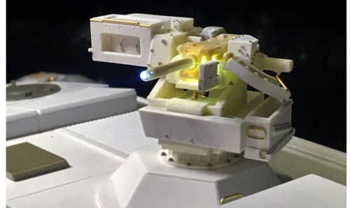

The above settings allow for the turret to be operated and for the shooting of the gun while driving the vehicle. Something you cannot do if you keep the Clark settings where you need to stop the vehicle and use both sticks to operate the gun alone. It gets difficult to coordinate the gun with only 2 hands with sticks requiring specific positions to trigger something to happen.
RC 1/16 TPz-1 A8 Fuchs 6x6 Transportpanzer with FLW 200 build

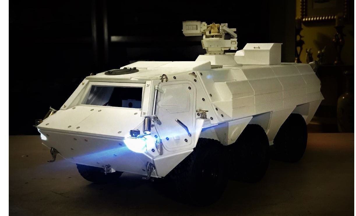

The translucid gun flash will disappear once the resin gun is primed and painted. With a very fast rate of fire of 340 rounds per minute, the GMG 40mm automatic grenade launcher is well represented using the machine gun 1 flash and sound of the TK40 control board.

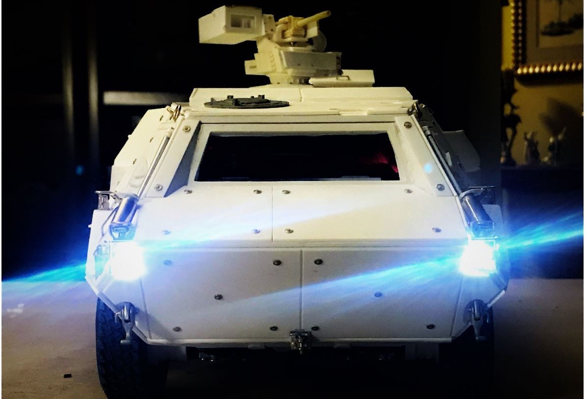

I always give my model working front and tail lights using cheap $2 pre-wired with resistor RC LED set from eBay China bought by the dozen. Also used for gun flash.

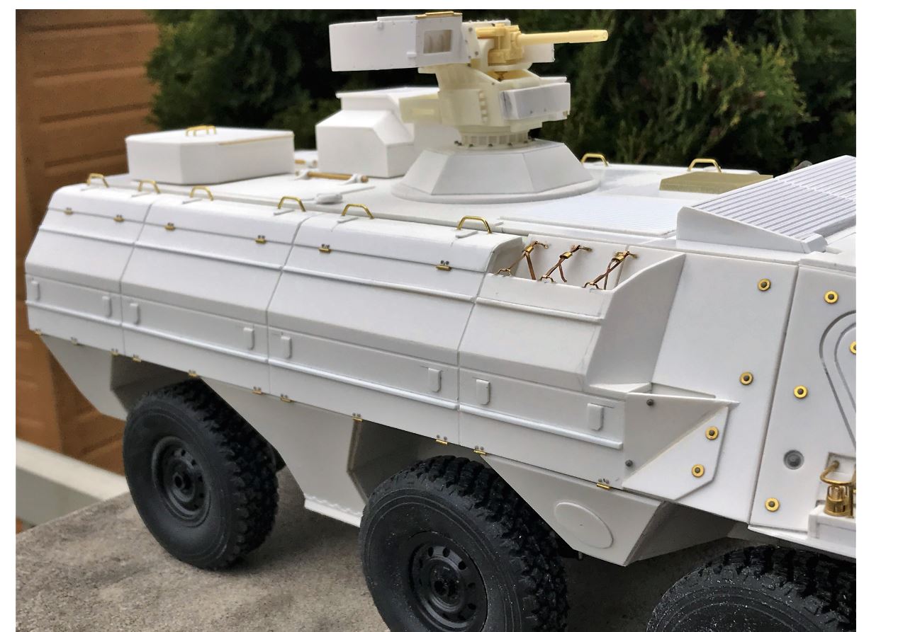

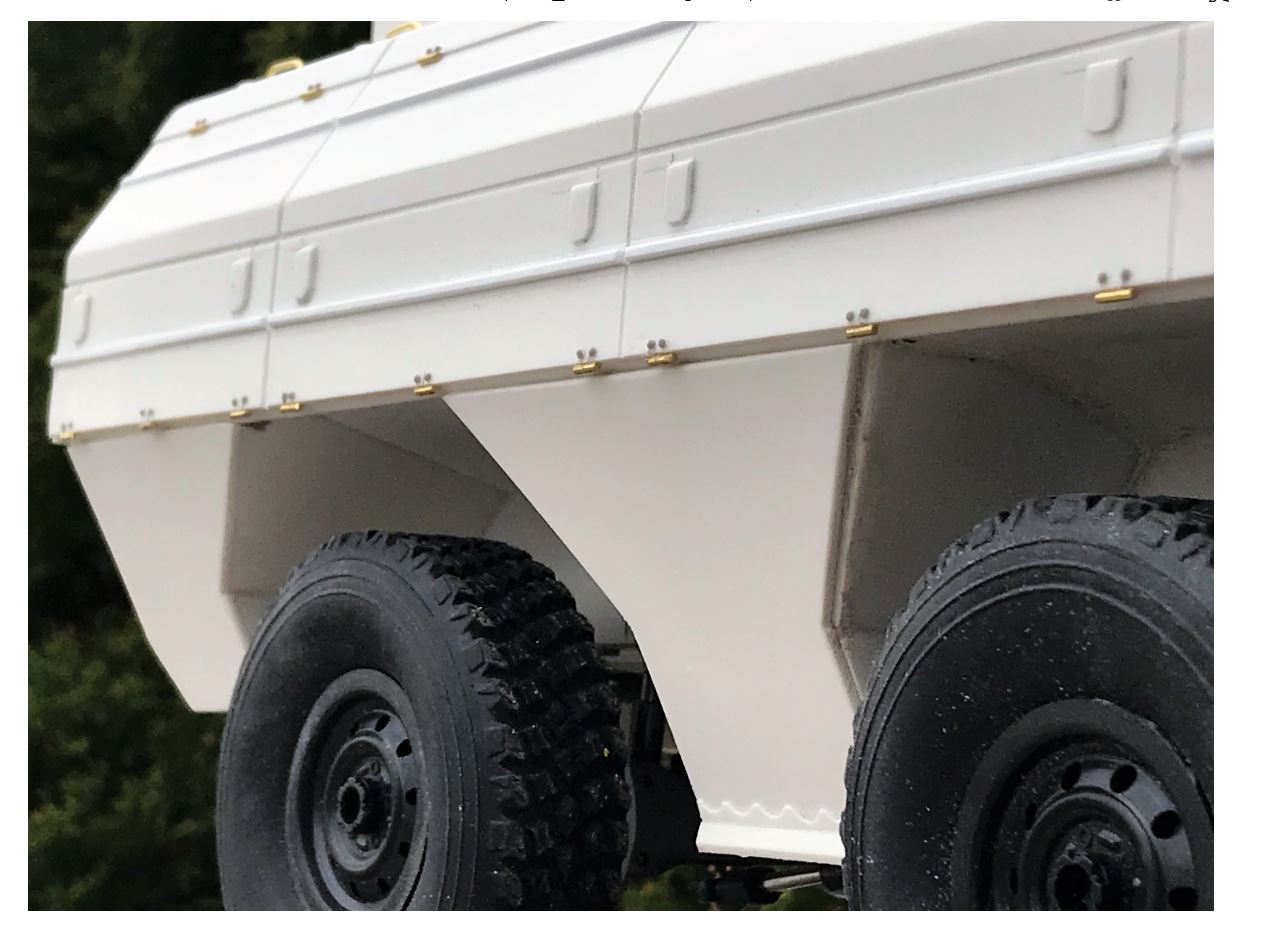

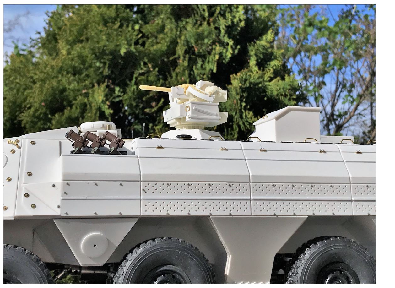

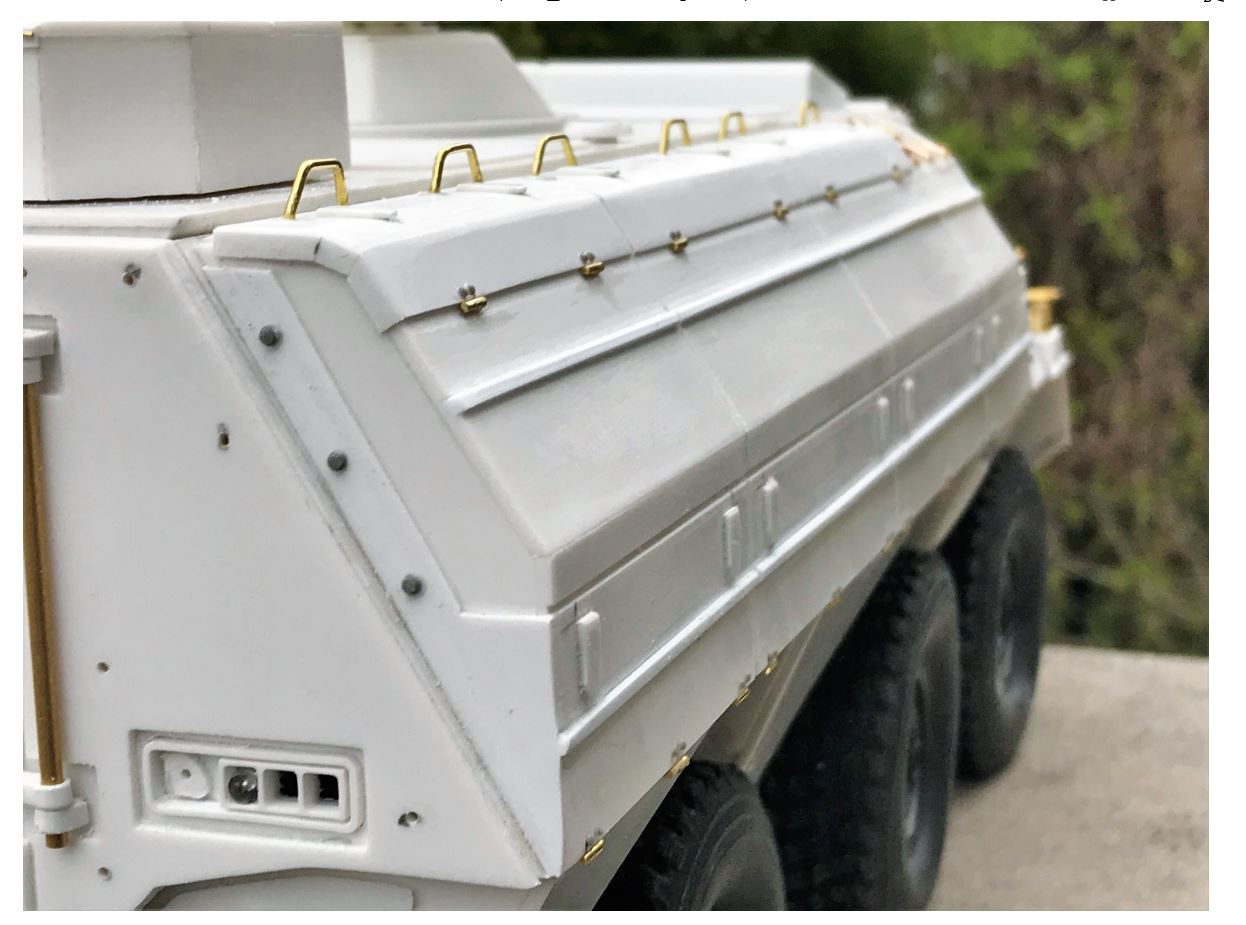

This post is for the detailing of the side bins.
The parts provided by Ludwig are enough to create the overall shape of the bins. Many builders will be satisfied and tempted to sand these and leave them shiny and sleek but it is not accurate.

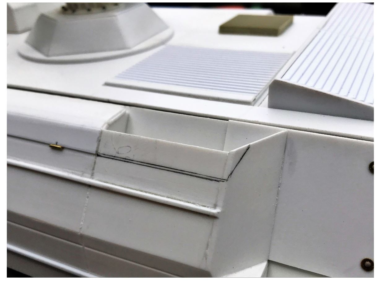

The bins have trap doors at the top which are not provided by Ludwig. Notice the mysterious black latches.
The contour of the trap doors are highly visible and provide a function for the bins which otherwise would look like some kind of flotation device.
A lot of study is required to understand the concept and bring them to a more accurate rendition. Plasticard sheet, Meng nuts and 1mm brass rod are used to reproduce the trap doors and many features seen all around them.

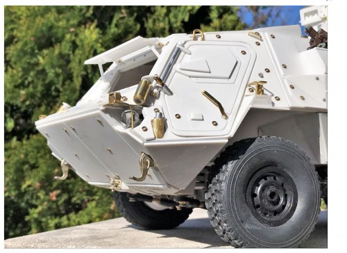

The right side has trap door with hinges at the bottom. On the left side, this lower area is covered by a perforated metal skin protecting the exhaust pipe that runs from behind the cabin all the way to the back.
Large handles are shown above each bin.

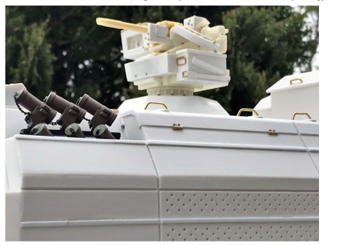

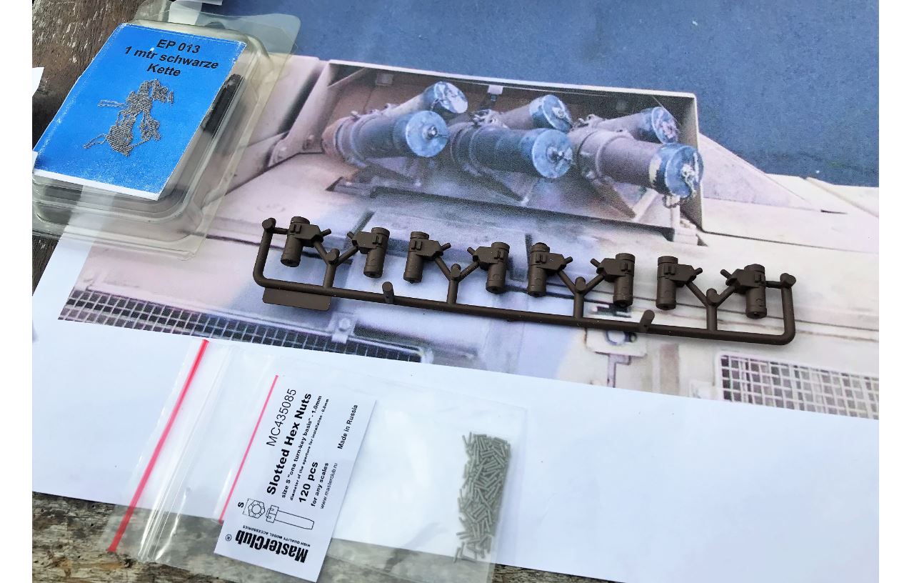

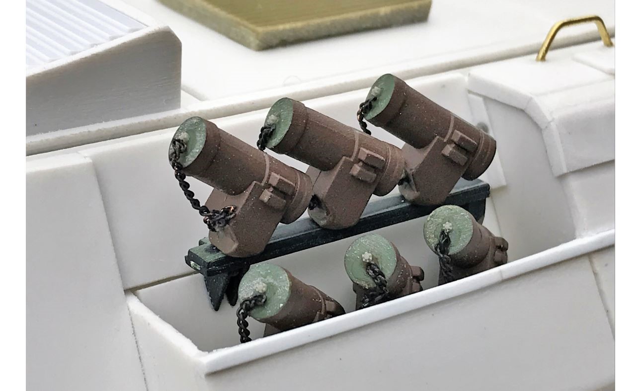

The left side has 6 smoke grenade dischargers at the front.
Heng Long Leopard 2A6 smoke grenade dischargers coming with the accessory set were bought from Toucanhobby on eBay, its pretty much the only affordable game in town for these. The 2A6 set also comes with mirrors and other items that are useful.
A small chain is always a good looking and simple addition to these. Oh, i forgot to add a small Meng nut on top of the bracket at the side of them.
Continuing on following post.

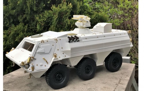

After the trap doors were installed, now the front section can be cut to the level of the hinges as seen in reference pictures.

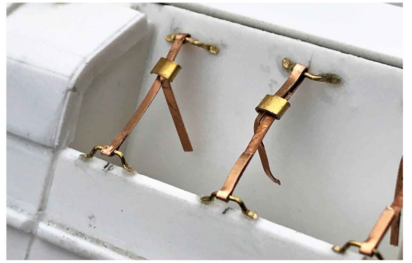

This is my interpretation of it, in brass and thin copper strips.
Ok, enough for today. It was a beautiful Quebec spring day of outdoor modelling.

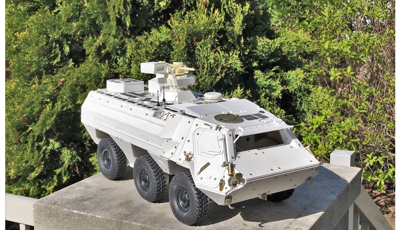

Re: TPz-1 A8 Fuchs 6x6 TransportPanzer - Bundeswehr - Build

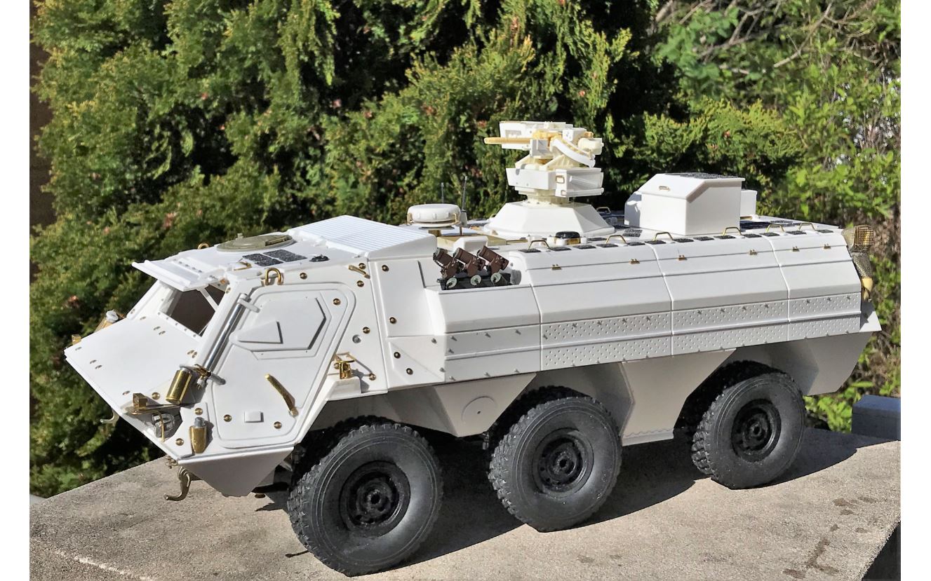

Presenting the roof in 3 parts.
This post is for the roof of the cabin.

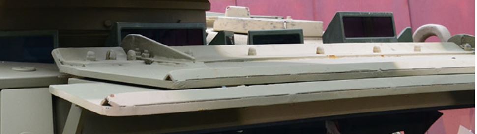

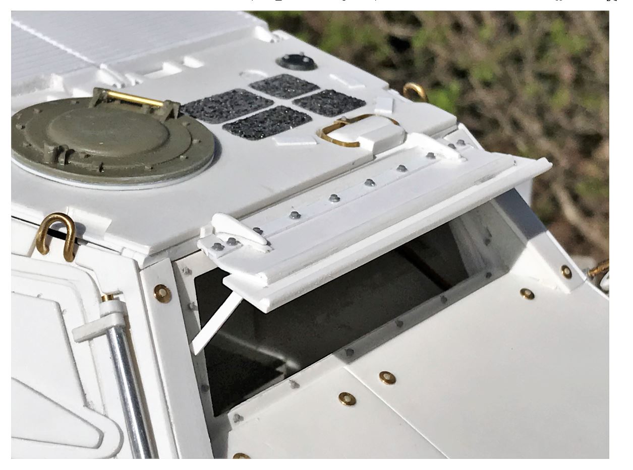

The fuchs is equipped with armored louvers for the windshield.
When raised, this is how they look. But I have seen some variations out there so be careful when selecting pictures.

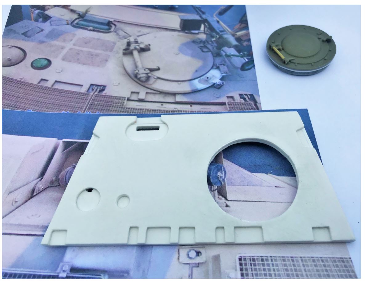

I purchased the AFV-Model resin Fuchs cupola. It is ok but does not open and missing some details. I added the brass rod for the hinge and added a ring to the base to beef it up a bit, it was too thin.

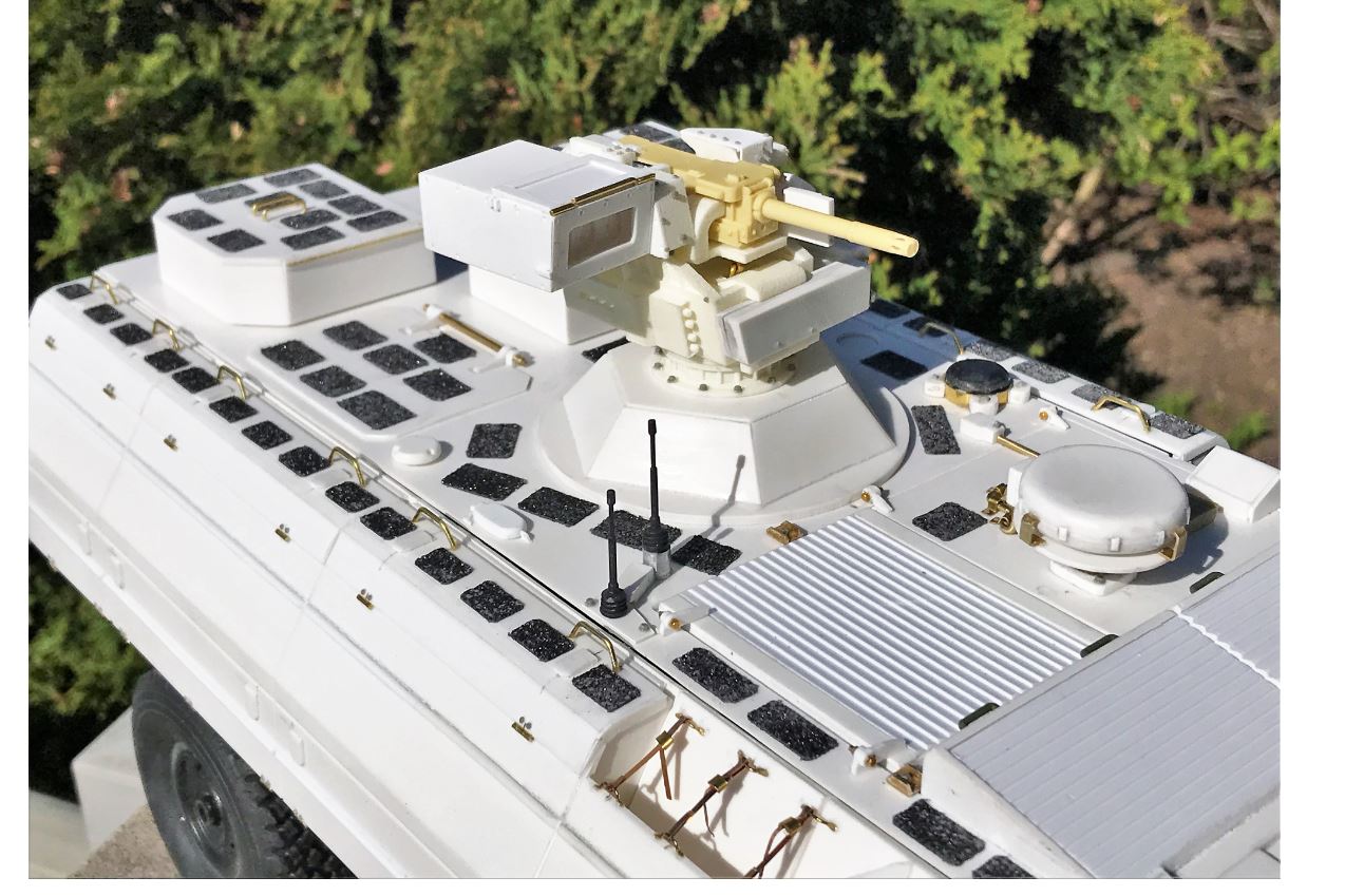

Picking up the roof of the babin where I left off some weeks ago with the creation of the add-on armour.
Ludwig only provides two inaccurate parts for the louvers. The whole thing need to be scratch built using reference pictures. It took me a few hours but it seems close.

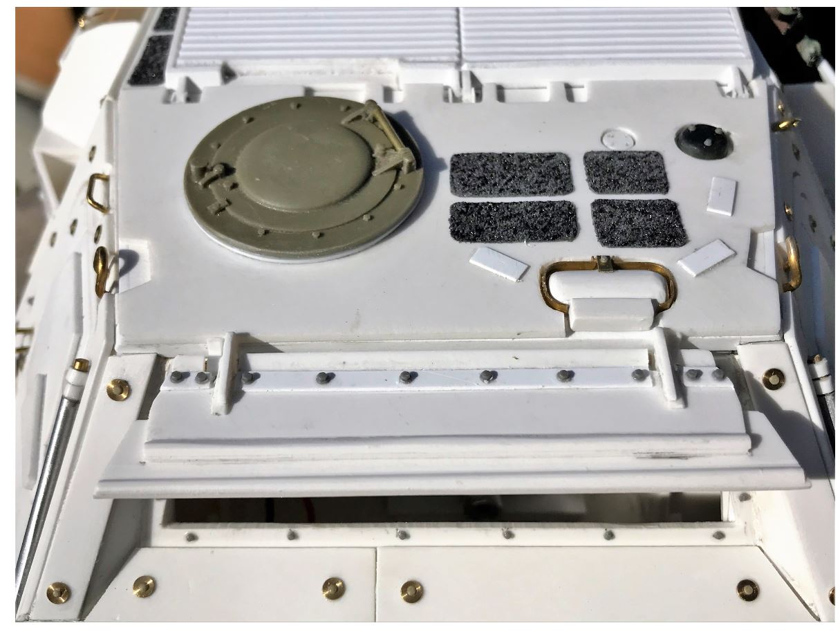

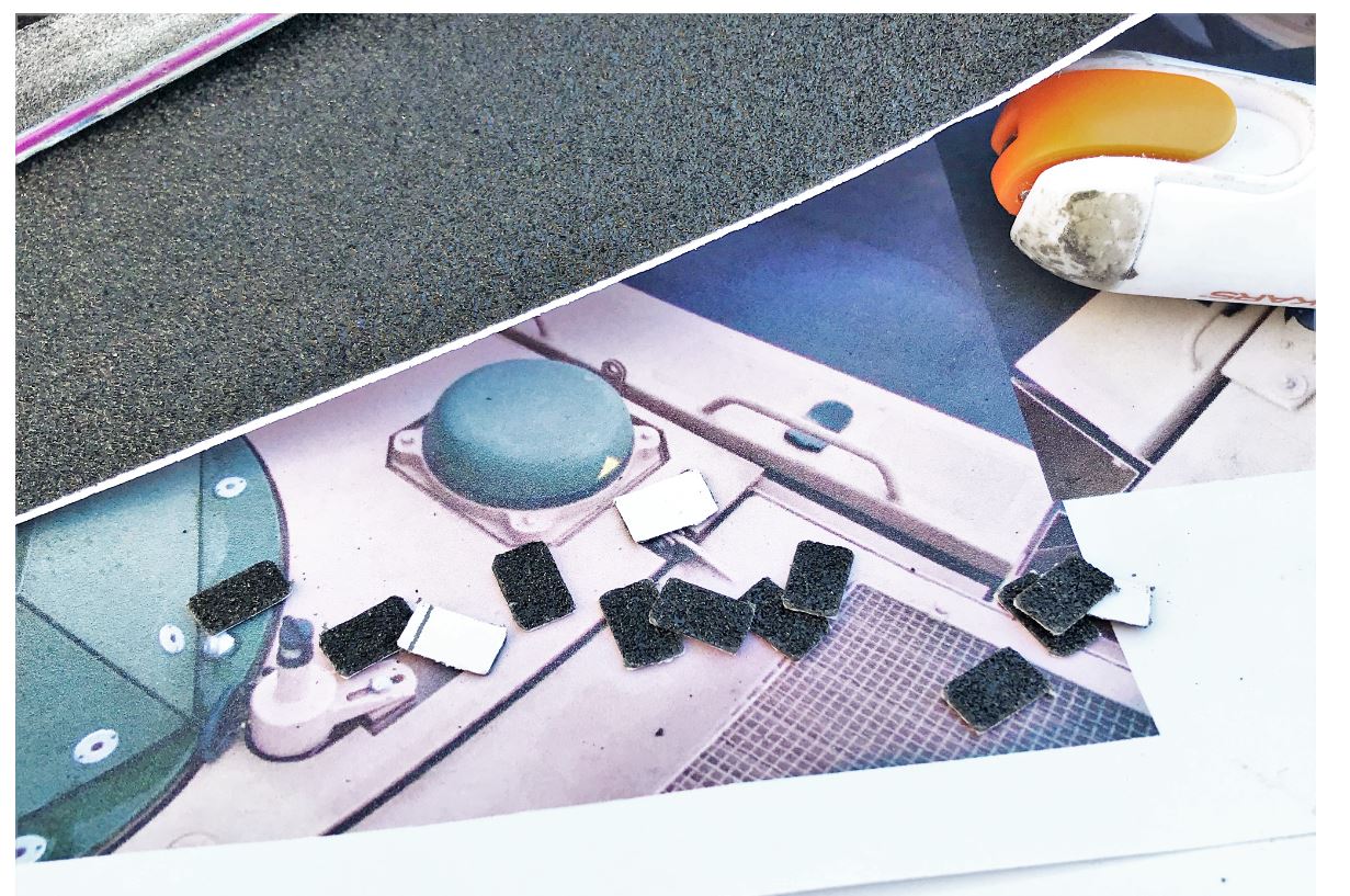

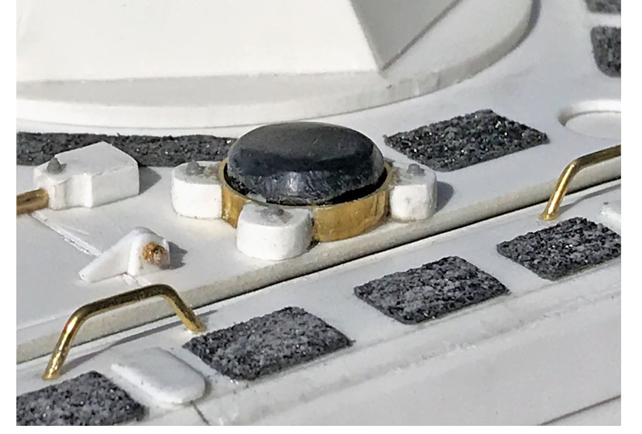

The driver's periscope was scratch built from vague reference. Notice the anti-skid plates, discussed later.

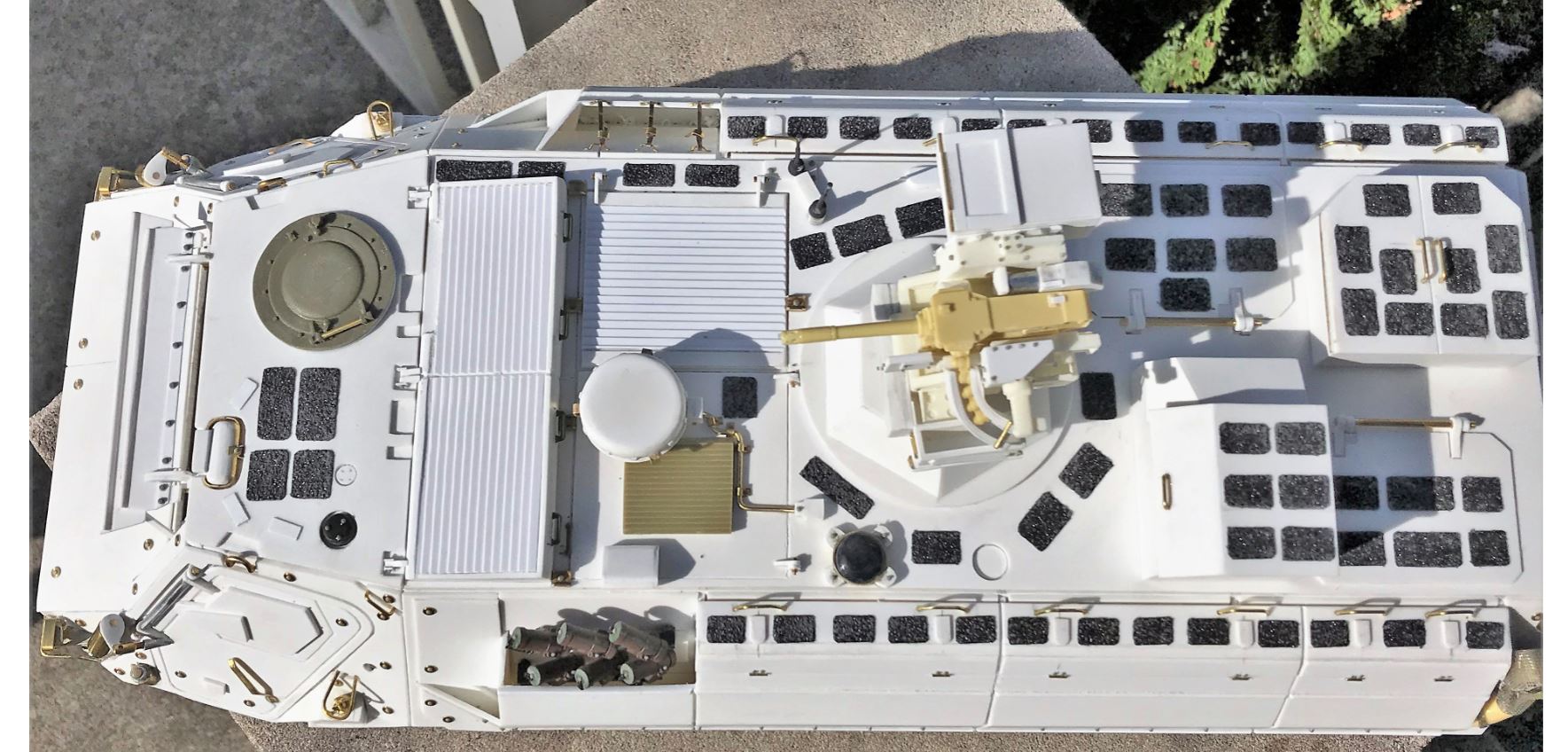

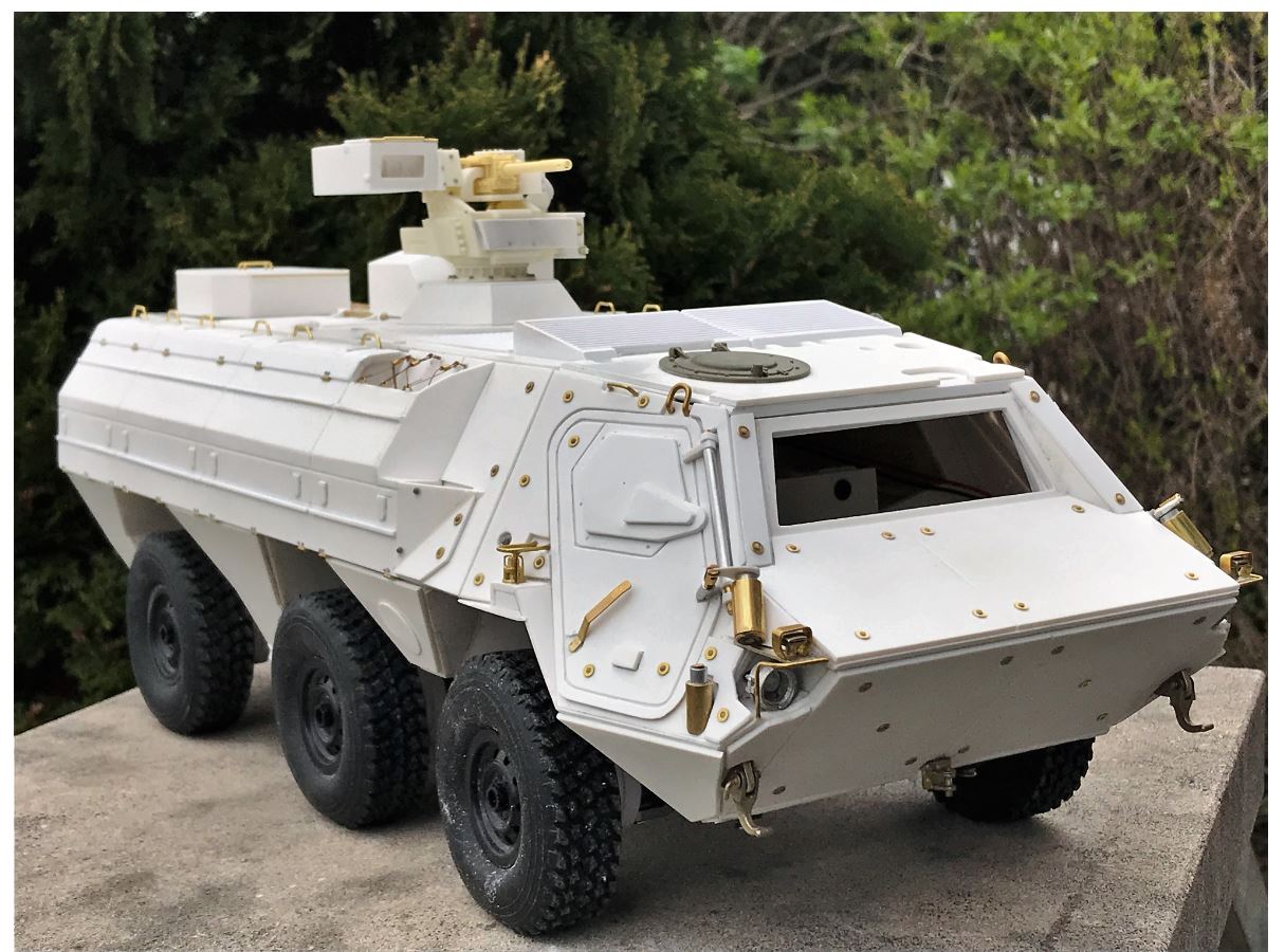

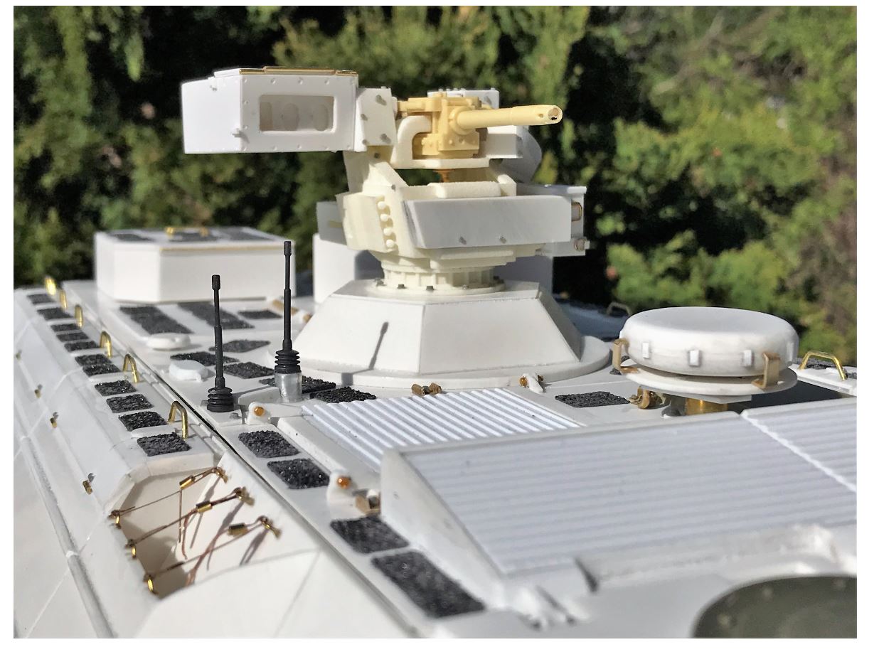

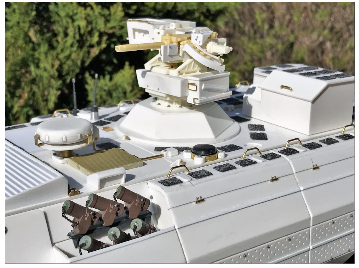

Overview of the finished cabin rooftop, with the hinges added for the engine grills and ventilation cover.

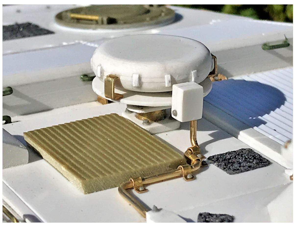

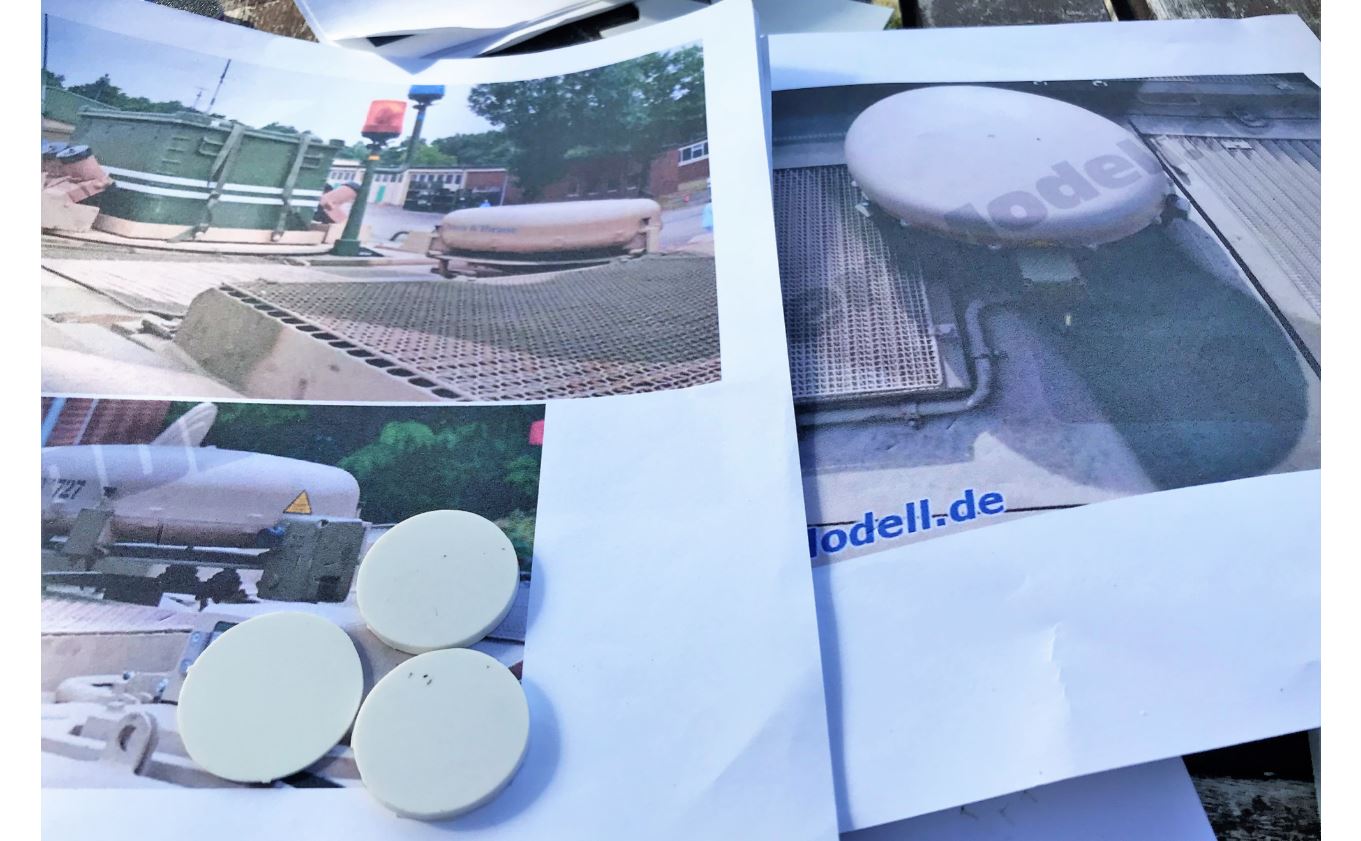

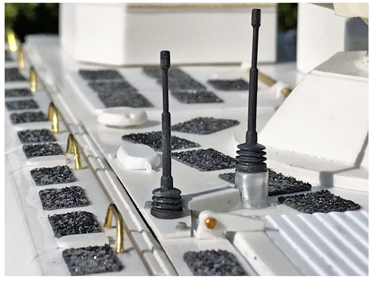

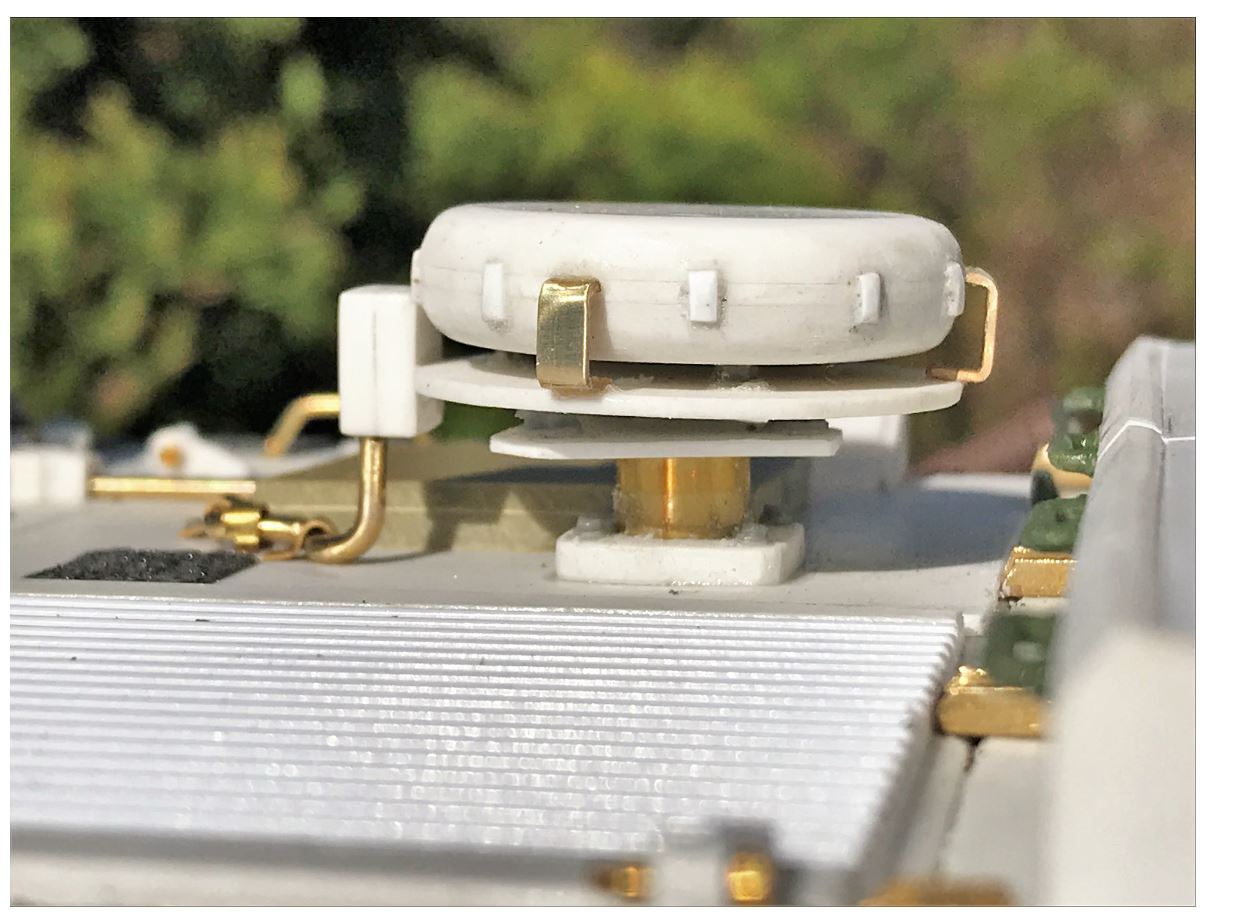

Many Tpz-1 are equipped with a Satcom antenna behind the engine grills at the front. This antenna looks too cool not to repro for my model.
Basic plasticard rounders will form the core.
This is the reproduced Satcom antenna, it took a few hours, not perfect but good enough for the time I spent on it.
AFV-Model sell non skid coating material on a self-stick sheet to reproduce the non skid plates on top of German combat vehicles. I am trying this for the first time.
It can be easily cut but it is too thick, so some sanding is required in a attempt to make it thinner a bit.
The plates are cut using the few reference pictures available. Few guys actually mount on top of this vehicle to picture the overall layout of them. Pictures on http://www.panzer-modell.de were extremely valuable for this build, but there were still some gaps in references.
All corners need to be rounded with a file. The antenna are from the HL Leopard 2A6 accessory set.
My interpretation of the layout of the anti skid plates. Not perfect but it looks good. As they are on self stick material, they can be removed and reworked as necessary. I am still seeing many imperfections that need replacement or better alignment. These are an important feature of the vehicle.
continuing on following post.

Overview of the vehicle. The roof top is almost completed, only missing the add-on armor attachment points and the engine grills. The Coronavirus pandemic is slowing down international shipping tremendously for any parts that need to be ordered during the build. It is undetermined when I will get them.

There is still a few things to install, such as the cabin mirrors, steps, wheel caps and whatever is still in the mail, but it is almost done.
