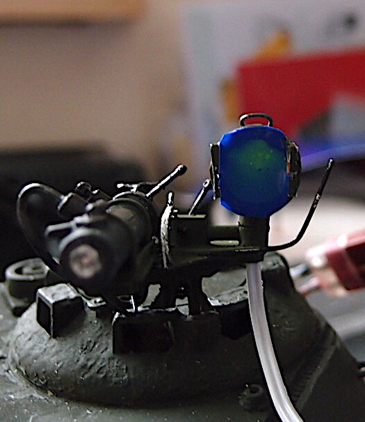

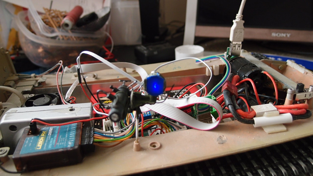

Blue paint mask fitted , high and low light intensity. General Jimbo was asking about pics of you resin IR searchlight.
paint mask material for lens
high with yellow led
low  yellow led, fit a blue   led and its done

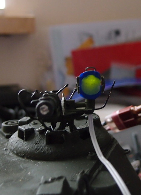

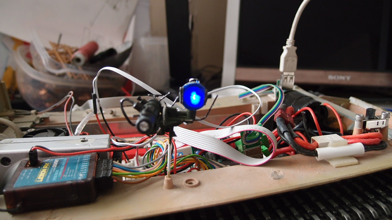

Found a small blue led, set up led and then lens filter following Eastern Fronts advice. Works a treat, next up find some fine wire for the power so that the cable does not ruin the effect.
max intensity
max intensity
lowest setting
lowest setting

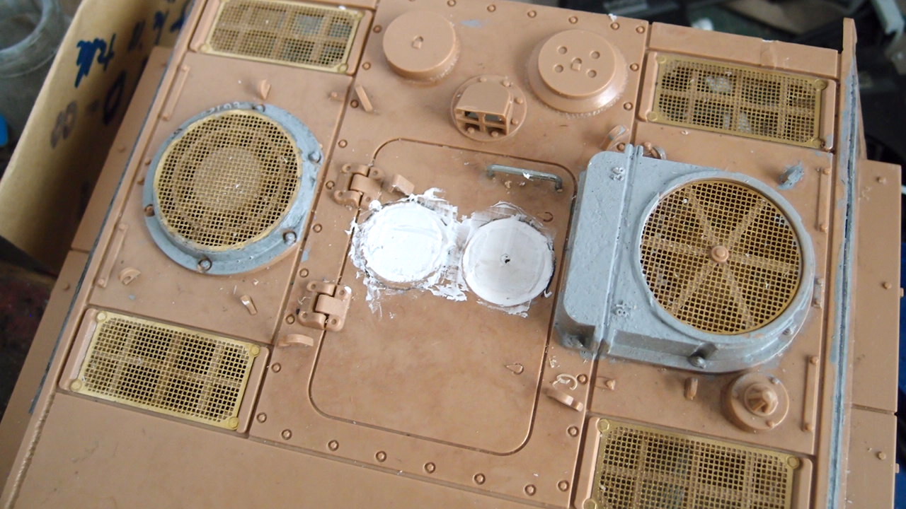

Back onto the hull , here is another little error on HL and Taigen that bugs me.. Covers for air filters are moulded onto the engine deck, should be raised to let air into filters. The F is a test run as the other Panther is painted, need to get a neat removal and fix sorted out.
Covers should be raised to enable air to be drawn into the engine.

Yep, indeed once you know you can't leave it like that. Just cut them off, full the holes and glue some nice replacement covers on.

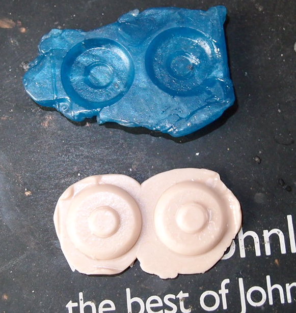

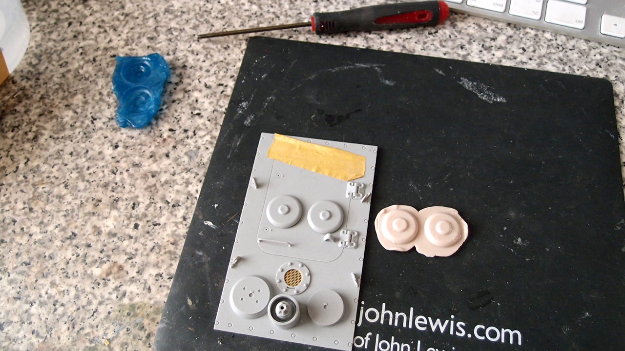

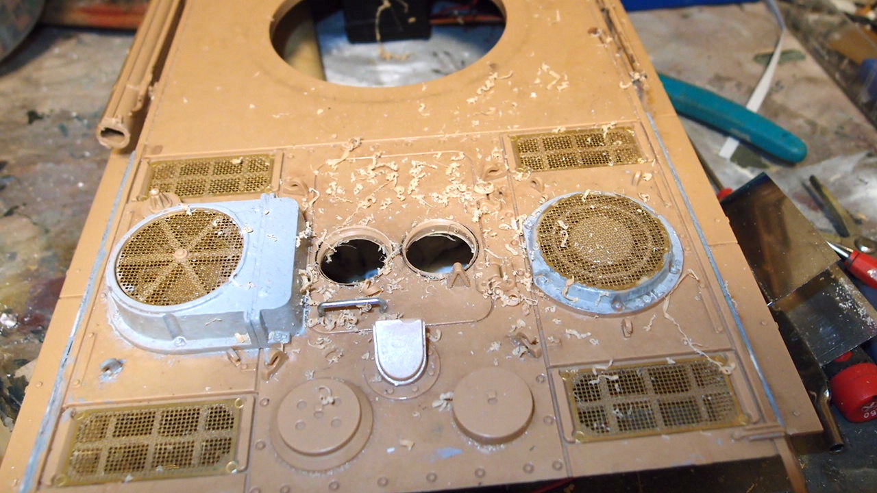

HI Soeren Your panther build shows the effect of the raised covers. Last pic of tank and panel wash ,you see the shadow and its the little details that really add to the realism :D . Blue stuff is your friend , made some covers great stuff and reusable ;D .
Marked round covers ,don't want to drill out by them.
Hull ready for covers
covers with blue stuff moulds, even got the texture from mr surfacer

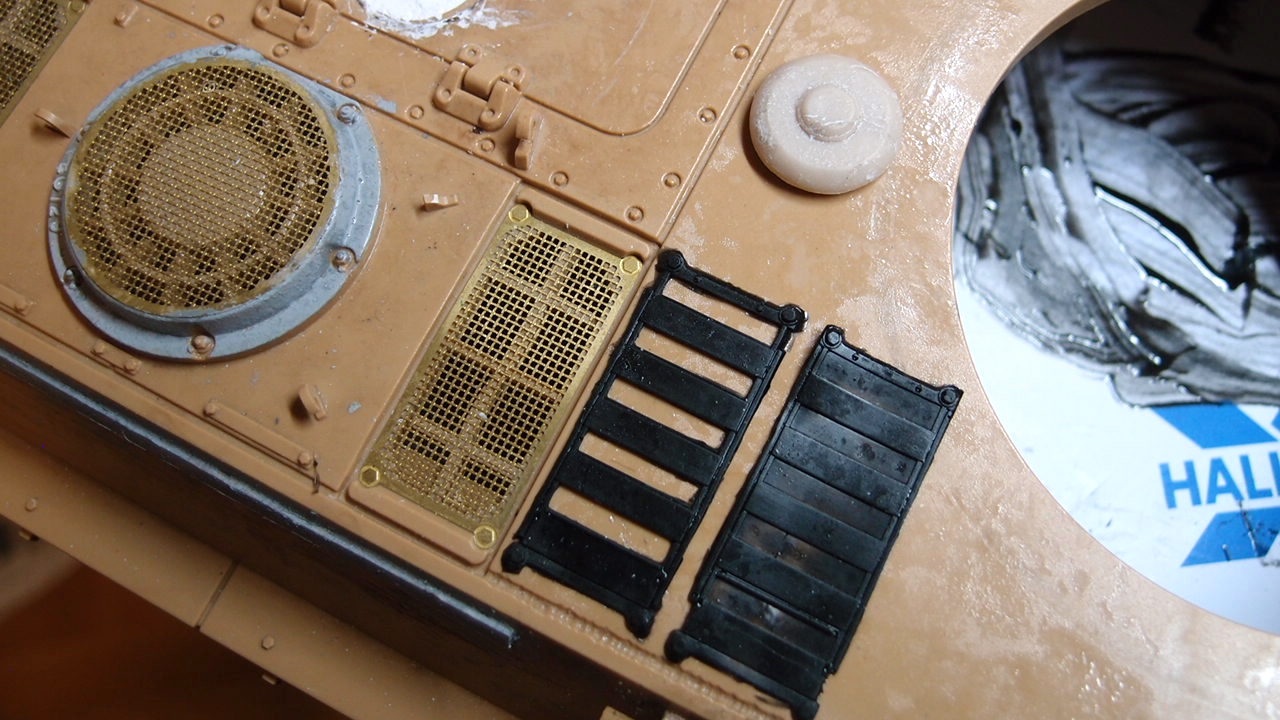

Trumpeter engine deck , covers are slightly different . Will cast them and decide what to use.

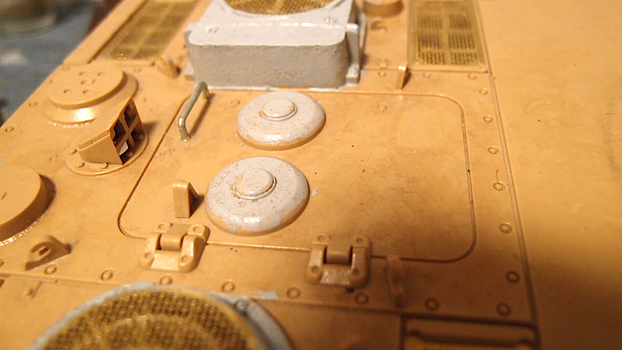

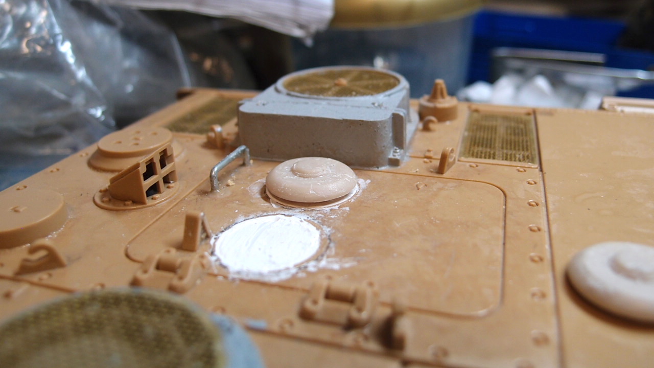

One air filter cover on to see how it looks , cast the louvers for fan /radiator ducts. Turned out well, open and closed versions. The Taigen cutout for the mesh is smaller than the Trumpeter 1/16 parts, will adjust to fit. Now to make another set as the mould was good.
Much better raised
Much better raised
Cast louvers open and closed, you can see the cast ones are longer.
