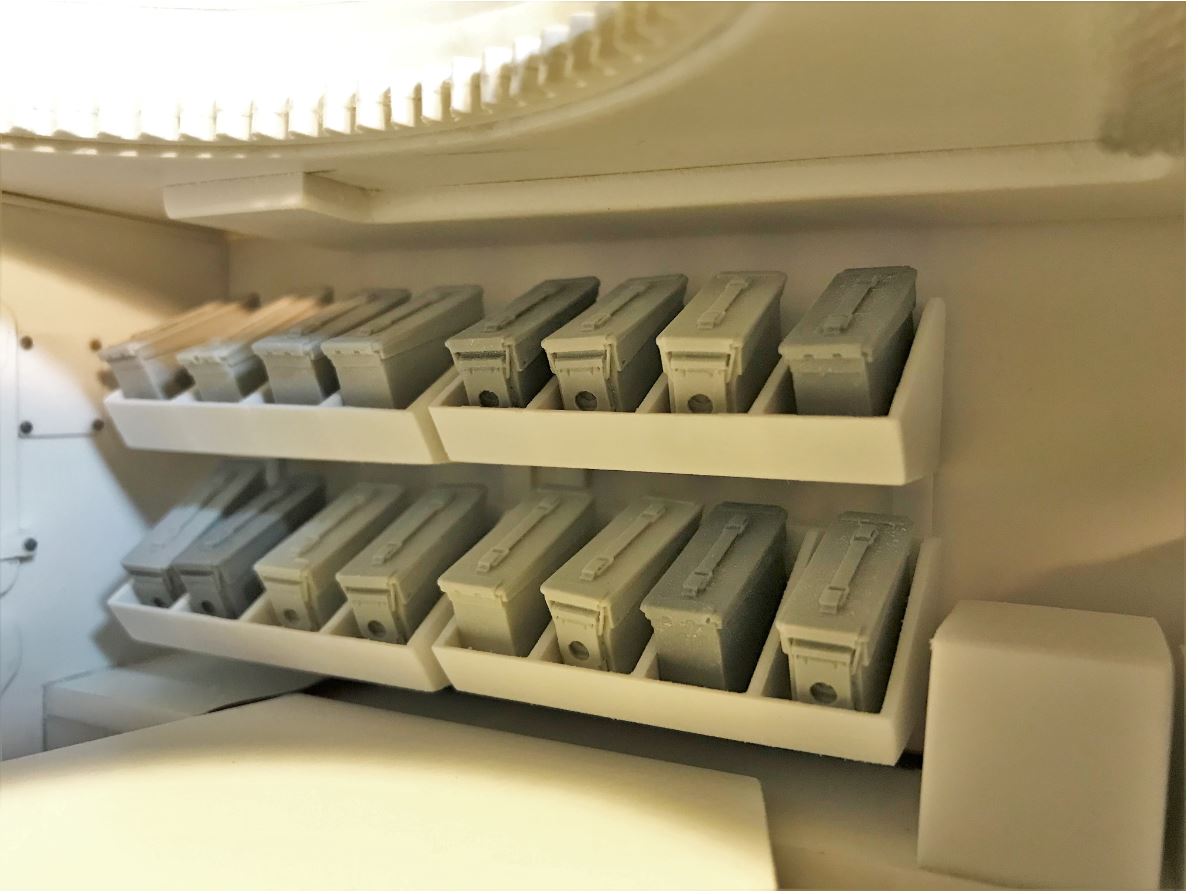

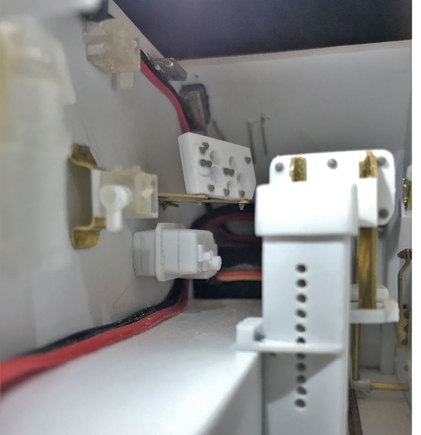

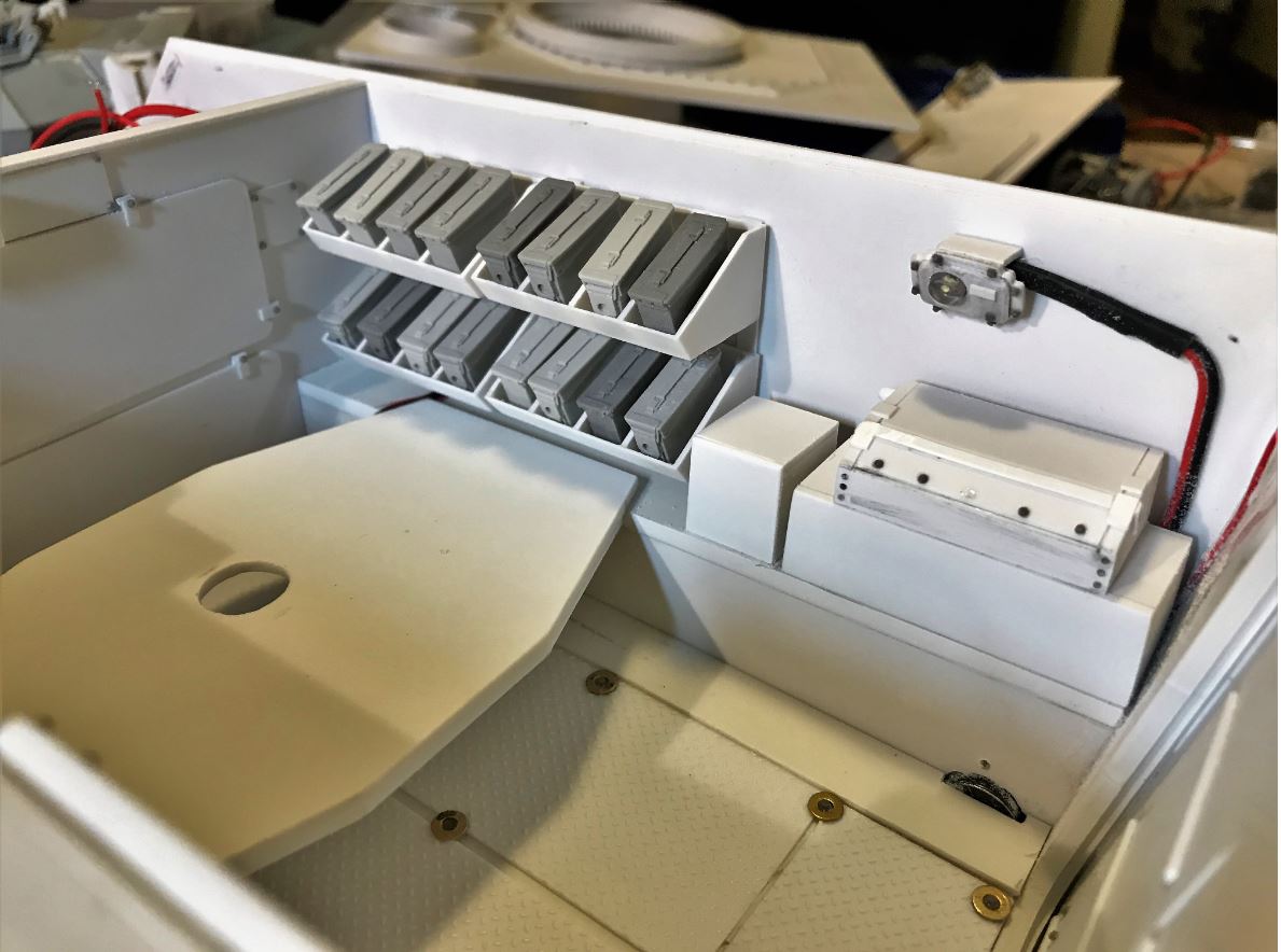

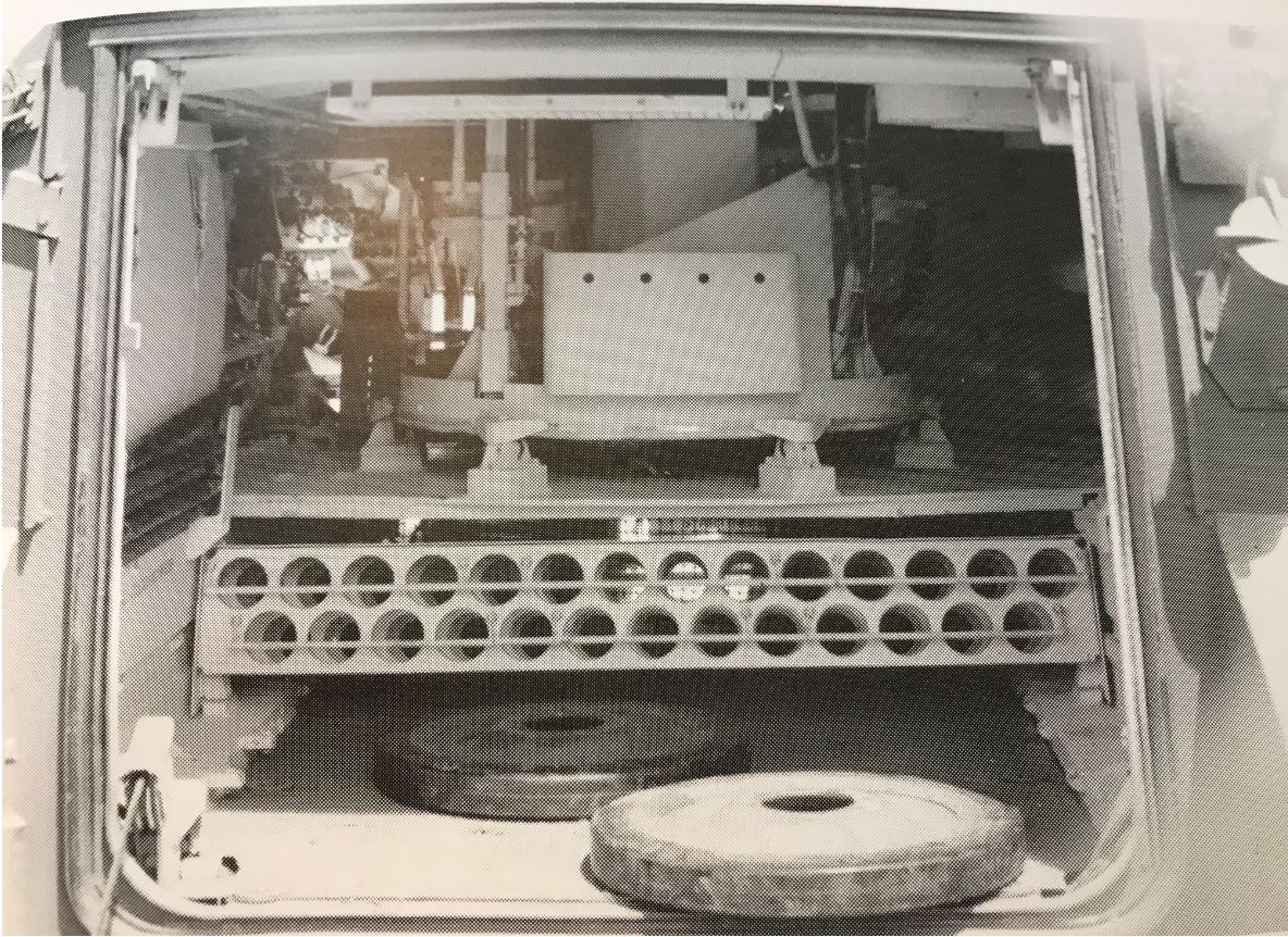

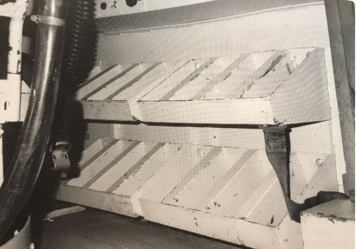

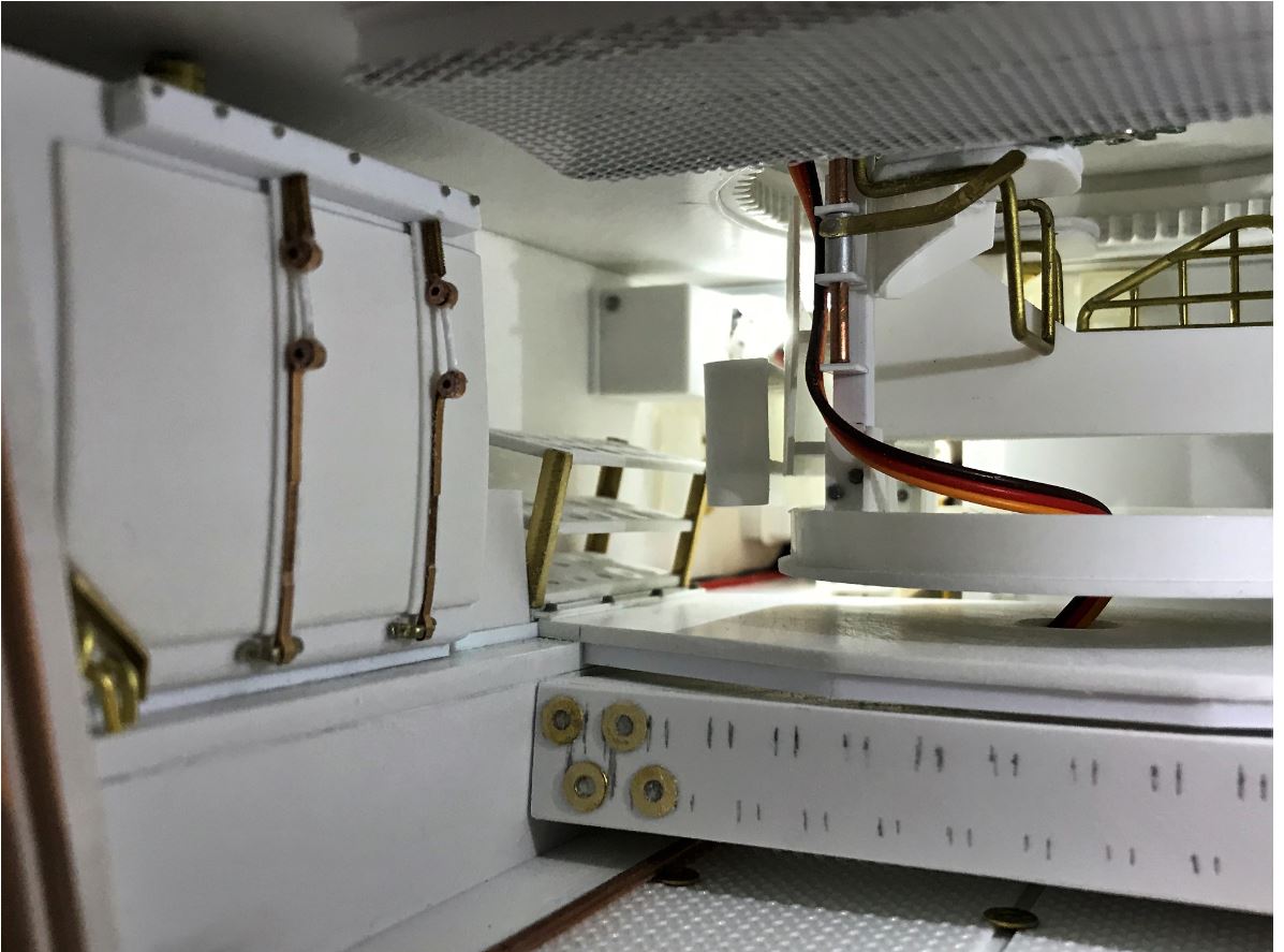

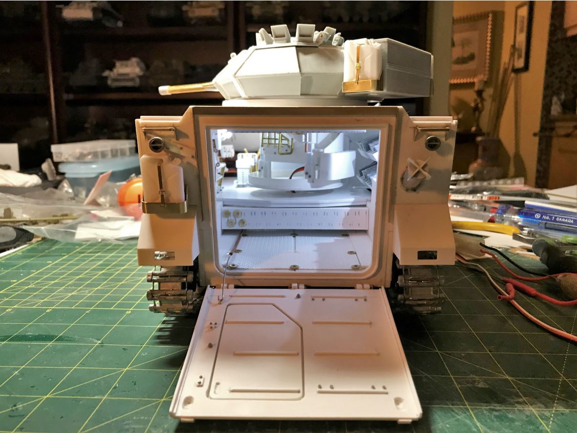

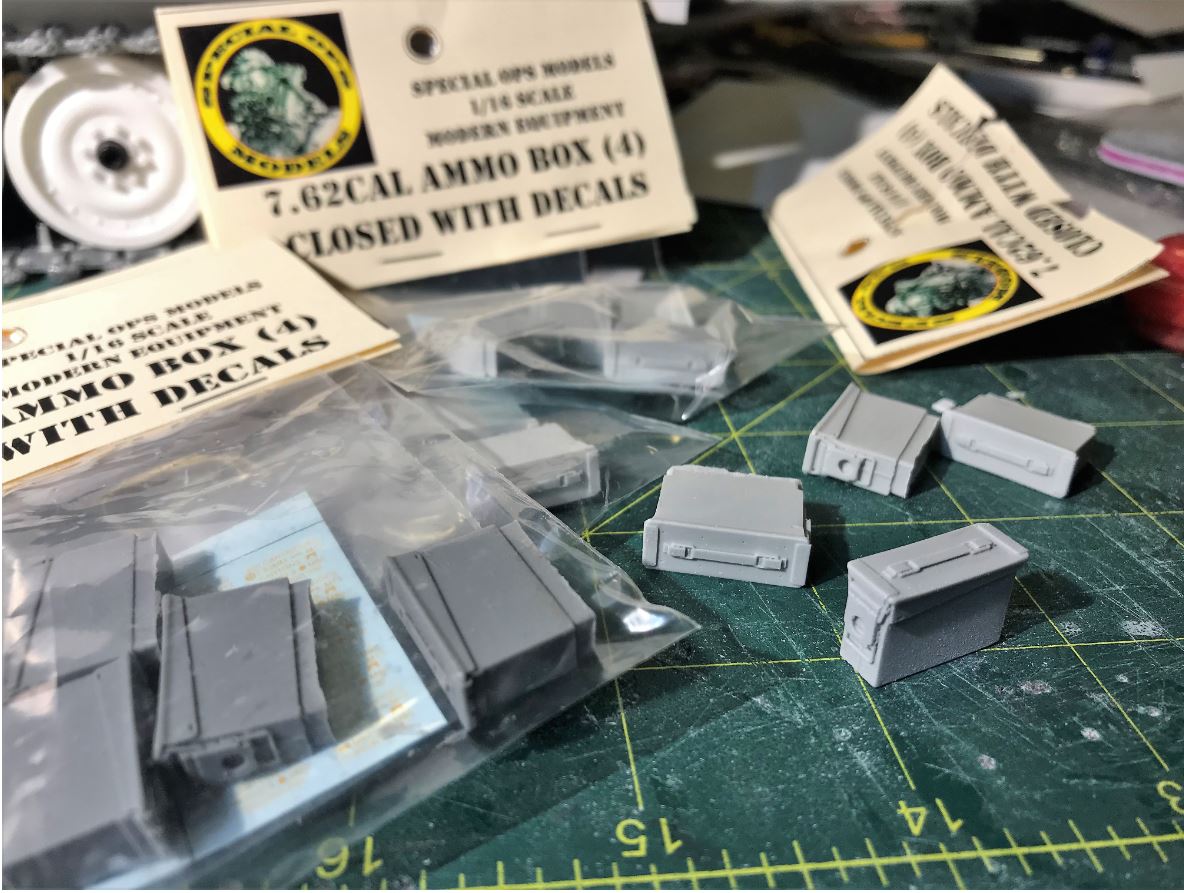

The right panel has storage room for no less than sixteen 7.62mm ammo boxes.
M-113 M113 M-113A1 MRV 1/16 RC Scorpion Turret Australian Army build

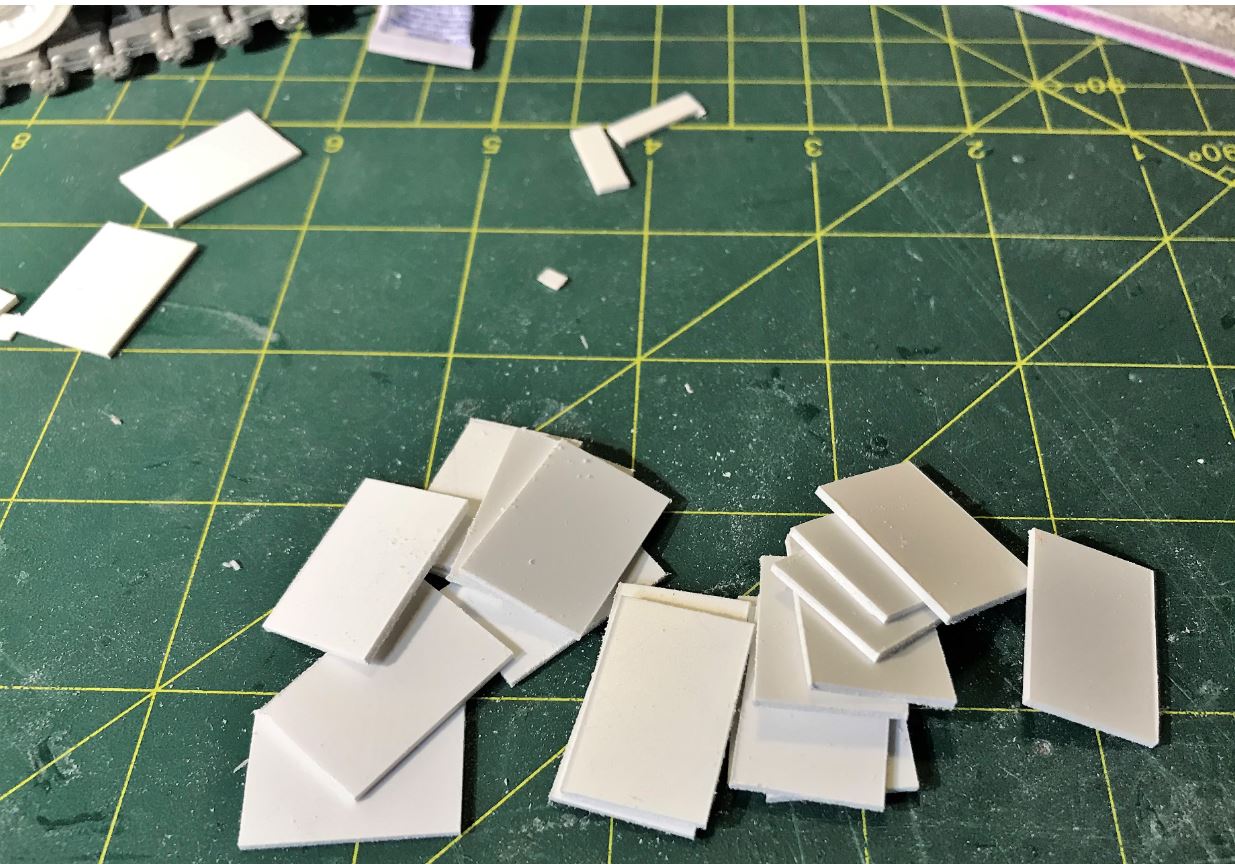

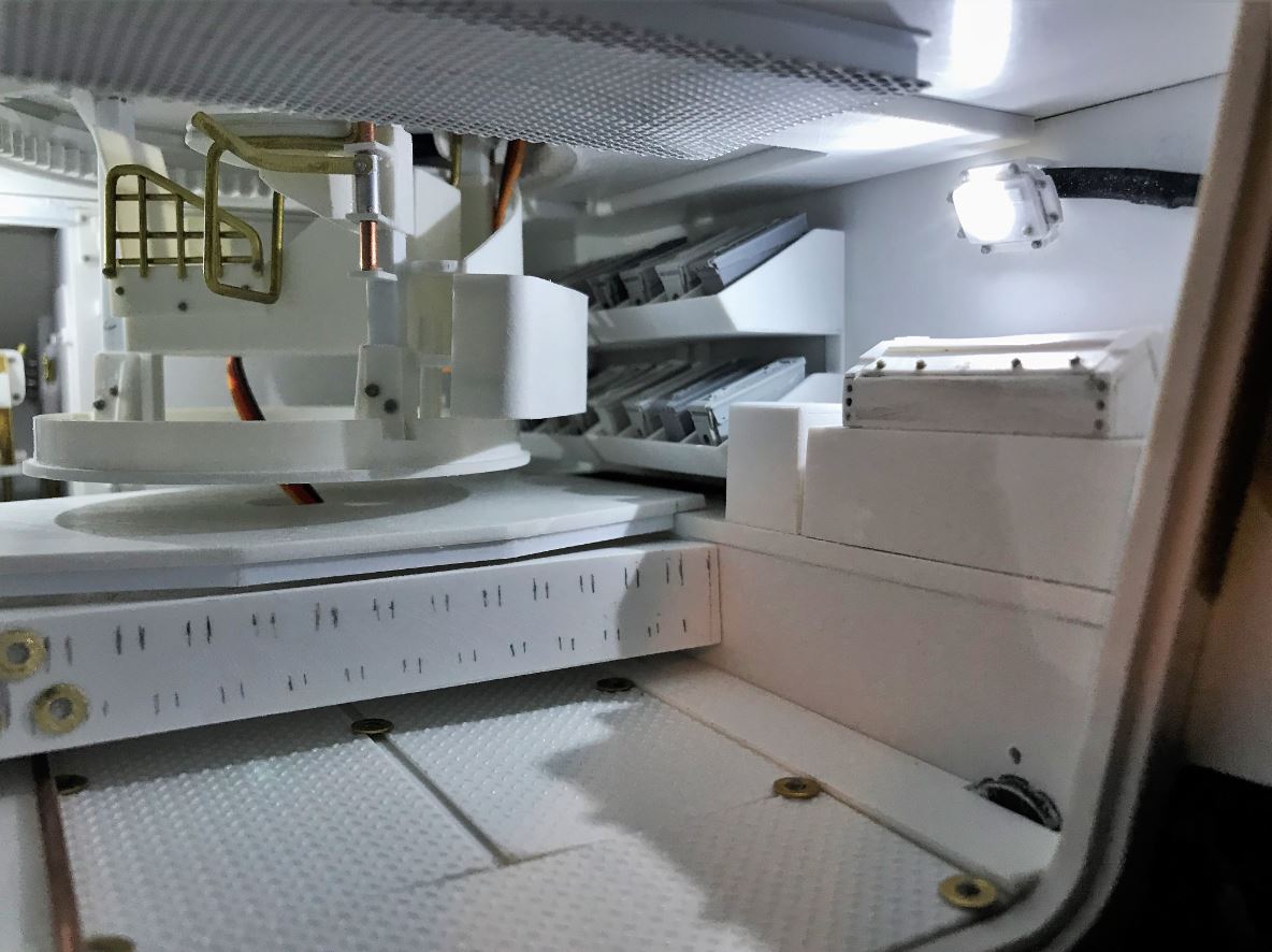

I could not leave these empty so i purchase 4 sets of Special Ops 7.62 ammo boxes, a significant expense.

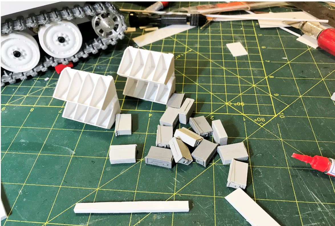

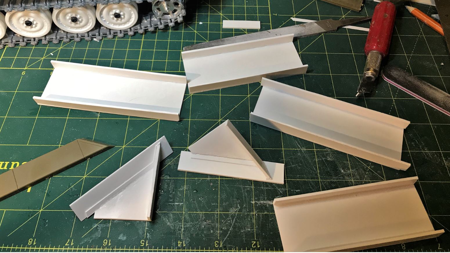

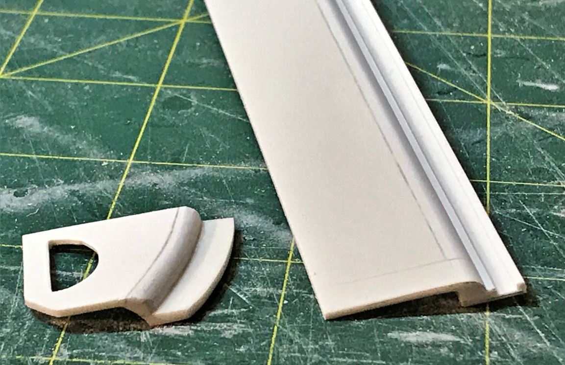

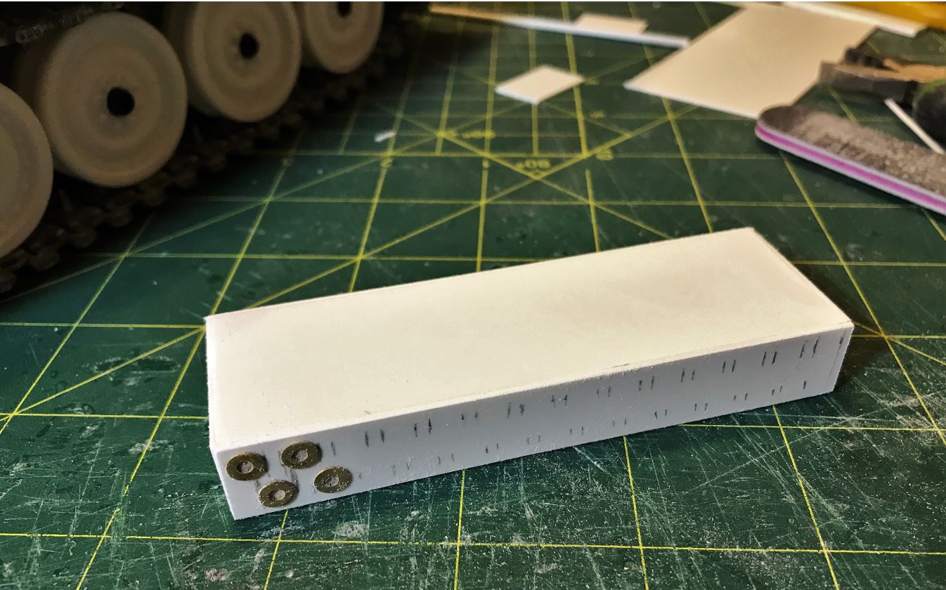

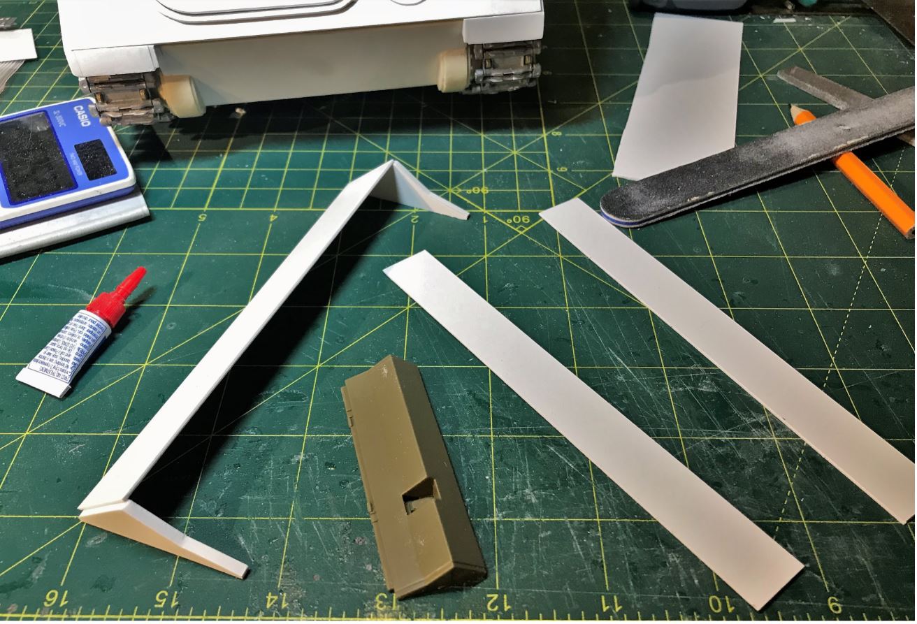

The racks were easily made in plasticard.
The finished ammo racks ready for install. I am giving it the honour of a full load of ammo.

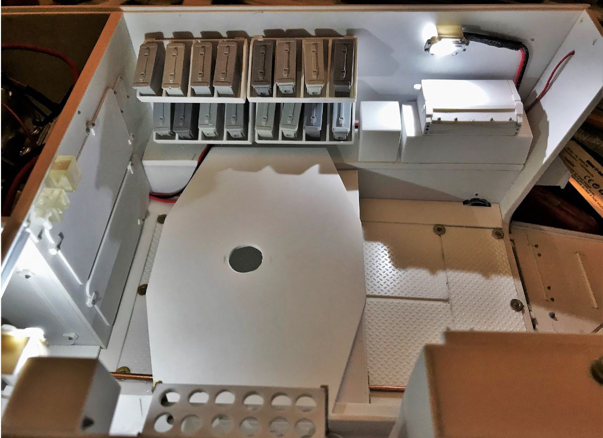

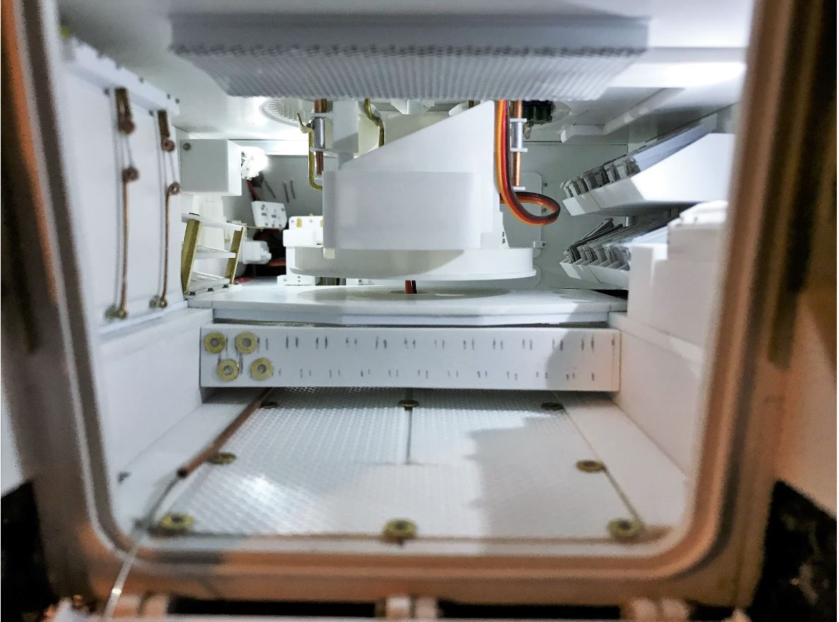

Overview of the right panel. You can see the 7.62mm ammo racks and the battery box. The purpose of the mysterious box between the two is unknown, but as it it located next to the battery, it is likely electrical in nature.

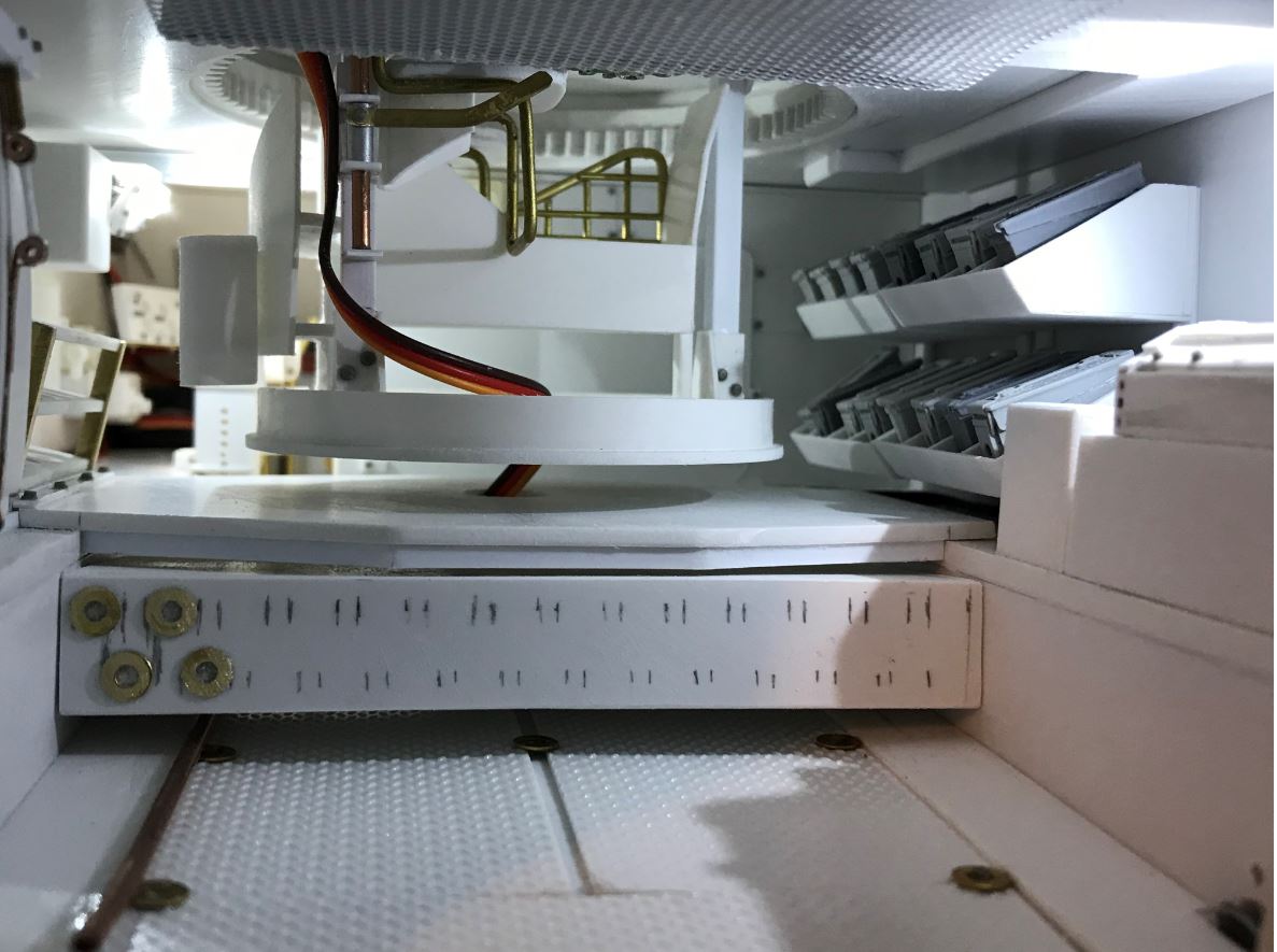

Below the turret is a ammo storage rack for twenty seven 76mm rounds for the main gun. Its inclined towards the front. Picking ammo from this storage unit required the turret crew to exit the turret.

The ammo rack is temporarily installed under the turret for the fit. It will be installed after painting and after the wiring for the turret are all in place.

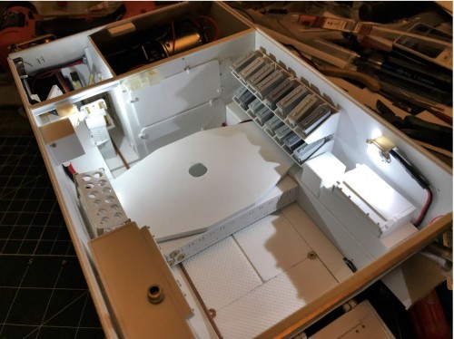

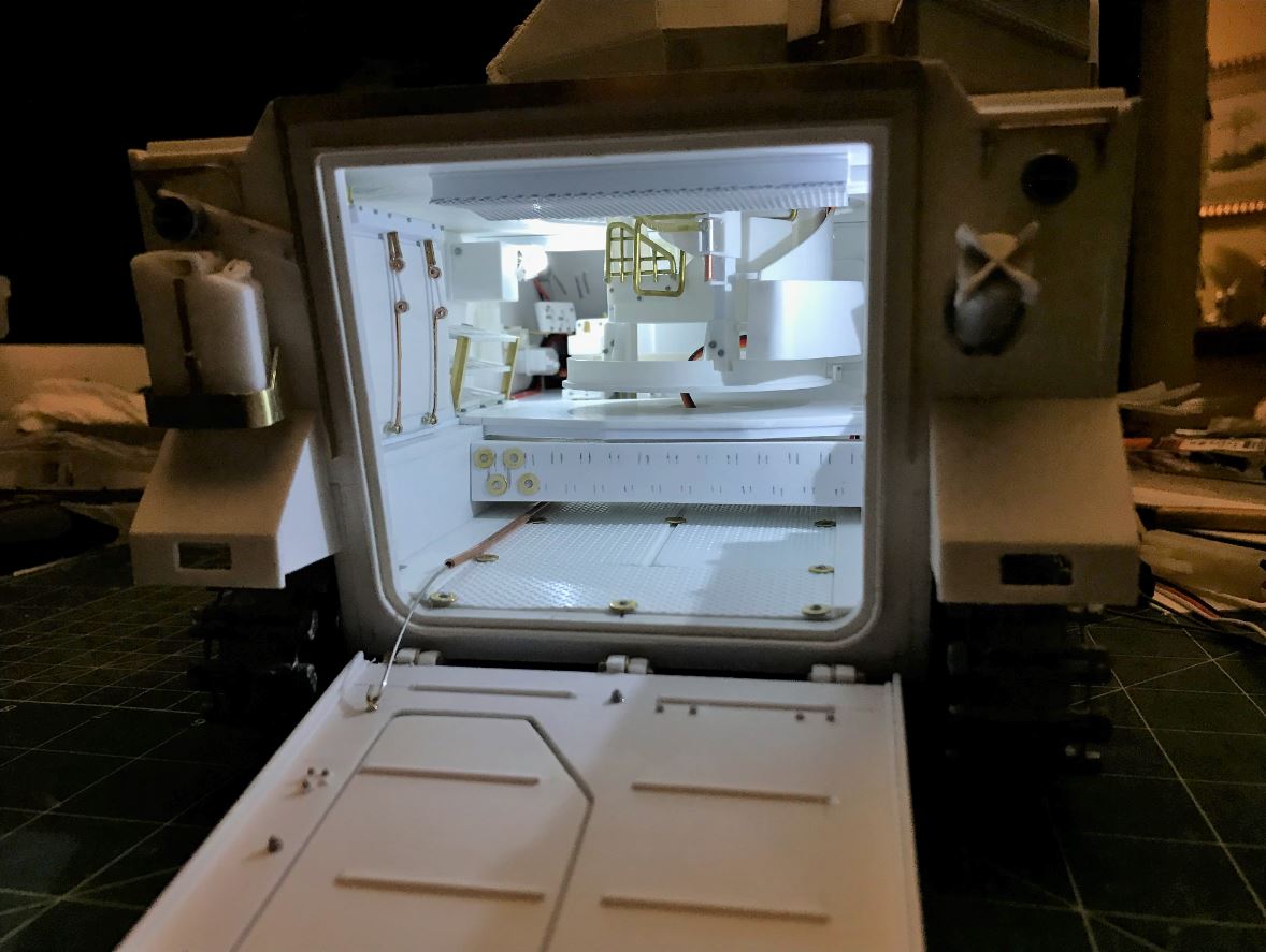

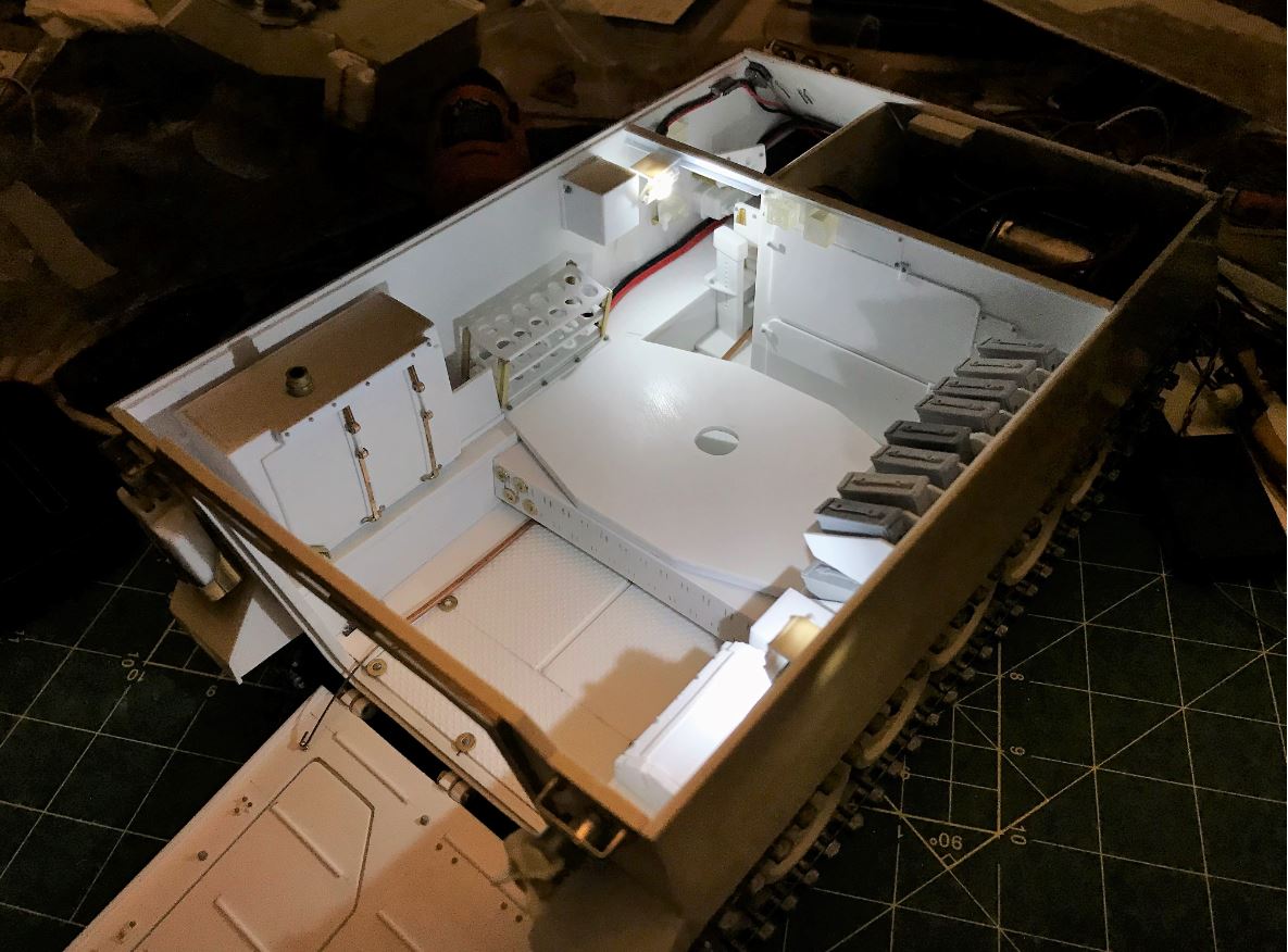

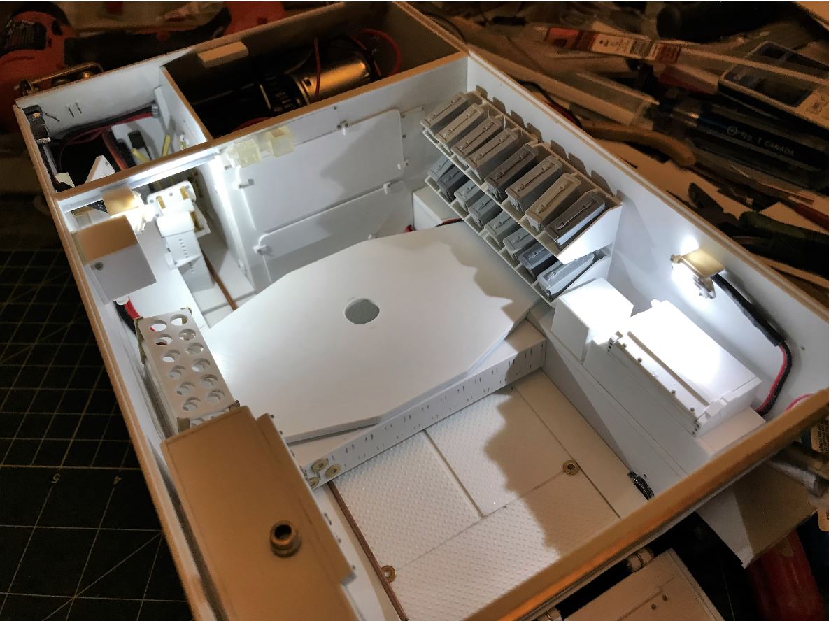

Overview of the interior with the lighting, always a favorite sight for me.

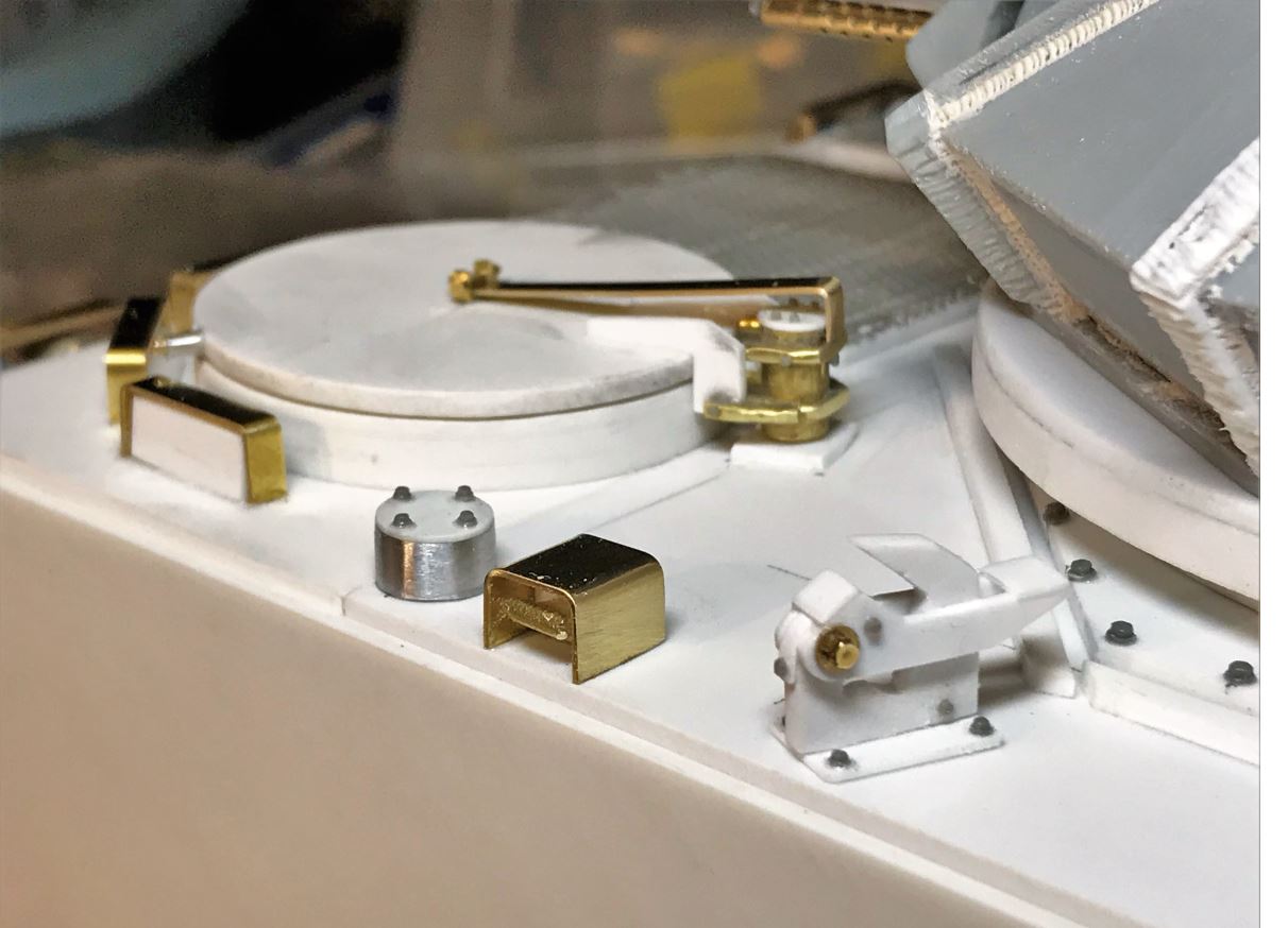

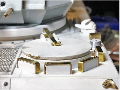

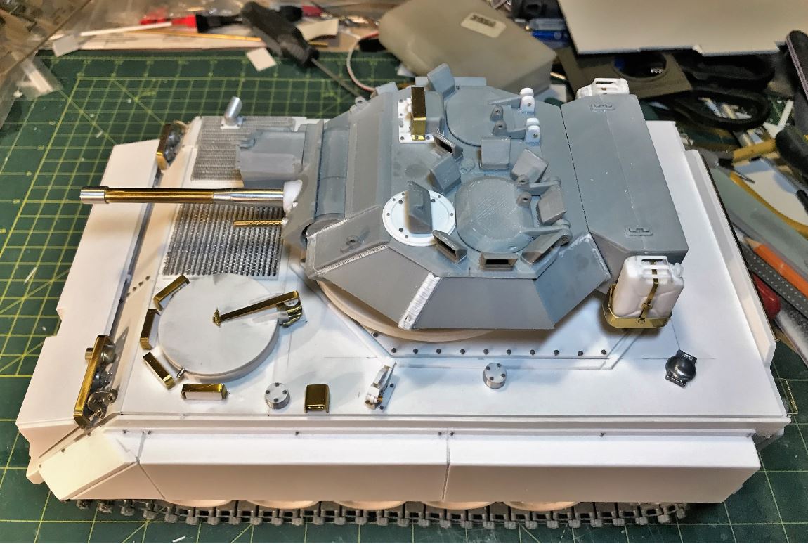

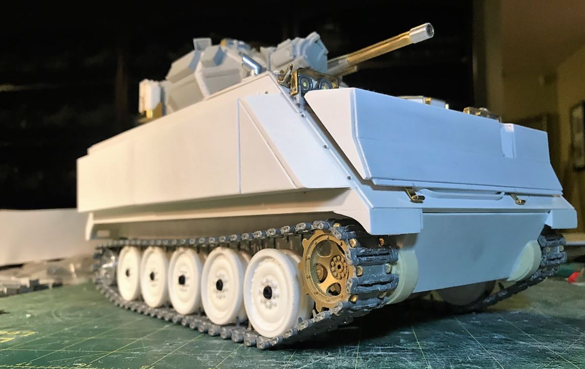

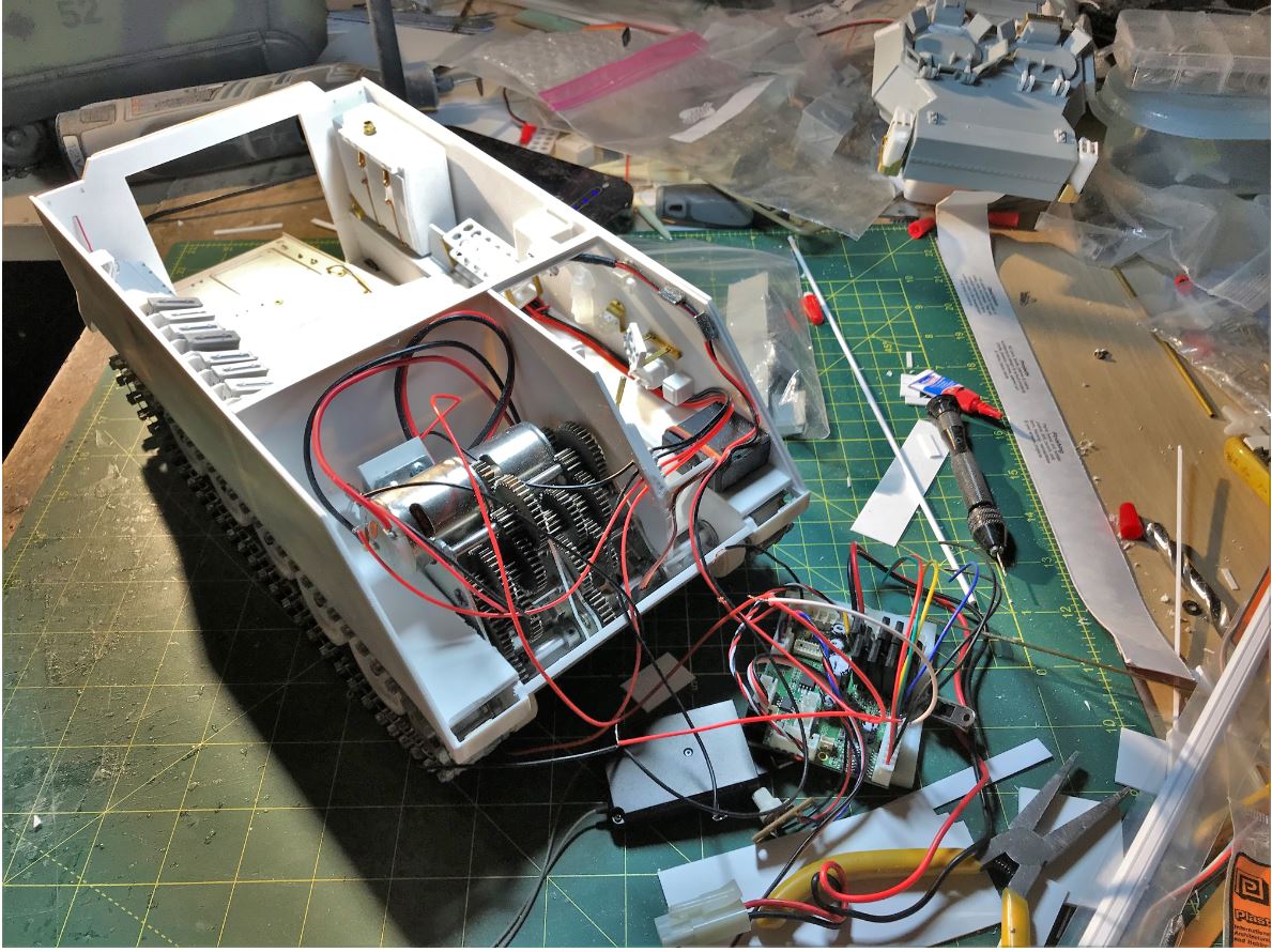

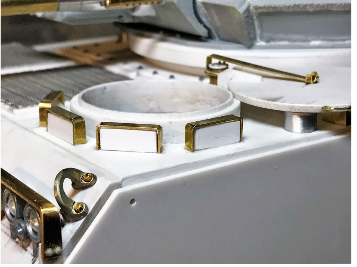

I started to complete the upper hull.

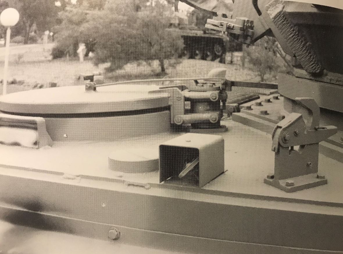

The MRV has a different drive hatch than regular M-113. It has a complicated mechanism that is a challenge to reproduce. Because of the turret above, it needs to open horizontally after being raised a few inches. I wanted a opening hatch so i had to compromise on a couple of areas to make this work in scratch.
Frontal view with the scratch built periscopes and guards.

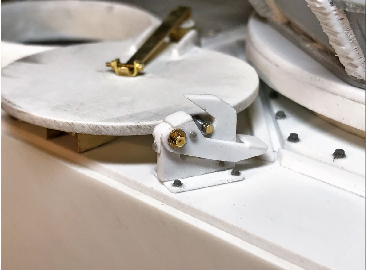

The strange custom opening hinge and the locking mechanism on the right gave me trouble recreating them from the single picture i had. They are not really accurate but they have some resemblance. This is a good as it is going to be with the 3 hours i wanted to spend on the driver's hatch. But someone very meticulous and with the right material and tools can have a lot of fun making them work fully like the real one.

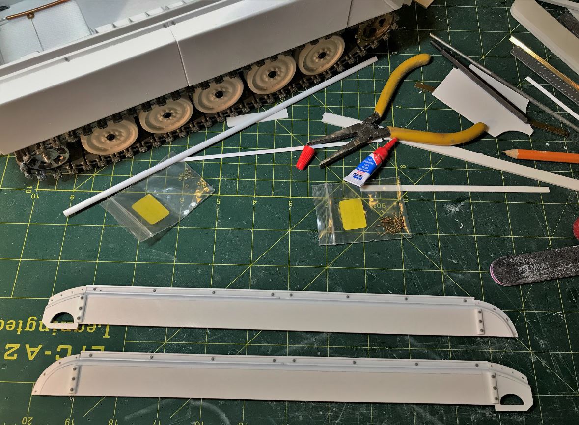

Here are the side skirts.

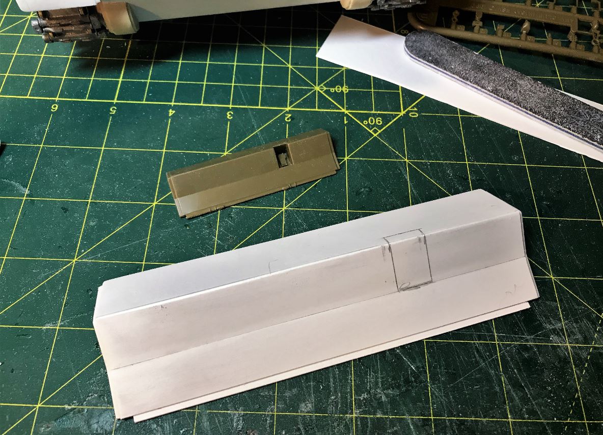

Like any M113, the MRV is optionally equipped with its side skirts when on the field. They have different mounting arrangements, some have full size skirts, some shortened with cut mud guards, some not at all. The easy way out would be to skip building them but it is not my style.

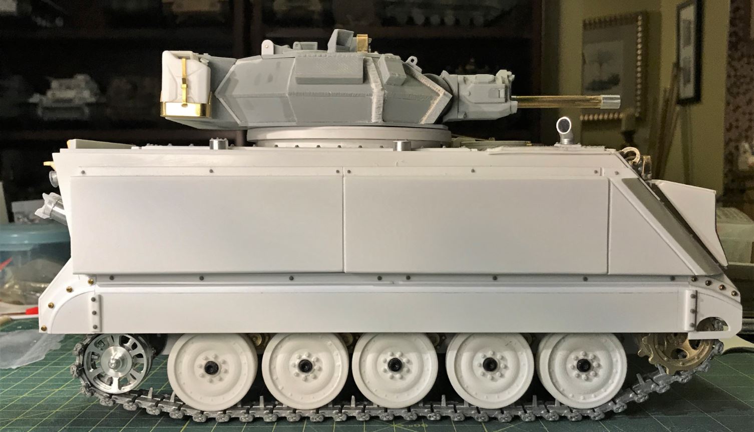

The side skirts are completed in about 6 hours of work.
They are removable, they are held in place with 4 M1x6 brass bolts with M1.1 washers on mud guards at each extremities .

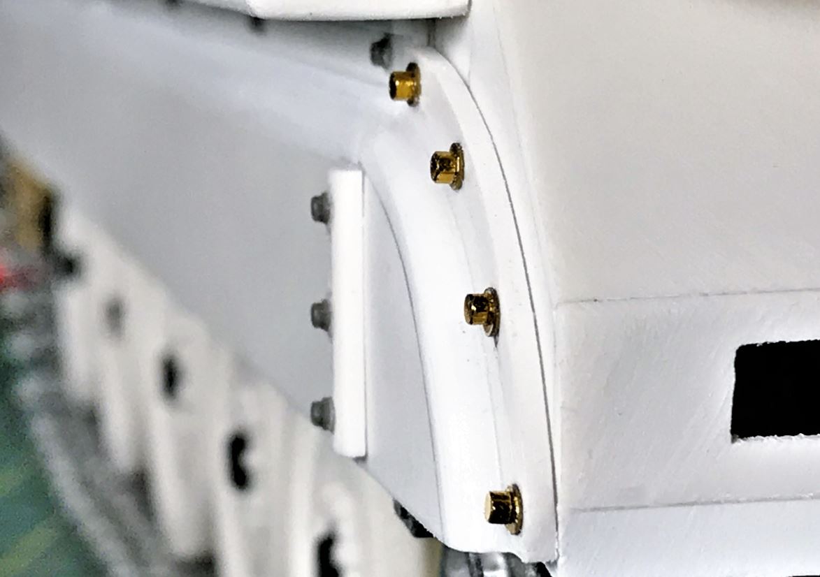

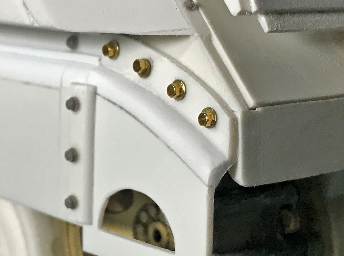

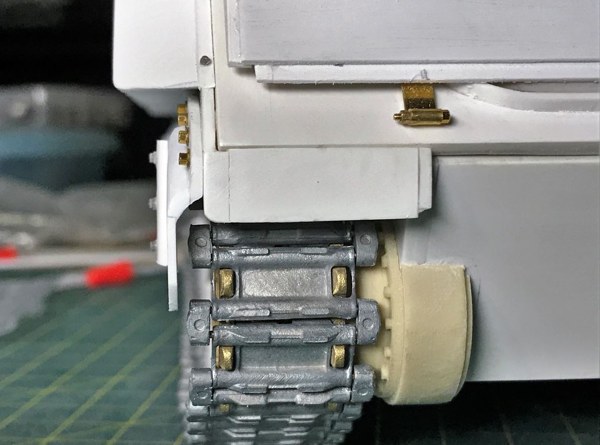

I gave the mud guards more thickness than they should in order to make them stronger.

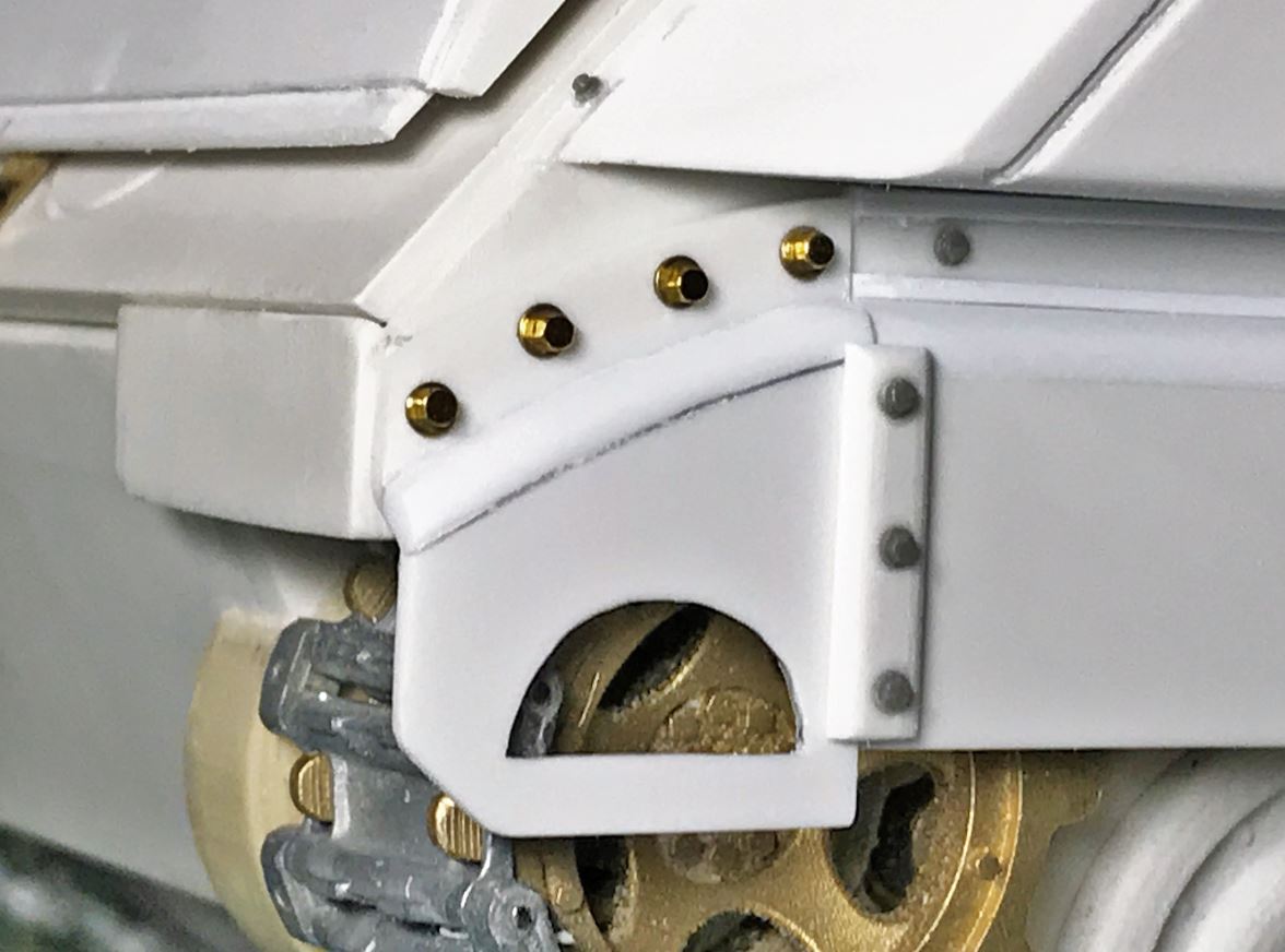

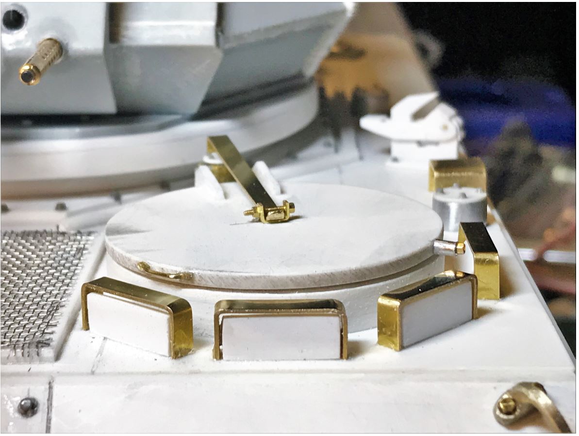

It is important to accurately reproduce the shape of the mud guards in order to clear the tracks.

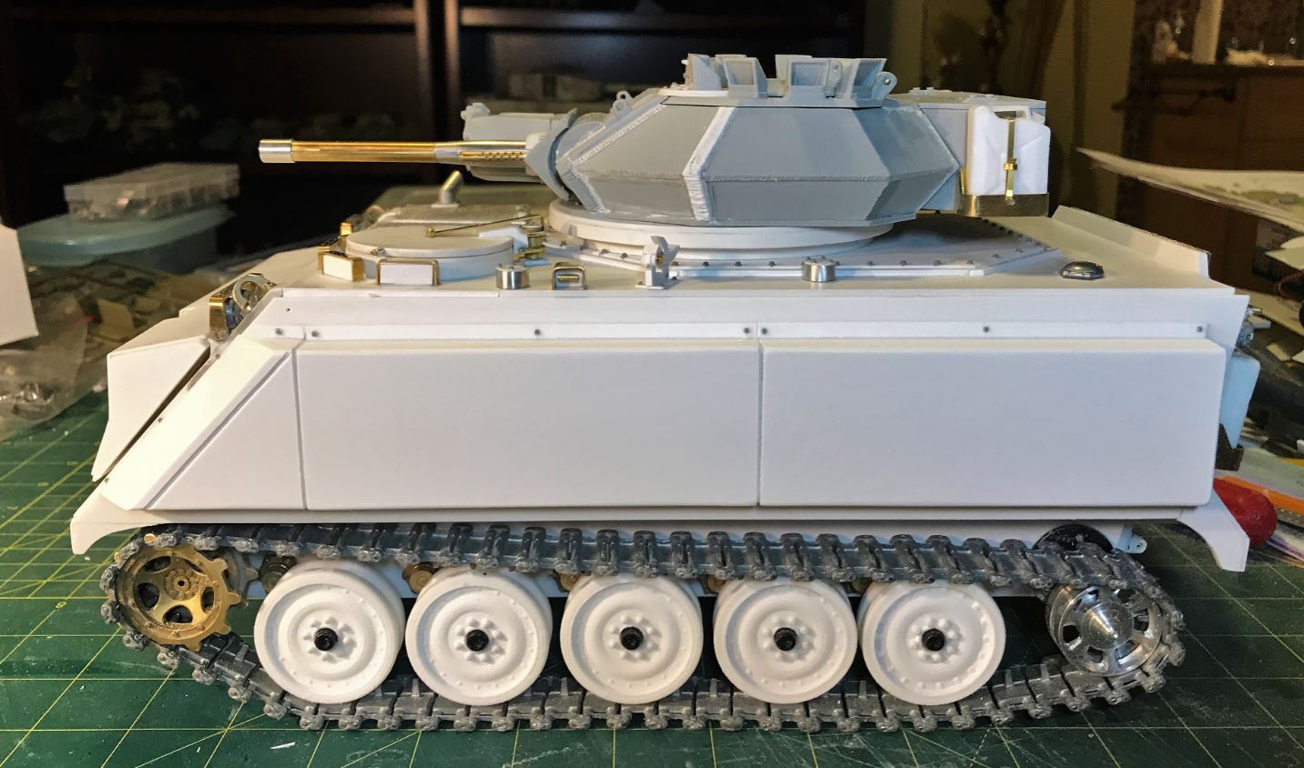

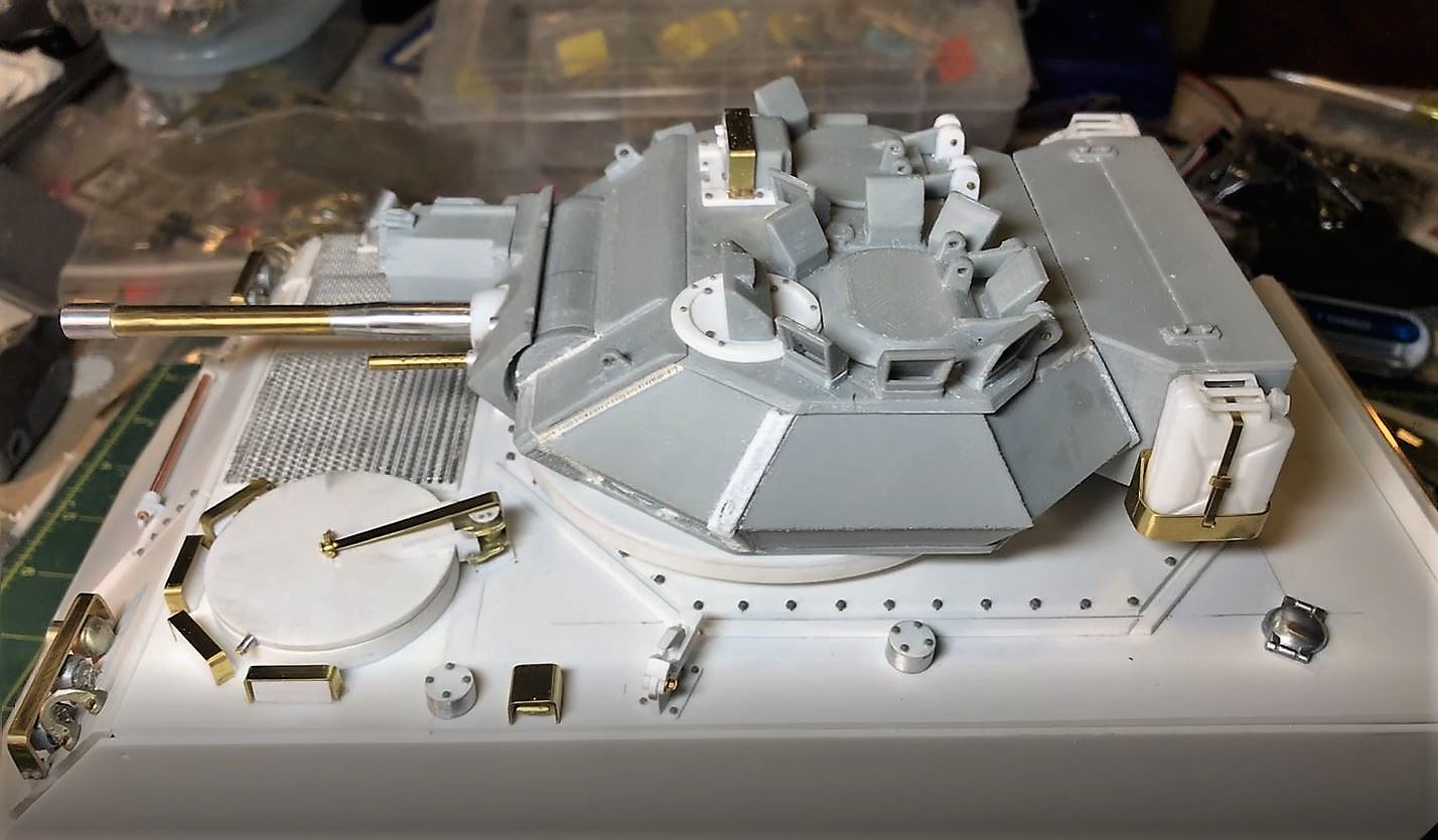

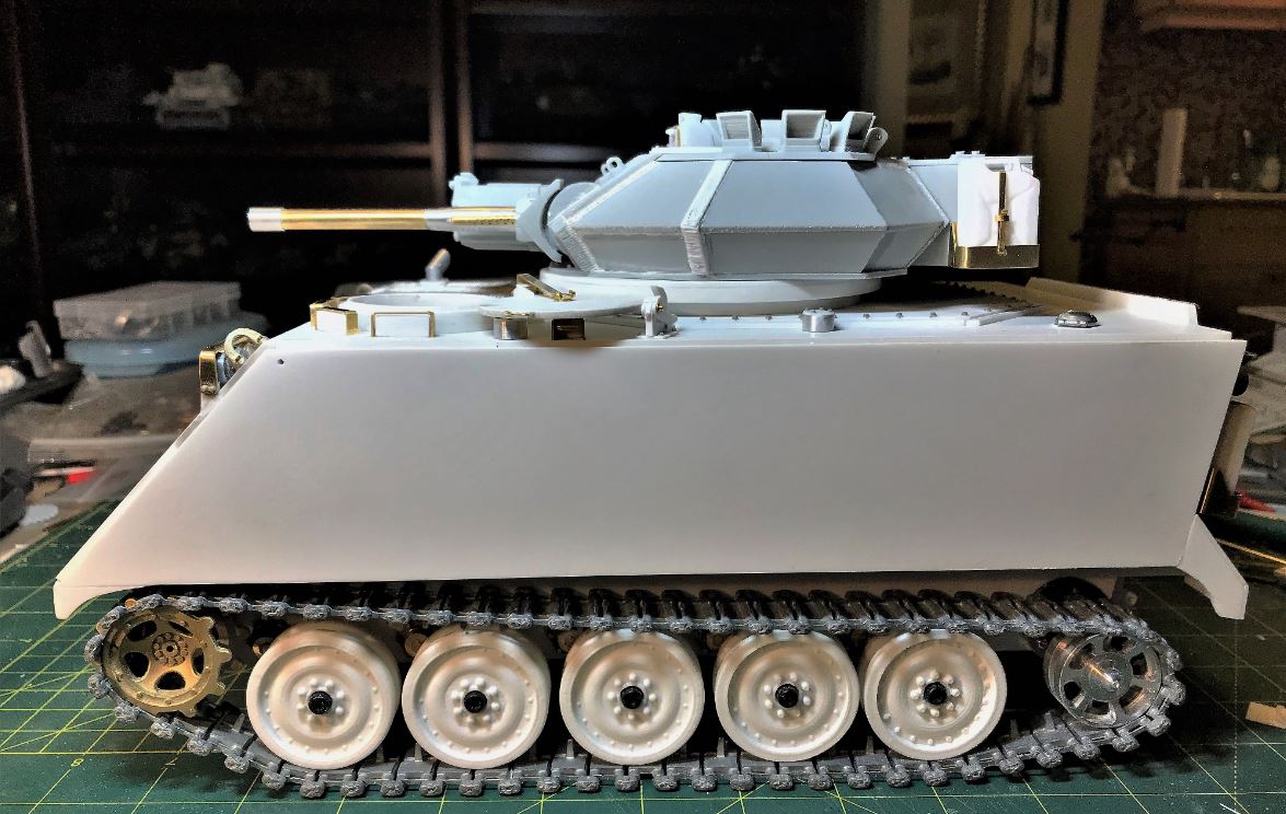

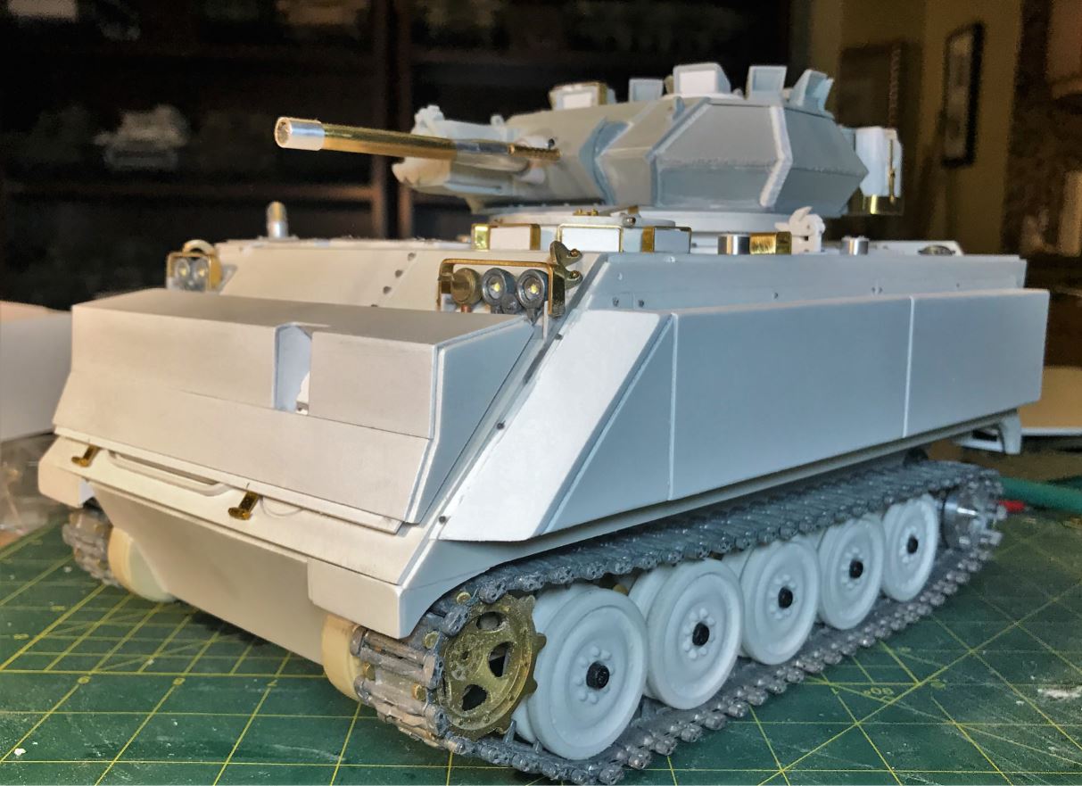

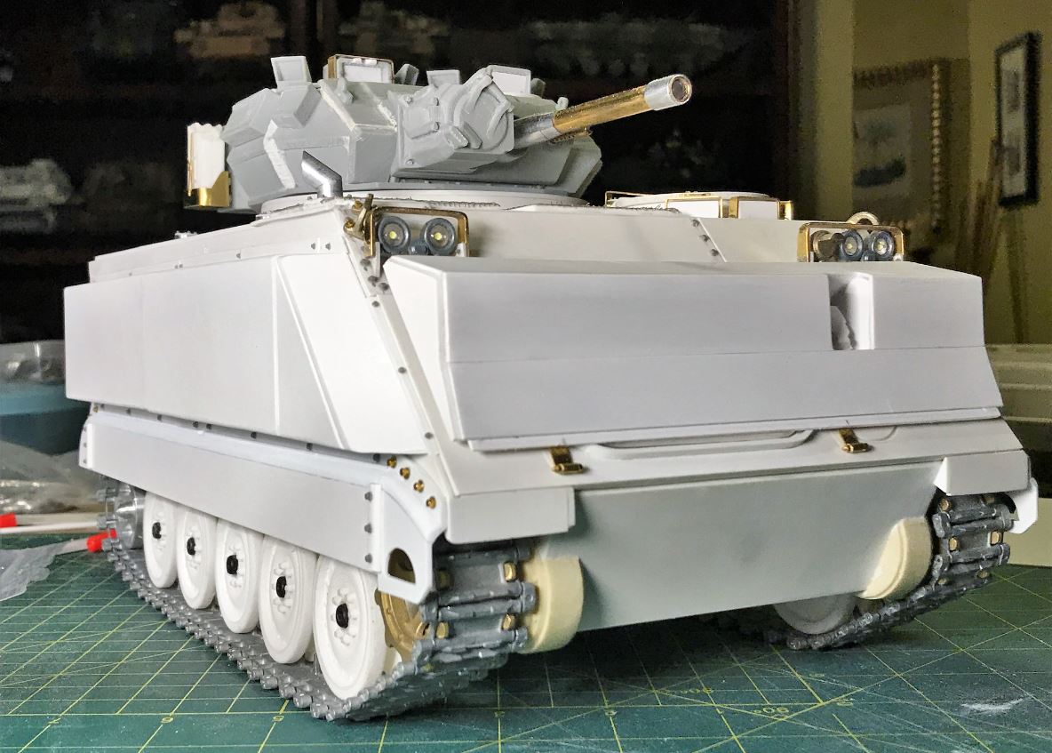

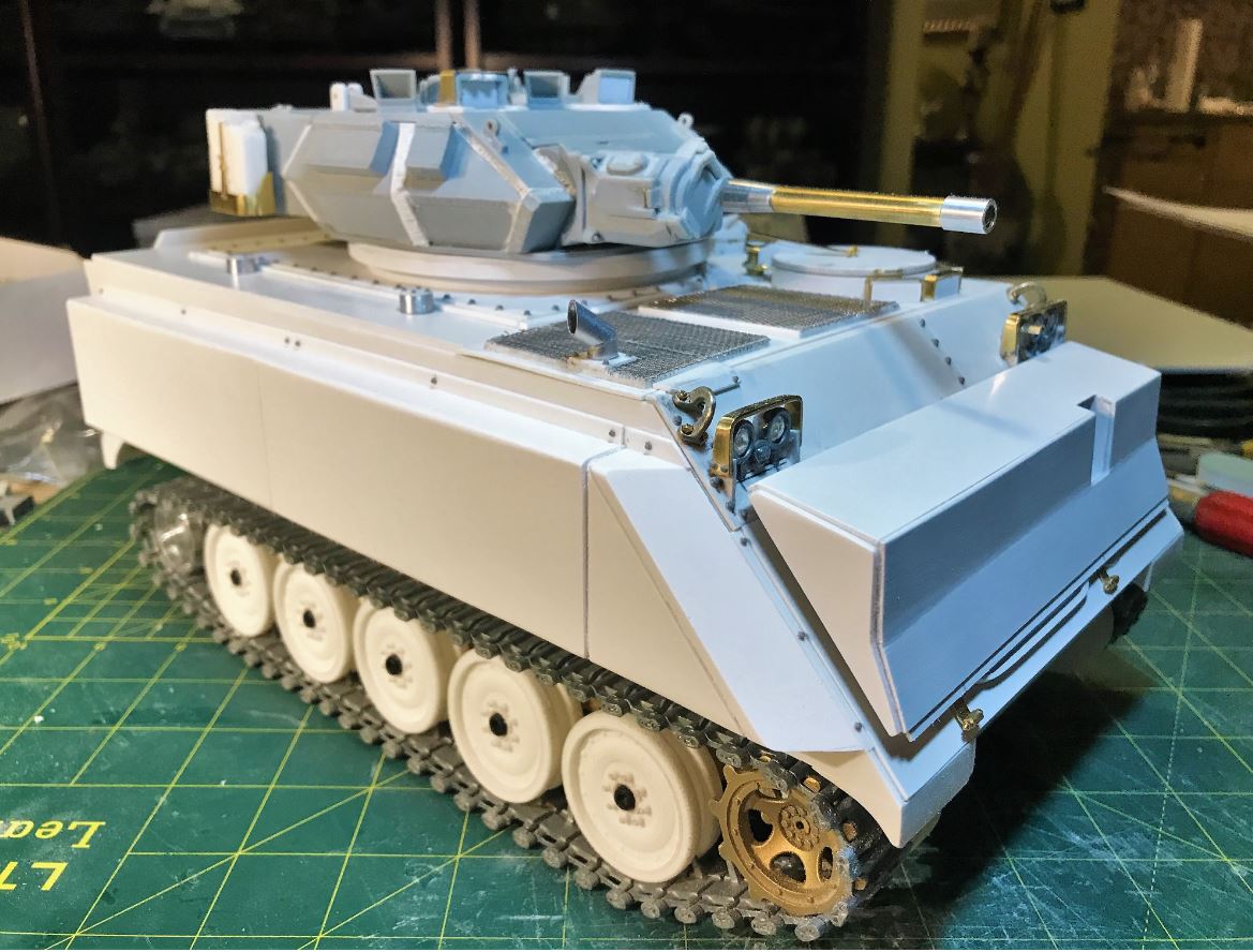

Here is the M113A1 MRV as it stand today. Next step is to complete the roof and exterior turret detailing.
