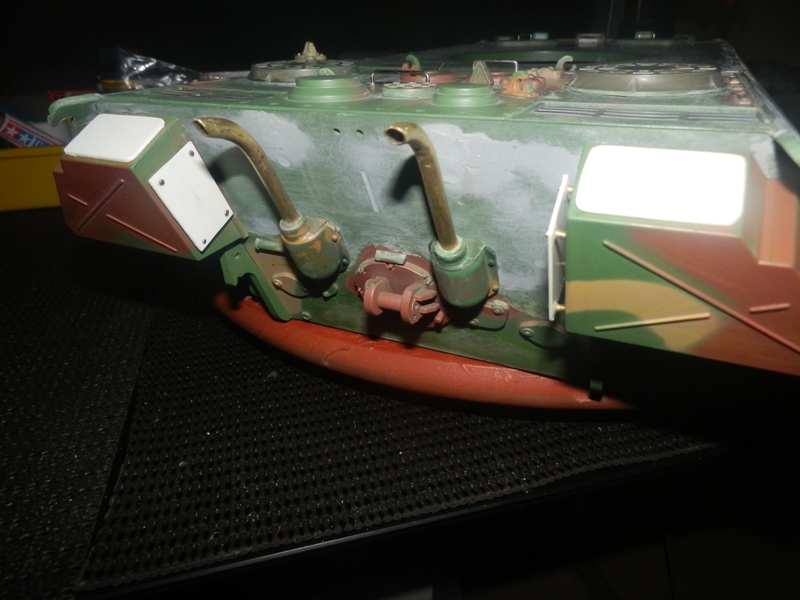

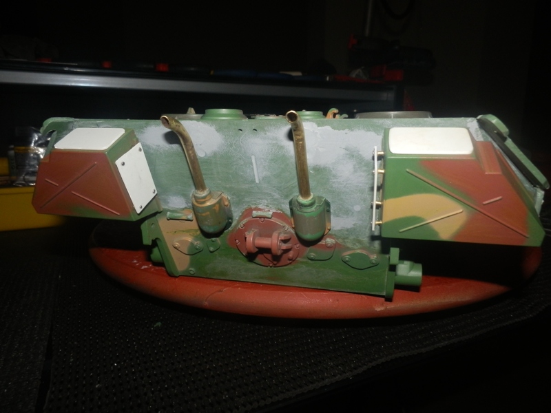

I formed my own exhaust pipes out of brass tube(toob to you left hand drivers!)
Heated the material with a butane burner to anneal it, got it to glow red.
Then keeping constant heat and load on it, gently curved the section into a tighter and tighter radius.
Cut the end off to the near angle, and cut the extra length off the bottom of the pipe.
Took 3 goes to get a reasonable radius, but they will do.
Certainly not Schumo parts, but not the cost either.
They will be fine.

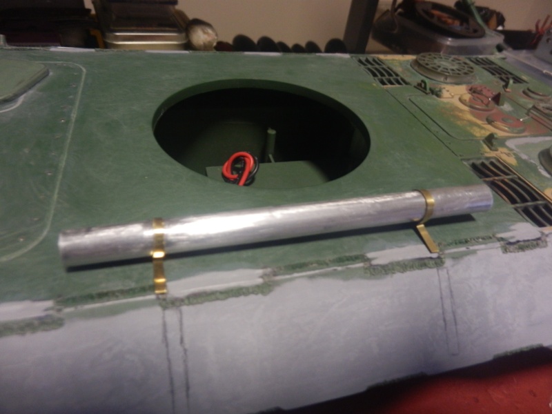

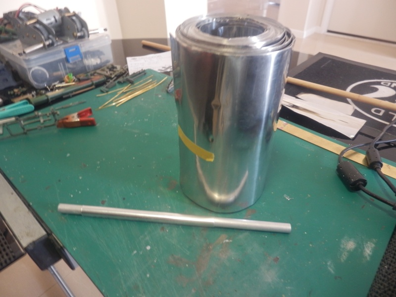

Dragged out a roll of roof flashing that I got years ago.
Used an inner cylinder out of an airsoft barrel to make a forming tool.
Cut a strip off the flashing material, rolled it around the airsoft tube and marked the excess with a pencil.
Cut the excess off with good scissors.
Rolled the joint..........(not that type :problem: ) and secured with super glue.
Used left over P.E. sprue strips as the hoop brackets and angled them slightly rearward as if they have been bashed on the front forcing them back.I still need to disrupt the entire tube as per the picture.
Caps and securing chains to be added.
According to the documented experts, these tube straps were the only hull accessory welded to the hull. All others were bolted onto the top deck.
