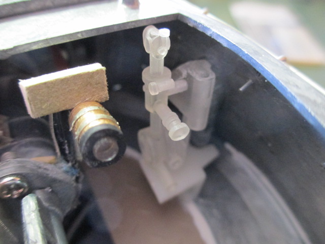

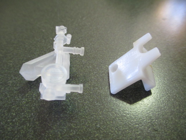

Those Shapeways bits in that clear material are done so to preserve and recreate fine detail in small objects. I've used them to a great degree on Crazy Joes M36 B and they were just fine. Easily as durable as molded plastic would be at that scale. Just treat them like you would any fine detailed part and you will be fine. ( even small objects folded out of brass like ABER 's stuff need extra care in use ) They glue, prime and paint just like any other plastic. Following along!
In place with a solid mount..JPG (90.83 KiB) Viewed 3254 times

I used the same add on parts from shapeways for my Cromwell build, I agree with the items seemingly being a tad brittle, most of them were fine though aside from the side storage box clasps which are very small and finely detailed so extra care was needed to remove them from the sprue and put in place, I'm sure you'll do a great job with them :thumbup:
