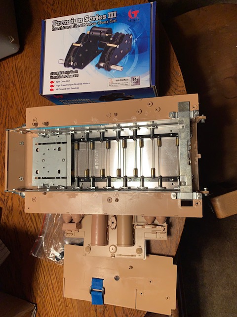

I installed the new gear boxes in the metal hull this evening and then realized I wanted Taigen metal road wheels, drive sprockets and idlers to keep the drive components all Taigen metal parts. I wish I had thought this all through because shipping from England to the USA is expensive.
Quick question. There’s only two screws holding each gearbox to the metal deck. Should I have used some form of thread locker? They seem very secure but what is the recommendation from the group?

I would strongly recommend you fit "Gearbox output Shaft Bearings/Bushes" to the outside exit hole of the Metal Hull,
These dampen out any stress on the Gearbox Mountings at one end and reduce the "Flex" that could cause the Sprocket to throw a track at the other end,
To help the output shaft to slide through the bearings/Bushes on first fit I suggest spraying a WD-40" product "Specialist Anti Friction DRY PTFE Lubricant" along the shaft,
It also makes a great alternative to grease for lubricating the gearboxes.

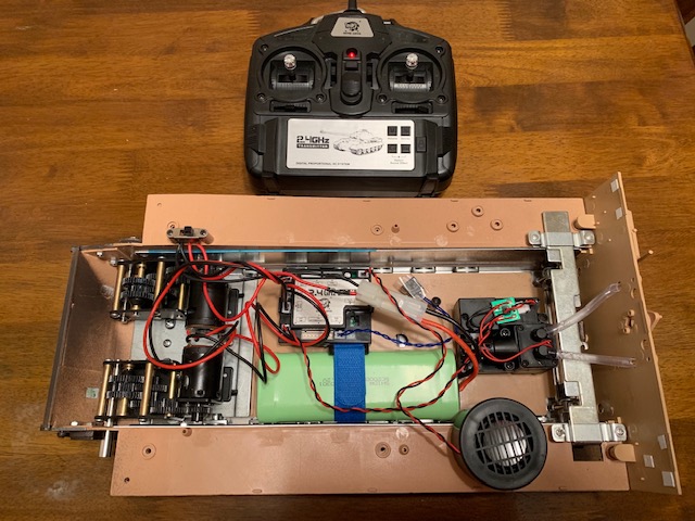

Made some progress. Watching the RC Mojo YouTube videos helped me 100%. I installed the new steel gear boxes and motors into the metal hull. I had to buy two small self tapping screws to properly mount the gearboxes. The base plate had provisions for two screws but I added a third for strength. I used blue thread locker on all mounting screws. I installed the on/off switch in it’s proper location (yes, I have new metal driver and radioman hatche’s on the way) and I temporarily installed the chassis electronics to test out the motors, sounds and smoke. Everything runs smoothly and works perfectly so far. I went ahead and applied a bit of white grease to the gear teeth. Now I’m waiting for the metal wheel set to arrive. Thanks for checking in.
