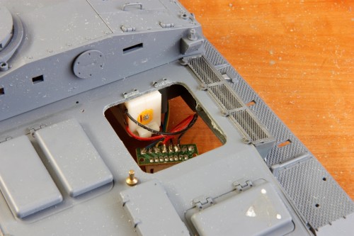

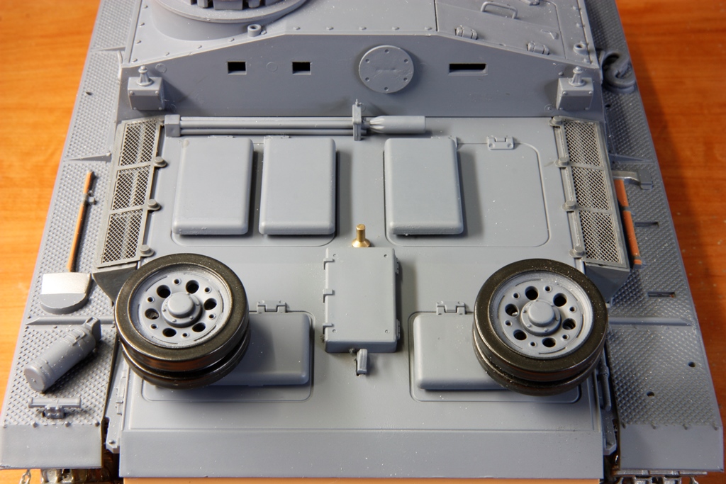

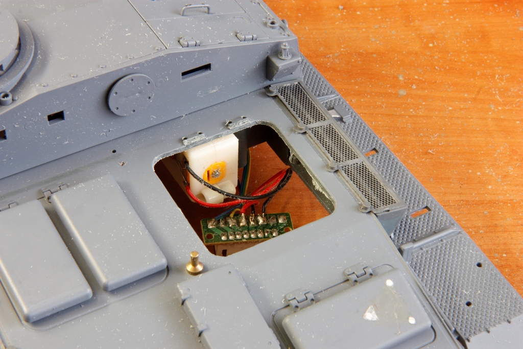

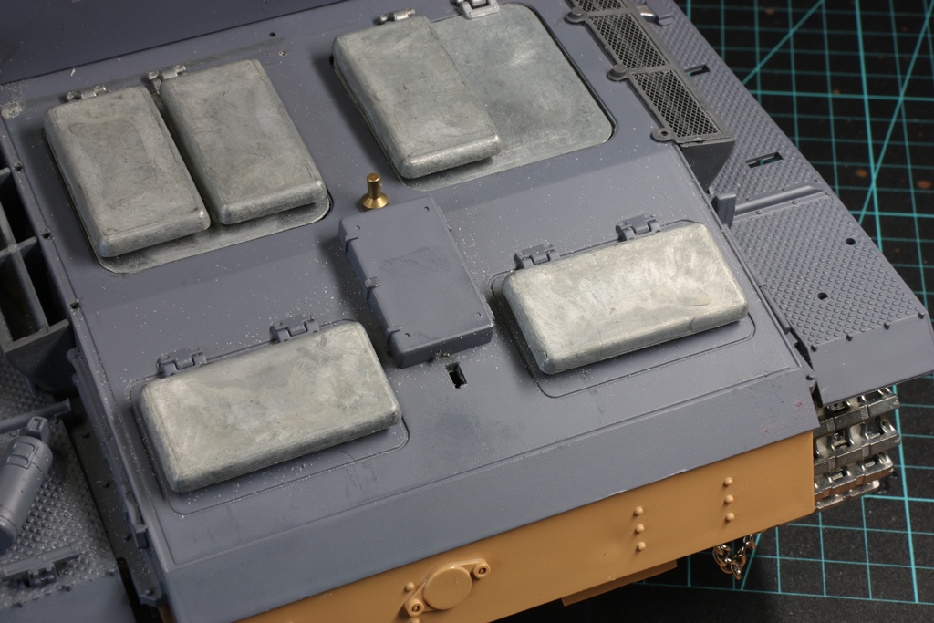

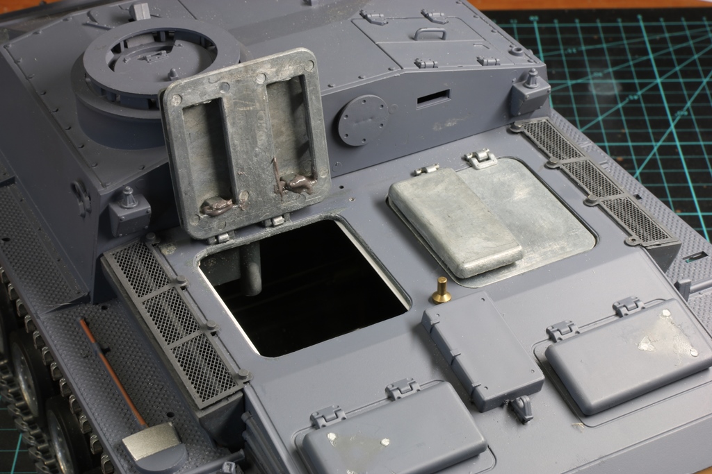

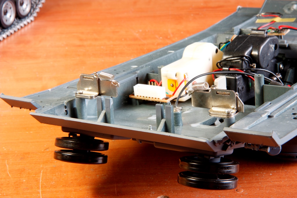

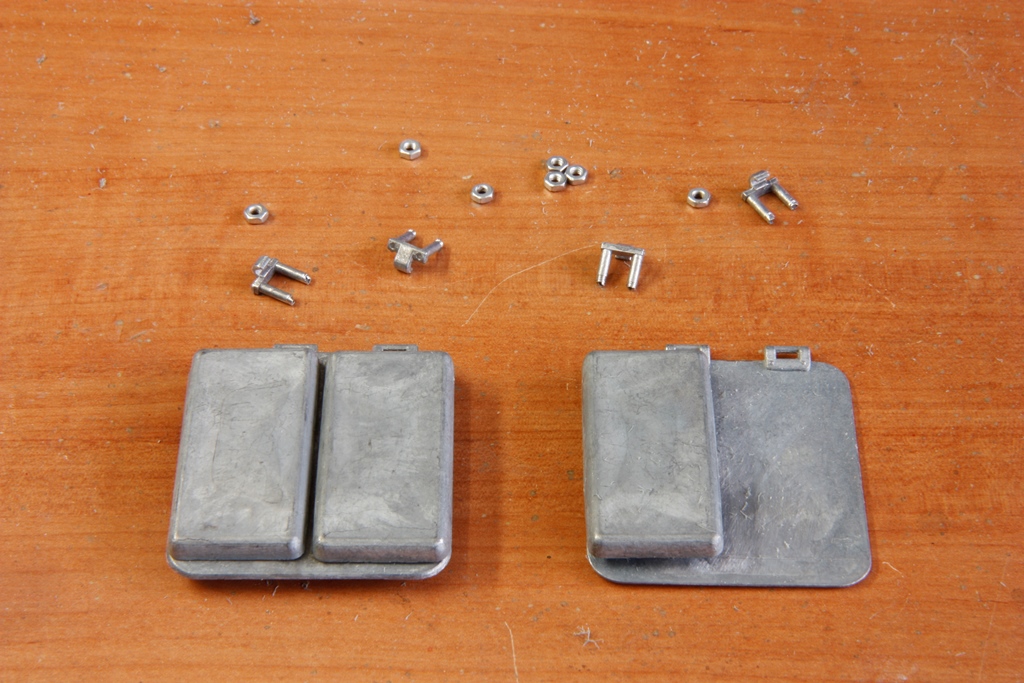

Next came replacing the rear immovable hatches. I am really keen for these as they should add some extra weight over the rear suspension, which is sitting a little high at the moment.
Once again, the hinges are a little basic and require some thinking to mount straight and true.
Heng Long never intended these mods, and so once you remove plastic, mounting points on the underside of the upper hull start to disappear. In this case, one of the plug sockets is now dangling.
In go the new Mato hatches, which were in danger of falling inwards, so I added styrene lips to catch them.
The rear-most hatches were to be next, and I removed the spare road wheel mounts, as that is where the Finnish storage box eventually goes. I then checked underneath and found the hull plastic in that spot supports the latch mounting screws.
As the storage box will rest on top of them, I don’t really need them to open, but I do want their weight. Instead I detached the plastic vents and glued the metal ones in place. A compromise achieved.
