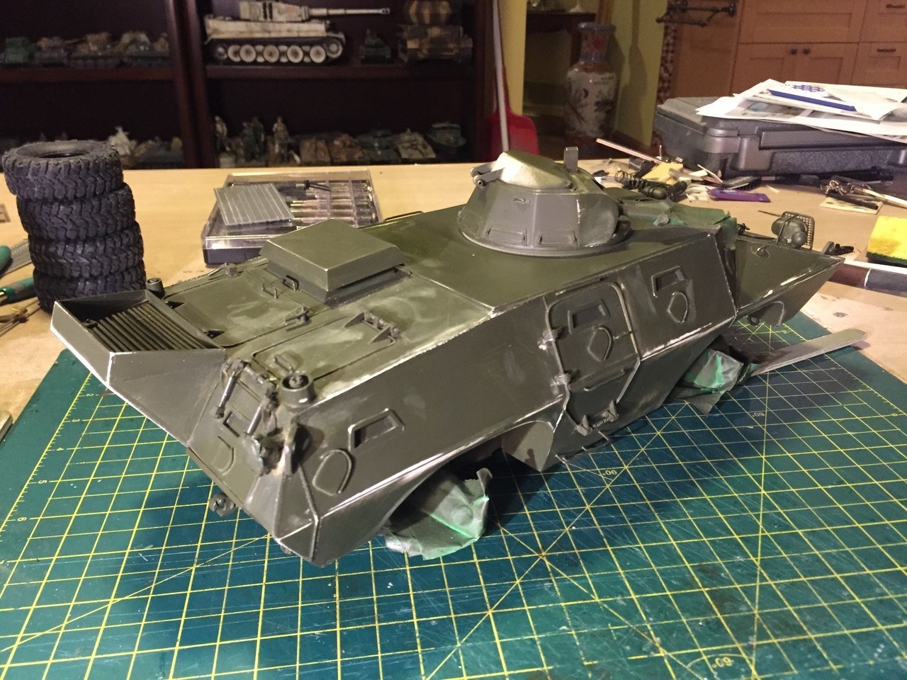

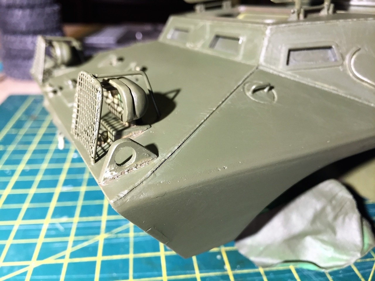

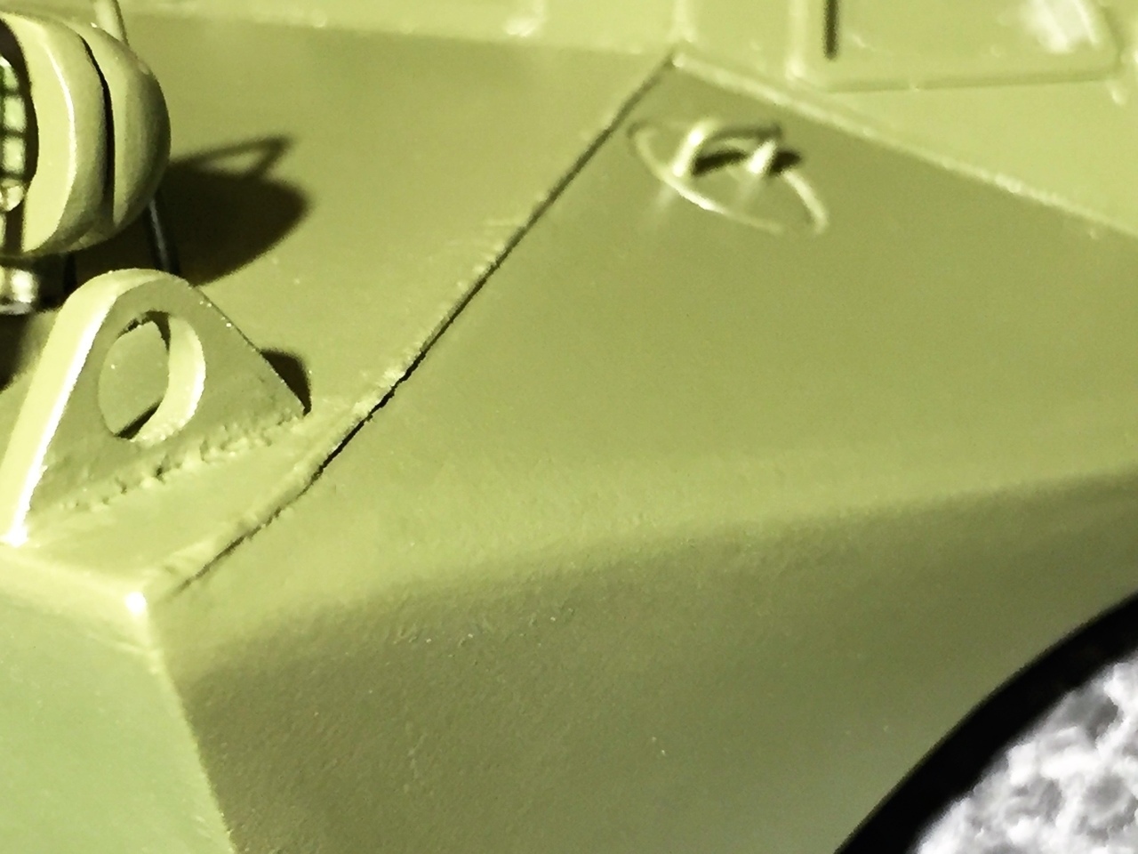

After the first coat of enamel primer, the usual imperfections typical of such scratch building are showing up all around. But its better than expected.
Ludwigs V-100 Commando
More putty, sanding, polishing... a phase that must not be skipped.
Same area after second coat of primer, its much better,

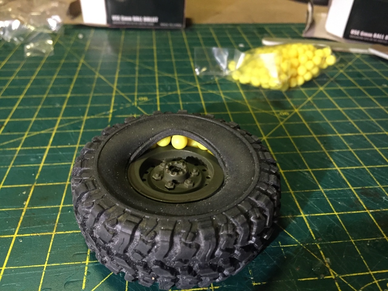

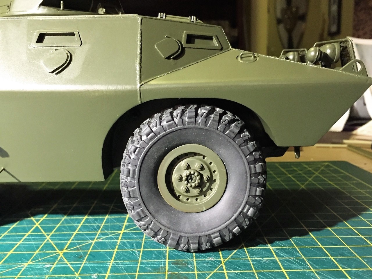

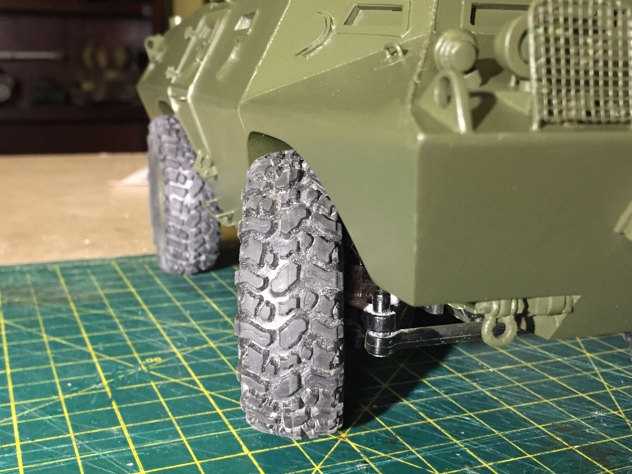

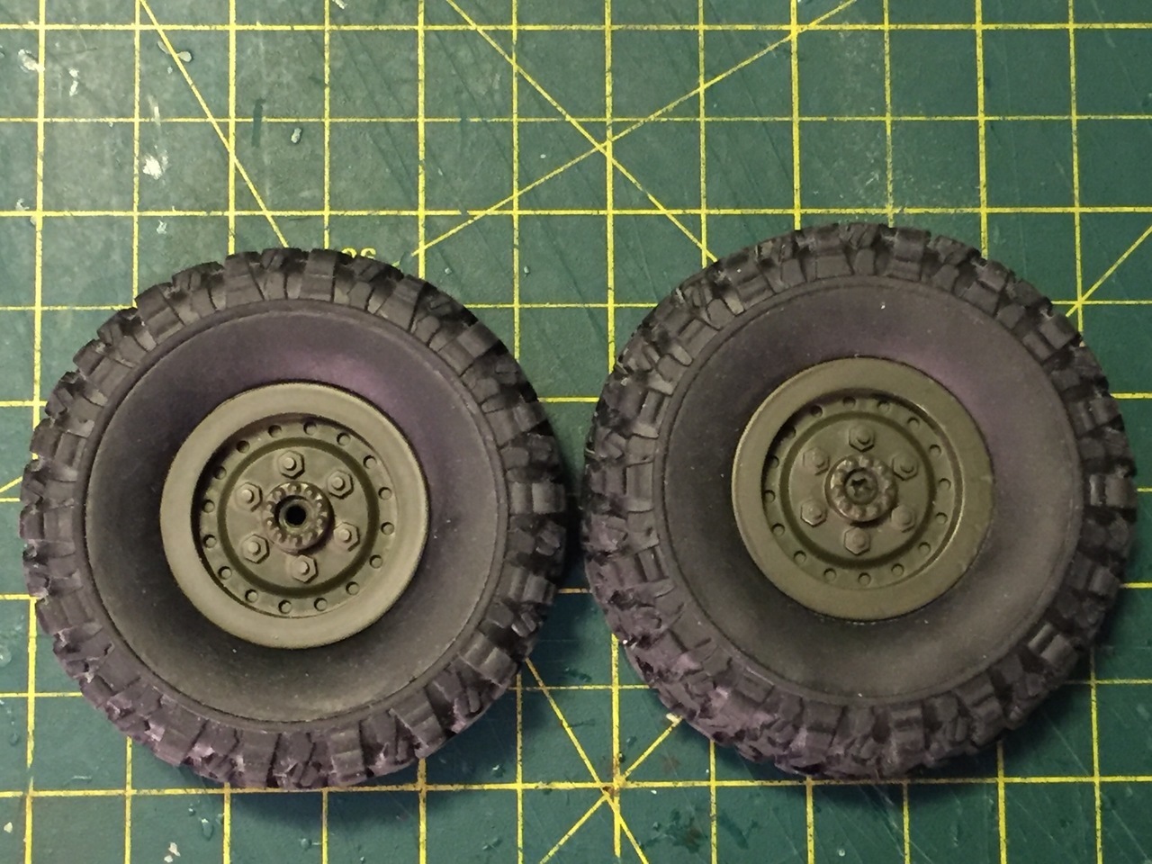

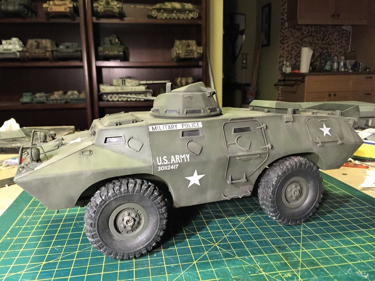

One big issue with the Heng Long/WPL tires is that they are flat. My tires needed a little boost to be as per reference so I decided to create a set of "show off" inflated tires. My trick was to fill them with those Heng Long pellets that comes with every tank. The technique is to insert the pellet, then massage the tires until they can't take any more, making sure that the tires remain round as much as possible. Each tire take about a HL box of pellets.
Here is a before and after comparison. The tire now look inflated and has gained about 5mm in diameter, exactly what I needed.
Here is the model sporting its new "show off" inflated tires. However, the flat set would probably be better for running, I have not tried these yet.
Next step is to give the acrylic coats on the model.
Regards, Louis

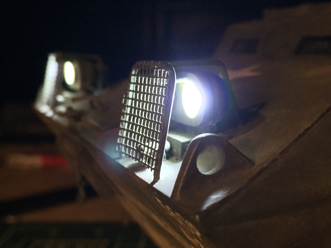

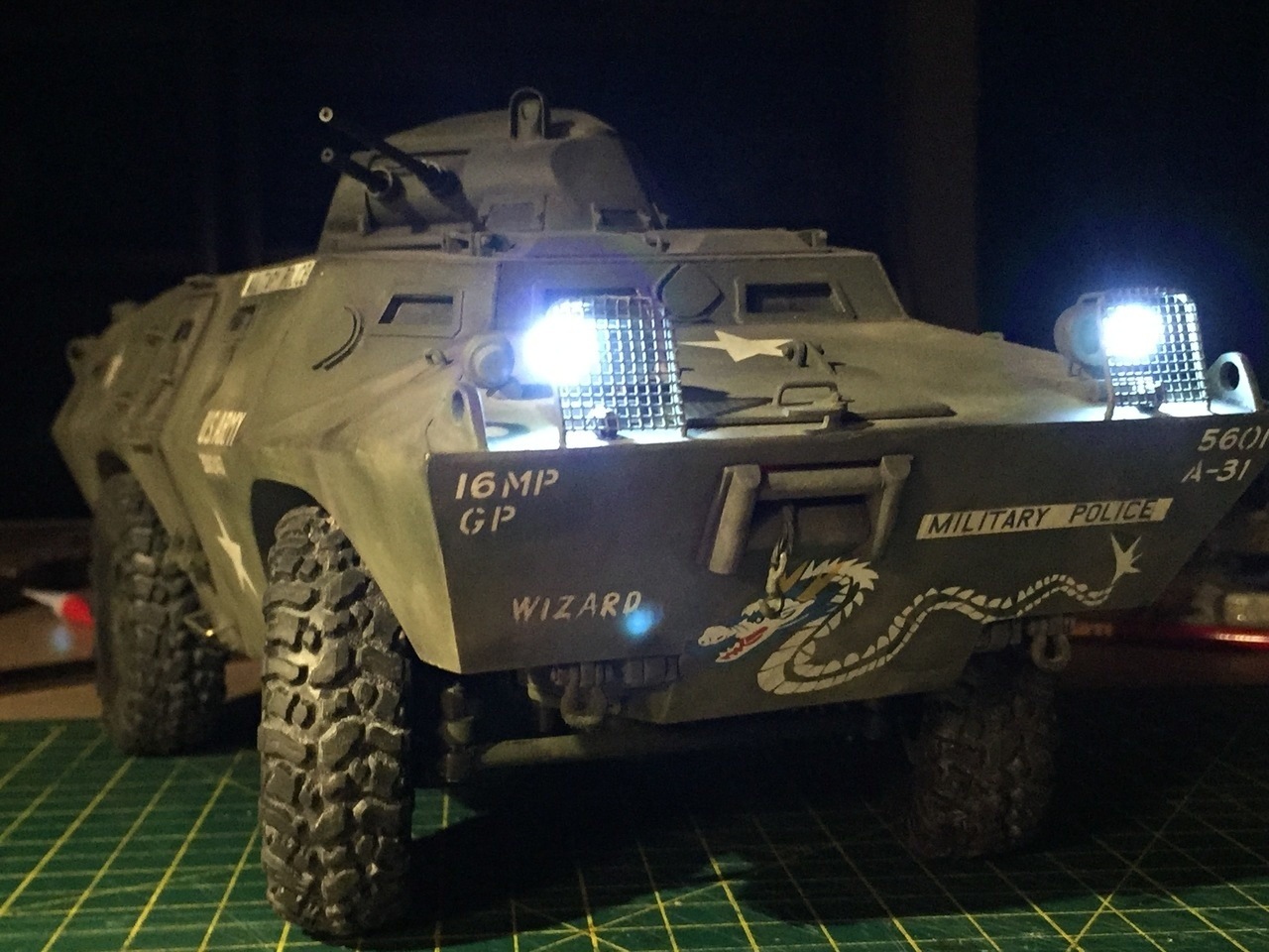

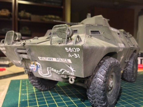

Many Commando armored cars in Vietnam had a colourful cartoon figure painted on the front, I wanted something similar.
Ludwigs V-100 Commando Vietnam

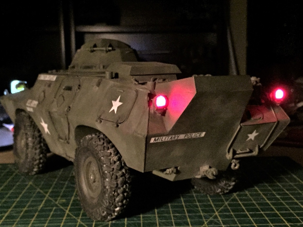

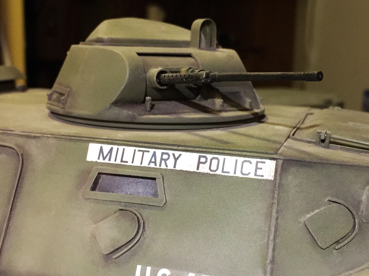

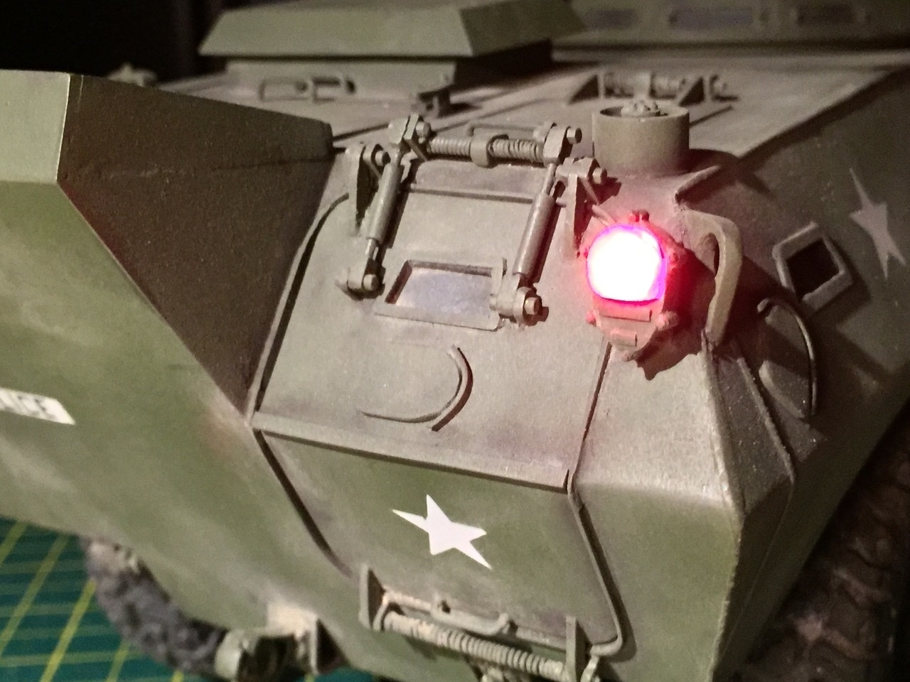

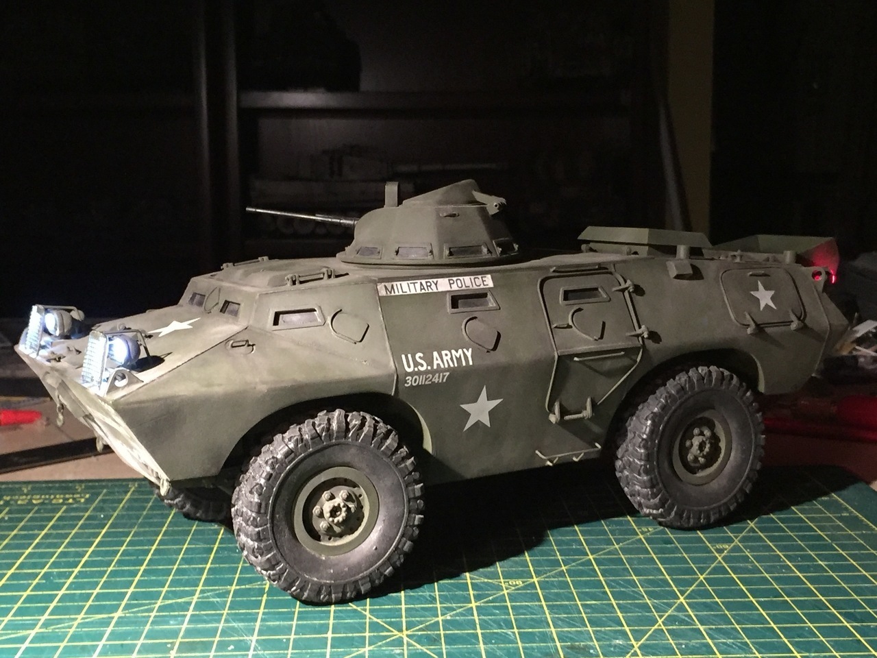

I am currently painting and weathering the model, its going rather well I think. I am very happy with the results considering that the model was a bunch of plasticard sheets a few weeks ago.
Night patrol
Next step is to finalize the painting and weathering, and then start the figures.
Regards, Louis

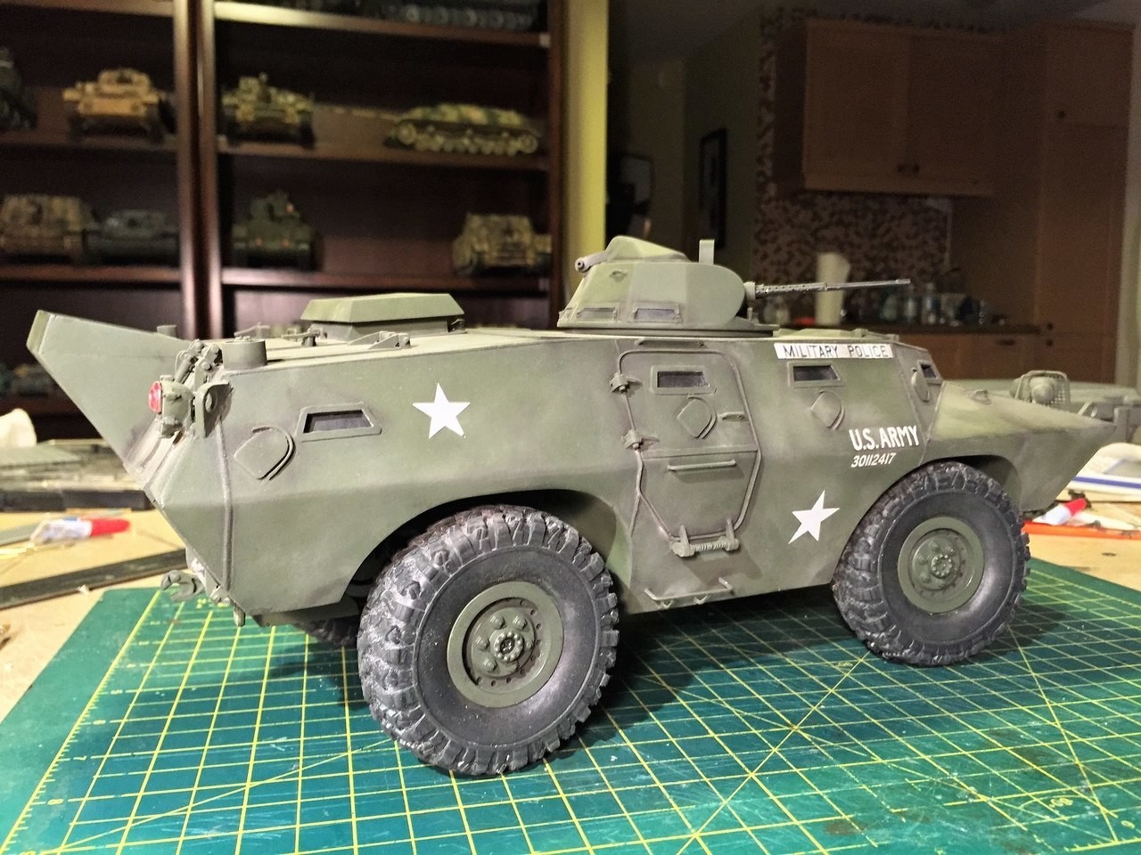

Here is a few more pictures
Regards, Louis
