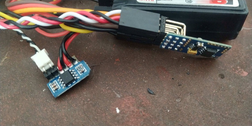

Small update here. Today I have installed an amplifyer. You can buy four of them for one euro free shipping in aliexpress.
There are several models, I just bout the smaller and cheaper of all, lol.
The difference (with a propper speaker) is night and day. So guys, for 25 cents you can make your small board rock.
