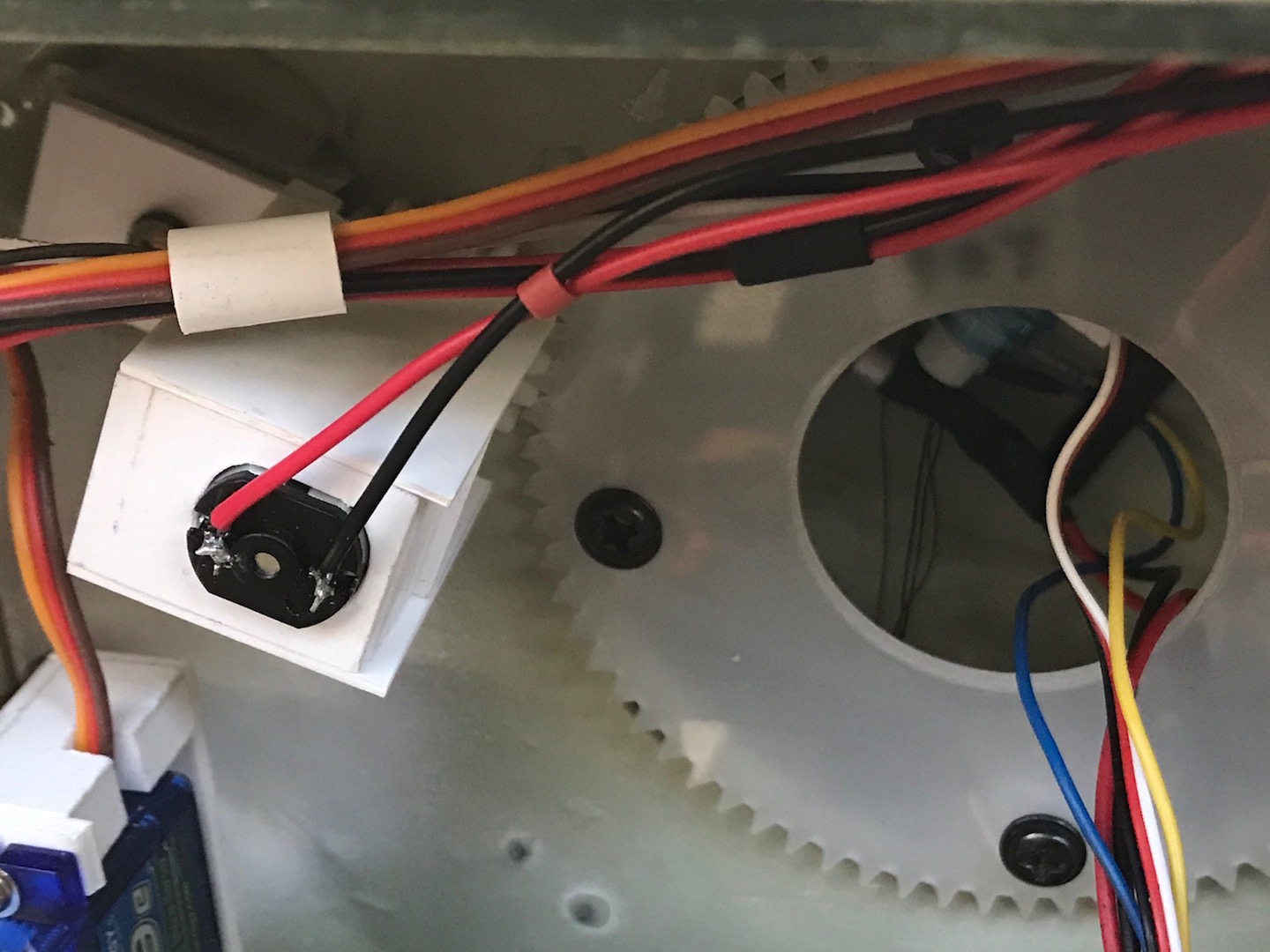

I used a small 6v motor with built in reduction gears (8 rpm) and fight s HL turret rotation gear to the shaft.
Then scratch made a housing for it and bolted it to a nut mounted inside a block of resin glued to the roof.
For the turret ring, I heated & cut down a HL ring to fit, then got a friend to machine one from 3mm acrylic.
The turret has elevation and traverse with a modified aber .30cal barrel and red led with fibre optic in the mg. The 37mm uses a smd for a flash.
Anyway, I won't bore you with the details, but if you want to know more, just ask. :thumbup:

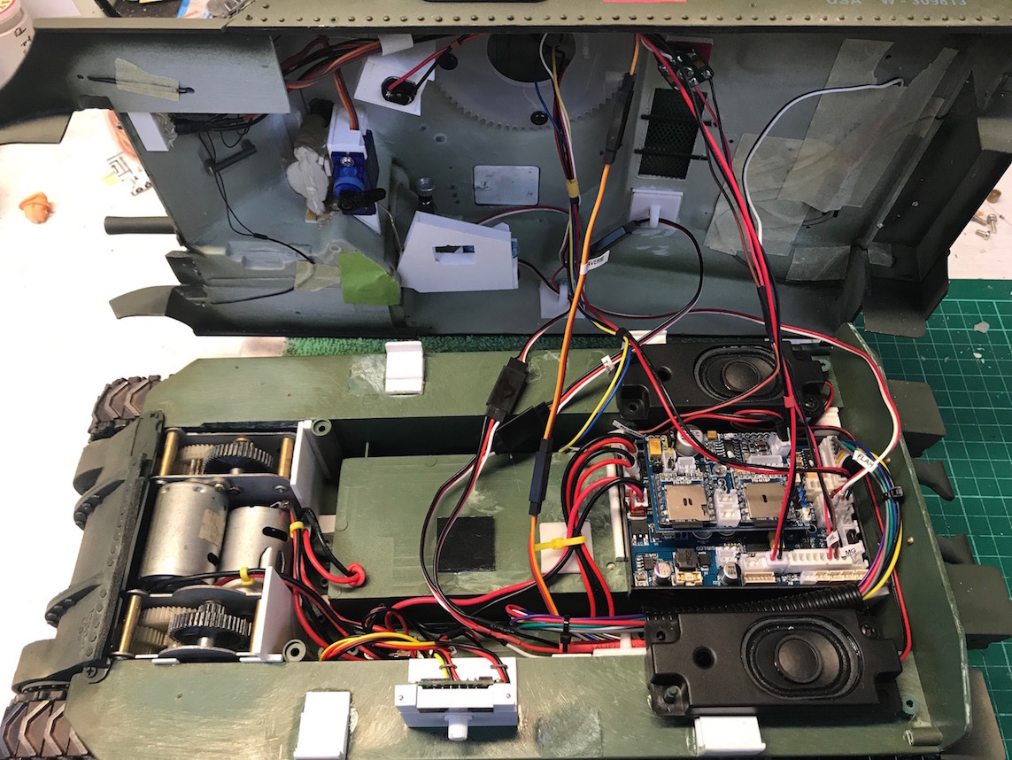

8rpm 6v motor.png (126.94 KiB) Viewed 3129 times
Still needs detailing and weathering
shapeways wheels- modified bogies.JPG (74.8 KiB) Viewed 3129 times

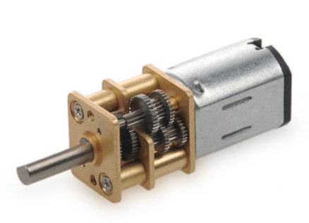

smooth 380 motors, white metal and nylon GB's, quiet and strong
scratch built turret motor housing
