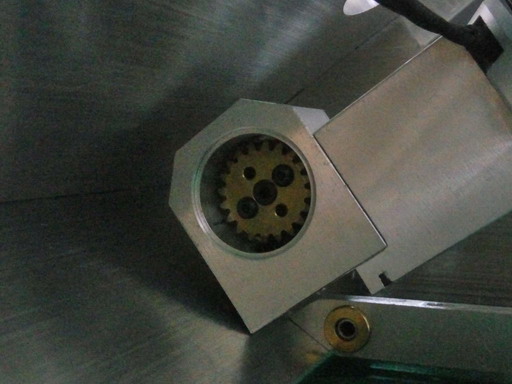

Re: AERO MATE Panther II
Look this Picture:
This gear is made of brass and the worm gear cuts the teeth away.....
How odd
Lets just say, We hope this get fixed by manufactor for you
