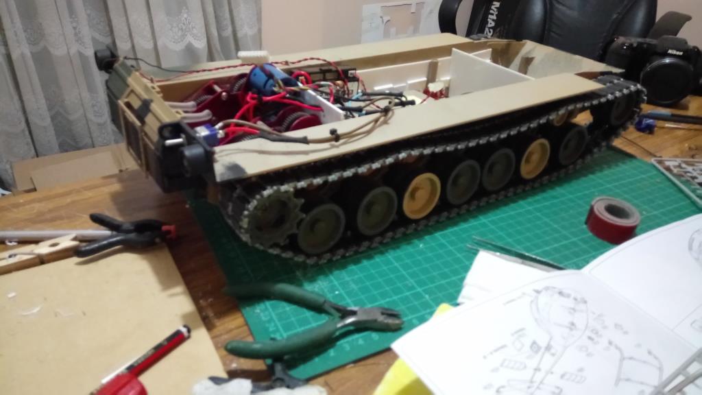

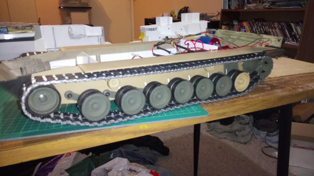

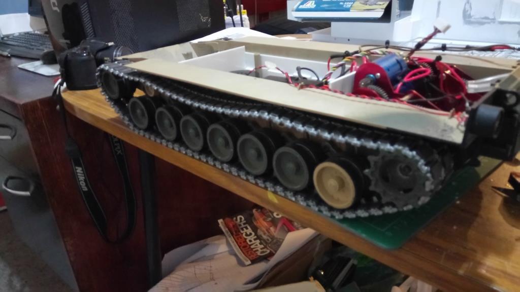

Tracks are on...took 2 links out of each, but when turning during a test run (without the top on)the tracks migrate off the sprocket!
Took another link out and they are nice and tight on the sprocket but tends to pull the first and last road wheel up!! Hopefully it will settle down on its suspension a bit too plus still need to get the track tension kit for it.....
- with 3 links removed...much tighter
- DSC_0270.JPG (80.3 KiB) Viewed 6534 times
- DSC_0267.JPG (69.28 KiB) Viewed 6534 times
- DSC_0266.JPG (72.4 KiB) Viewed 6534 times
- two links removed.....hangs a lot!
- DSC_0265.JPG (70.43 KiB) Viewed 6534 times

Yup suspension is all upgraded might need to change the springs around to the other hole....its my first tank so uncharted watersSon of a gun-ner wrote:Have you not beefed up the first and last suspension on each side?
Doesn't that usually help with those wheels wanting to be pulled up, especially with the weight of metal tracks?
Mick.

I'm no expert, but to my eyes, the track looks too tight in the last photo. Maybe it will stretch a bit and settle down once it's run in. On the other hand, it could put a strain on the sprocket and idler bearings.
Richard
