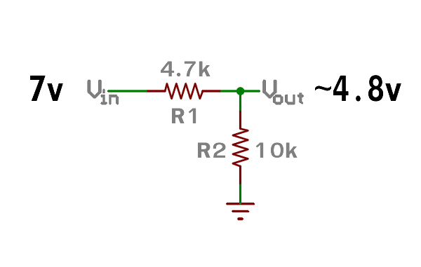

After a bit of fiddling about, I got this working from the RX18.
Rightly or wrongly I removed the voltage divider, so its one wire straight from RX18 IR+ to A0 on the Arduino.
The RX18 IR- is not used.

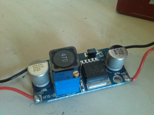

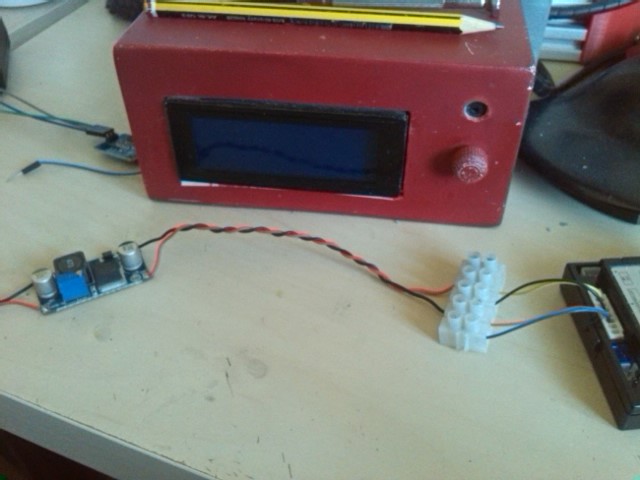

Bingo! Perseverance pays off.
I at long last received the voltage regulators in the post today.
I needed one to use the airsoft circuit to trigger a pulse to the Arduino board. The RX18 pushes 7v on pins 2 & 5 (new T90 board, I haven't checked the old RX18's yet).
The Arduino can only take 5v max.
I hooked up the VR to pins 2 & 5, and then attached a multimeter. Sure enough it was 7v when I fired the gun. The VR has an adjuster on it, so I just kept firing the gun, and adjusting the voltage until the maximum readout was under 5v, 4.8v in my case.
I then hooked up pin 2 (+) to pin AO on the Arduino. Fired the gun and nothing.
I then hooked up pin 5 (-) to GND on the Arduino. Fired the gun, and praise be, the IR flashed.
No resistors, they aren't needed as the input voltage is controlled by the VR. Though in theory I could now (and I will try it) replace the VR with a 10k resistor.
So, although I couldn't get the signal to trigger the Arduino using the RX18 IR pins, I can do it using the Airsoft pins on the 8 pin plug.

- VoltageDivider.png (60.55 KiB) Viewed 8470 times
