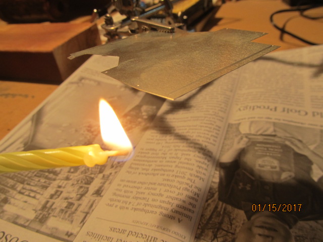

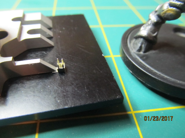

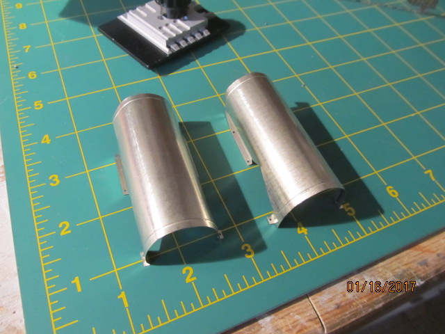

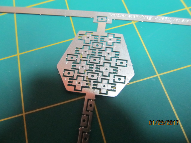

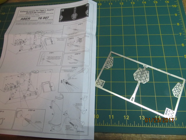

Starting things off with the Exhaust heat shields by Aber

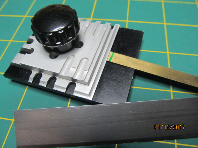

Annealing brass parts helps with bending process.
Adding scribe marks on Heat Shields
Ta-Dahhhh
Ta-Dahhhh

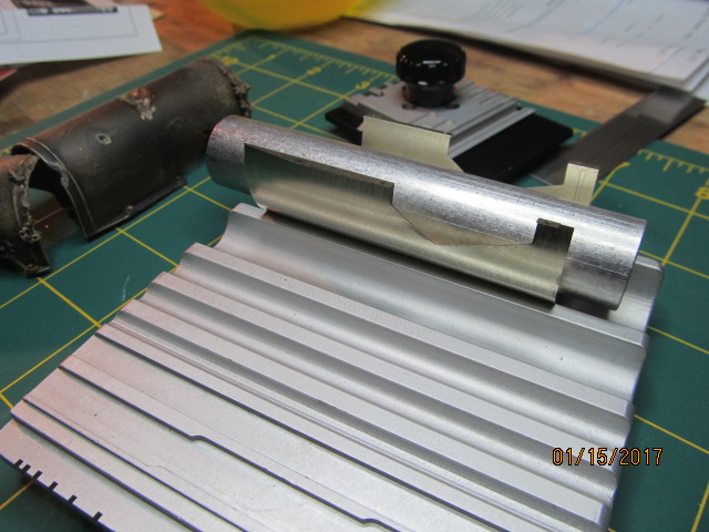

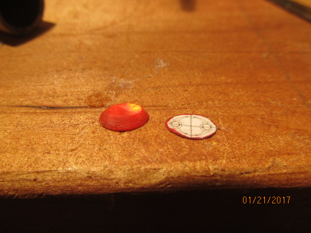

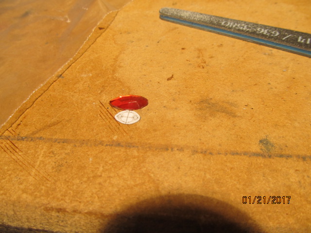

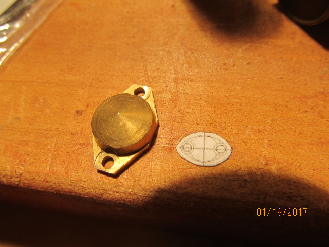

Brain storming on how to make this Engine Heater Cover
Scaling pattern for Eng Heater Cover
Cutting test shapes from Styrene
Styrene templates were a bust. Got this gem from craft store and shaped it with sanding stick.

Heres what I ended up with...Not sure if I like it though. I will try a couple more things...

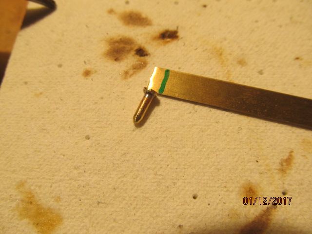

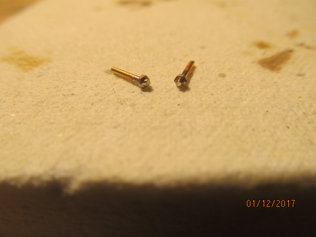

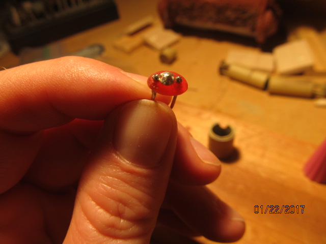

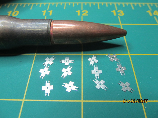

Time for Heat Shield Mounts
50 cal. for some size recognition...ha ha ha
Filling mounts with solder

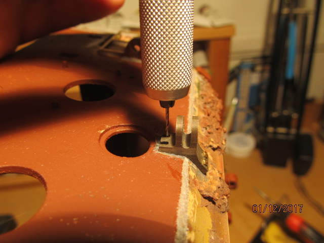

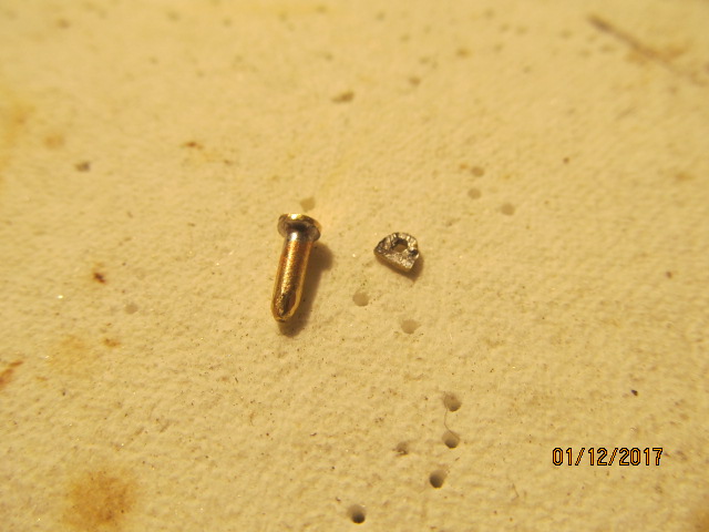

Drilling out solder for attachments bolts
Filling holes on rear hull with Styrene
