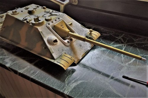

Today I tried to fit the gun. Realized that filling the cut area in the collar was too much, so had to regrind it. After that i spent time adding several layers of Vallejo Putty to smooth the ground area. Now I can get enough Depression. Also redrilled the spare track hangers and made the wholes for the retaining chains. Same on the Panther G hull... Enough for today.

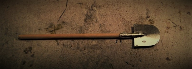

I wonder why I ignored this part completely until now. I was so tired after work today, and managed nothing more than to make this spade. ACE OF SPADES I am today
Might as well try to make another set of Tools for the JP. Starter crank shouldnt be too hard from 2mm wire. Hammer mybe form Apoxie Sculpt? Maybe axe as well? Or solder from 1mm brass Sheets? Cocktail sticks for the handles?
