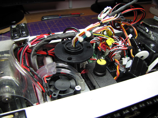

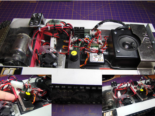

Just a little update: The lower hull now has the TK24 conversion installed (a super audio upgrade over the TK22 btw) and I have been able fit everything in as intended. Apart from the Clark board a better 10k pot for audio volume control has been added and, next to the main/smoker switch mount, can be seem a small step-down voltage regulator. This was needed because, frankly, running the Tarr smoker straight off the battery was producing too much smoke for realism.

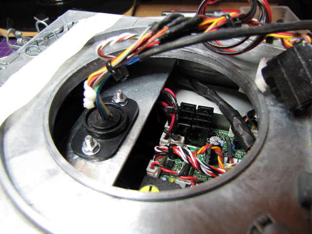

Finally, here is a picture of the finished result from the turret side; the 360 swivel drops neatly in place although, as I pointed out, it sits quite a bit forward. This means I may still have limited '360' ability depending on how inventive I can be with the turret wiring, though I'm confident it will work out fine (the tricky stuff is done).

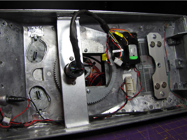

Returning to the modified 360 swivel bridge, I next fixed blocks to the sides of the upper hull to allow the bridge to slide in place. This is a firm fixing but easily removable if needed.

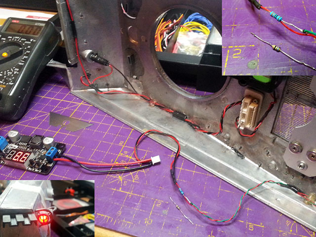

Before fitting the 360 swivel, however, I tested all the Mato upper hull wiring (oh me of little faith :D ). What I found was that the load resistor on the tail lights was woefully inadequate. Doing the math (sort of) I'd reckoned around a 150ohm resistor was needed but what I found was a very sorry looking 60ohm component. These lights are connected direct to the smoker output by Mato. That means on a fully charged NiMh battery up to around 8.6v are pumped to these leds. This is less for the TK24 because it's proportional but with the TK22 it's full voltage all the time. When I put even 6v to the leds through this resistor it became very very hot indeed. In the end I used a readily available 330ohm resistor that allowed a fairly bright tail lights even at the lower proportional output of around 3.0v but run very cool even at the full 8.6 volts. <br />I thought I would add this for other owners, or potential owners, just to keep an eye on because I really don't think Mato did their homework when hooking up the tail light leds to the smoker output on the Clark board, especially considering they were/are supplying these tanks with the older TK22 (full voltage on the smoker output). The headlight output is controlled by a dedicated output on the Clark board and so doesn't present a problem like this.

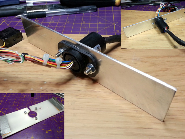

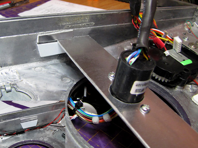

Moving on to the upper hull, I made a bridge to hold the 360 swivel in place. For this I used 2.0mm aluminum plate (the original is poorly cut plastic on mine - set inset pic) which allowed me to reduce the width of the bridge and produce much stronger fixing with the added bonus that is metal like the rest of the Mato. As can be seen, I also modified the 360 itself to a 2 instead of 3 bolt fixing.
The next thing I needed to do was ascertain just where the 360 swivel joint would fit between the new upper deck and the gearbox compartment - as can be seen a snug but feasible place (as I hoped) would be just above next to the Tarr smoker. This places the large 18 wire 360 swivel quite a bit forward from centre of the turret, but it's workable.
