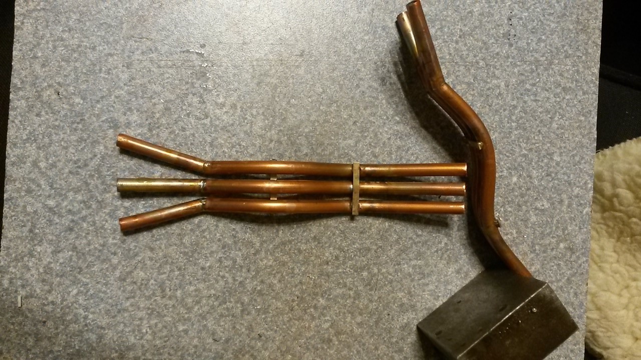

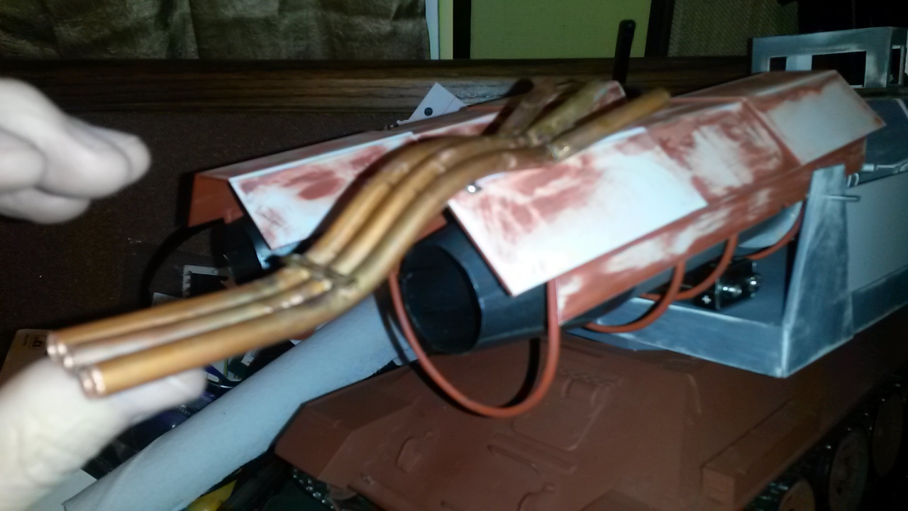

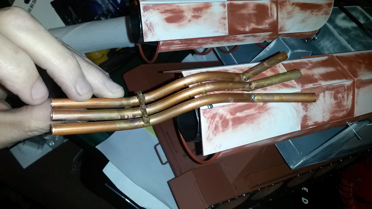

Did some soldering on the headers last night. Here's a couple of pictures of where I'm at, so far. Still have to trim down the back ends where the hoses will attach.
Next up is the header that mounts on the side and breaks into 3 lines. Going to have to make a trip out and hunt up some black hose for them, then I can give the sprays a test run. I'm going to make some tips out of brass to give some back pressure and to make the sprays fan shaped.Maybe two sprays horizontal, and the one in the middle vertical. That should make it look like more there than what there really is.

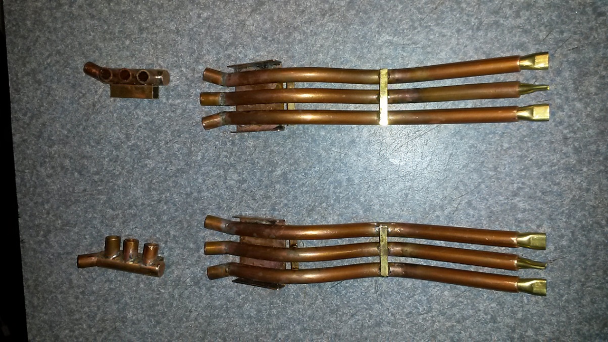

Did some more work on the sprays today. I made up a mounting plate for the sprays, made some tips, and did the supply headers.
Here's a view of all the spray parts, except for the hoses.
overall view
overall view

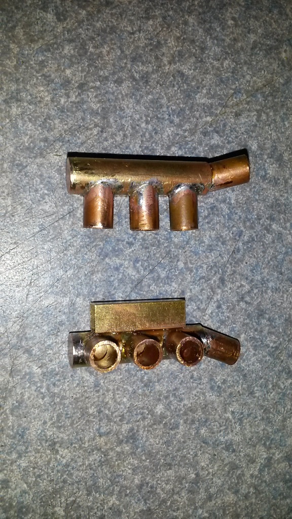

Here's a couple of shots of the supply headers. One input line and the three outputs going to the spray bars.
supply headers
supply headers
another view
another view

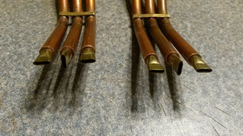

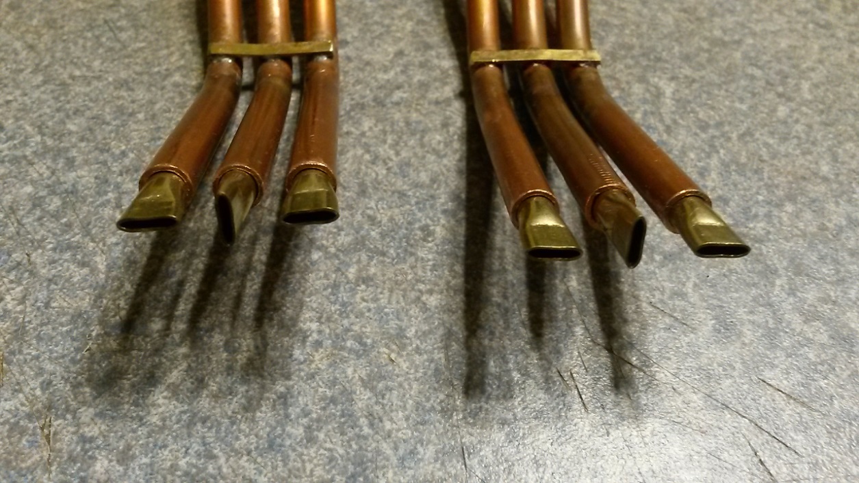

And here's the tips I made up for the sprays. Not really sure if they'll work, or not. Might need a bit of tweaking. I'll find out how well they'll work once I figure out what kind of pump I'll be using.
spray tips
spray tips

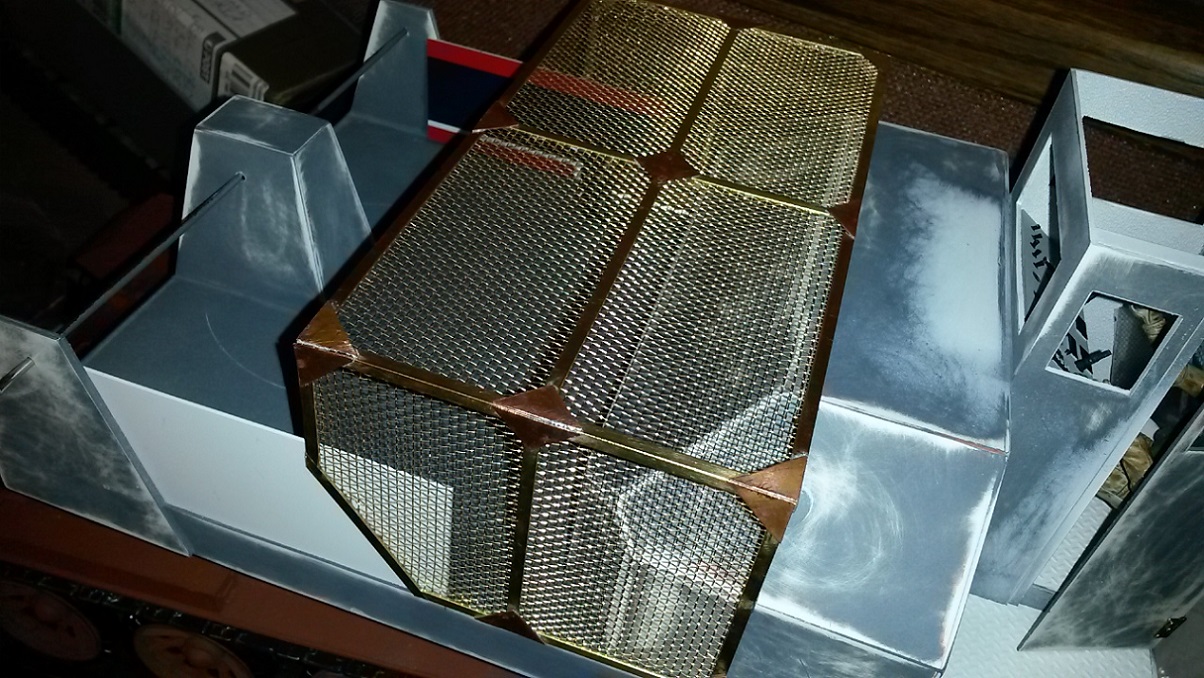

The brass screen arrived. Herman, you were right! This stuff is a pleasure to work with. Solders like a champ! I found a place that sells a smaller amount so I didn't have to buy a whole roll. Still expensive, but well worth it.
Anyway, here's the FOD screen for the jet intakes.
More to come, just have to get there!

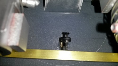

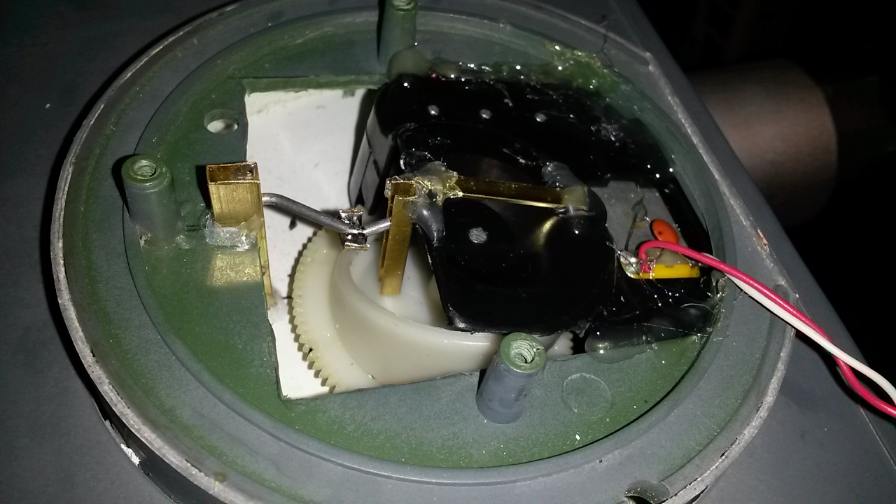

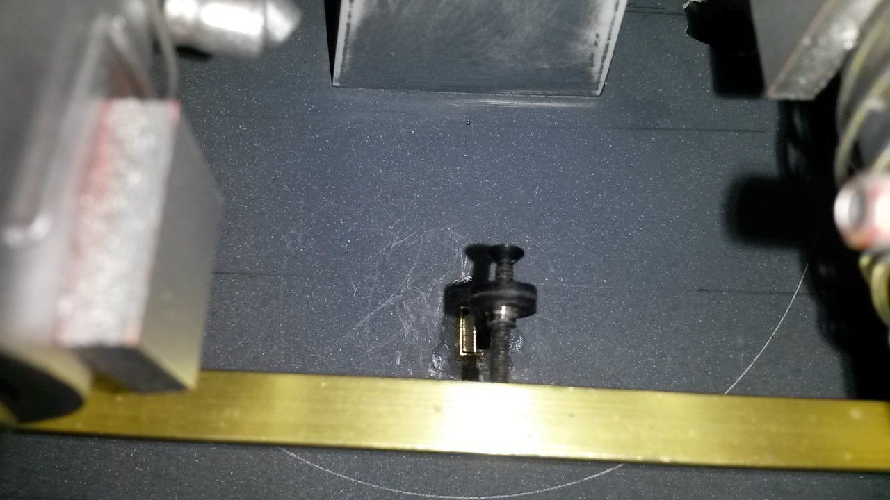

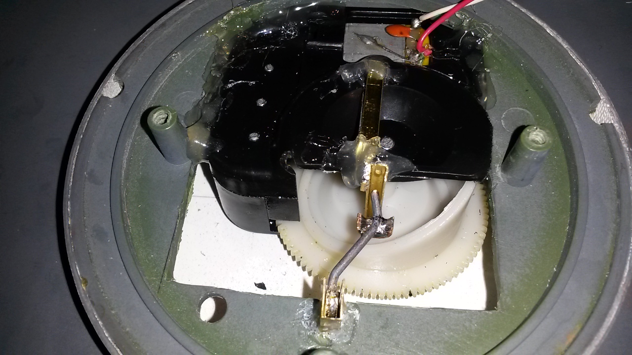

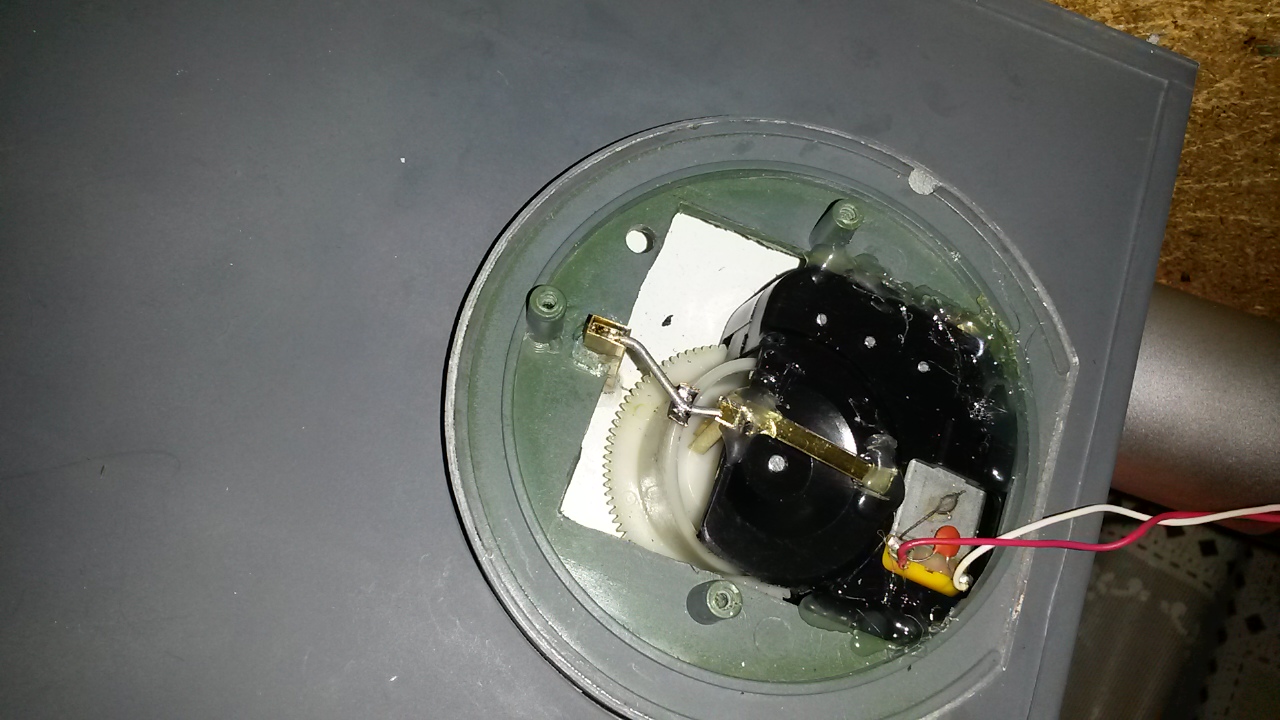

I spent most of the morning getting the elevation function to work on the jet engines. I used the HL elevation unit, with some of the case cut off so that it would fit inside the turret ring. The slide is made from a couple of telescoping, rectangular shaped brass tube. The arm that rides on the cam is steel rod, with a brass skid plate soldered onto it.
Here's some pictures from different angles.
There is a piece of brass angle that ties the engines together, I attached the slide to it with an R/C car swivel fitting. It slides on the screw to compensate for the forward / reverse travel .
And a link to a short video of it in action...
https://www.youtube.com/watch?v=7fEYF5SdL7A
After I got it all working correctly, I added the covers, ducted fans, and hoses. Of course, now there is too much weight for the elevation unit to move without the clutch slipping. Gonna have to think on this for a bit. It really moves pretty smooth, so I might just add some counter weight, or a couple of springs to carry some of the load.

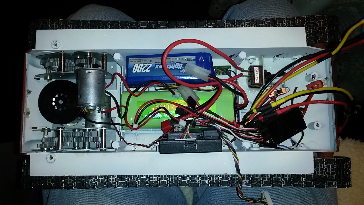

Here's the interior layout that I think will work out. Still waiting for a Taigen V2 MFU board to be in stock. ALso, there will be 2 ESC's installed, one for each jet.
inside
inside
The motors for the fans arrived Friday, so I tried running them up. Not sure if this beast will be able to run much above half throttle. Those little fans really move a load of air. Might not need those spray nozzles, after all, Mick! :wave:
It was about this point that I fried the ESC for the fans. Thought it was heavy enough to run the two. Think again. :{ So, ordered a couple of them. Hopefully they'll be here this week.

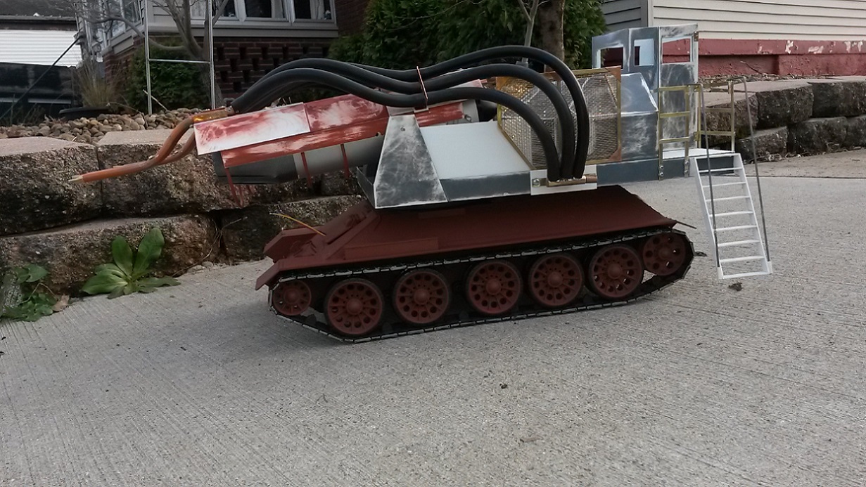

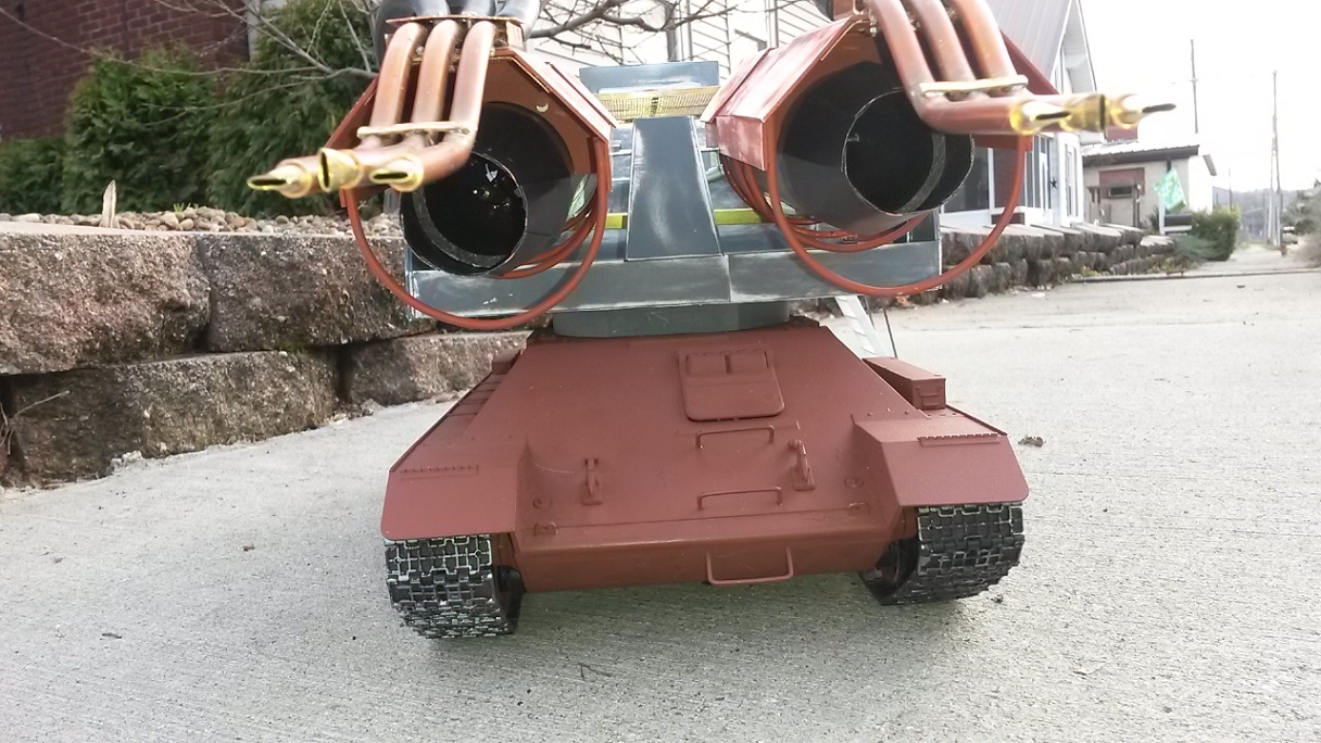

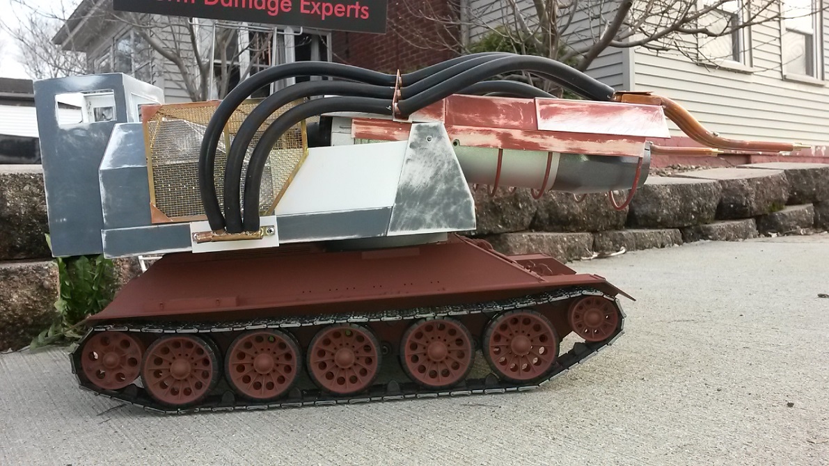

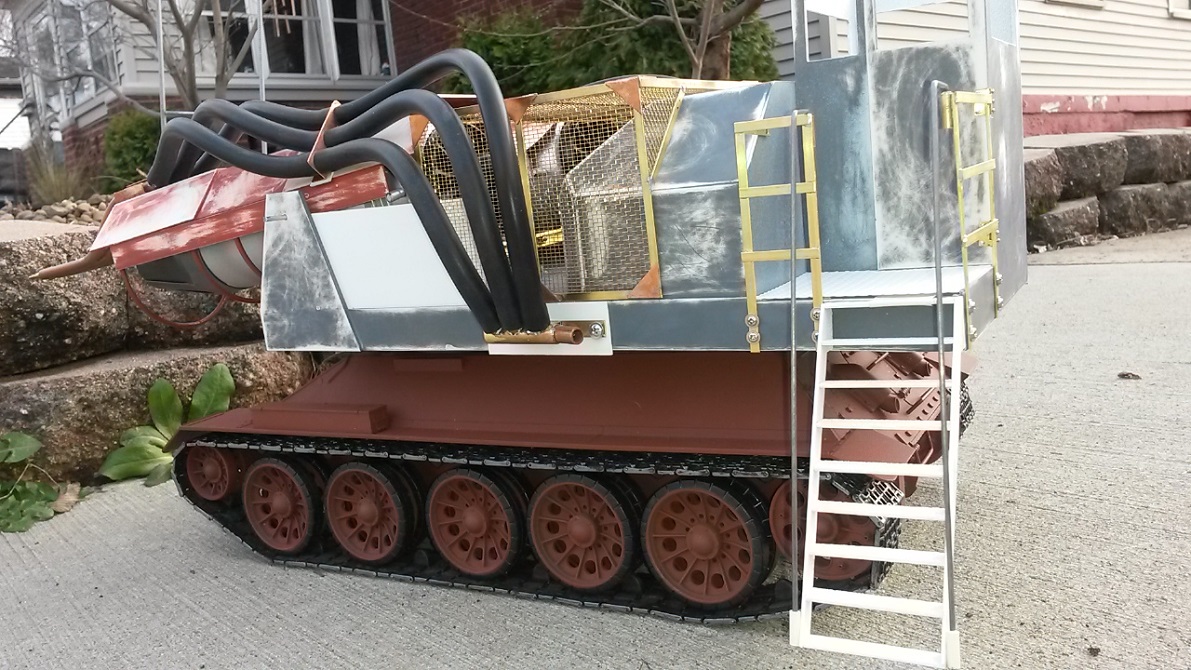

Cut and installed the hoses for the sprays and took it outside to get some decent pictures.
The business end.
Also made up the access ladder.
Guess it's about time to start some painting!
