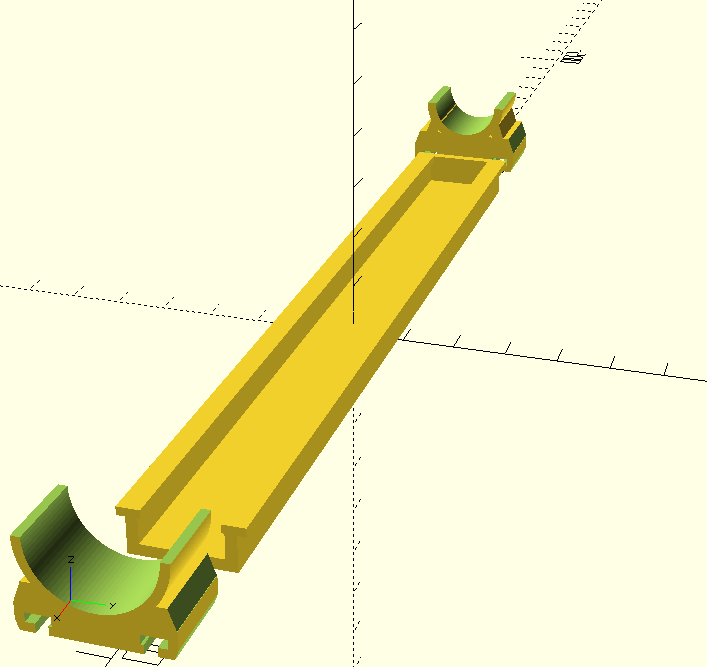

Having decided that building the gun with styrene is too flipping hard, I have started the design work using openscad to produce it on a 3d printer when I get back from Spain. Here it is so far....
Obviously lots more work required but a reasonable start.
I'm going to need a printer that handles at least 150x100x60 and it's going to take a while to print!

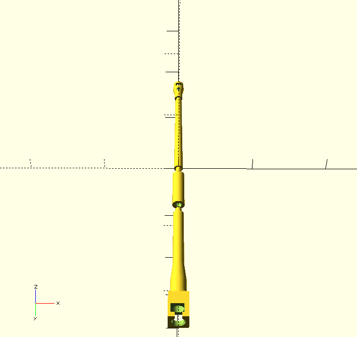

Done the design for the barrel, I had to split it into 4 to make it printable. I suspect there will be a few failed prints before I get it right and accurate
I can't wait to get the printer and give it a try!

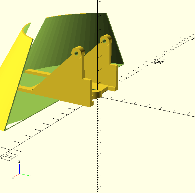

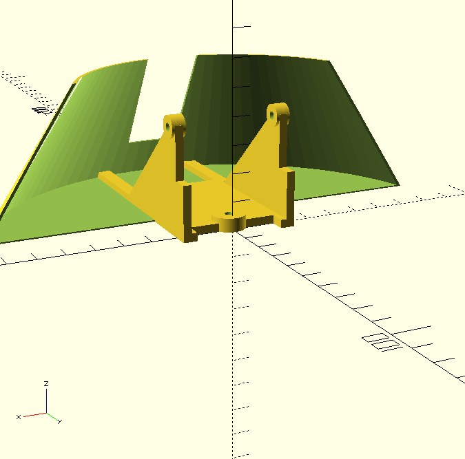

Designed the cradle and barrel mounts
I had to make sure the barrel mounts were free running so I can get the recoil working

More progress on the build and more parts printed for the gun carriage
The slewing turret is fitted
I printed off the cradle and the front gun support but the design was wrong
, so back to the drawing board, then reprints, and presto I have a carriage and the front and back supports which I'm delighted run freely so recoil is going to happen!
The gun is pretty big and I'm waiting for brass tube to reinforce the middle.
Just have to print the cradle supporting bracket and then the whole cradle assembly is complete.
