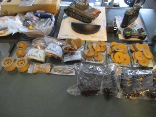

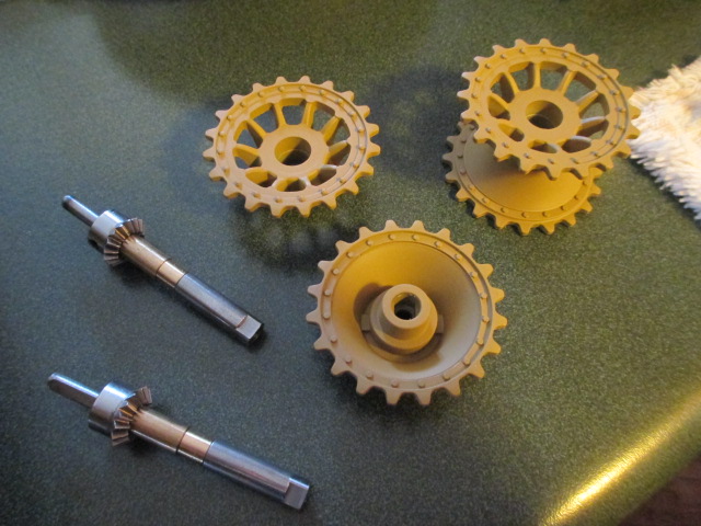

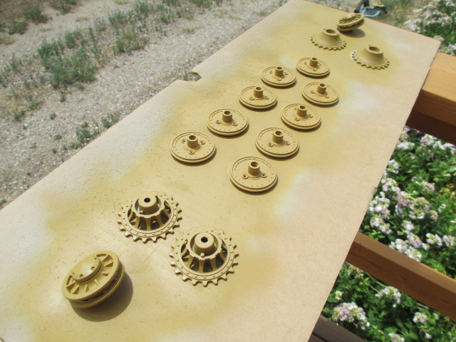

Post came yesterday with a very nice Aber aerial for the tank. This type will let me use my miniature spring set to make it fully functional. Spent the afternoon primering and spraying what seemed like a 100 road wheel pieces along with the sprockets and idlers. They can cure tonight and I'll assemble all of this tomorrow. ;o) Pics:
Everything painted where it is supposed have paint and set aside to cure.
One set of seven...
One set of seven...

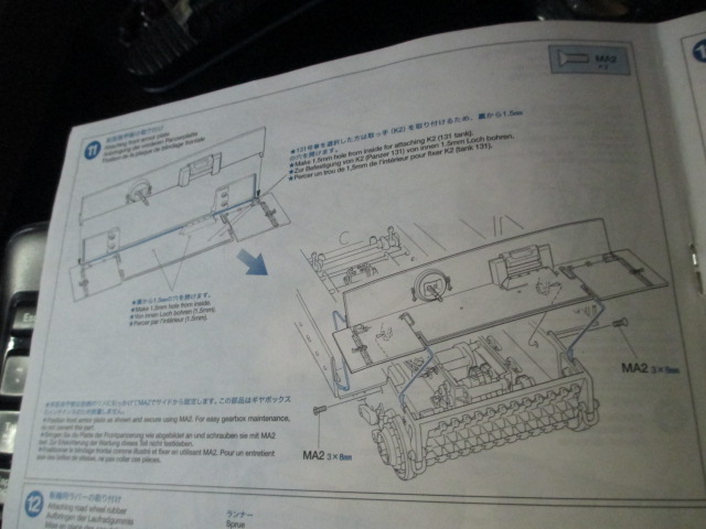

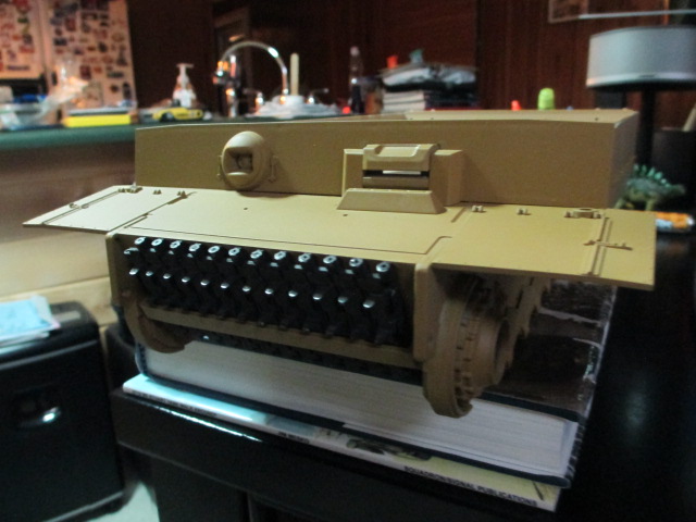

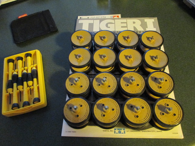

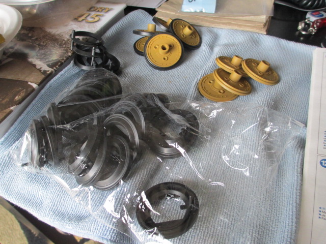

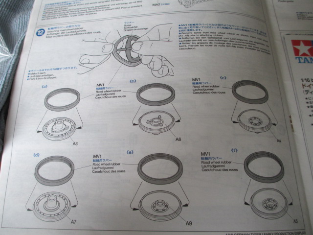

Ad Lav, thank you, sir. This afternoon saw the cleanup of the spray job on the lower hull and the attachment with nuts and bolts of the working track section on the glacis of the tank. All of the road wheels are prepped now with their rubber tires on. A small note to the next builder of one of these. Tamiya will give you nine road wheels of each type but only eight of the rubber tires for those eight required. ;o) Pics:
Tires and road wheels underway
Step 12 and 48 rubber tires removed from their ( admittedly cool sprues ) and put on the road wheels.  Tamiya really knows their stuff.

Mounted solidly with nuts and bolts cold welded to the crossbar retainer
Mounted solidly with nuts and bolts cold welded to the crossbar retainer.JPG (99.03 KiB) Viewed 4282 times
Step 11 requires mounting the bar and the section of track.  I eschewed the Tamiya molded segment and used a piece of live track off of a set of HLs'
Step 11 requires mounting the bar and the section of track. I eschewed the Tamiya molded segment and used a piece of live track off of a set of HLs'.JPG (94.29 KiB) Viewed 4282 times

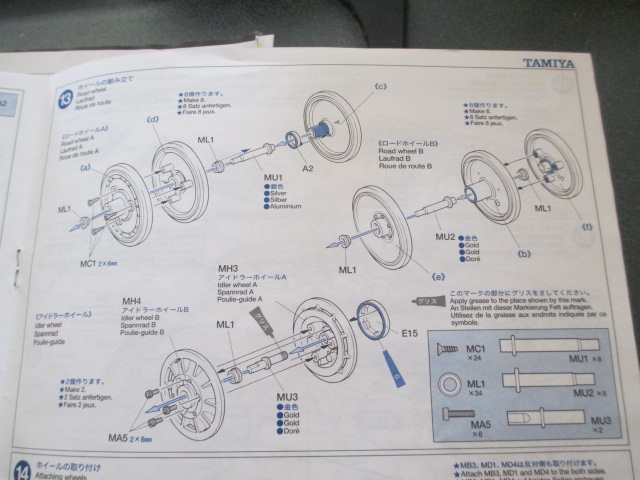

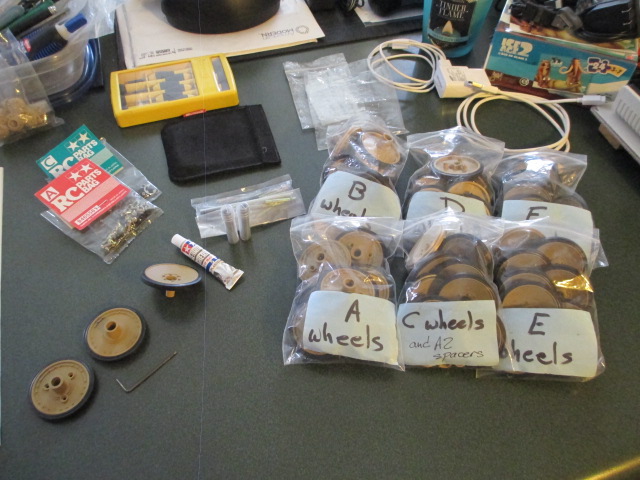

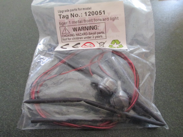

Post brought a set of Taigen Tiger 1 headlights last Saturday. I need the LEDs and wiring out of them. Also, weekend is over so on to Step 13. Bearings were located and Tamiya's brass bushings set aside. It's not even work doing this kind of repetition when everything is so well engineered. Even Tamiyas little pot metal multi-wrench makes a perfect bearing press so things sit evenly. The idlers did not have to be assembled as Mike had provided excellent metal early types with bearings already. Pics:
Completed and free wheeling
Ready to go with parts, wheels, tools, UltraGel and bearings
Step 13 required you to be awake...
the LEDs and wiring for headlights

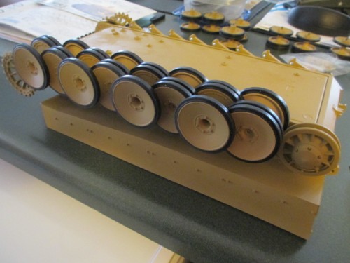

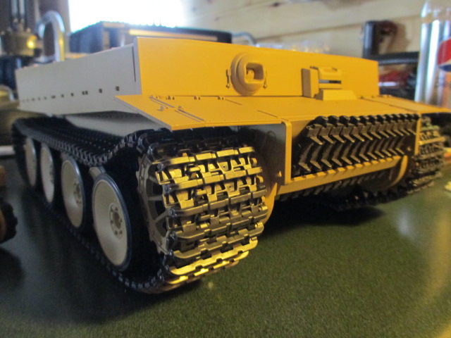

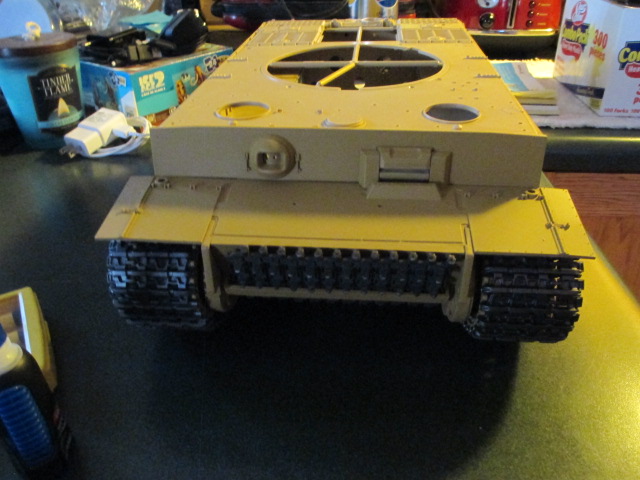

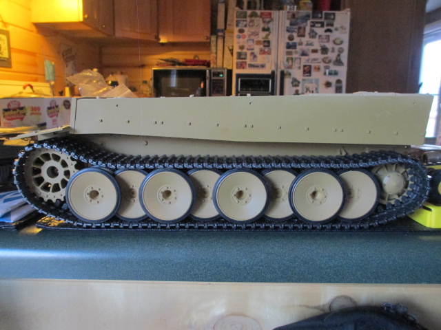

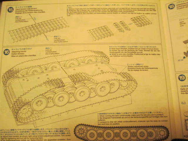

Tonights update is the last until this coming Monday. I have a convention to attend in Denver, Friday through Sunday. So on to the fun. Wrapped up (for the most part, some paint detailing is required) Steps 13-15. Pics:

Solid and straight.
Solid and straight.

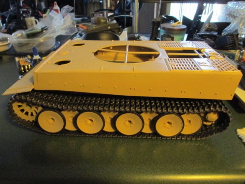

On it's paws finally...

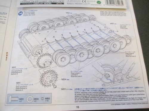

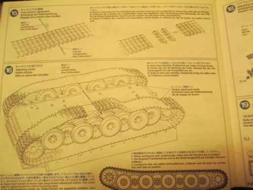

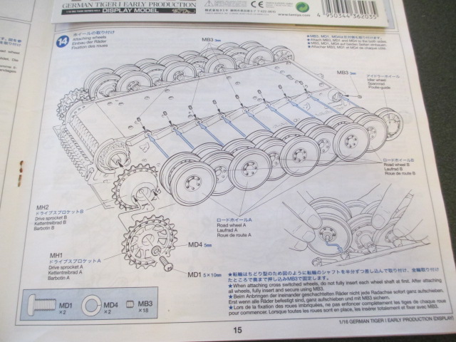

Steps 14 and 15...Tamiya wants you to remove two track links to mount these.  Only one track link is required to get almost perfect slack right off of the bat.
One side completed.  The Henntec adjuster for the Idlers will be handy.

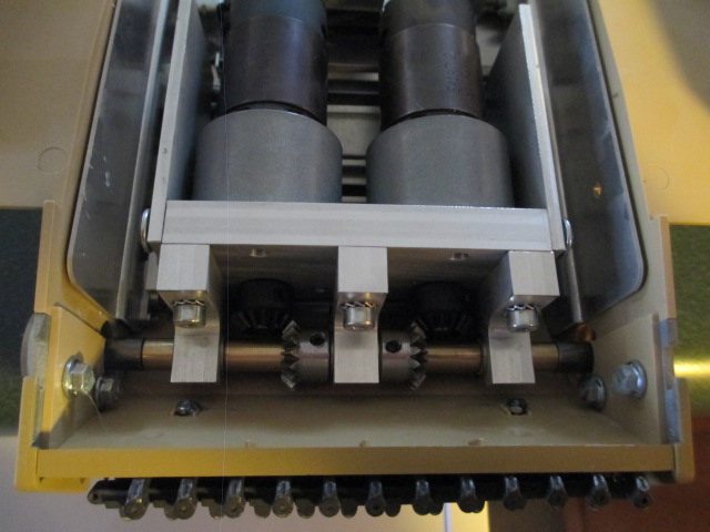

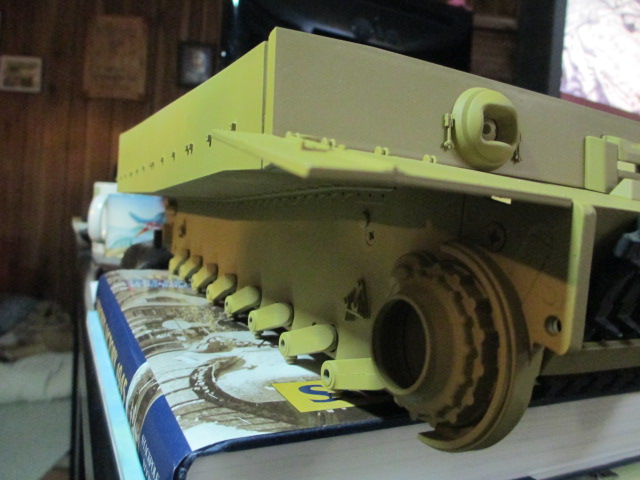

No brains yet but the brawn is in place.  No give whatsoever in those axles and sprocket mounts.
No brains yet but the brawn is in place. No give whatsoever in those axles and sprocket mounts..JPG (94.68 KiB) Viewed 4191 times
The gearbox axle mounts were an Epic in and of themselves.
Step 13.  A good tip here is to leave the axles loose in the suspension arms until all the road wheels are in place.
