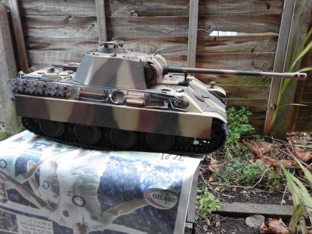

The schurzen have now had a coat or two of paint. This tank has been my first experience with an airbrush, and I still have a lot to earn before I can get a really quality job. However, my excuse for the time-being is that camouflage was put on in the field by the crew with a bucket and a mop
Richard

helluva good job with the airbrush ! you have no fears now mate ! nice job.are you gonna weather it ?

Re: My Panther G Build
Richard, well done mate, you have done an amazing job, it's not an easy proposition to take on a job like this for your second build, you have done yourself proud
